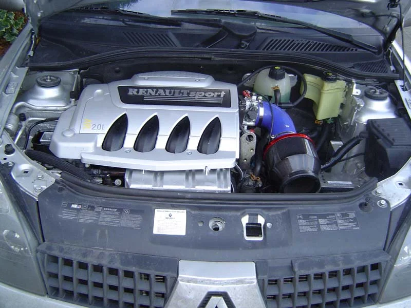

My viper was open at the back of the rad (1st pic). When mapping the car on the road on a cold day (approx 10deg) inlet temps (measured at the inlet manifold) were between 20 and 35deg depending on how hard the car was being driven, the harder you drove it the hotter the rad got and the hotter the intake.

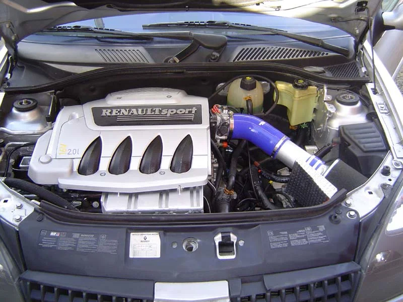

The second pic is the maxogen, an open one. Doing the same as above on a similar temp day the inlet temp sat at a constant 17deg it did not move around at all.
I think in the summer the test would have gone even more in favour of the second setup with under bonnet temps being even higher.
I can not comment on a setup with a CAF as I never tried one but I imagine throttle response would not be as good and all the restrictions in the pipe wont help.
You could try an open maxogen like mine they are only about £50 and see how you got on with it would probably be OK in the winter.
Not sure how much temperature effects bhp there is probably some figures for it somewhere.
PS I like the look of the hillpower one looks like a good compromise between open and closed filter (you get the noise without the heat soak)
