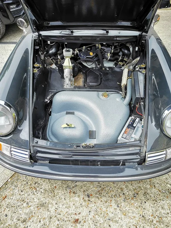

We went over to where the car is kept and at first glance it looked quite nice, the paint work wasn't perfect but on the whole it looked cool. Darren showed me the things that he wanted sorted but I suggested that it would be best for me to come back another day and do a full wheels off inspection and that way I could give him a list of my findings and we could go from there.
IMG_20200212_195328_644 by Scott Raven, on Flickr
IMG_20200210_120903 by Scott Raven, on Flickr
IMG_20200210_121825~2 by Scott Raven, on Flickr
IMG_20200210_154033~2 by Scott Raven, on Flickr

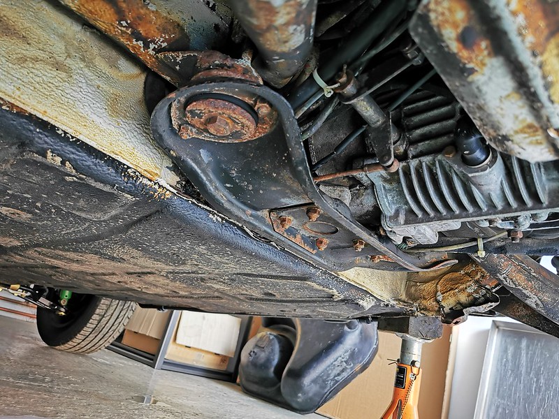

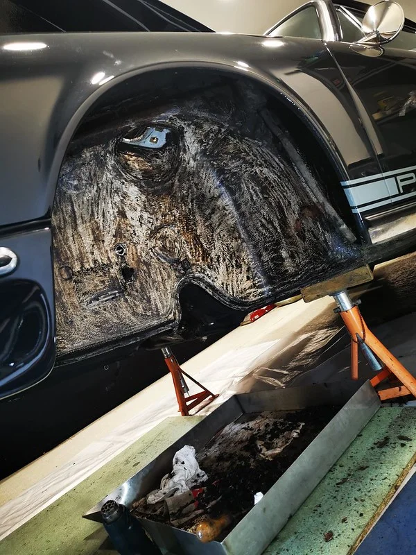

On my return the car was jacked up and the list was done, Darren had told me he had just given £75K for the car so what I found wrong was shocking considering the price of the car. Front wheel bearings noisy, bearing races damaged and hardly any grease, engine oil leaks, long bonnet been made from a standard bonnet with a bit of metal welded on, wrong bonnet slam panel and catch, washer bottle held in with foam, front and rear suspension in bad condition, fuel leaks from the tank, wings going rusty, rear 1/4s full of filler, all lights held in with self tappers, broken seat adjuster, old Moss alarm still fitted but not working, bad wiring everywhere, wrong screws holding the trim in place, front and rear bumpers being made of fibreglass and not steel and being held in with screws, gas struts on the engine lid and bonnet not holding up, door rubbers split, front shocks/legs fucked because the wheel bearings had worn the hubs due to bad adjustment, poorly made copper brake pipes etc etc......
I gave Darren the list and he's response was okay that's fine when can you do the work.

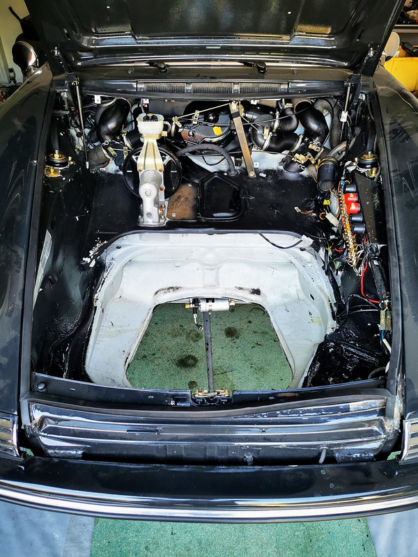

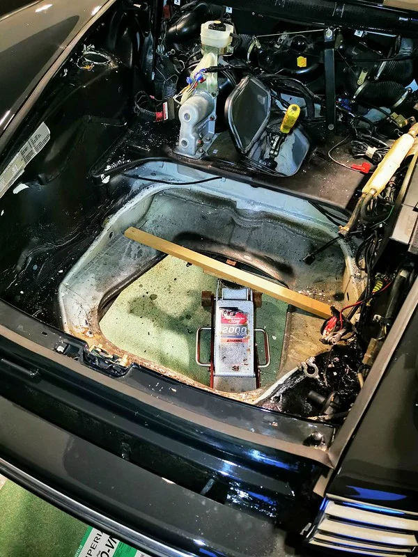

I started by removing the fuel tank and front suspension where it was stripped down for blasting and powder coating, all fixings plated and all bushes replaced with Powerflex heritage items to just improve things a little while still looking like factory rubber bushes.
The plan with the car is to get the car to a standard it can be driven and enjoyed, I will be stripping it down to a bare shell so the panel work can be sorted, sunroof delete and a bare metal repaint.
Once that's done the refurbished suspension can be bolted back and the rest of the car fitted up with other new parts like Singer style door mirrors and a set of back dated clocks so i had to be mindful how far I went with the car considering it will be come apart again.

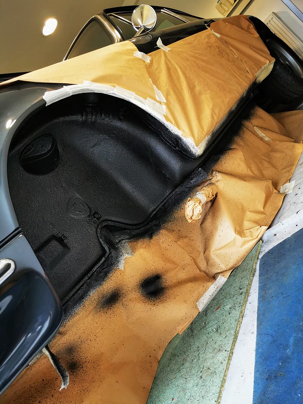

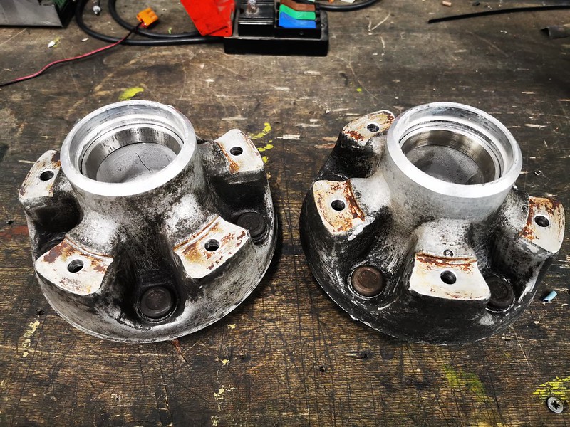

Front wheel arches were cleaned off, painted and undersealed, oil lines and thermostat was also removed. Front hubs stripped, vapor blasted and new bearings installed with plenty of grease this time.

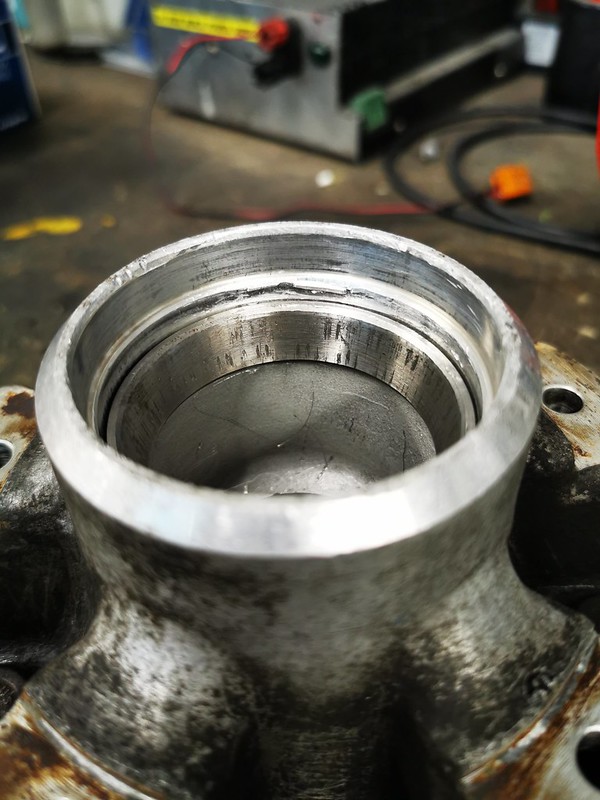

Once the fuel tank was removed i saw that the rubber fuel lines didn't look to be in the best condition so i had a new pair made up and on closer inspection the fuel tank had undergone a few repairs so a new tank was bought.
IMG_20200228_140308 by Scott Raven, on Flickr
State of those bearing races. :mad:

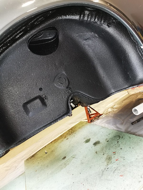

Wheel arches and sills undersealed ready for the suspension to go back in.

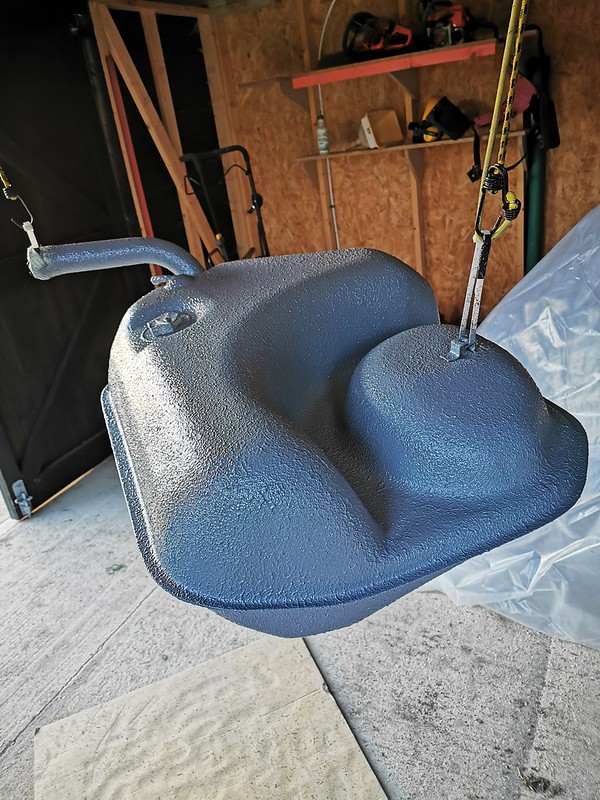

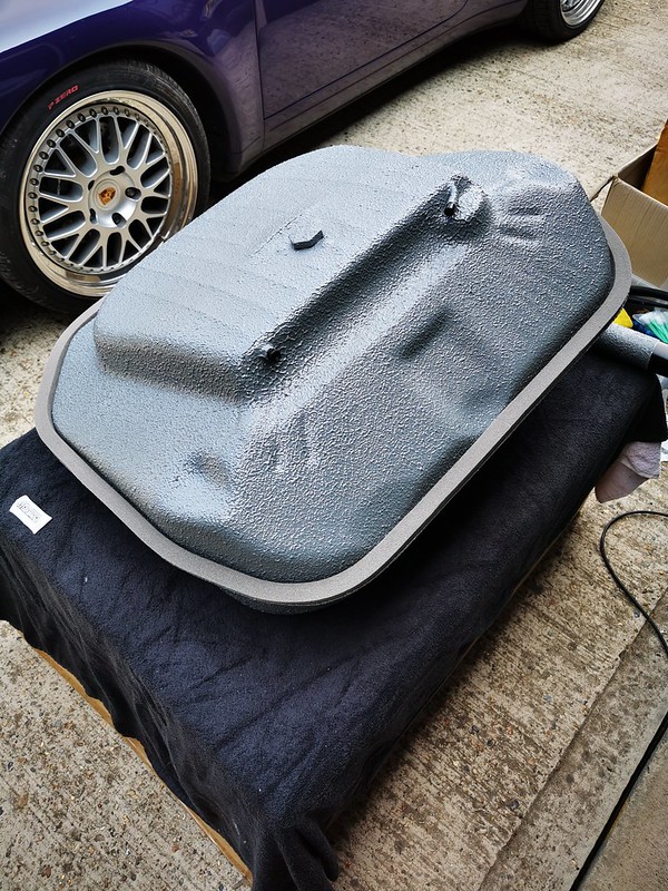

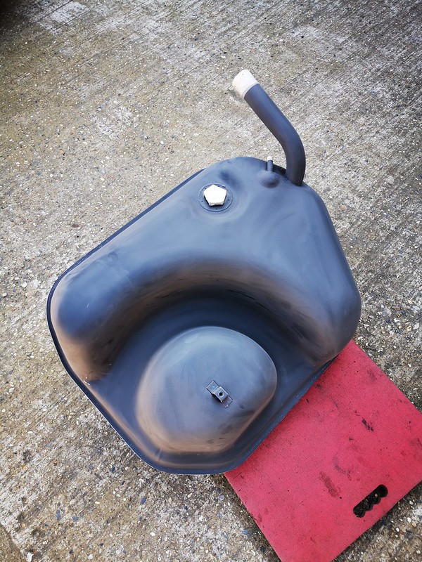

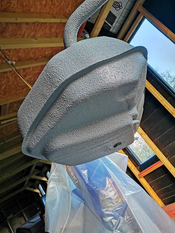

New fuel tank was prepped so it could be protected with the factory 3M bag sealant for that OEM finish. :cool:
IMG_20200321_140251 by Scott Raven, on Flickr
IMG_20200321_174156 by Scott Raven, on Flickr
IMG_20200321_174059 by Scott Raven, on Flickr

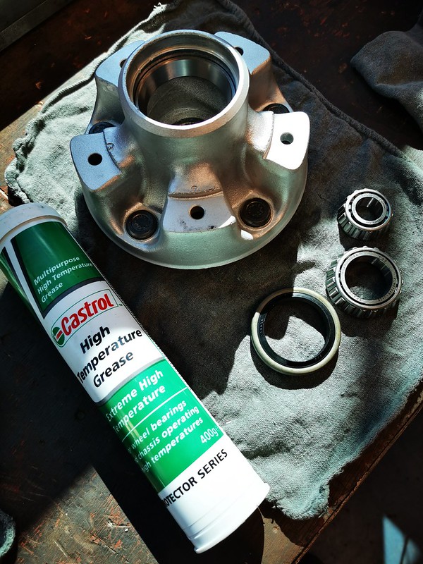

Fitted the new fuel lines and copper brake pipes and built up the front hubs.

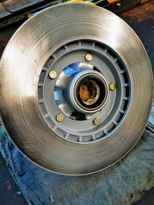

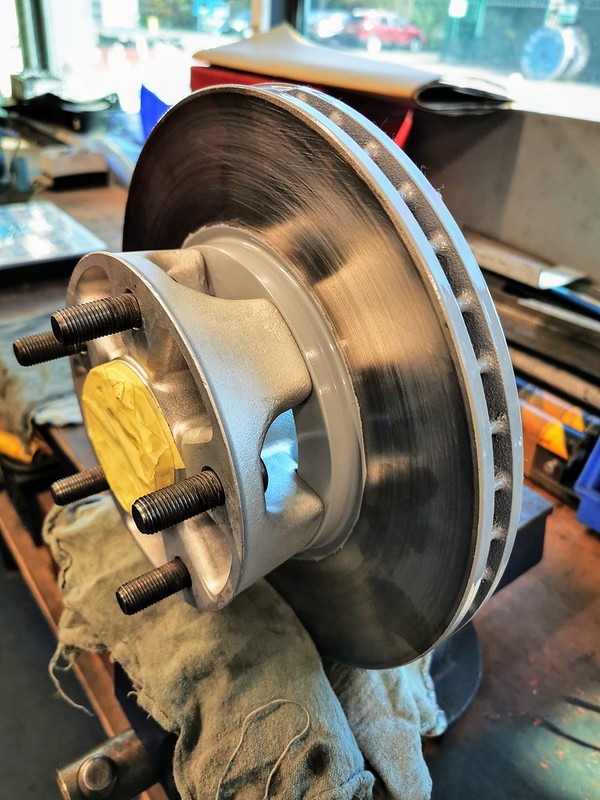

Brake discs where all good so just had a clean and a paint.
IMG_20200325_132934~2 by Scott Raven, on Flickr
IMG_20200325_133100~2 by Scott Raven, on Flickr

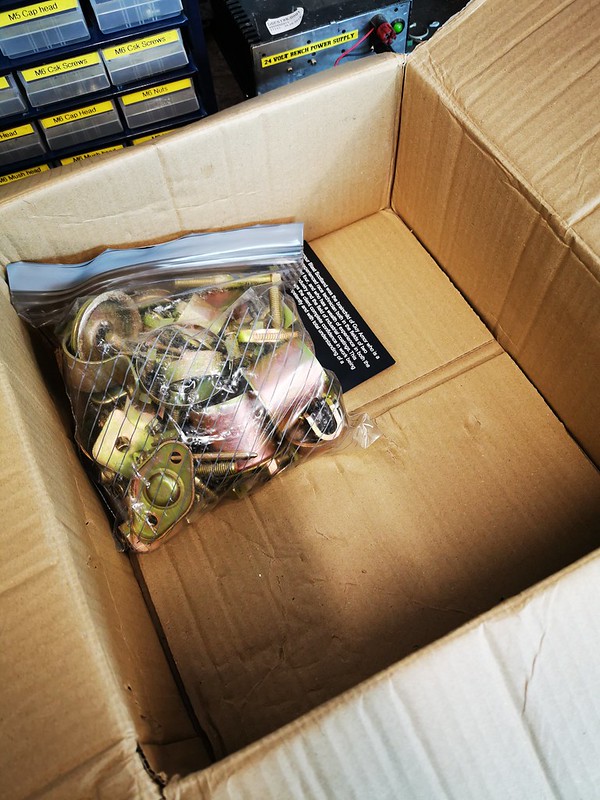

Plating parts came back.
IMG_20200401_105145 by Scott Raven, on Flickr

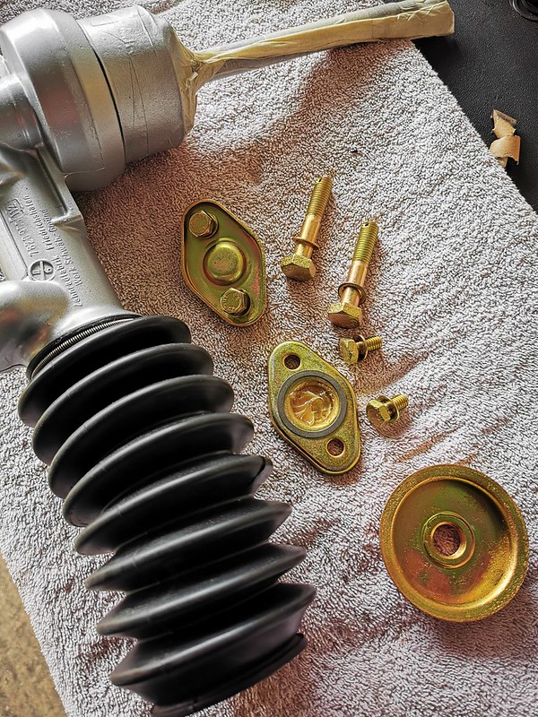

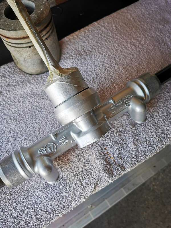

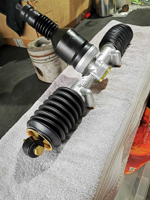

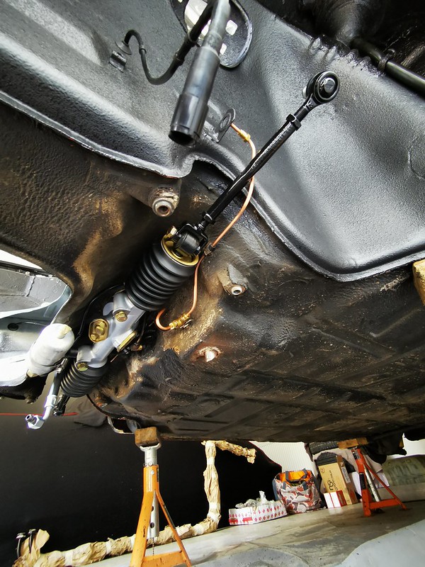

Steering rack was stripped, cleaned and inspected then assembled with new steering arm bushes and a Powerflex top support bush.
IMG_20200325_153115 by Scott Raven, on Flickr
IMG_20200401_144933 by Scott Raven, on Flickr
IMG_20200401_170743 by Scott Raven, on Flickr

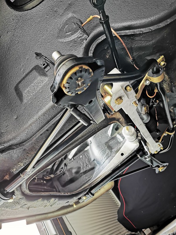

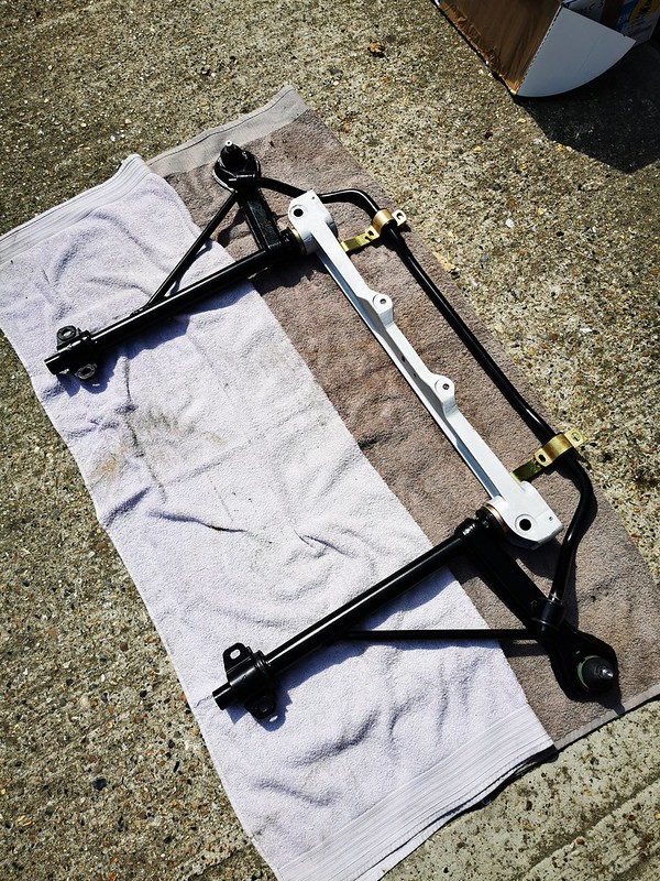

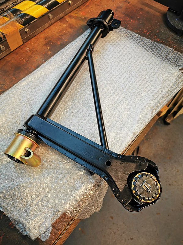

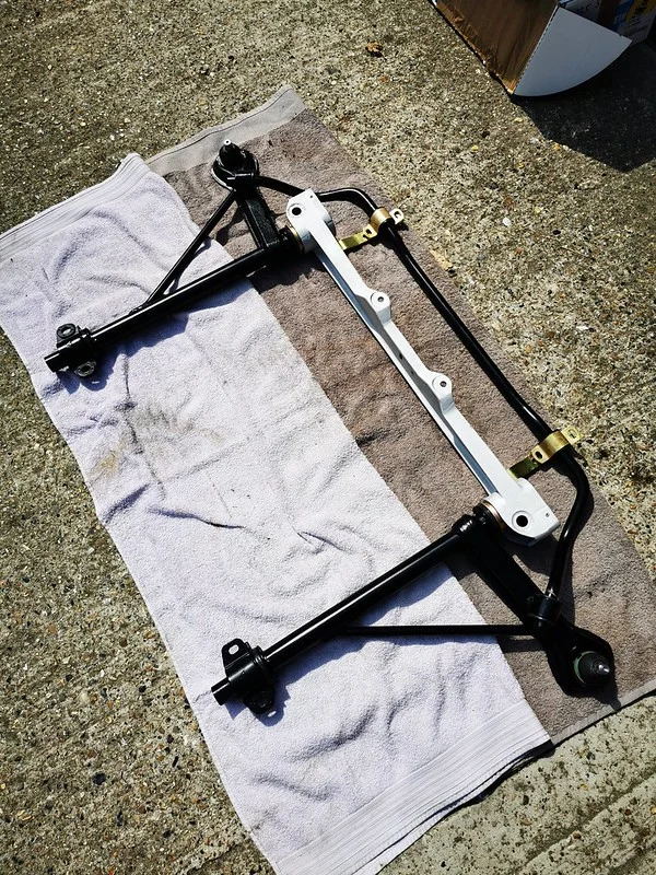

Wishbones were built up with Powerflex bushes and new ball joints.
IMG_20200402_080102 by Scott Raven, on Flickr
IMG_20200808_113313 by Scott Raven, on Flickr
And steering rack installed back into the car.
IMG_20200808_113716 by Scott Raven, on Flickr

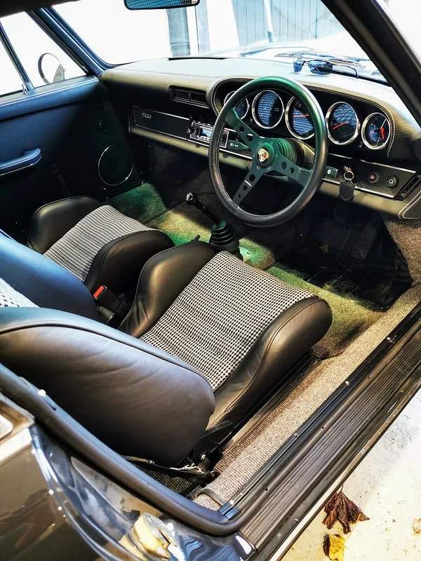

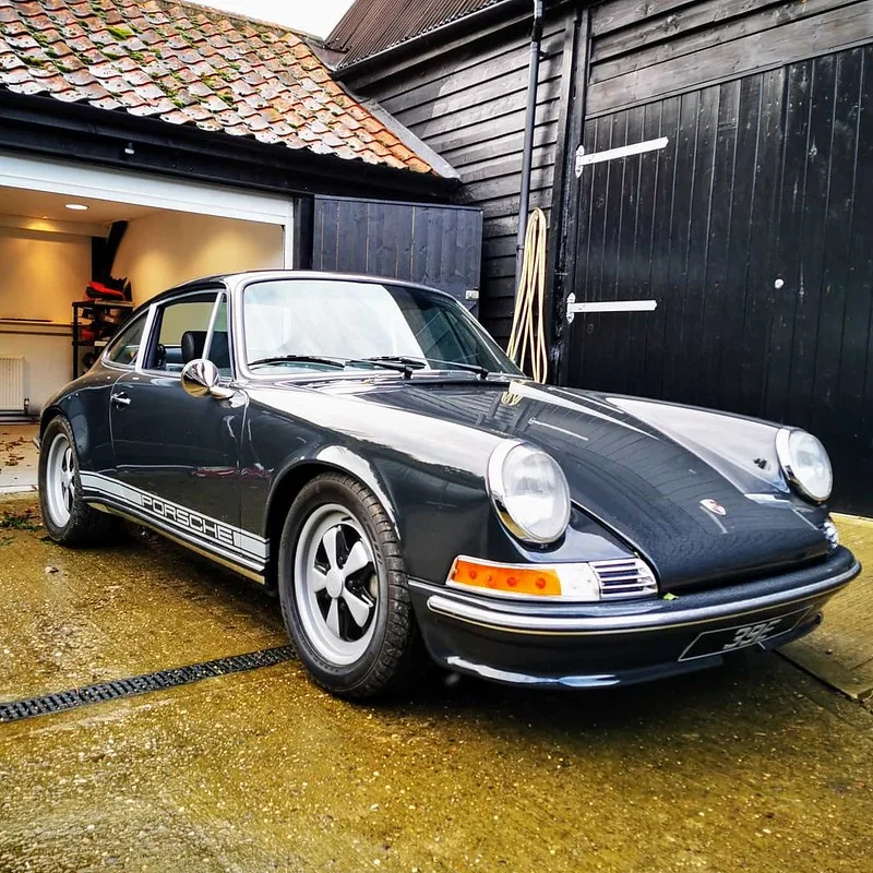

Yeah basically it's made into a older looking 911, impact bumpers are removed and all of the black exterior trim has been polished. Interior trim is also made to look old.
We are going to backdate the dash clocks but this was going to be a 6-8 week wait and a cost of around £2500k and at the time Darren just wanted to be able to drive the car again so it's beetput on hold for now.
originally it looked something like this
so yeah an 80's car made to look older.

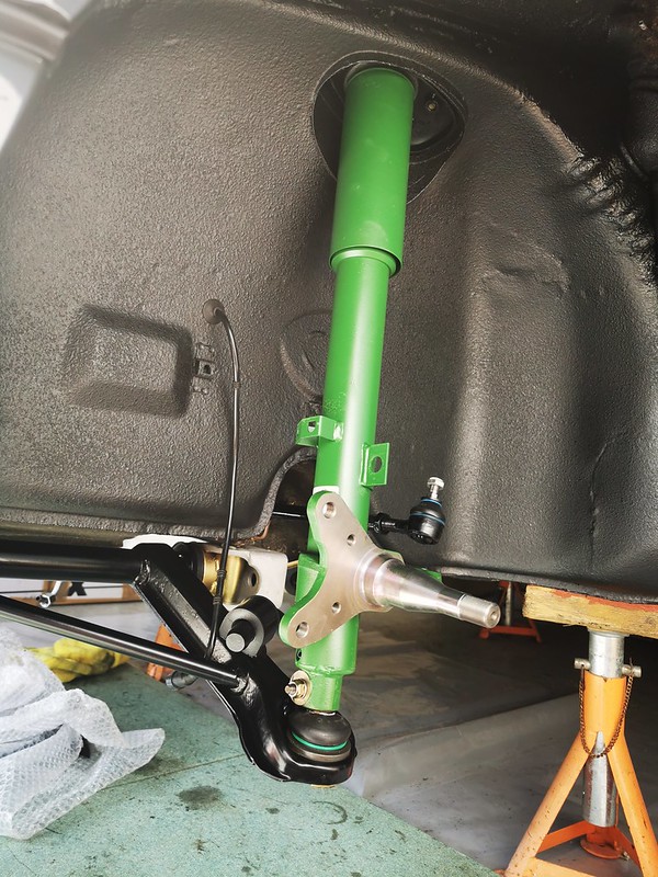

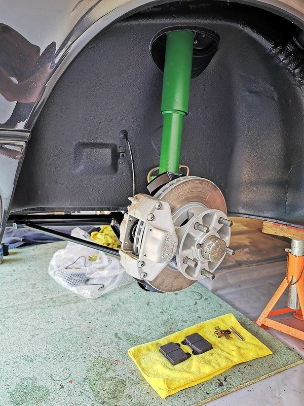

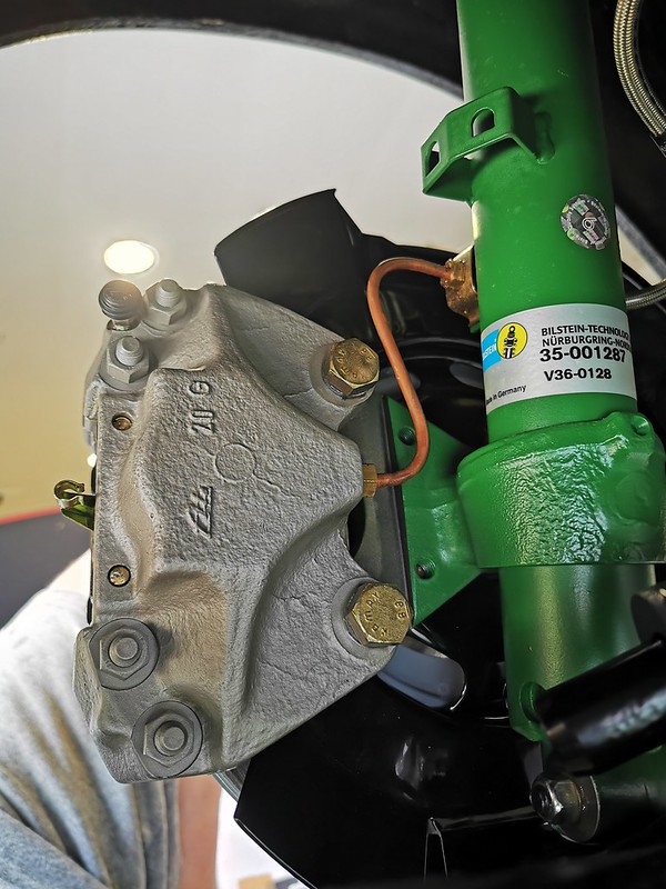

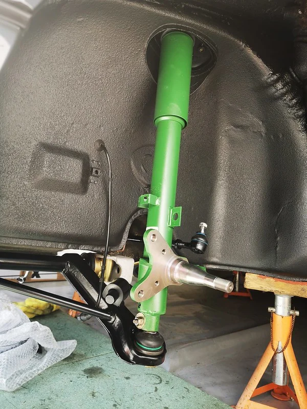

I decided to replace the damaged front legs with a pair of Bilstein factory option sports shocks, the rears had already been replaced with a pair of yellow fast road sports shocks so it made sense to upgrade the fronts and paint the rears green to match.
IMG_20200809_092538 by Scott Raven, on Flickr
New disc backs powder coated in gloss black and the brake caliper's were stripped, blasted and coated in a light grey.
IMG_20200809_095326 by Scott Raven, on Flickr
IMG_20200809_121846 by Scott Raven, on Flickr

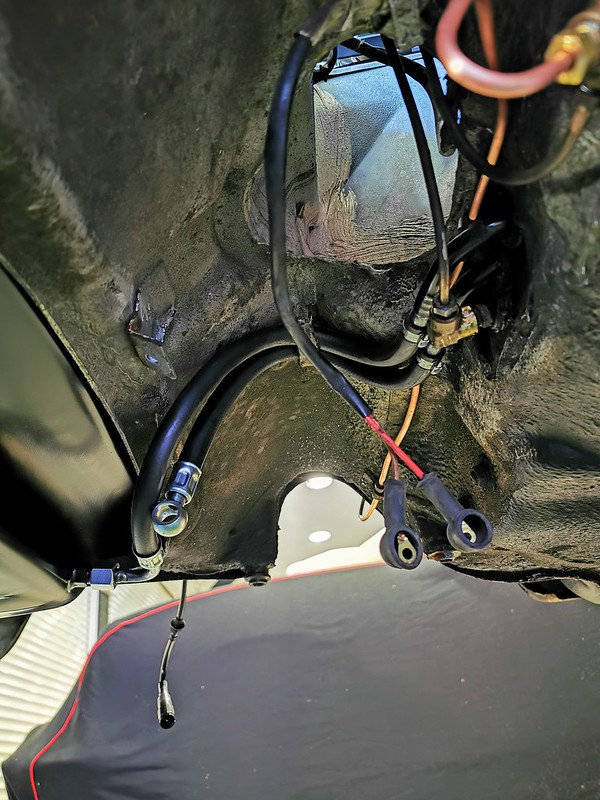

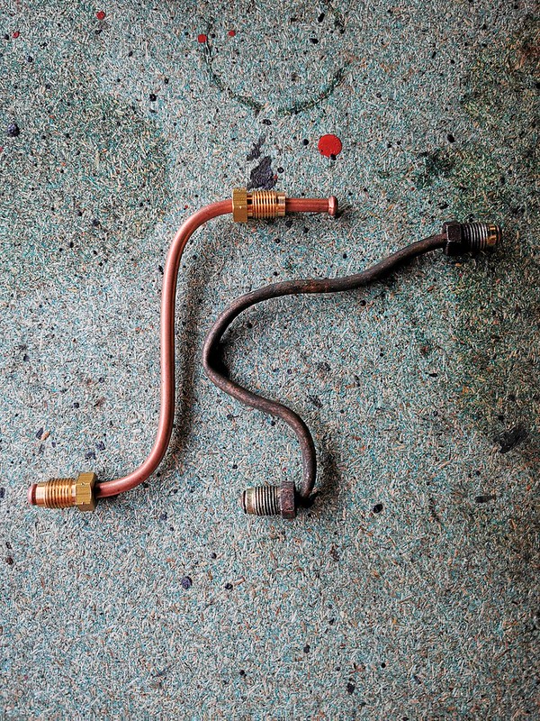

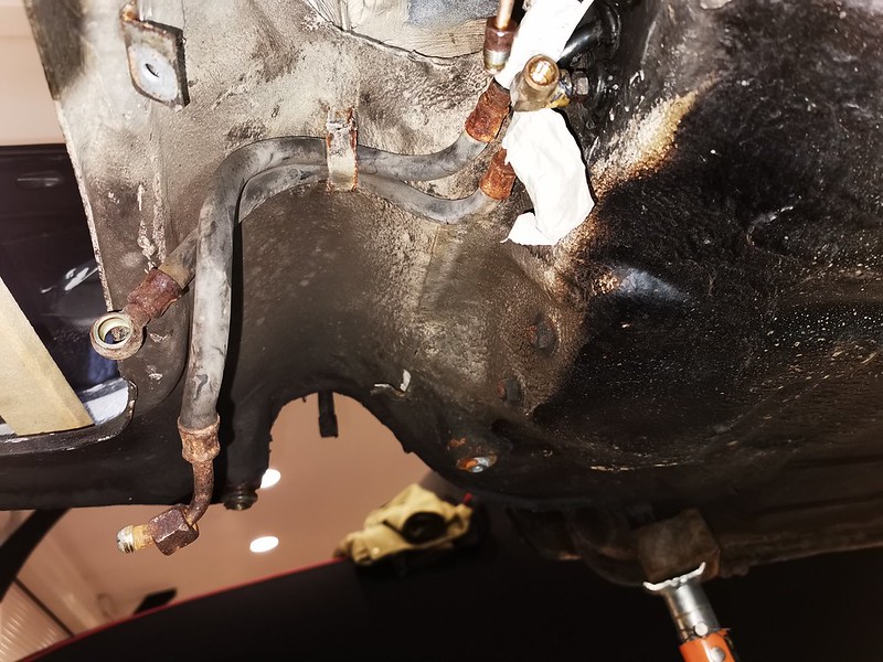

With the caliper fitted I could make up new copper brake pipes to replace the poorly made ones that id removed. How someone could make and fit that and think its acceptable is beyond me.
IMG_20200809_111603 by Scott Raven, on Flickr
IMG_20200815_125126 by Scott Raven, on Flickr

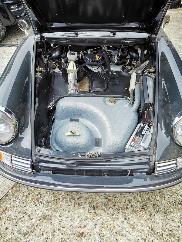

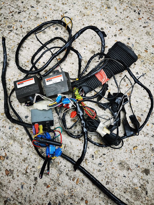

The fuel tank was installed with a factory Porsche foam seal, new filler neck hose also used. While was working in that area the old Moss alarm was removed and the wiring tidied up the best it could be.
IMG_20200810_154427 by Scott Raven, on Flickr
IMG_20200810_151103~2 by Scott Raven, on Flickr
IMG_20200816_132036 by Scott Raven, on Flickr
IMG_20200816_114222 by Scott Raven, on Flickr

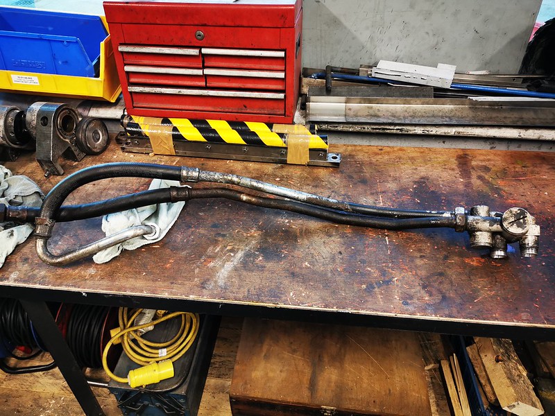

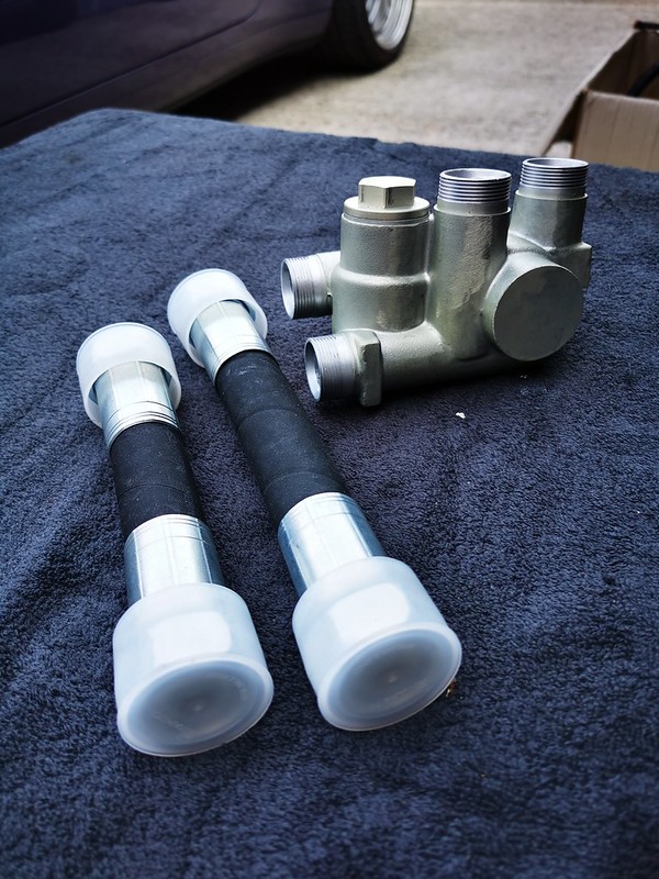

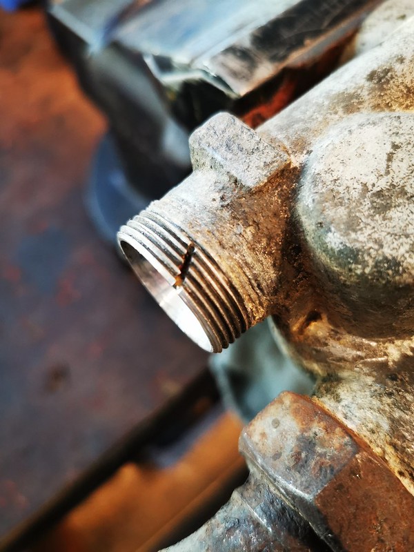

With the front end complete the next job was to sort the oil lines, cooler and thermostat. Like with everything I seem to touch on this car the oil system was no different it was in a bad state through other peoples bad work.
The main hard oil lines were cleaned (because they were covered in underseal) and painted, ideally they needed replacing because the threads have been damaged by someone cutting the old flexi hoses off but at £1k these can wait until the full strip happens.
I replaced a few oil pipes and had to replace the alloy thermostat with a genuine Porsche unit, again because of someone else's bad work.

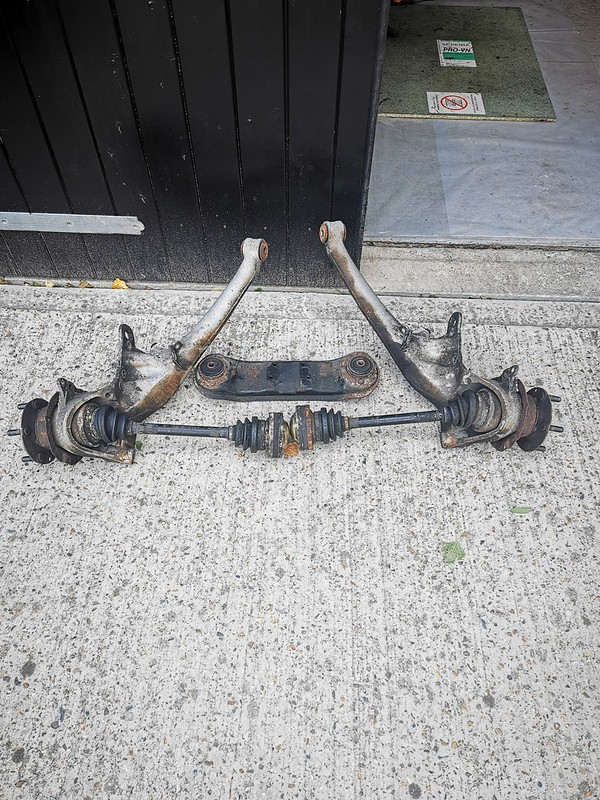

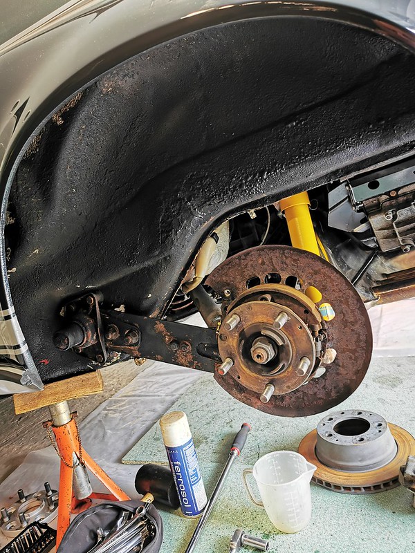

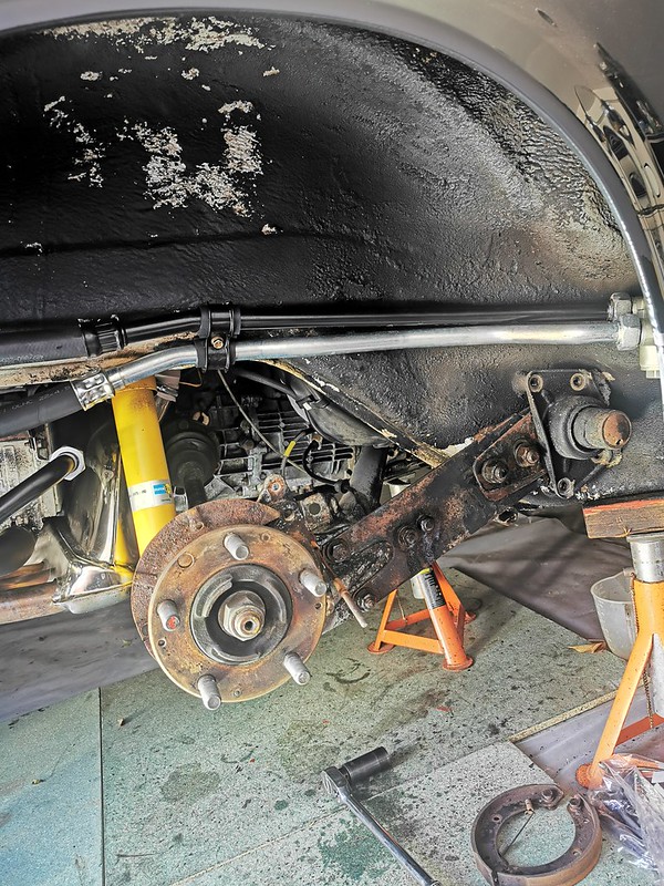

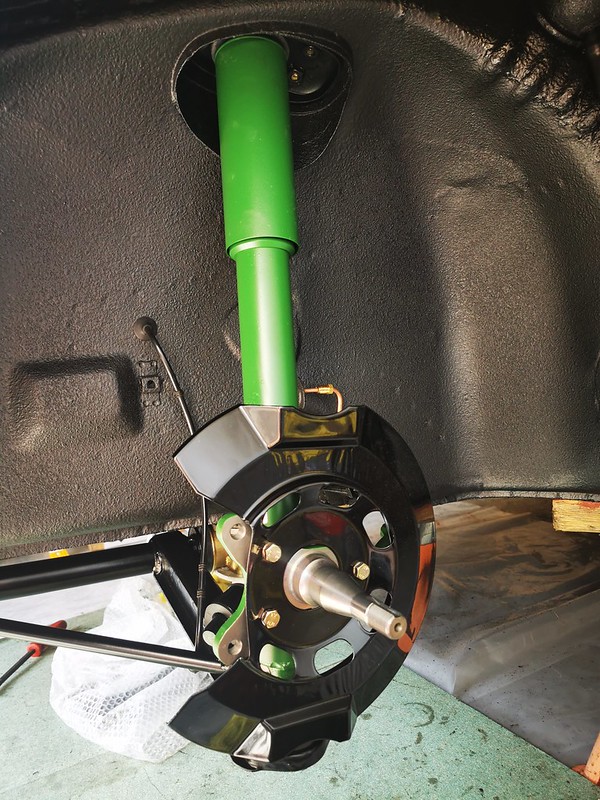

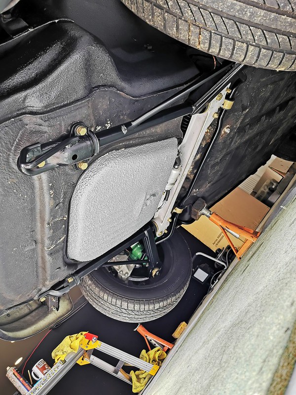

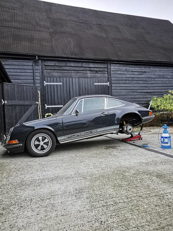

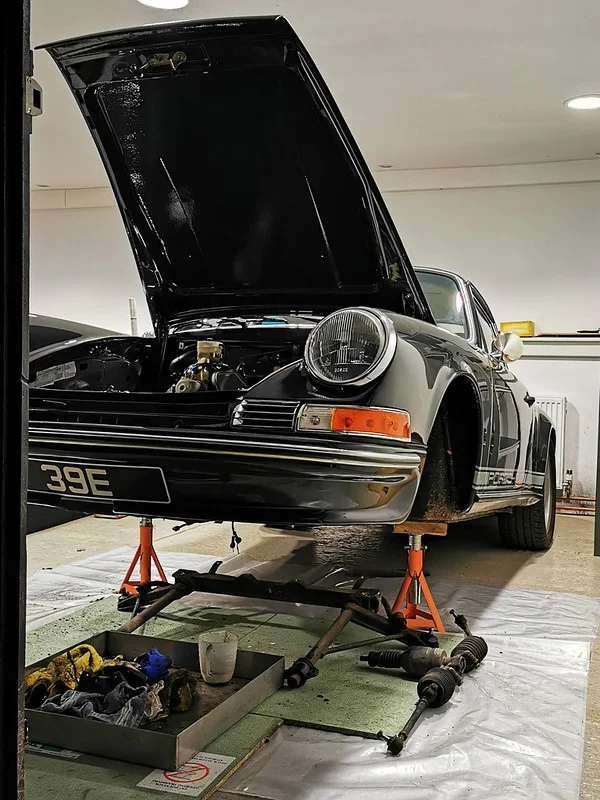

With that side of things finished it was time to get the car turned around and pull the rear suspension out, I was hoping that it wouldn't be that much work but knowing that the hand brake was only working on one wheel I didn't hold much hope. I took the car out of the garage so that i could clean out the rear wheel arches and wash off the leaking engine to make it easier to see where the oil leaks were coming from.
IMG_20200817_085453 by Scott Raven, on Flickr

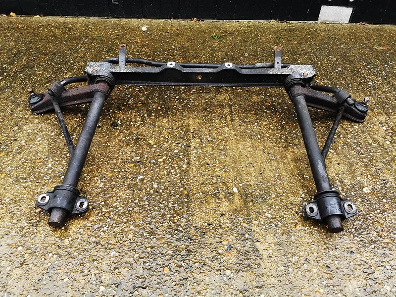

Once back in the garage the rear suspension was stripped down and removed along with the driveshafts and shocks, once stripped it was clear to see that it was all fucked, both hand brake cables needed replacing, hand brake linkages, disc backs, CV boots, roll bar drop links, etc and of course it all needed blasting and powder coating.
IMG_20200817_161846 by Scott Raven, on Flickr
IMG_20200822_144926 by Scott Raven, on Flickr
IMG_20200822_172548 by Scott Raven, on Flickr
IMG_20200817_173659 by Scott Raven, on Flickr
