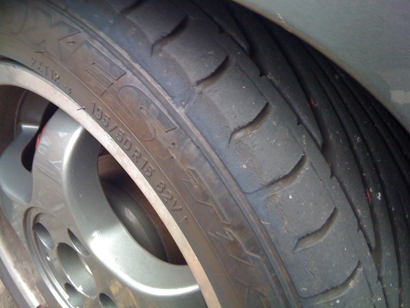

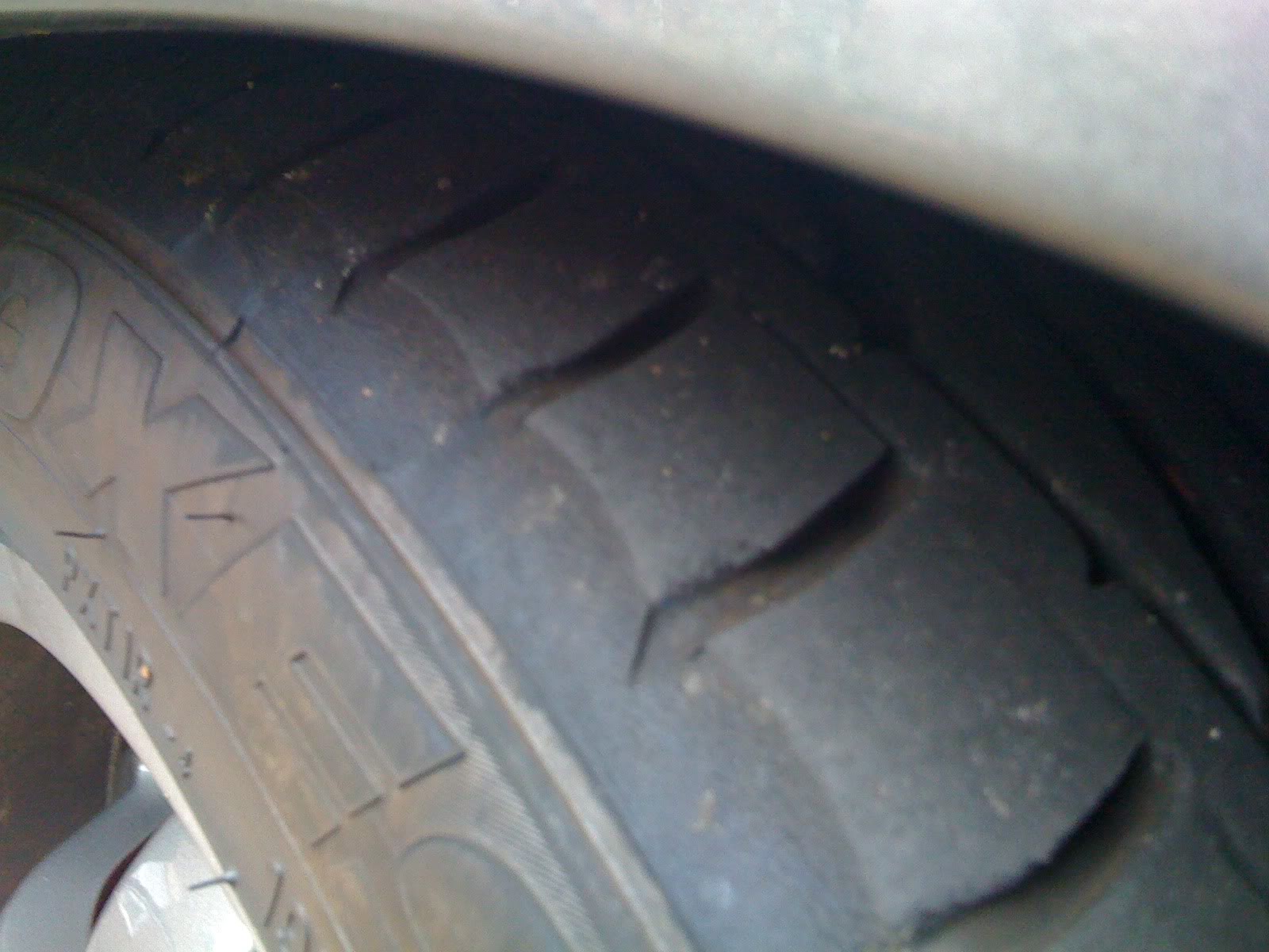

Maybe the photos are not great but you can see where there is more wear, any ideas as to why? This is on the front passenger side wheel and the others do not appear to be like this.
I was thinking perhaps that hooning around roundabouts a little bit fast was perhaps the issue?!
yep its just pushing it on corners that does it, mine are the same. T1-R's are common for it with them having a soft side wall there for rolling under on hard cornering. Stick a couple more psi in there if it bothers you
would i be right in saying that this sort of wear doenst really matter anyway? Isnt it the centre 3/4 of the wheel surface that is tested for minimal depth?
you'll never wear out that bit of your tyre before the center/edge of it unless you spend your life going round rb's. Its not badly worn at all in the pic tbh.
shud b ok 4 bit... just keep ur eye on it... if u start seeing like a canvas underneeth then get them changed lol
ner not for that in the slightest. I'd almost class that as the side wall.
Like I said stick a couple more psi in there, will help it stop from under steer too
looks like u get alot of flex in ur tyres from the pic... nxt tyres id invest in sum lower profiles 50% is alot
it'll be the roundabout thing;)
the Police can't do anything if they spot it (providing they're not otherwise illegal), but they'll know what you've been up to!
some tyres put up with it better than others
It's alright they're Toyo T1Rs. They only last about 10000 miles anyway. :approve:
10,000???? thats a lot on t1-r terms. Last set were gone after 2,000 ha but that was with raf marham ripping them to pieces. Otherwise they would of prob made 5,000
Or they are too wide and scratch the wheelhouse. But then it should be on both sides unless your car is bit assymetric ;)
