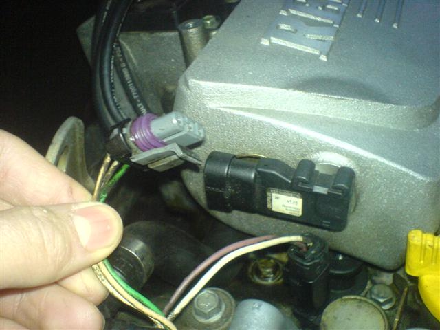

omg just checked under the engine and i found this cable unplugged wtf!!!!
Plugged it back in, took it for a 5 min drive didnt notice any difference the noise is still there. I couldnt hear the noise at idle only after i go over around 30mph, after which its constant!!!

bump, any other ideas to what the nosie could be and what the hell is the cable thats unplugged! probably a sensor but would still like to know.
Thanks
that is the map sensor..... the car was running in basic fueling mode with that disconnected.
take the battery off for 20 mins.... make sure the map is reconnected and restat..
leave to idle for a few mins
that will reset the basic fueling parameters.
