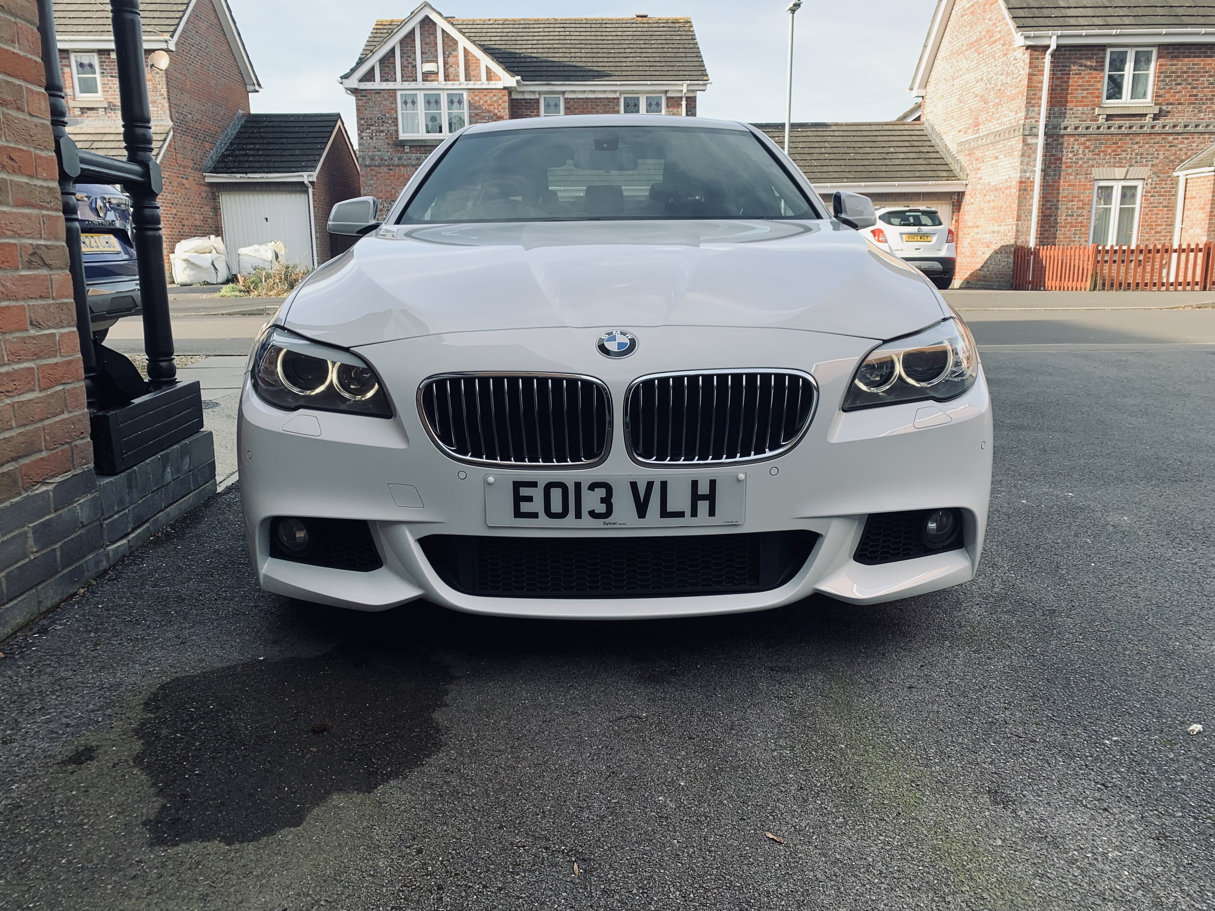

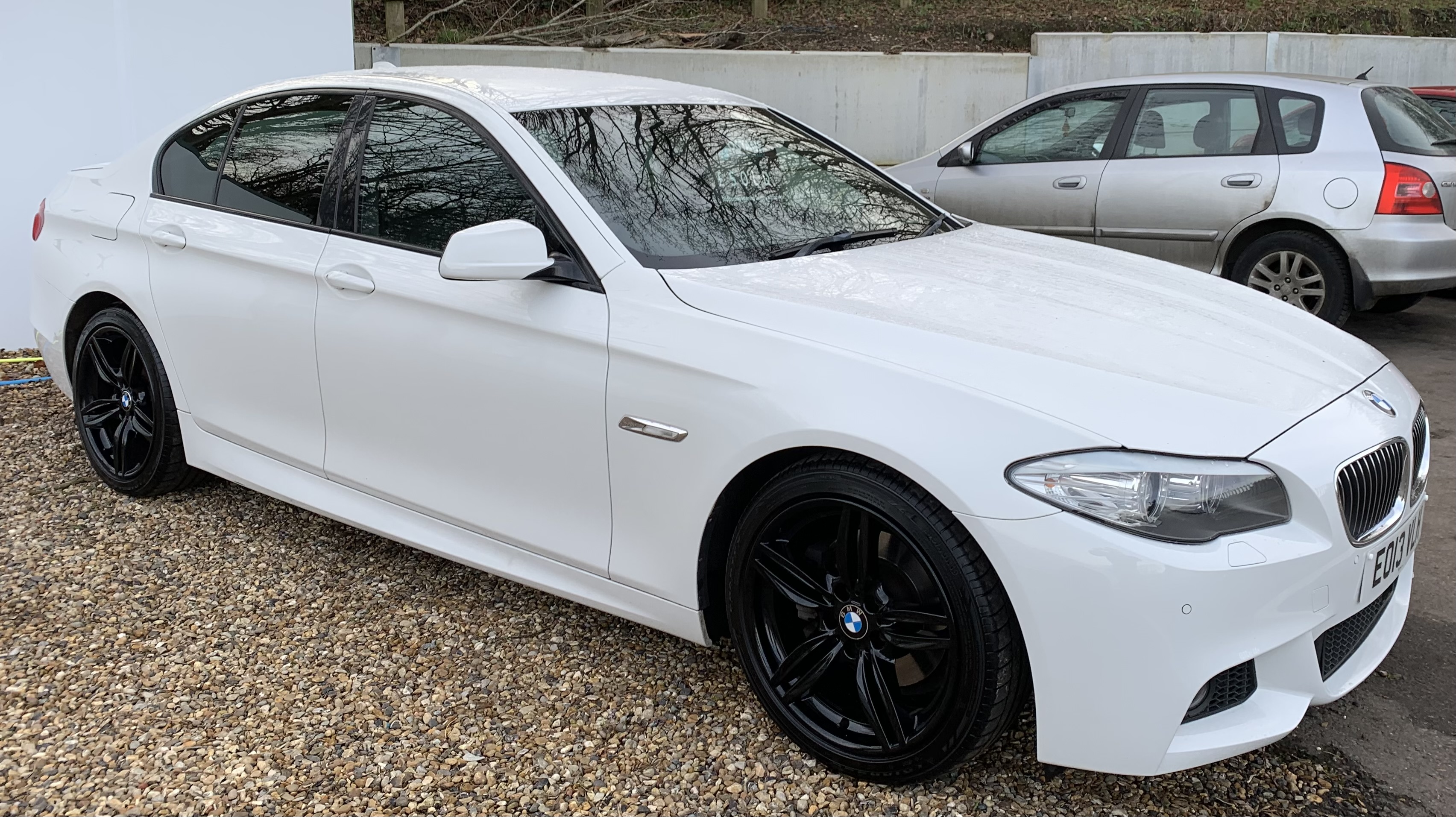

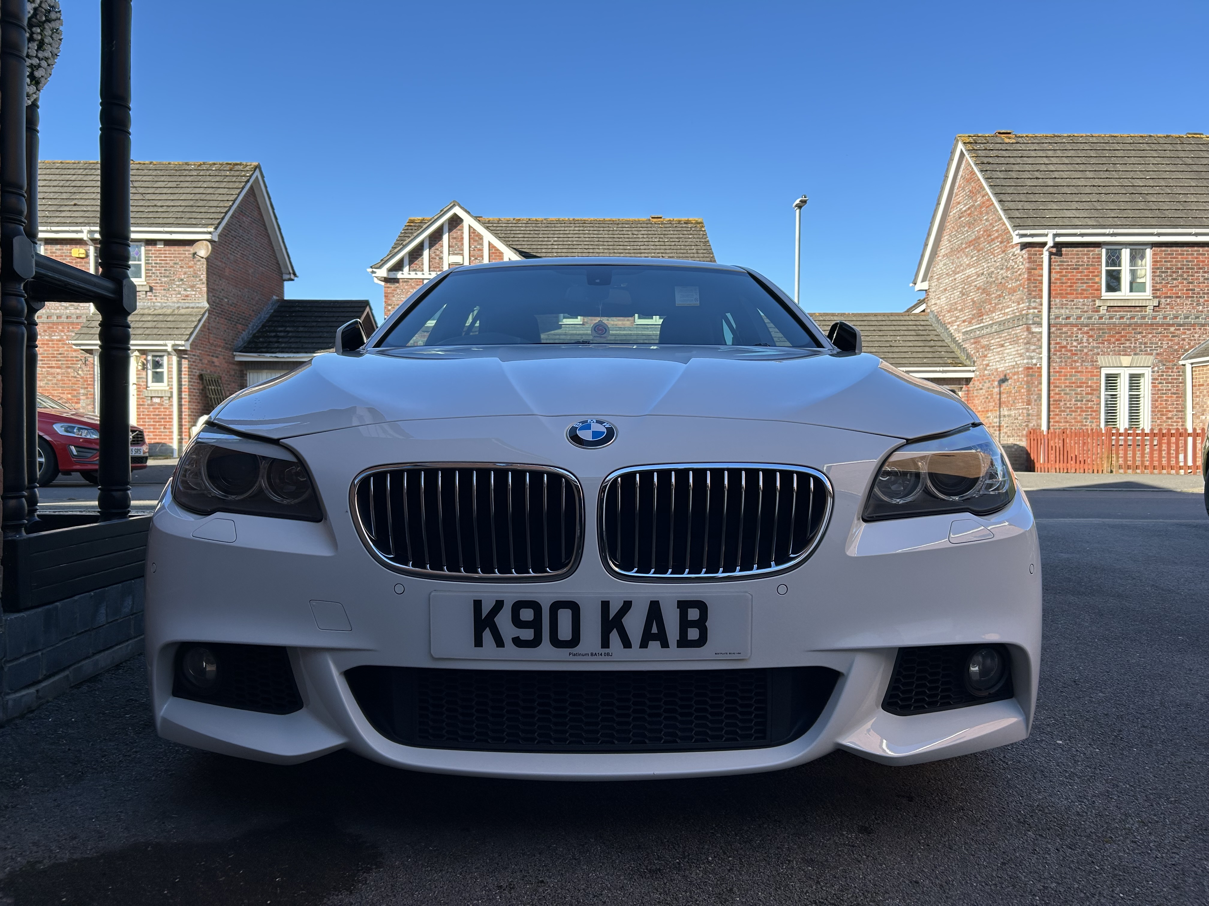

Anyhow, stumbled across a lovely 520d with decent spec, wheels just powder coated, new MOT and a fully stamped and up to date service record. Annoyingly it was 170 miles away. Placed a deposit and headed over to collect.
On arrival the car was presented it absolutely immaculate condition and i had no hesitation bringing it back with me.

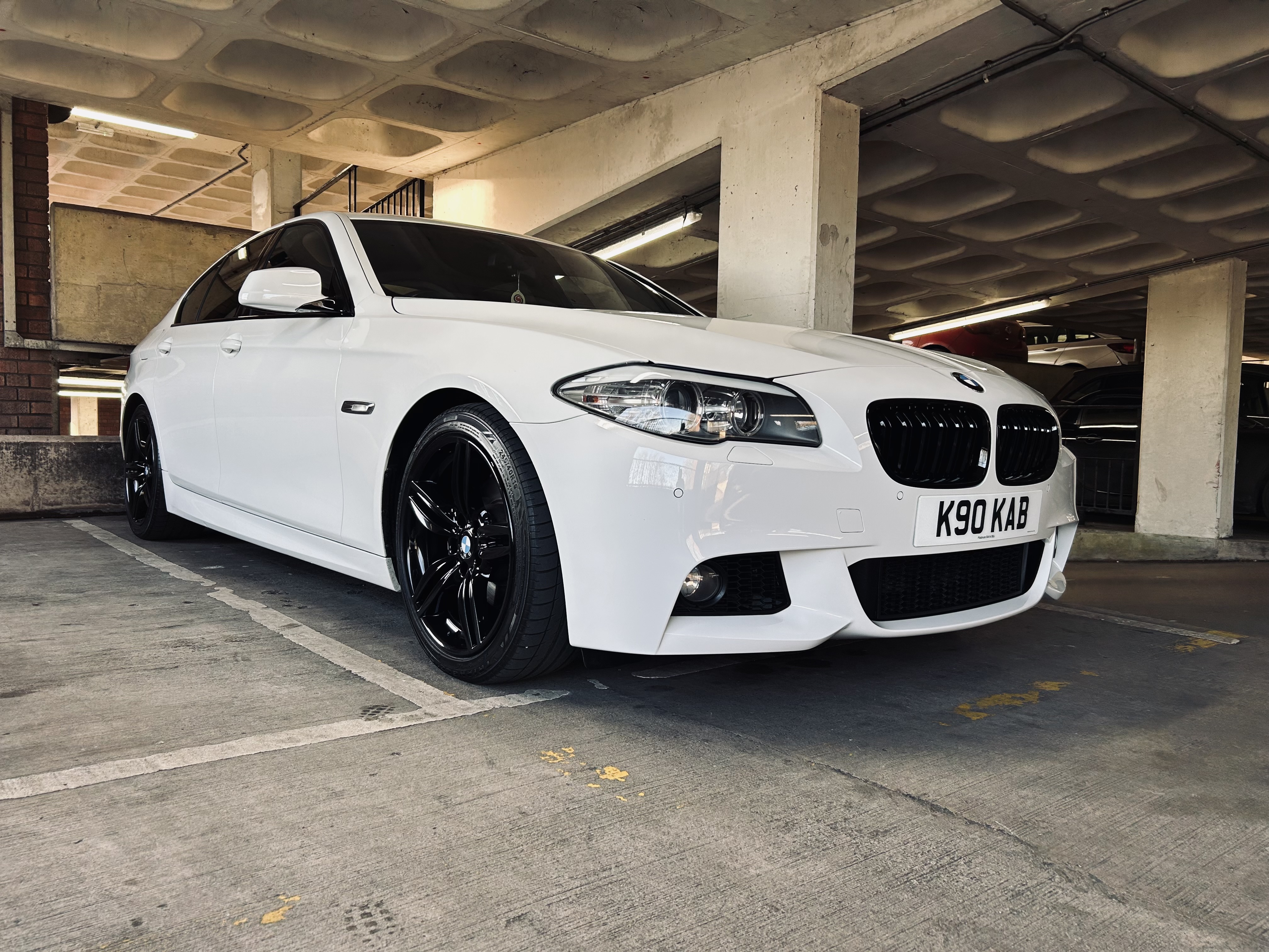

Pics on collection day, Feb this year.

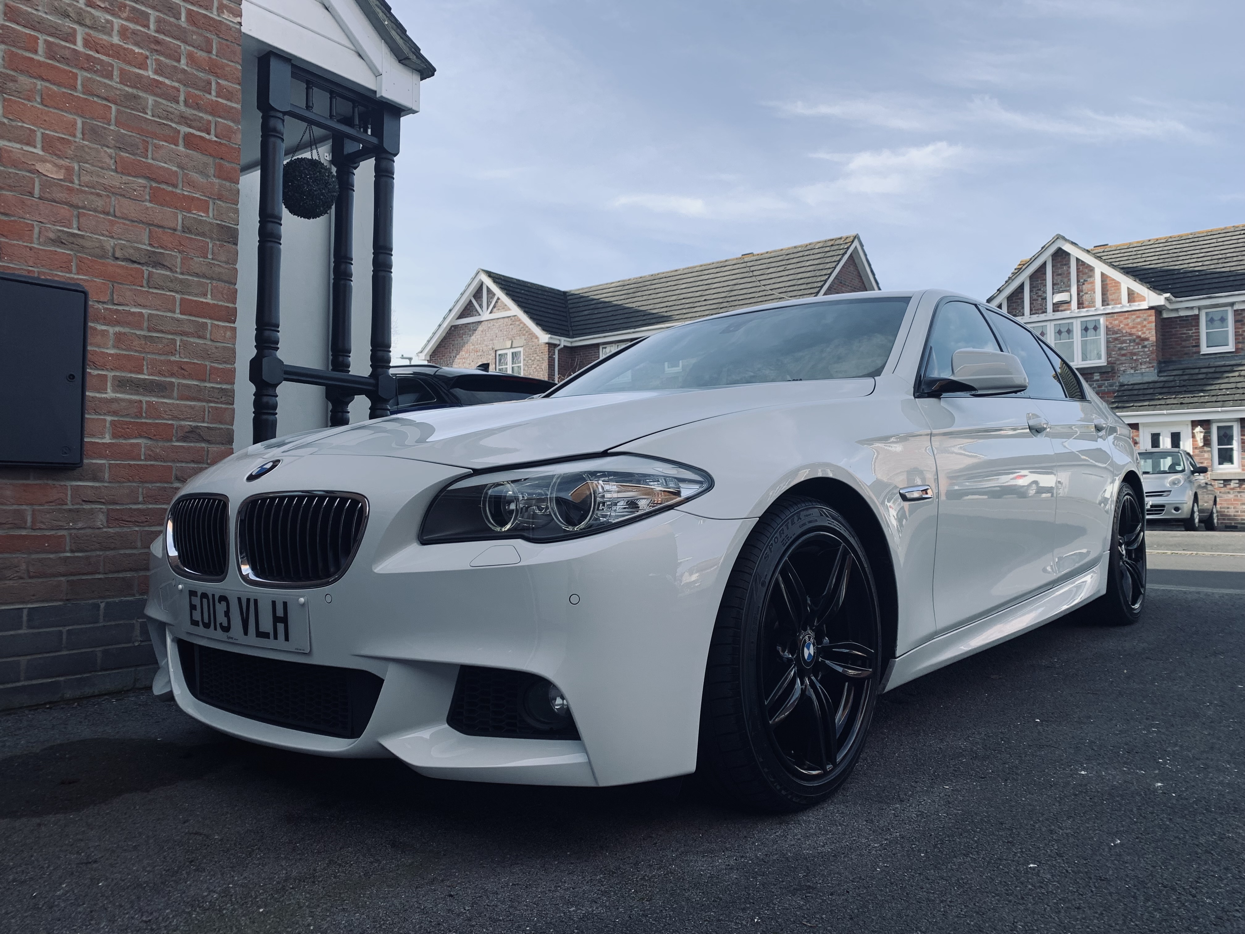

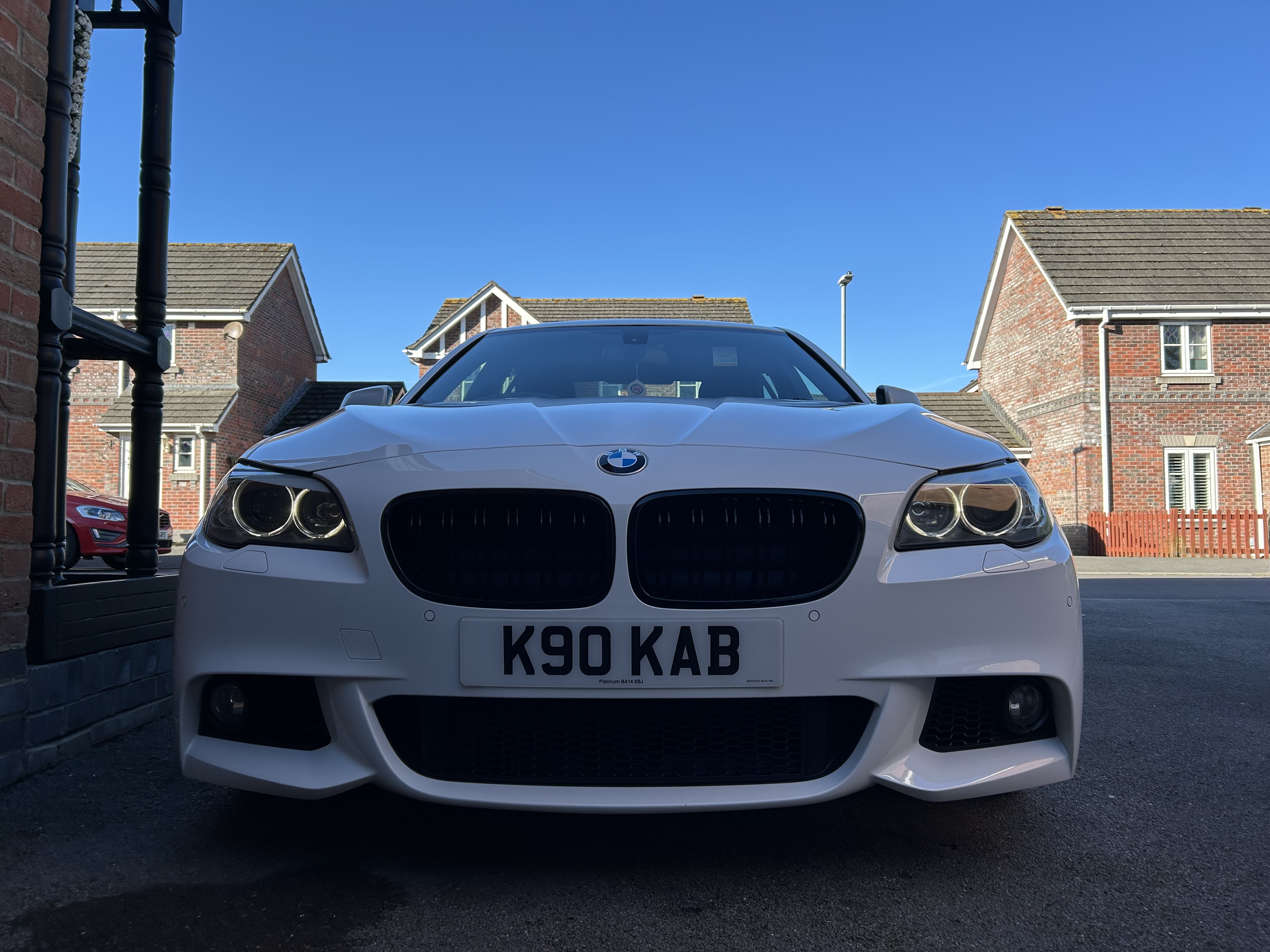

Next day i gave it a quick wash to put my mark on it.
Shame about the dog s**t tyres, as new though and drive fine on them.

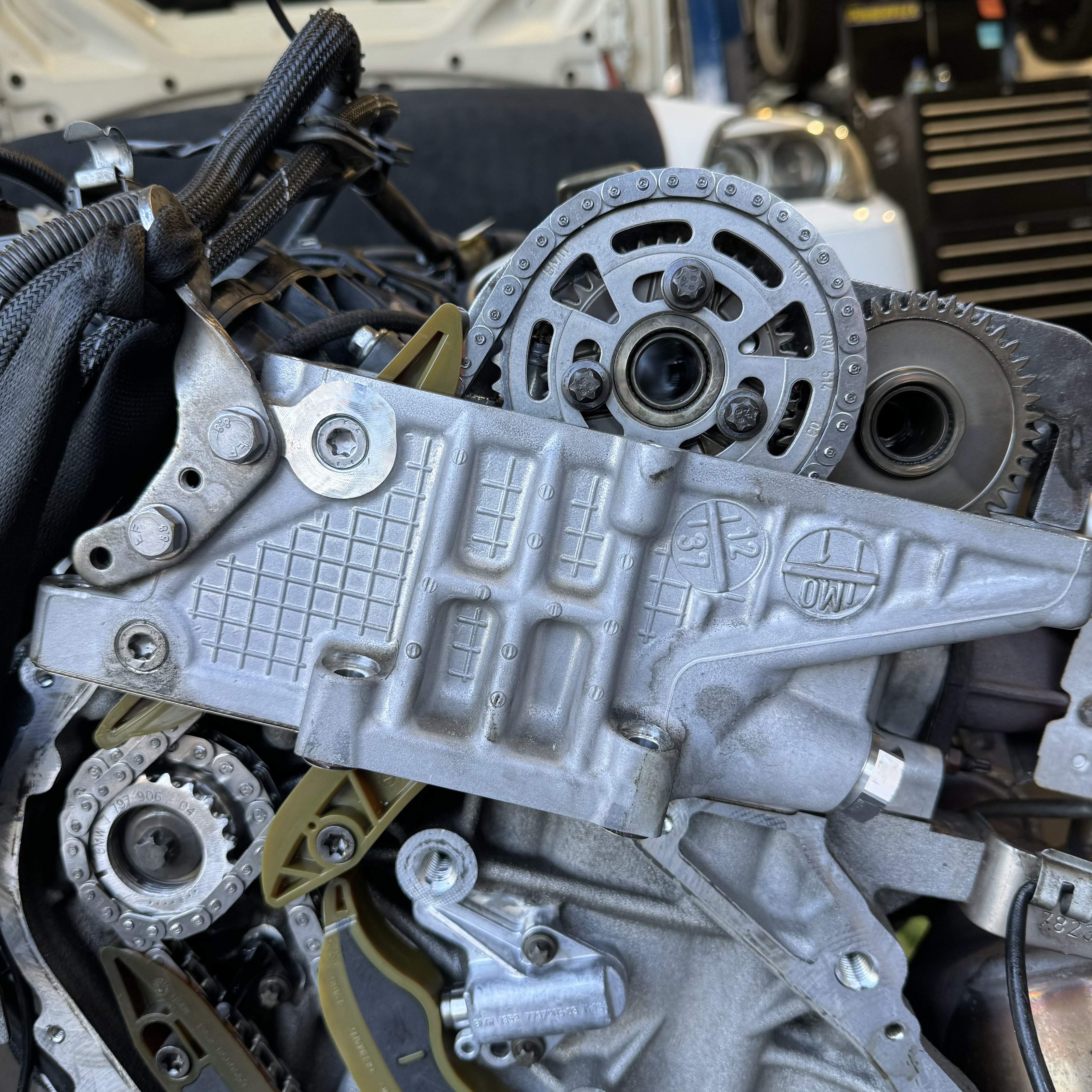

Get a call half way through when they had the rocker cover off and i knew what was coming, Mr Bailey, your timing chain is loose af 😂 they wanted £2,000 to do the job. Not a chance i was paying that!

Big big fan of these in PFL. I hate black wheels but other than that, Sterling chariot. 👌🏽

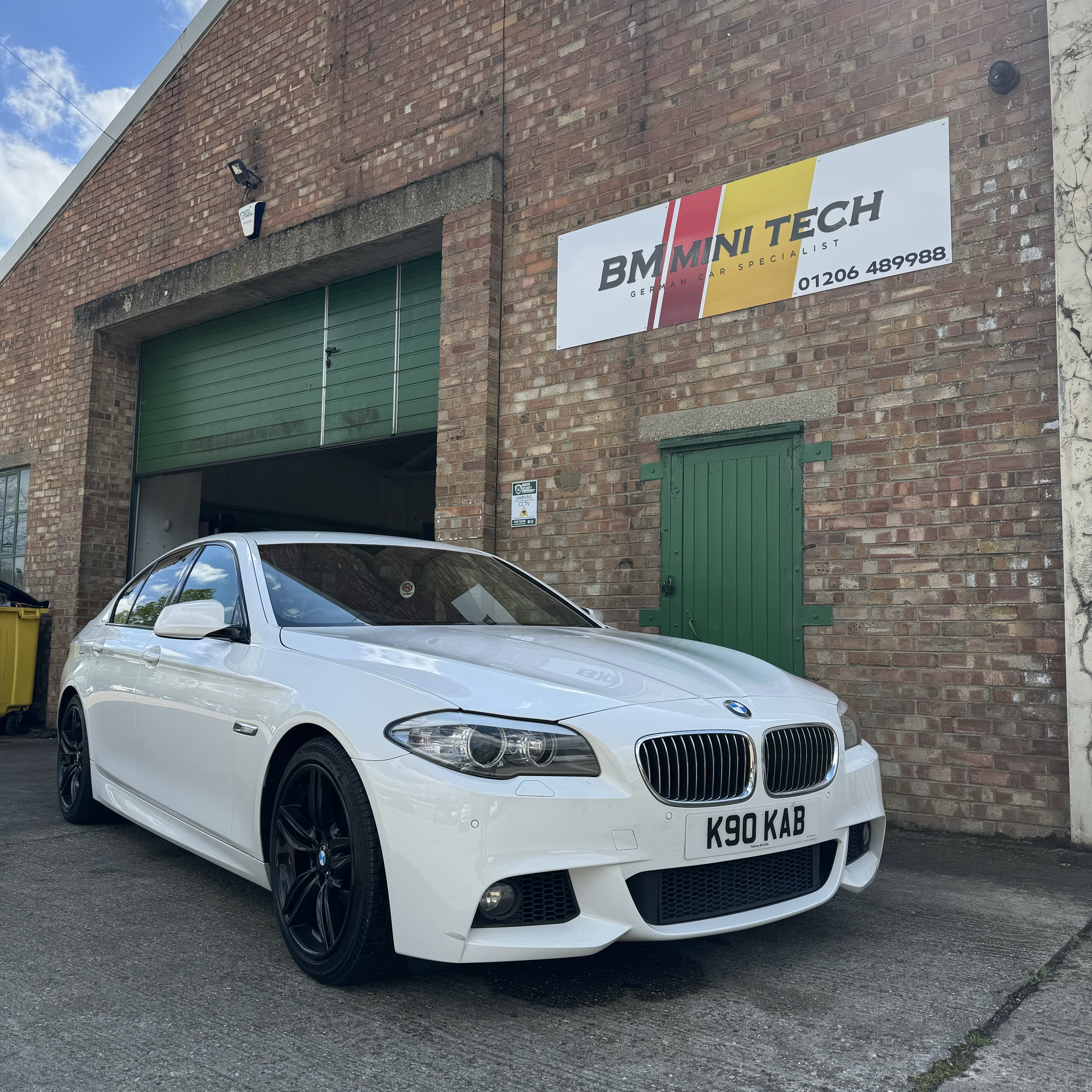

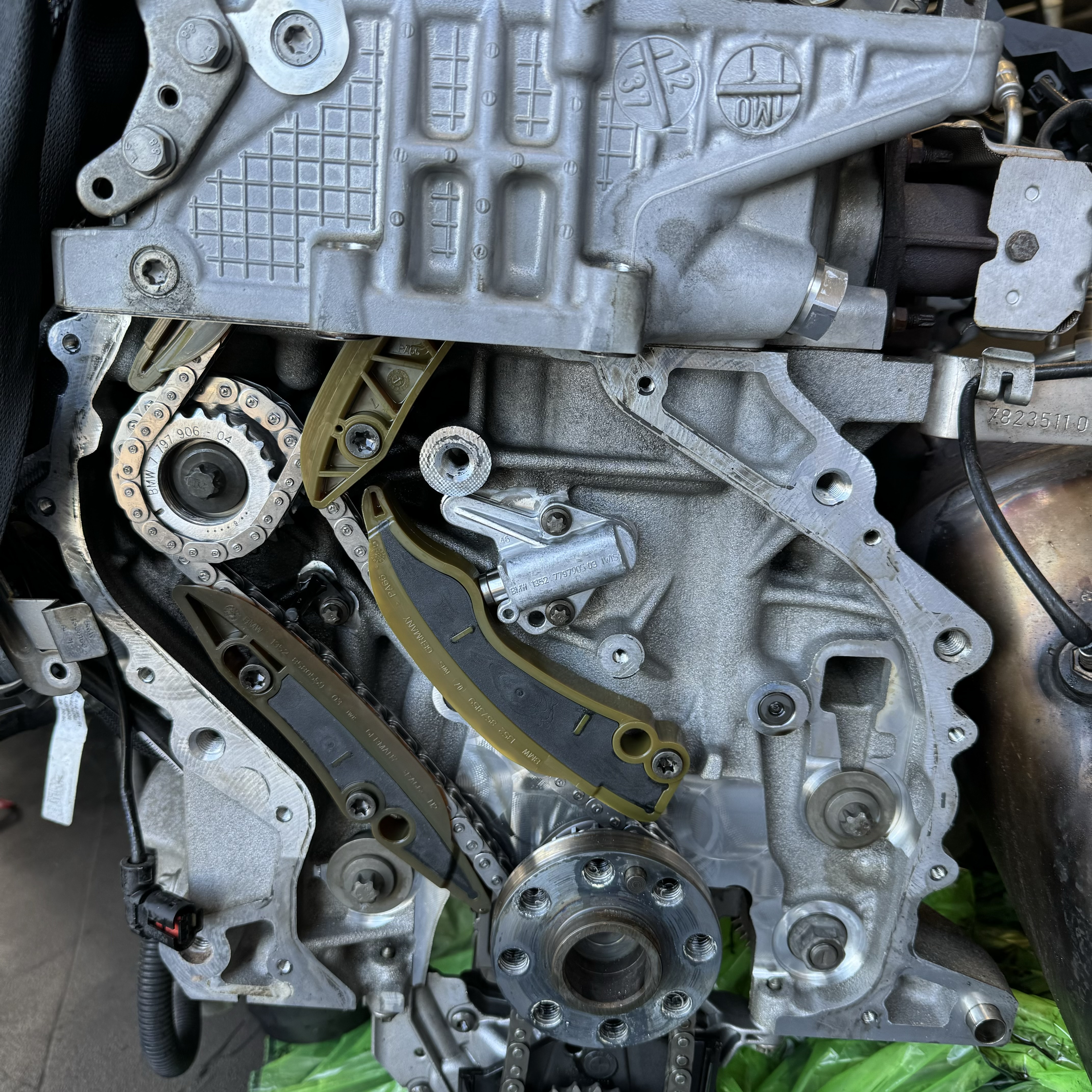

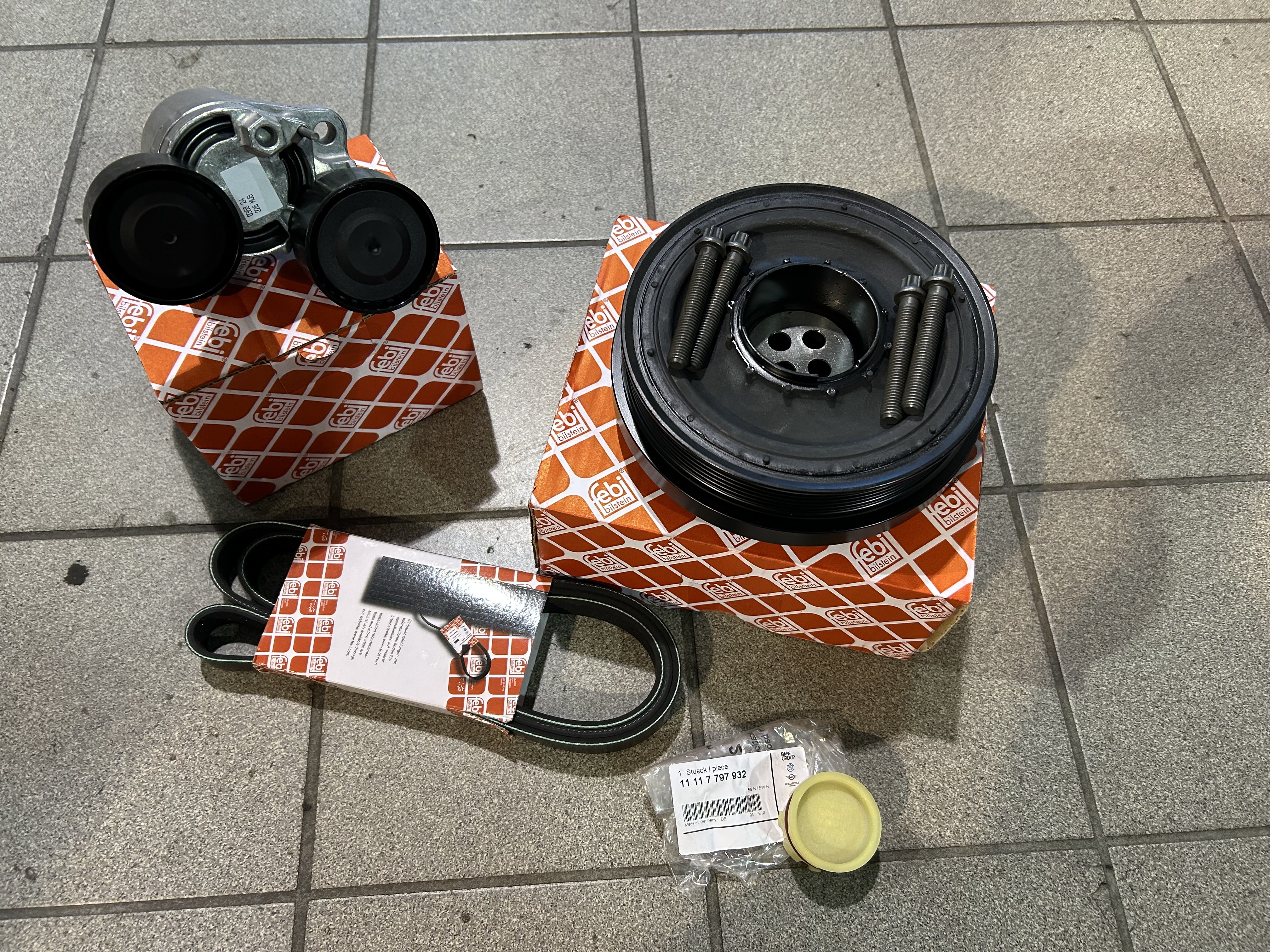

After some research i booked in with BMMINI TECH in Colchester!

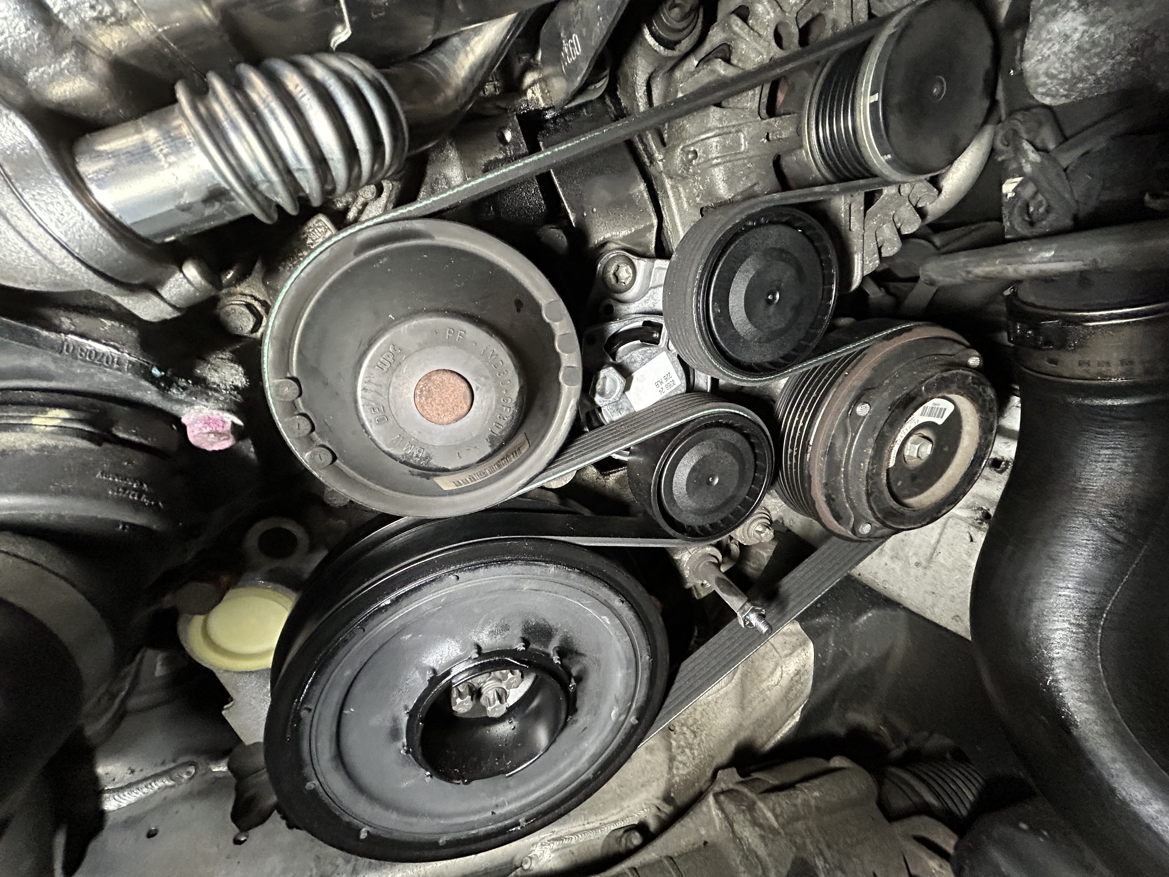

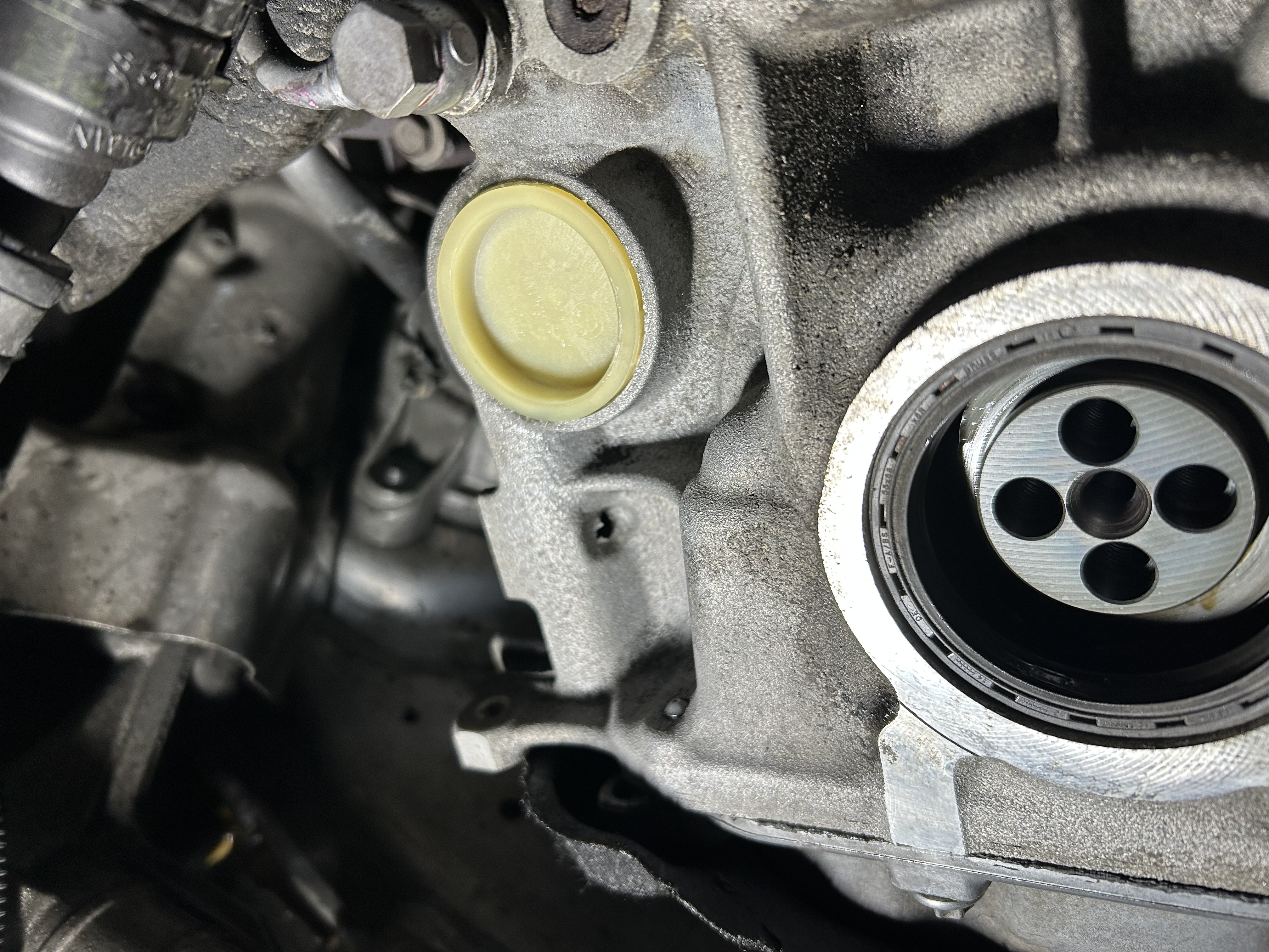

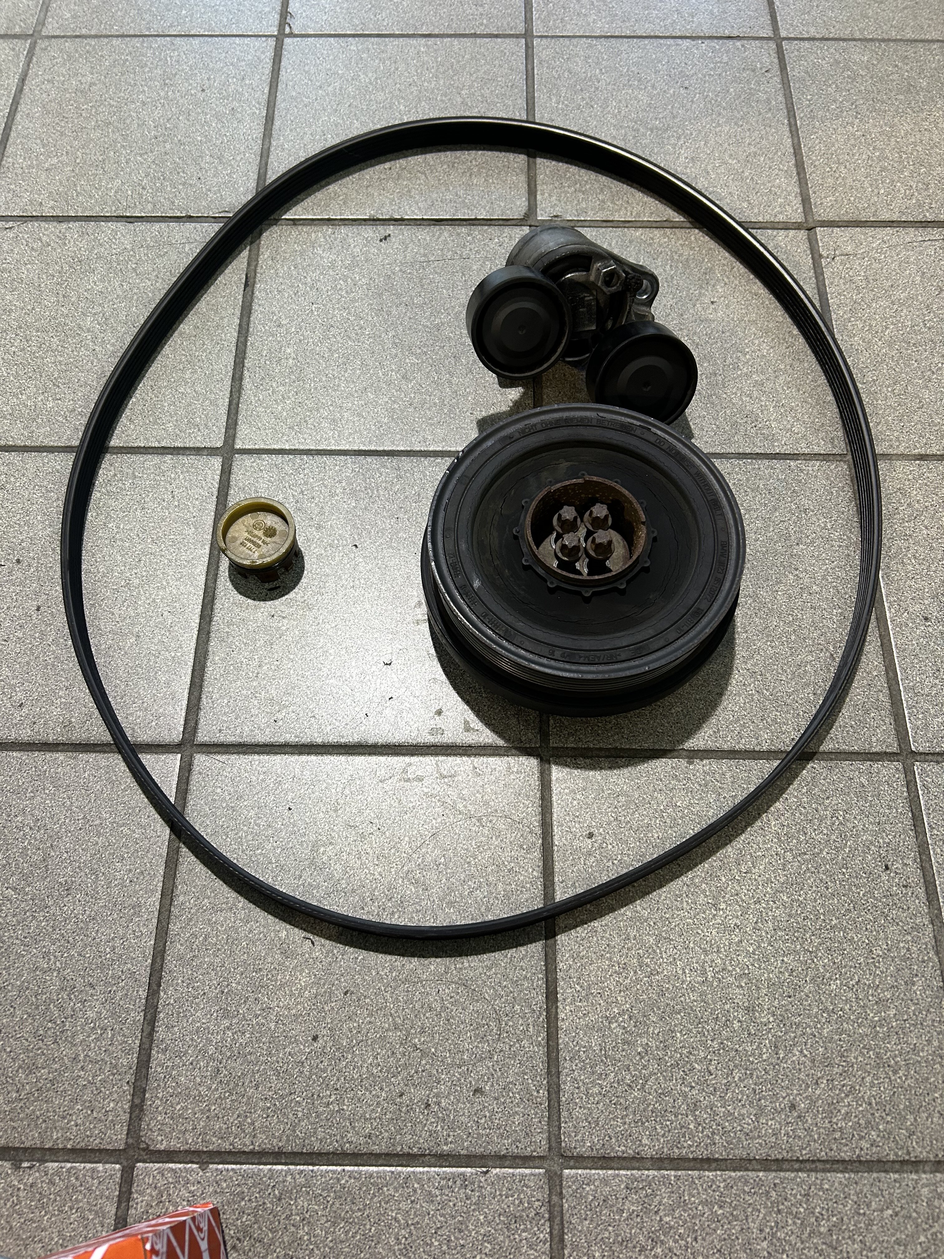

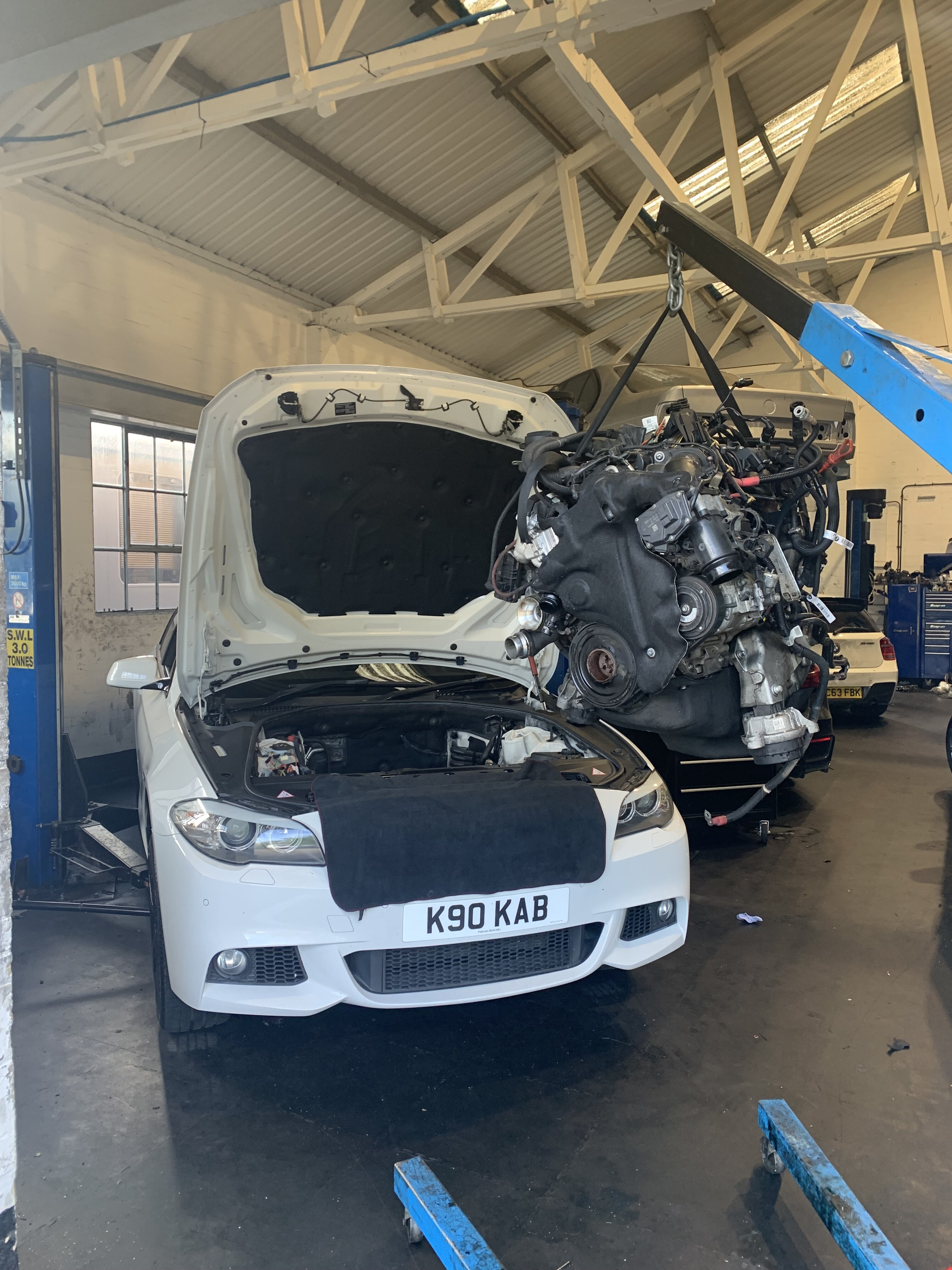

200 miles each way, i arrived there at 7:45am. The car went in at 8am and by 8:40 the engine was out, never seen anything like it!
Matt Cup
  Leon Cupra

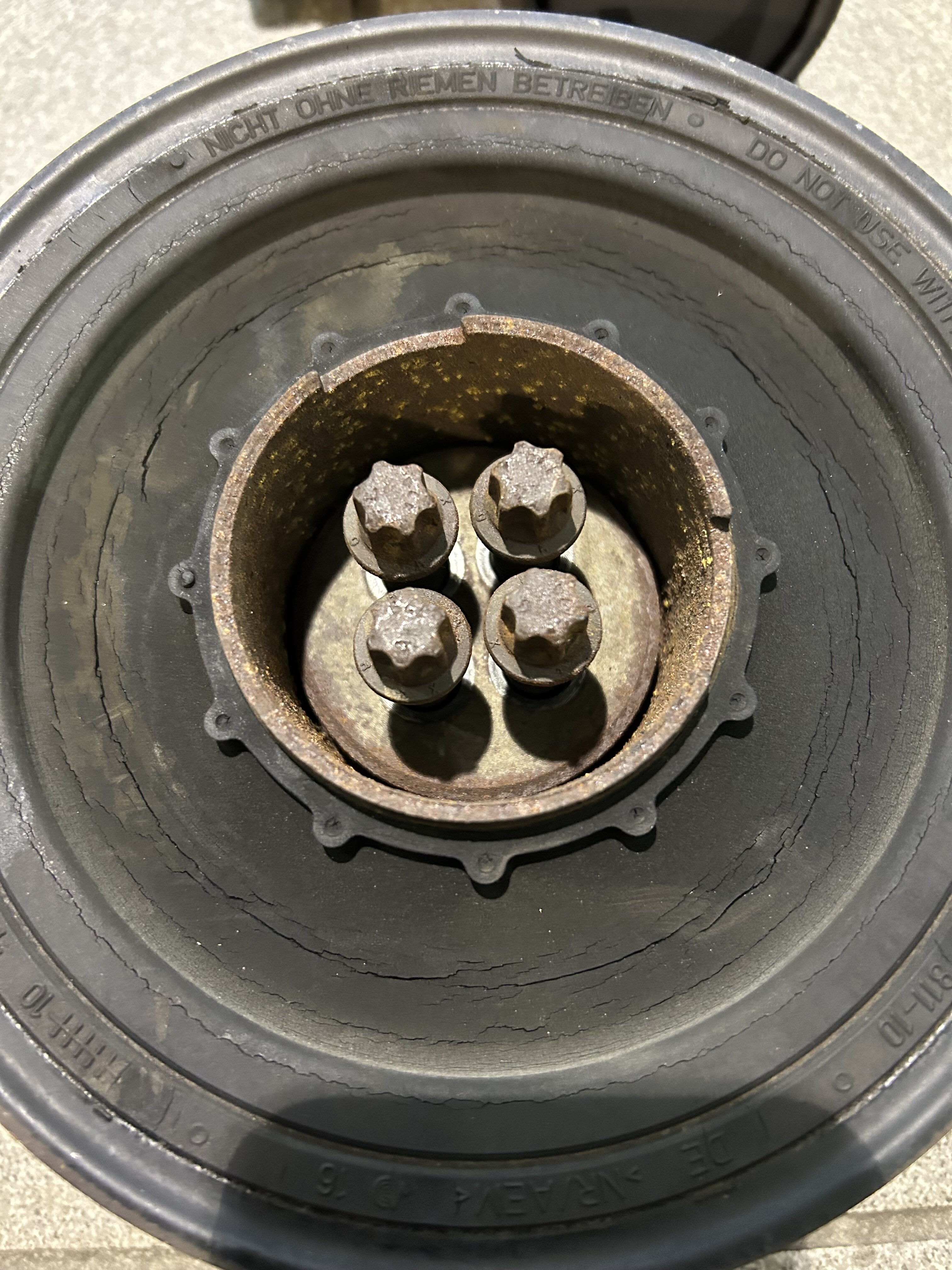

The difference before and after is staggering. Can’t believe how sloppy that chain was without it actually failing.
Alastair.
  986'S 172ph1+182FF

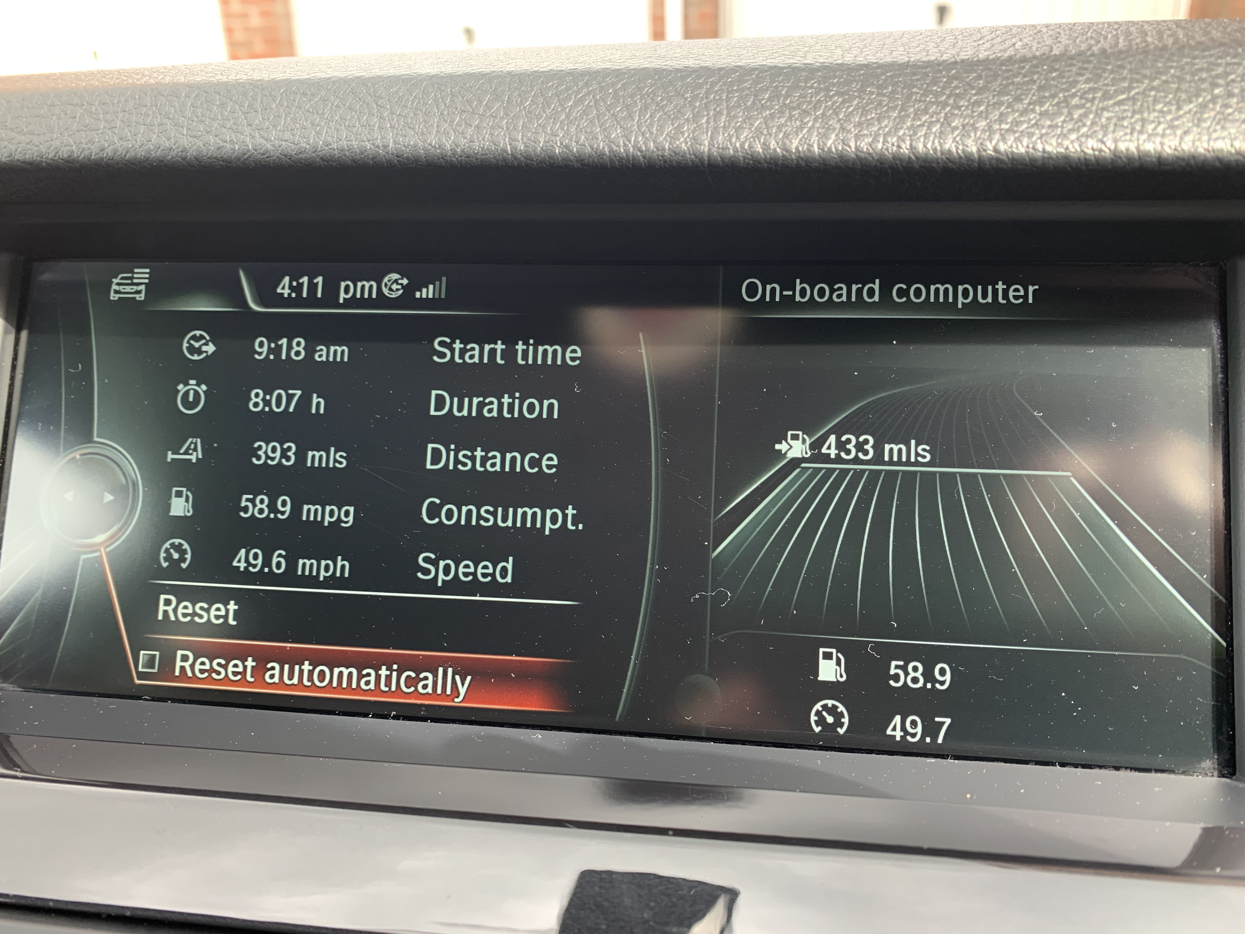

All this done and i was back on the road before 12:30, absolutely staggering!

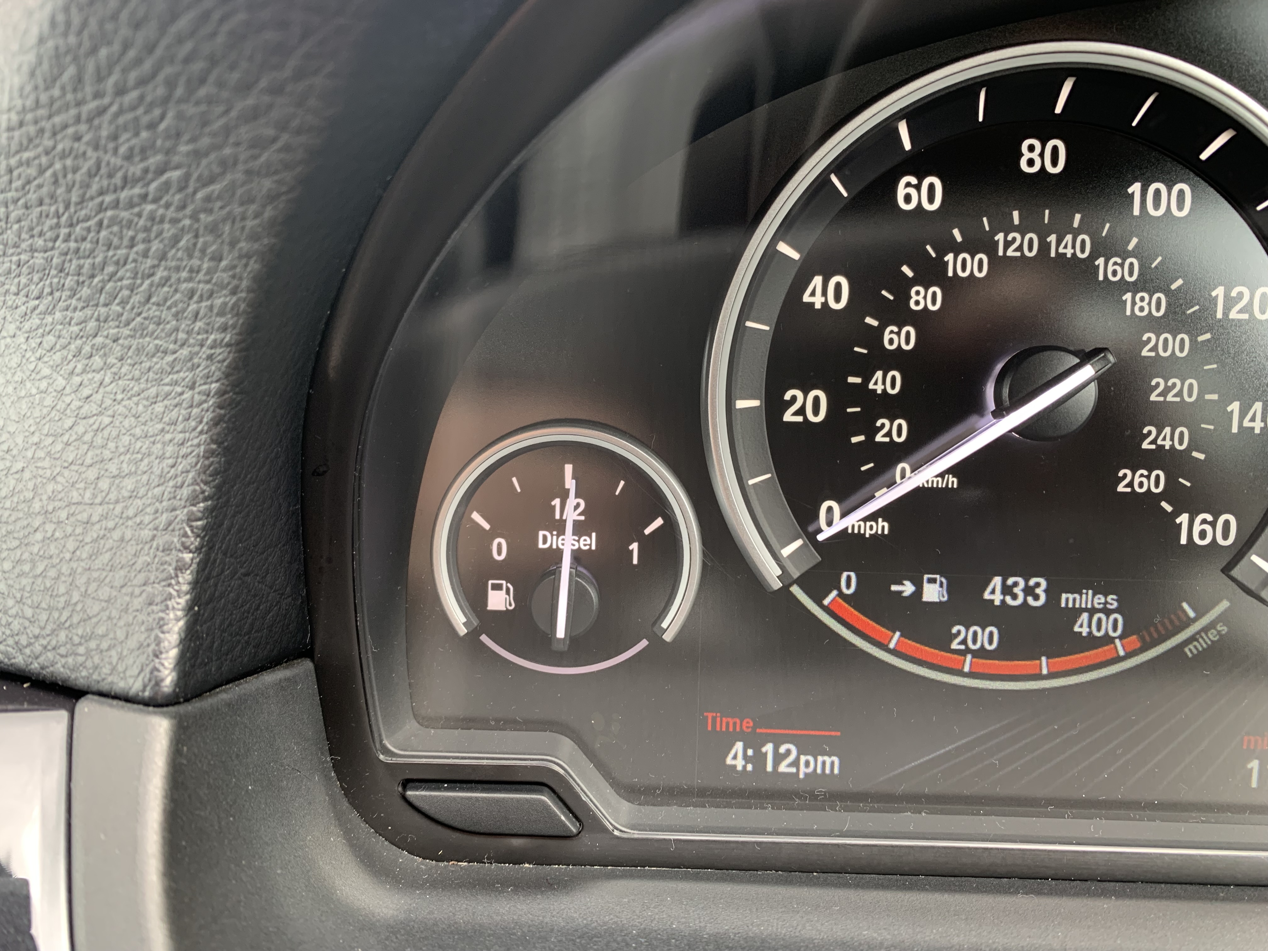

Nearly 400 miles, left on a full tank, just over half left.
Drives absolutely mint, no issues with any of the work they have done and i am one fussy b*****d.

That looks great in white, even with the black wheels. All the big jobs sorted straight away as well👌

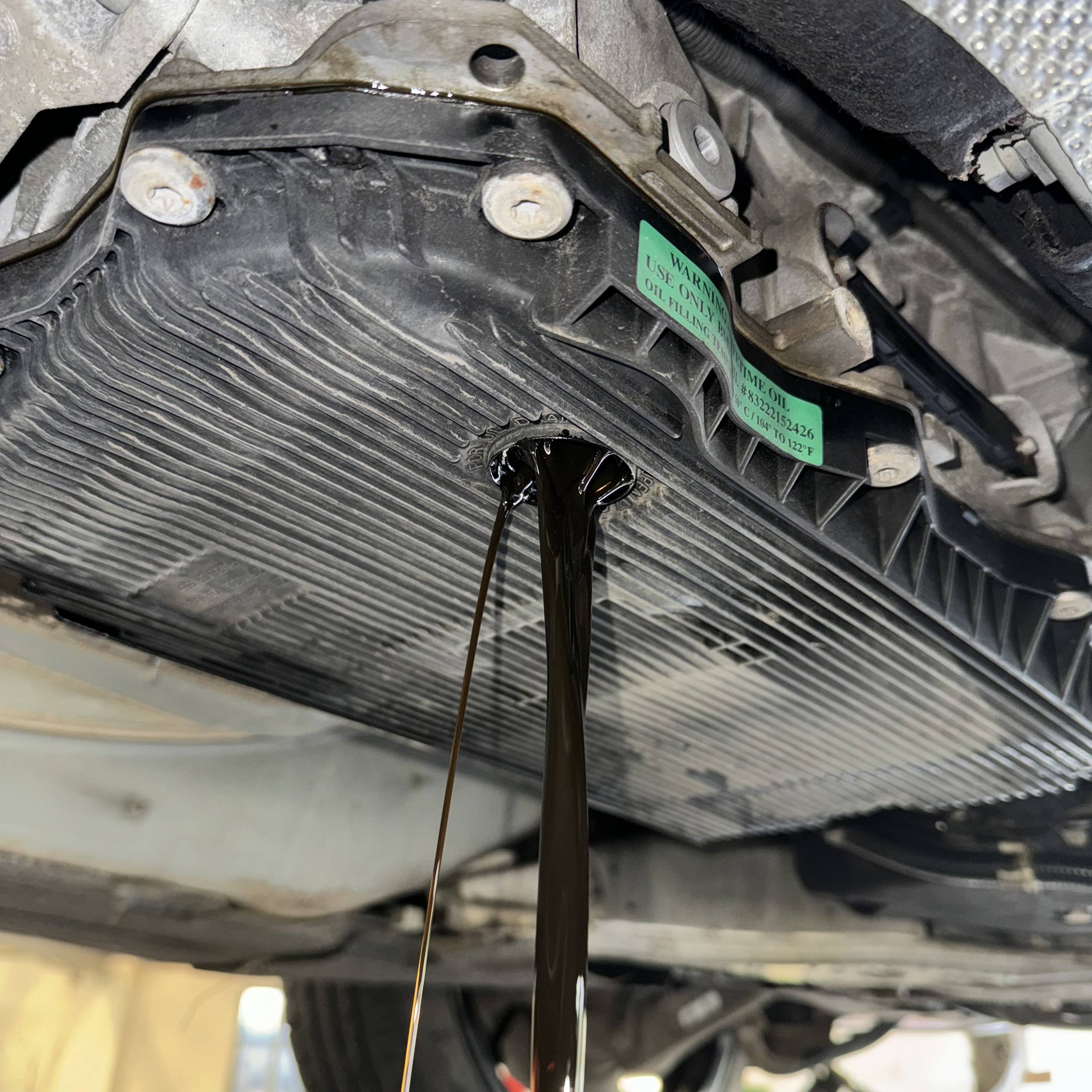

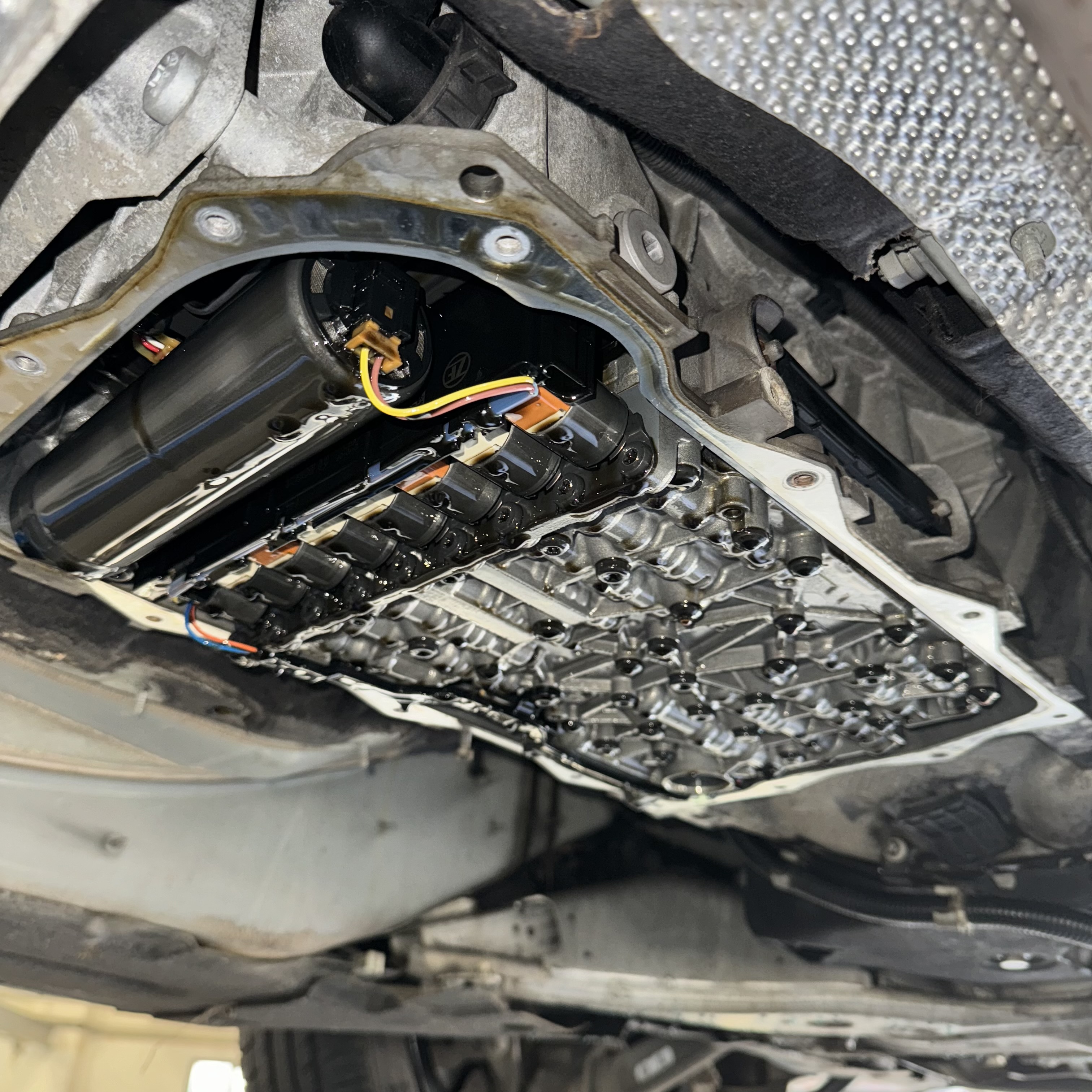

N47 timing chain, all genuine parts, new oil, oil filter and air con regas is £1,099 inc vat

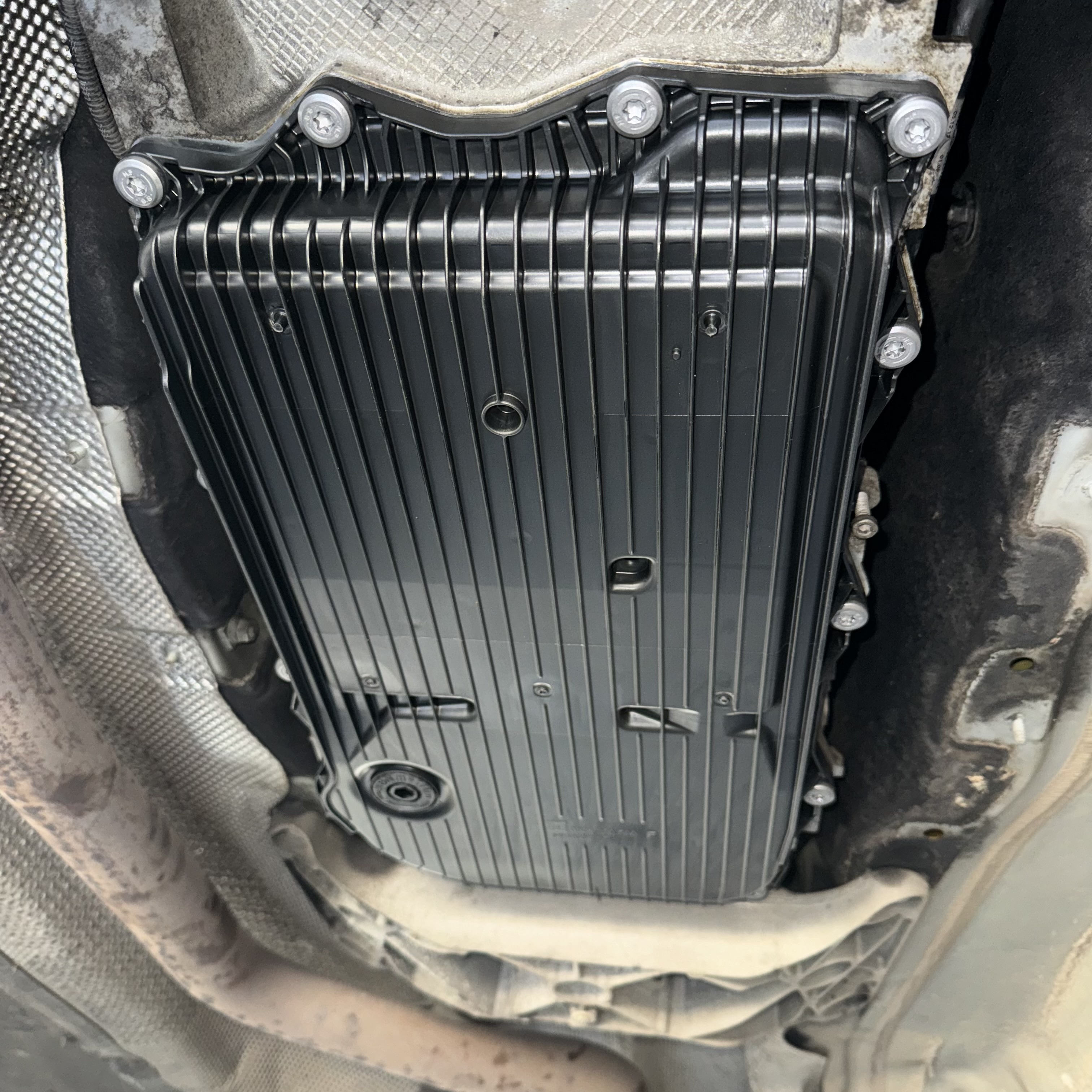

Gearbox service was £449

One chap
Including vat??? f**k Me. No wonder they do so many.
Sorry to keep asking questions, but this is blowing my mind. How many of them worked on it
One chap on his own did the whole thing, drove it in at 8am, into the waiting area, 8:30 thought id go get some fresh air and the engine crane was attached, walked back in 10 mins later and it was out.
Bloody magicians
All come from a BMW dealer background, guy who owns the place was a master tech at BMW for many years.

Was the chain rattling?
I do like an F10
Nope, no rattles, engine was silent. They said some rattle real bad and some are really quiet like mine. Some snap on 50k some 150k, just never know when they're gunna go they said.

I can vouch that the engines on these come out a piece of piss. Only 2 mounts on the engine, drop the box support so the whole lot can swing, disconnect the coolant and fuel lines and yark the c**t out. Only about 8 bolts to undo in total.
There’s plenty of space in the bay with the 3.0 in there so there’ll be s**t loads with the 2.0. Still a very impressive effort.

Good old N47, amazing it hadn't snapped yet being so loose, but a great result with garage contributing to having it replaced, massive win! (y)
Very surprised that wasn't rattling it's tits off but at least you've sorted it for many more trouble free miles.
Very envious of the mpg, I can only dream of that in my X5!

Nice buy, also dislike black wheels but lovely bus! Great news on the peace of mind work carried out!
