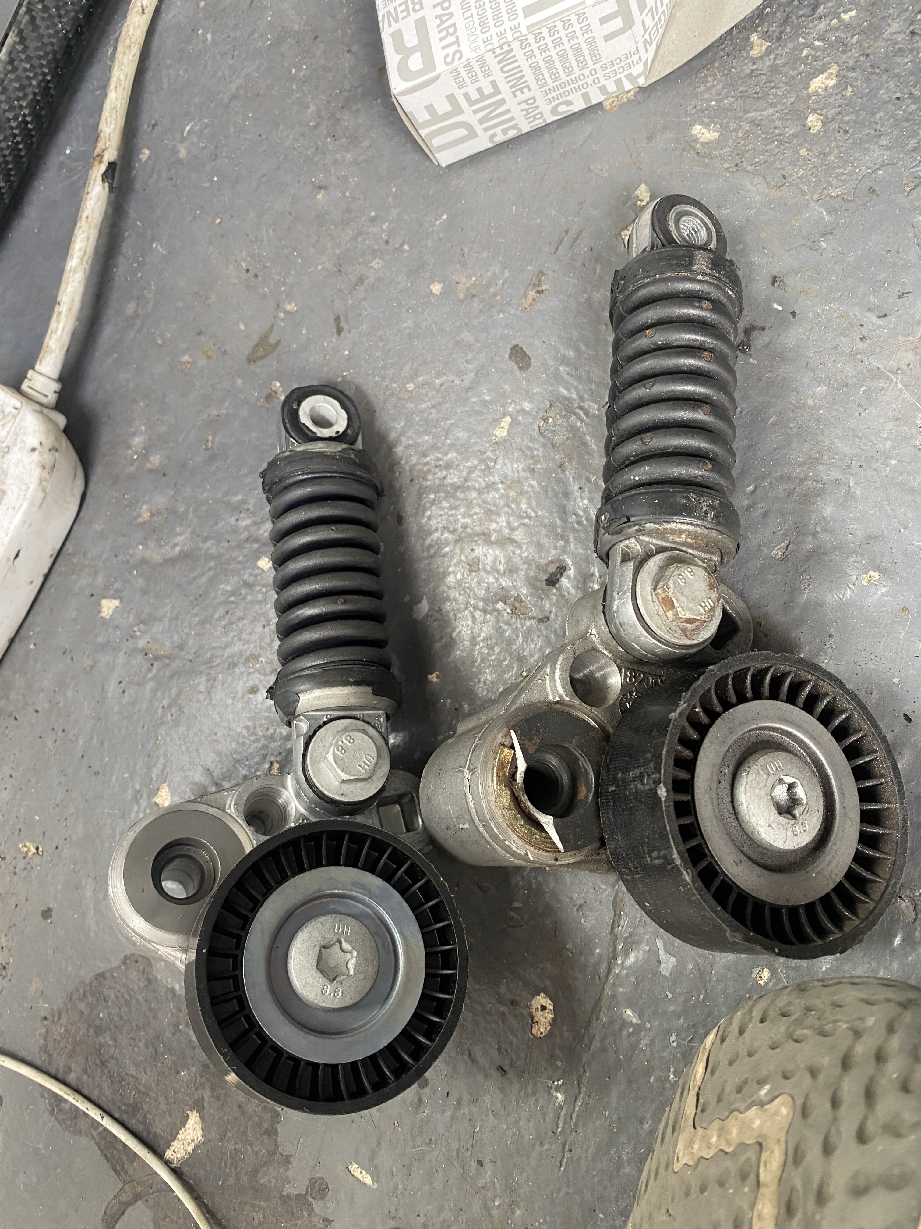

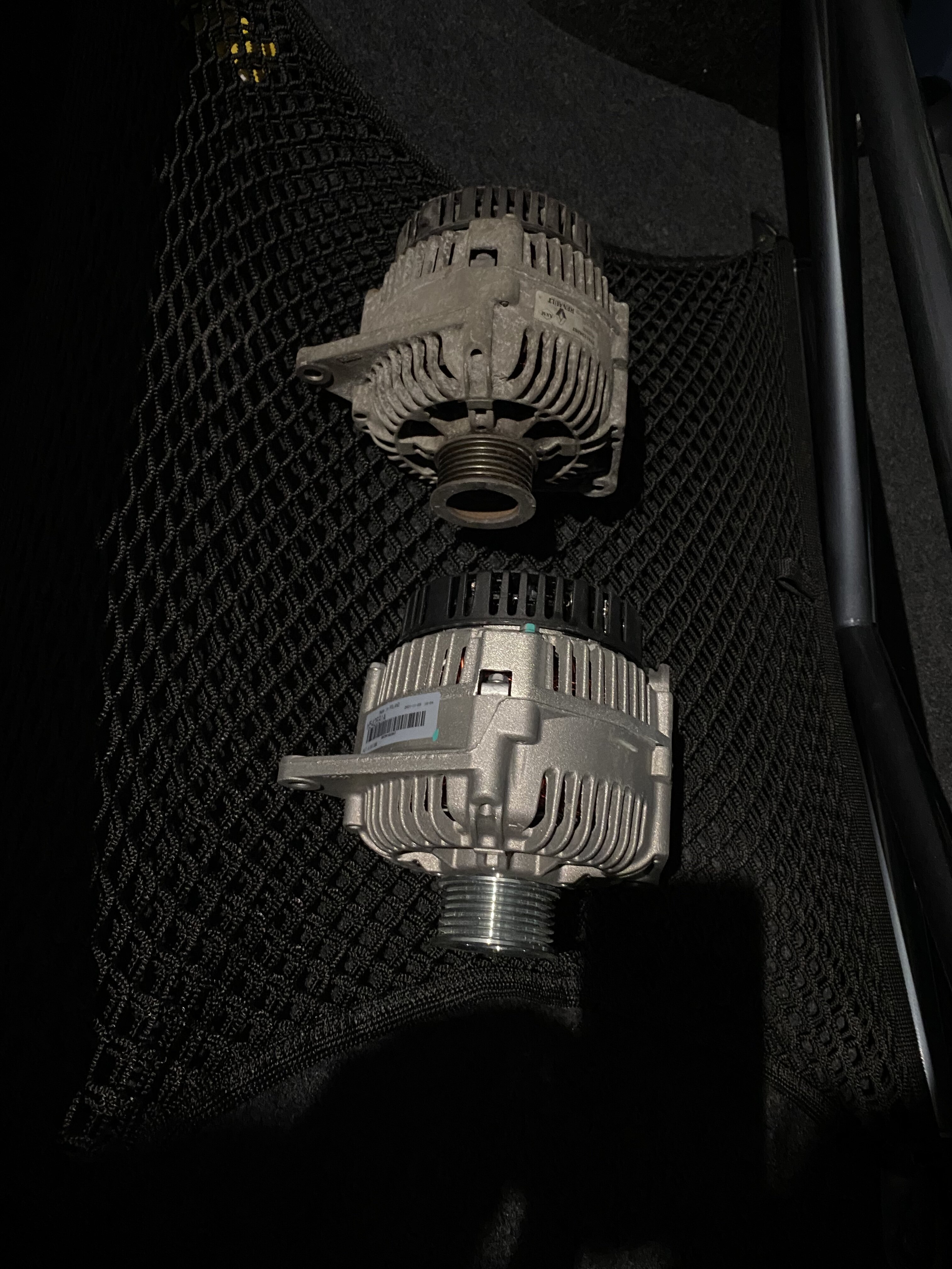

Well what a palaver that was from start to near finish….So as detailed above I ordered a new Valeo alternator from autodoc. It arrived as described in a Valeo box and was spot on.

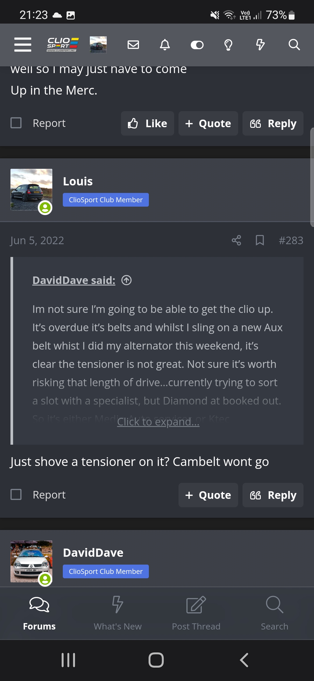

Now my car is due it’s belts service (on time) however I plan to get it booked in at the end of the summer, when my wife is back from maternity leave. So as a temporary solution I fitted a new Aux belt whilst fitting the alternator…now here is where it gets fun…the new belt fitted, alternator back on. Started car and everything was cushty….that was until I turned the wheel on full lock at which point the tensioner spring rubbed the belt.

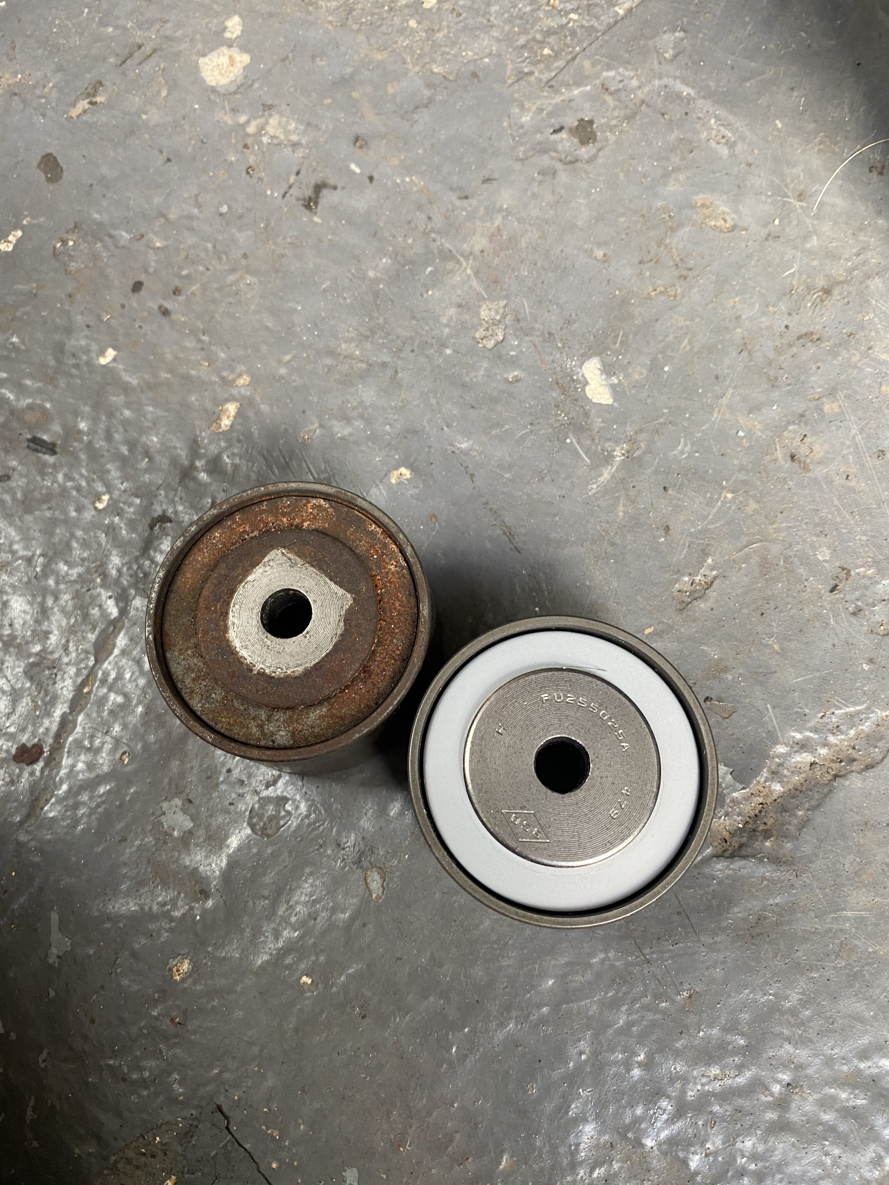

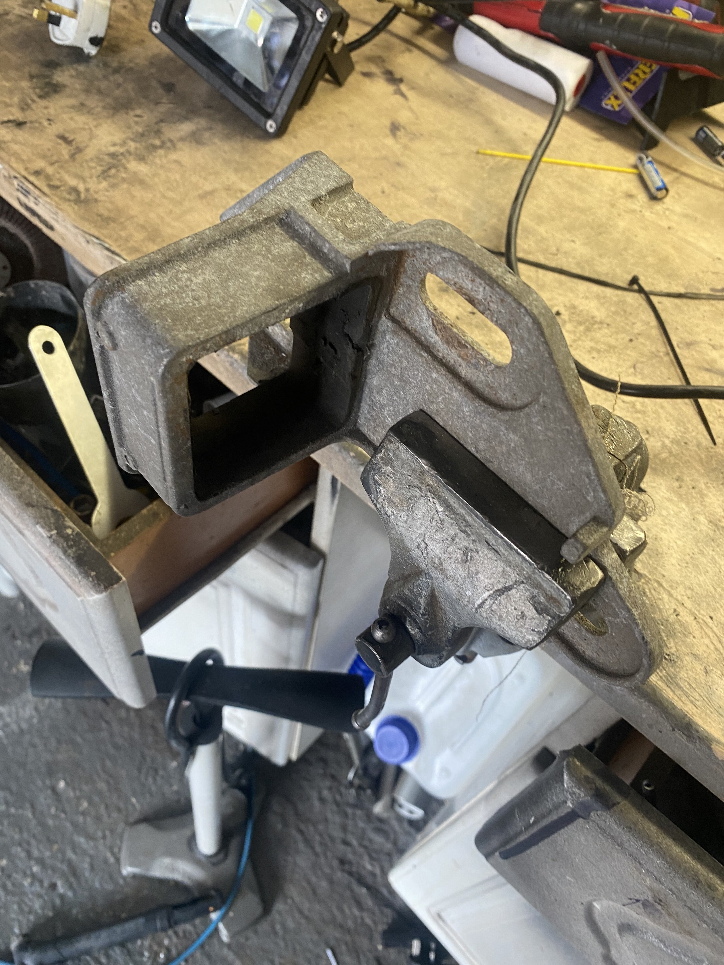

Further investigation, my smart arse (I’ll save £90) half house of a new belt and not tensioner, was a bum move. The tensioner was literally seized solid.
Order places with RPD for a replacement Aux belt set up and today I finally got it all fitted up and working!

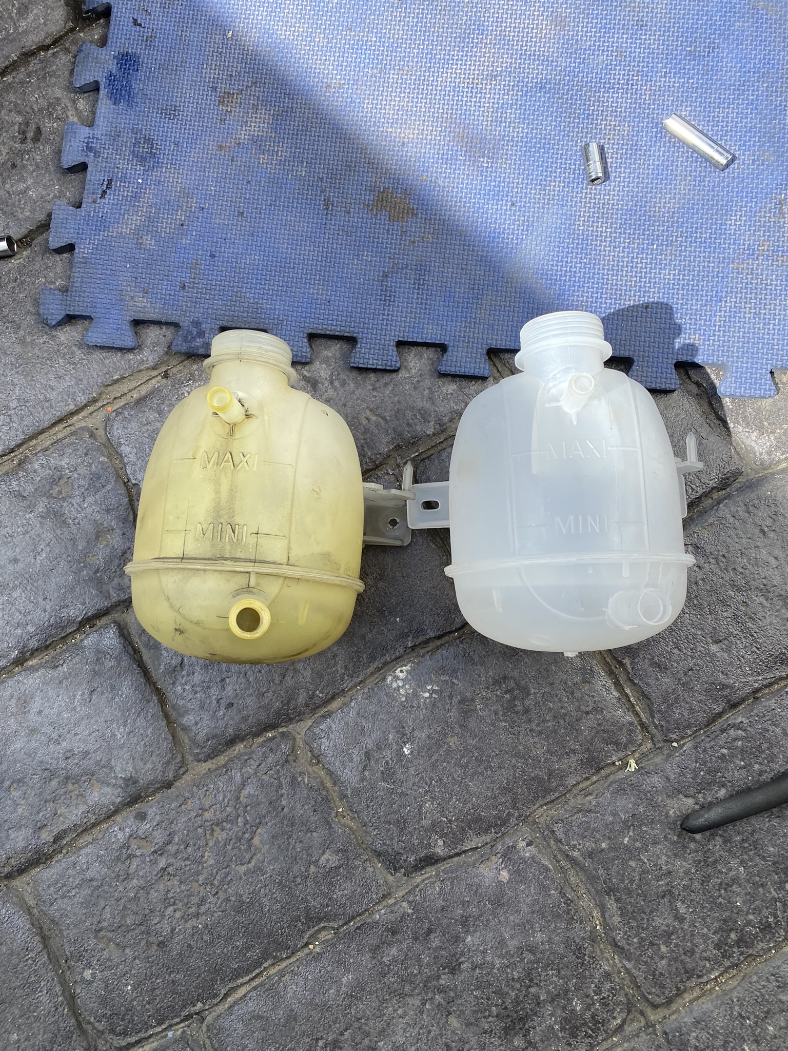

Forgot to mention, whilst sorting out my Alternator issues. I decided to get the car better prepared for the 300 miles round trip to CSF22. First up dropping the gear box oil, I didn’t take any pictures. But I did literally drop the oil, all over the garage floor. It stinks. Luckily the oils that. Are out the box was still a nice golden colour and no nasty metallic residue. Which leads me to believe I may have changed it before, but I’m sure I haven’t.

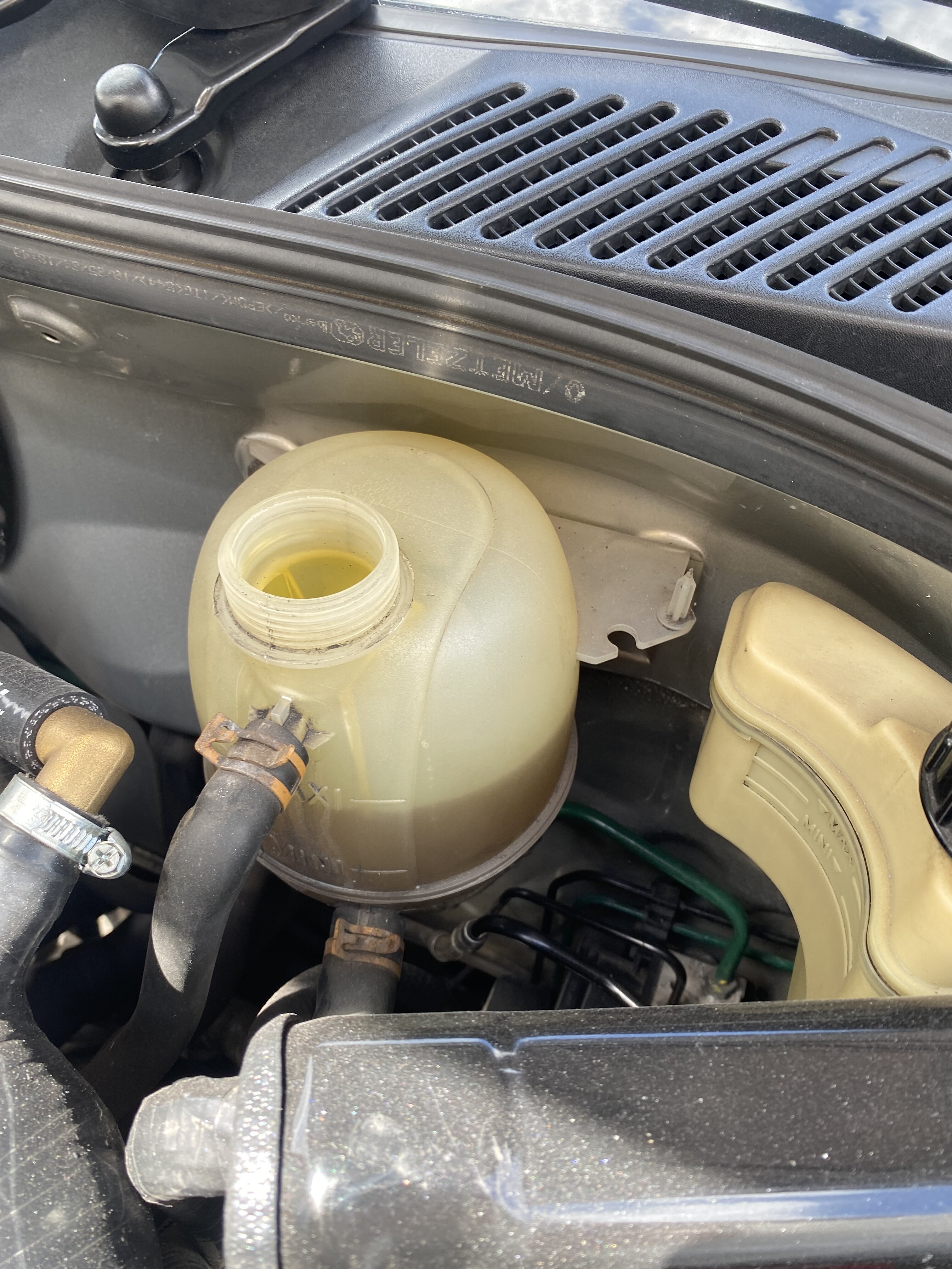

next up, I finally fitted an item I have had in the spares box for nearly 3 years now. A new header bottle! Coolant has been flushed through, genuine Renault type D Mountain-dew! Beautiful! Cleans up the bay no end.
Next job will be an oil change I think as although I never actually drive anywhere in the clio, it’s probably due. Need to remember to order some now.

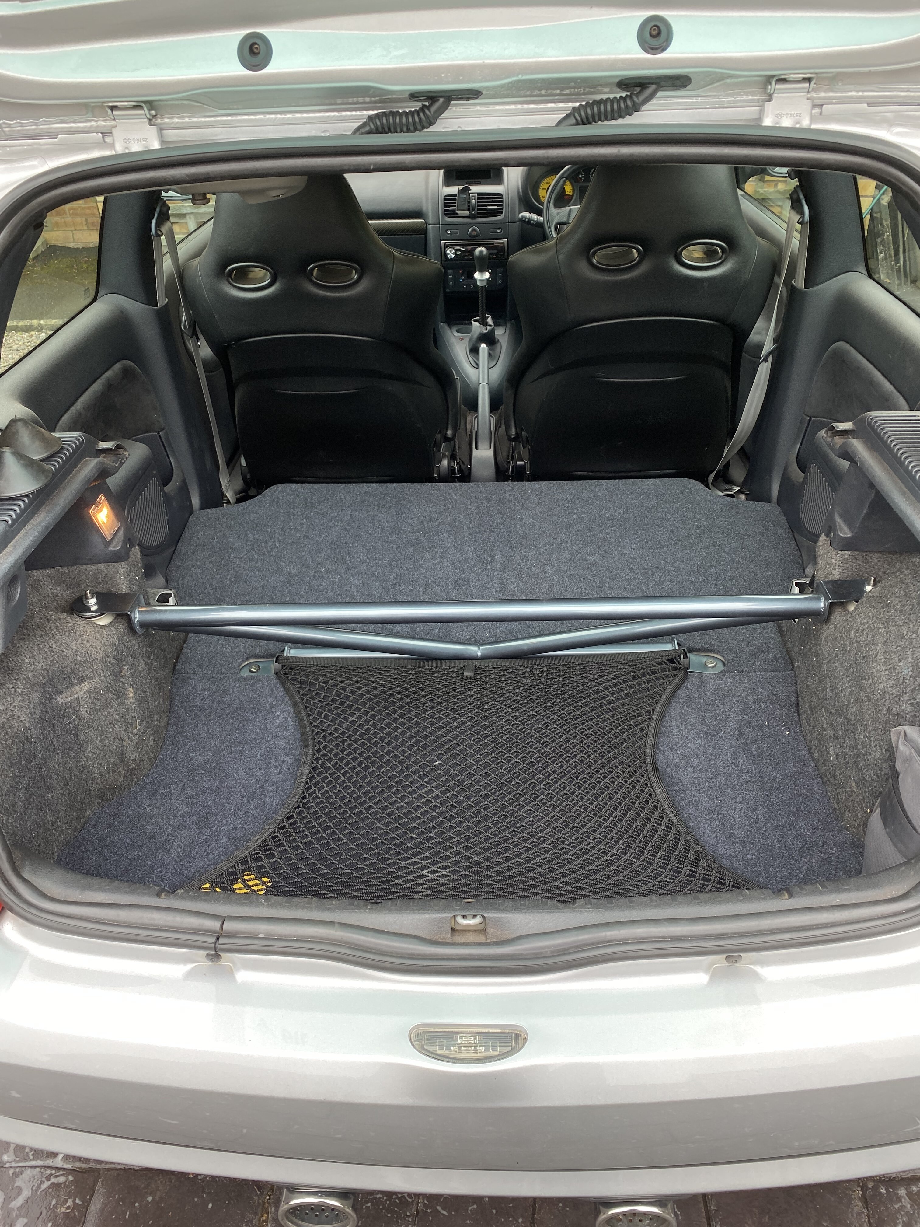

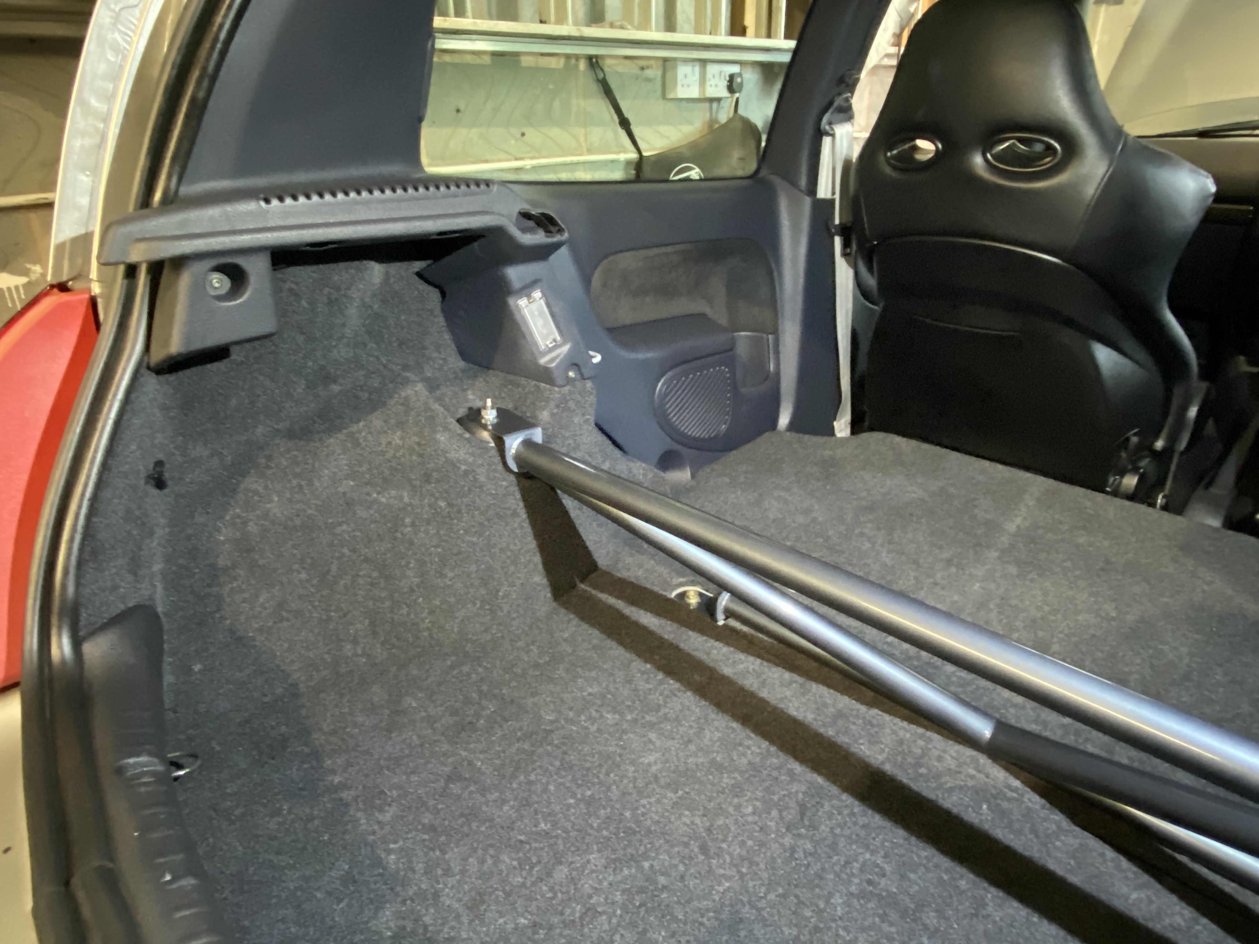

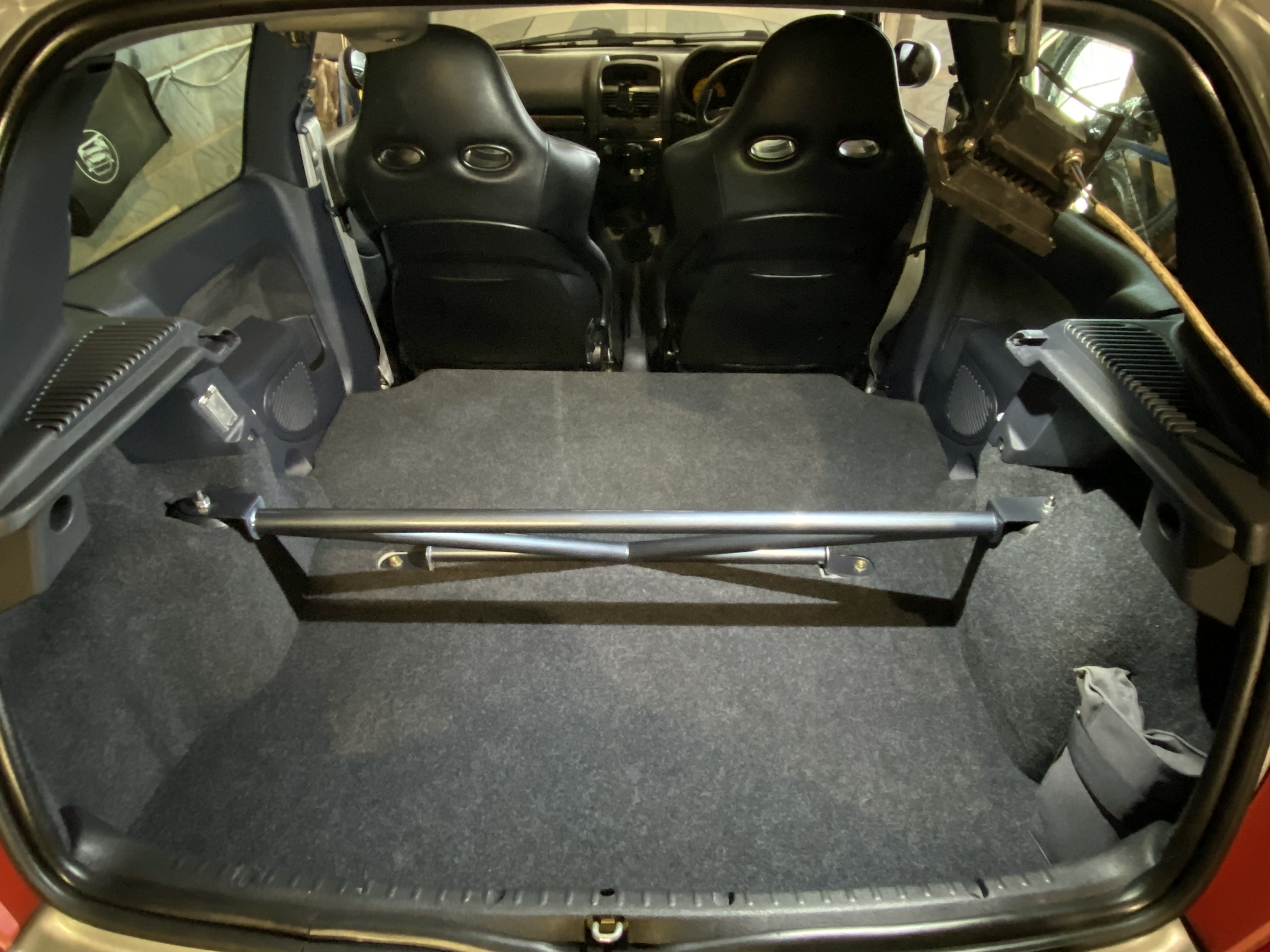

Right so with CSF fast approaching I need to get the car ready. I have quite a list and not a great deal of time as I’m off on holiday shortly! I really don’t want CSF to be it’s first drive out after doing so much major surgery…but it’s looking like it might be! First up I needed to finish off the rear seat delete. Now long term losers readers will remember I started making a false floor for the boot back in January. That’s right 6 months ago. Well I finally completed it.

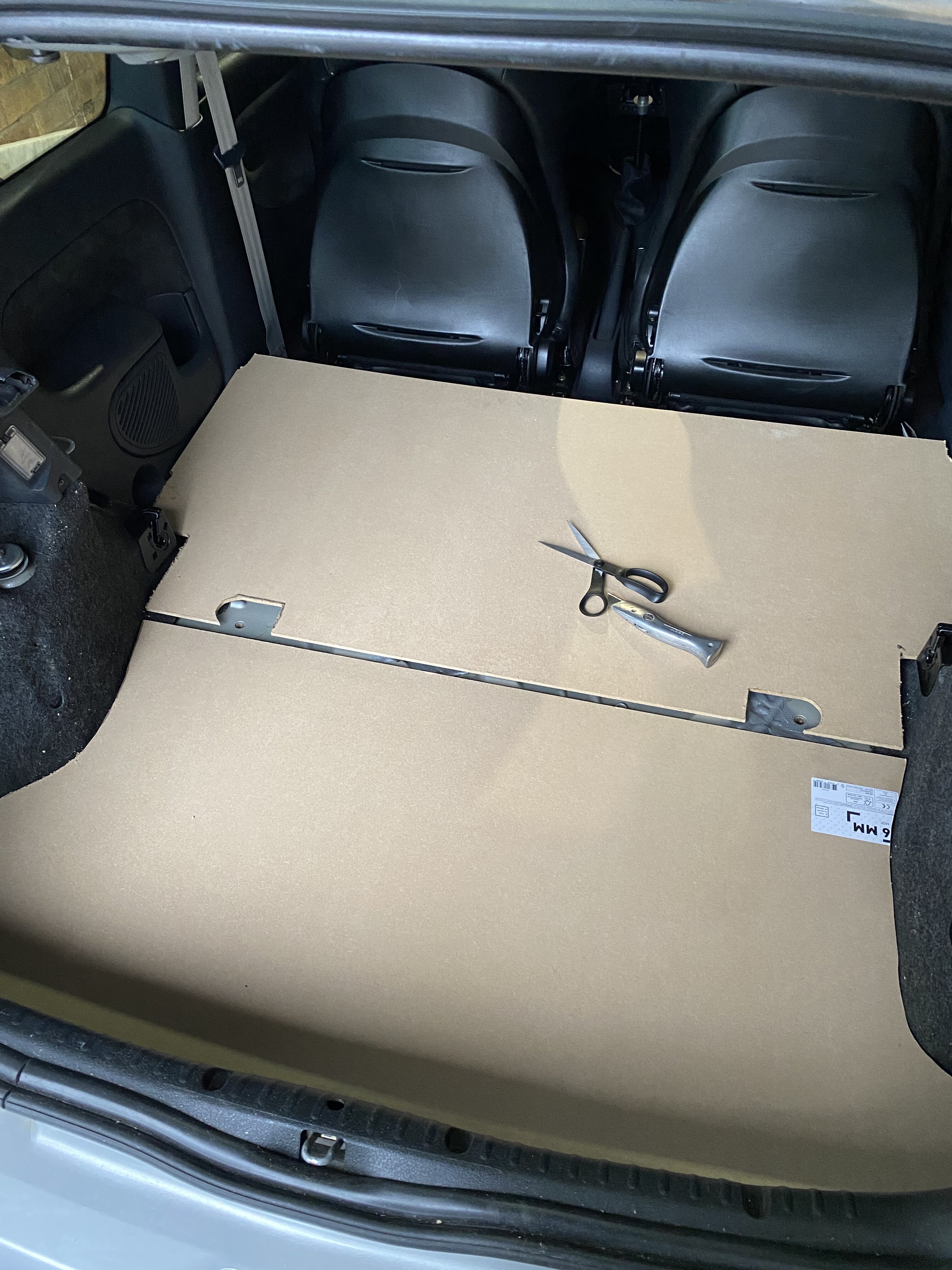

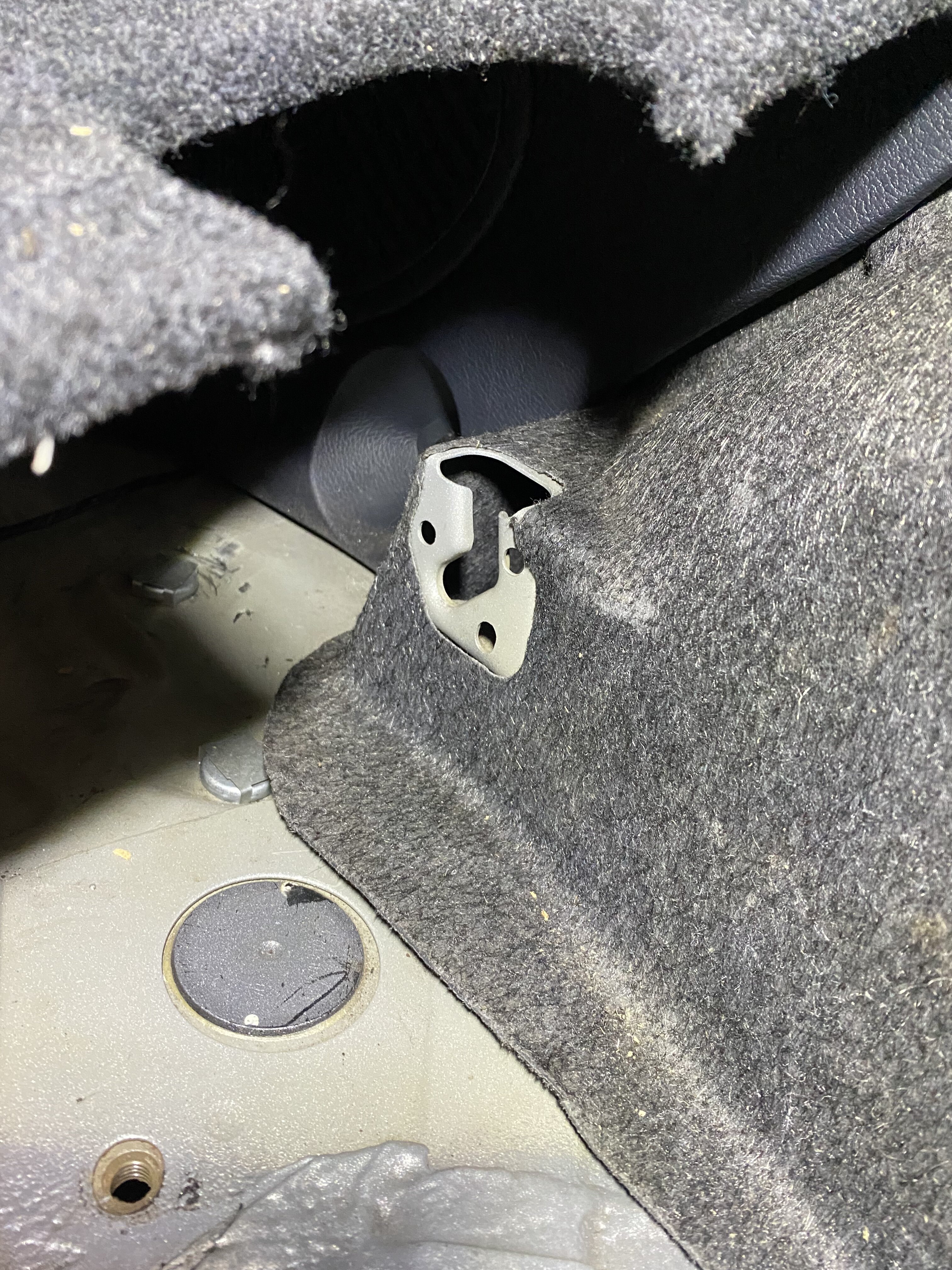

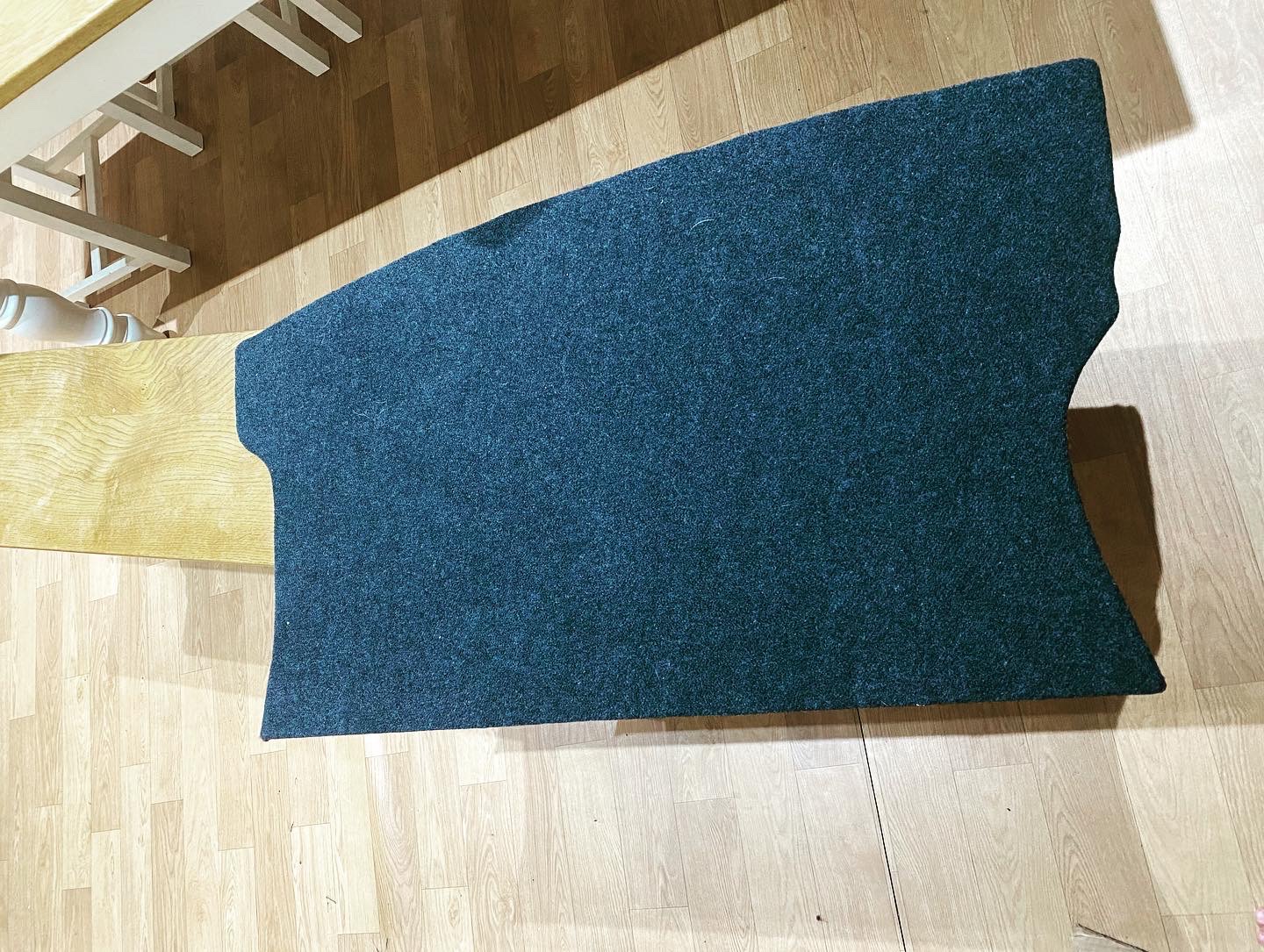

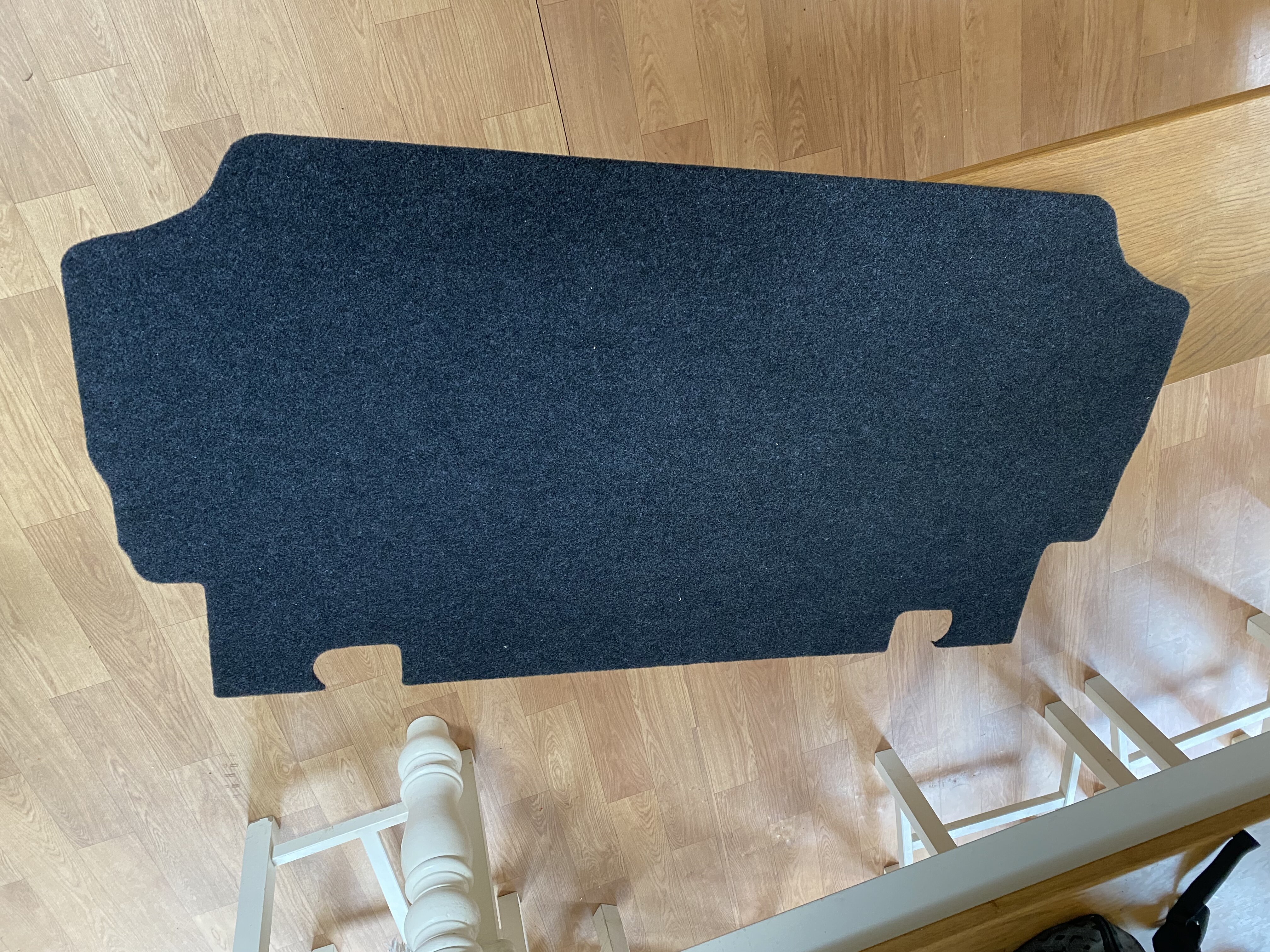

I started off making some carboard templates before transferring onto so 4mm MBF board, I kept the False floor in two bits for ease of fitting and removal. One the fit was acceptable I shaped the ends to fit in with the natural floor shape a little better.
I then spent a while contemplating carpet choices! In the end I opted for four way stretch carpet in anthracite as it looked best to mate the wheel tub carpet in the boot from the factory. On the roll it looked a wide choose so I fitted it. Stuff is super easy to work with, just cut and spray glue
fitted in the car and took some photos…bugger

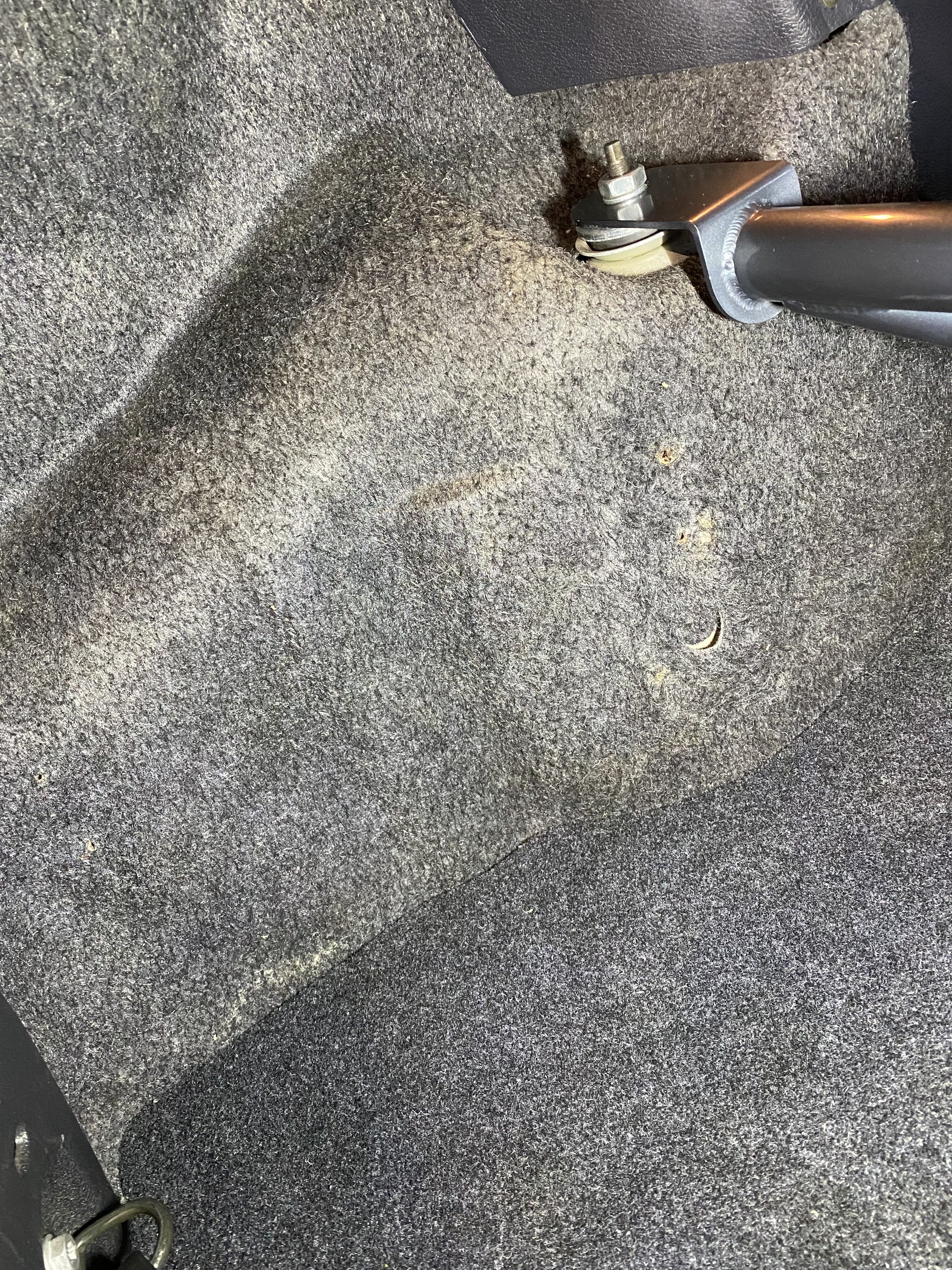

in the light the colour match is as bad as the front wing colour match on the outside of the car. I decided to address this by re-trimming the wheel arches with the same stretch fit carpet! It’s an absolute nightmare to do as the panels are semi ridged. But it helps overcome my annoyance around miss matching carpet. It’s also worth noting how grubby my boot carpet was
It also gave me to opportunity to hide the rear seat hinge points

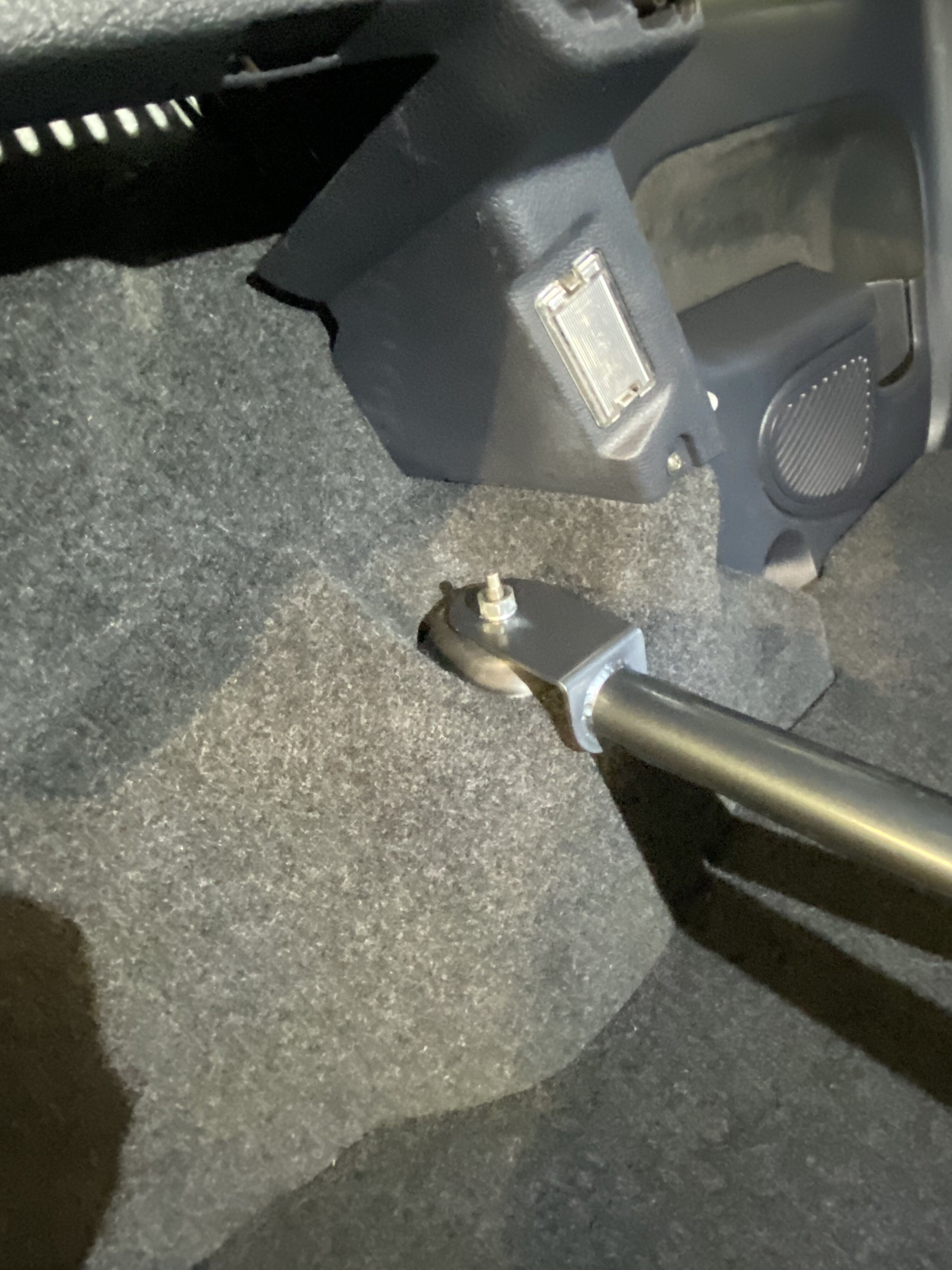

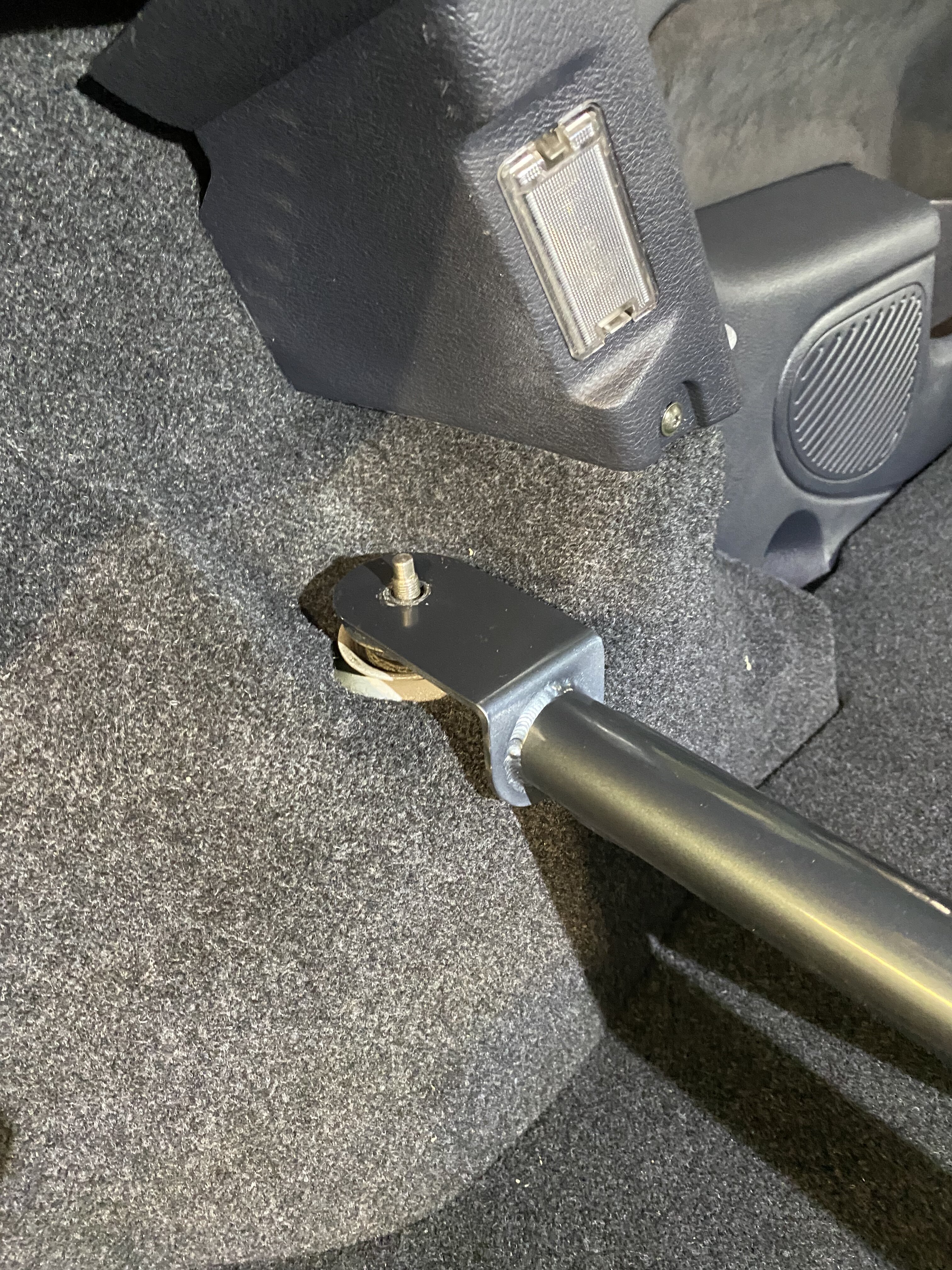

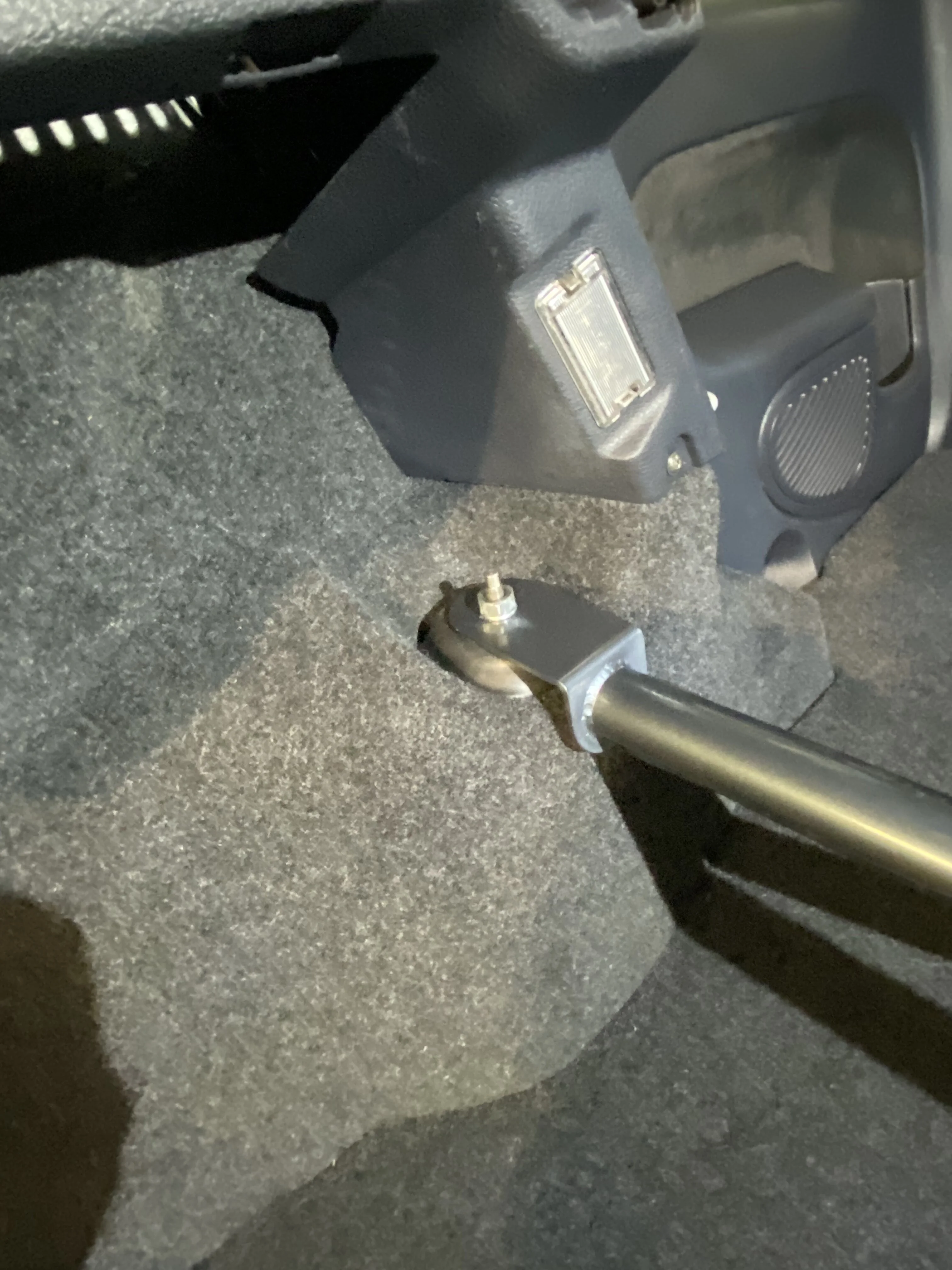

So all covered and Faldo floor fitted, I went to refit my kbrace…nut something that bugs me with it, is the fact you can see the damper top mounts.
To help his that I cut down the original strut top rubbers which neatens the whole job up a treat
So all in cleaned and finished, I’m pretty bloody happy. It’s a neat set up, just need to get a boot net now that fits the area nicely as the one from my Merc is too small.

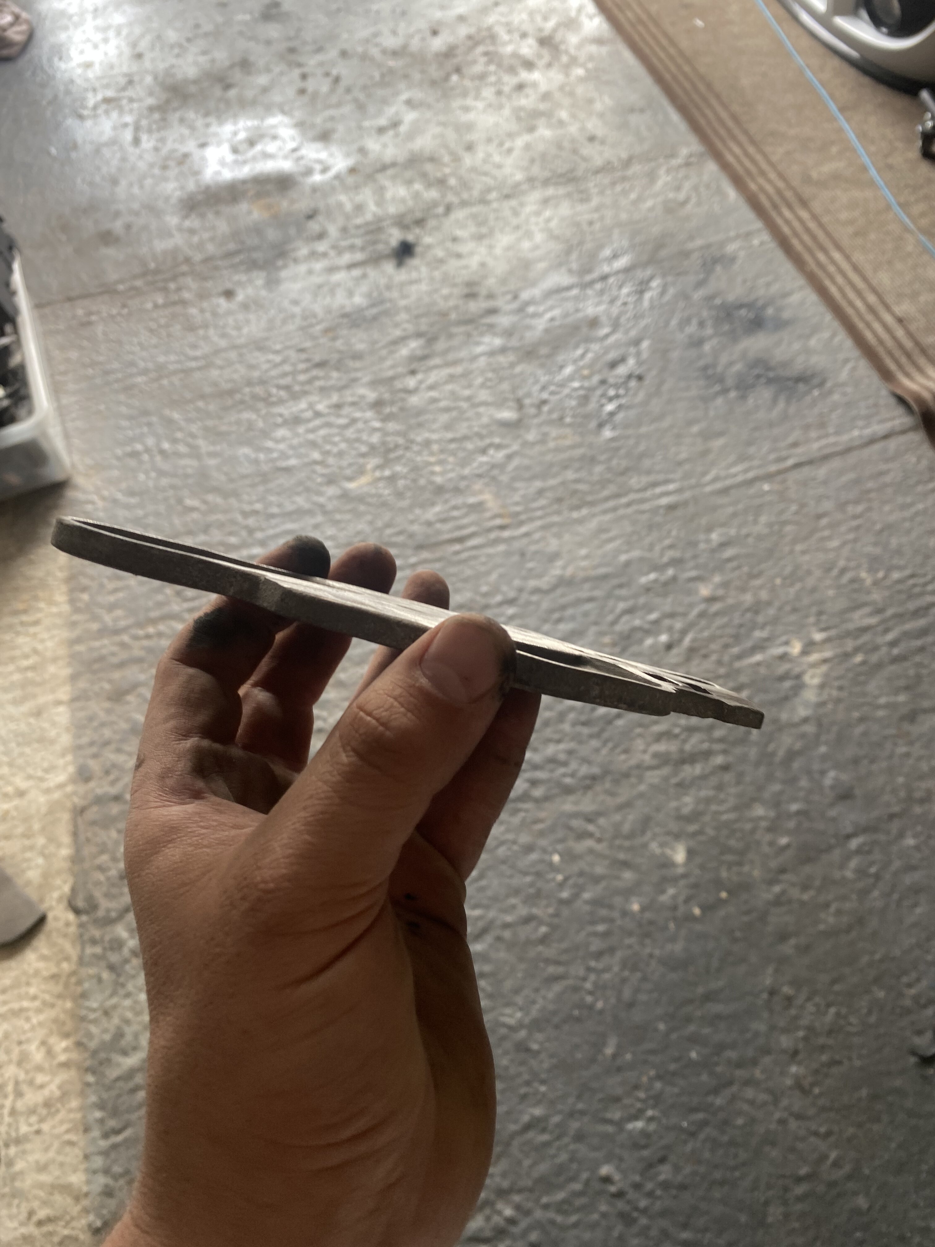

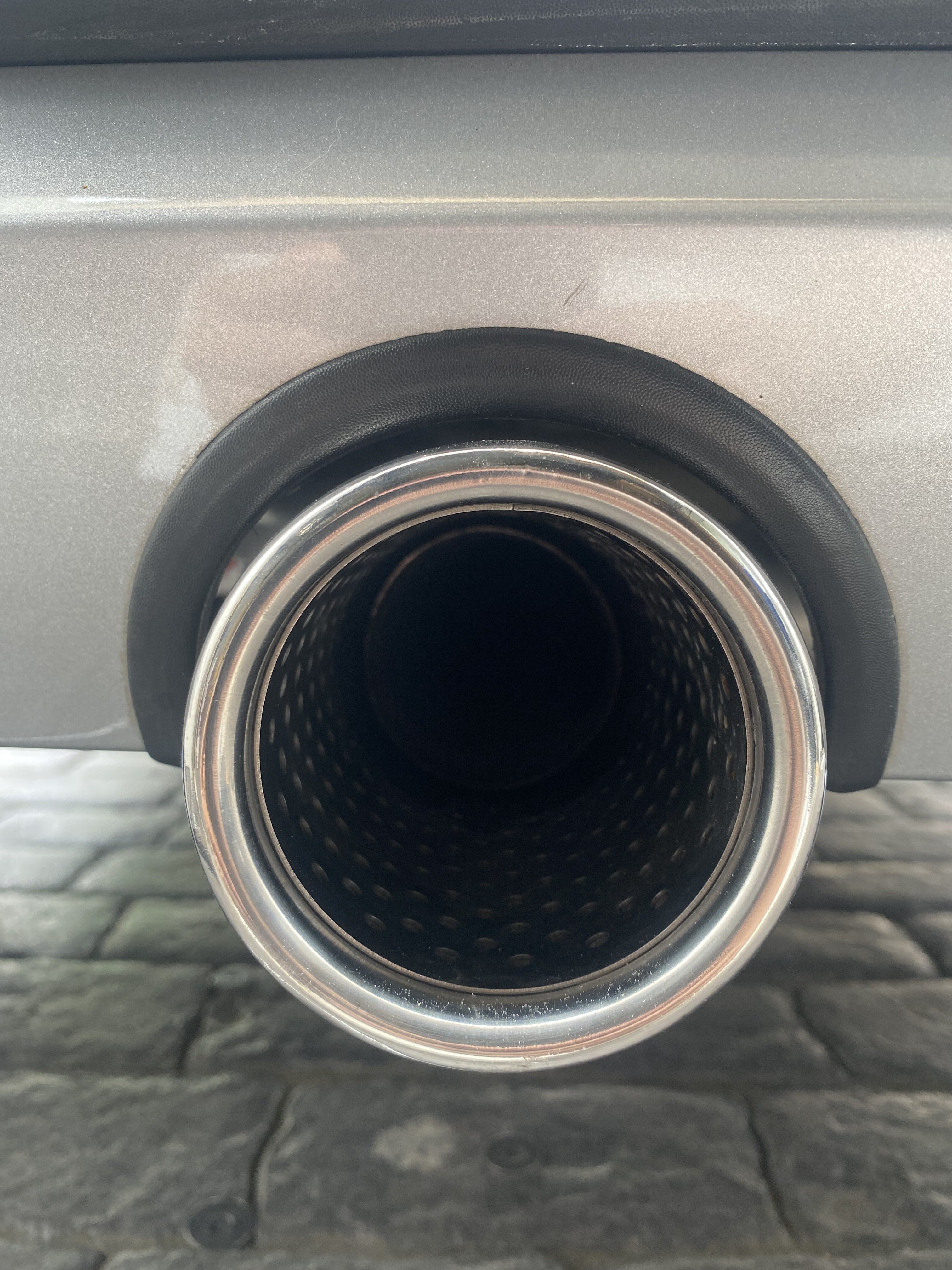

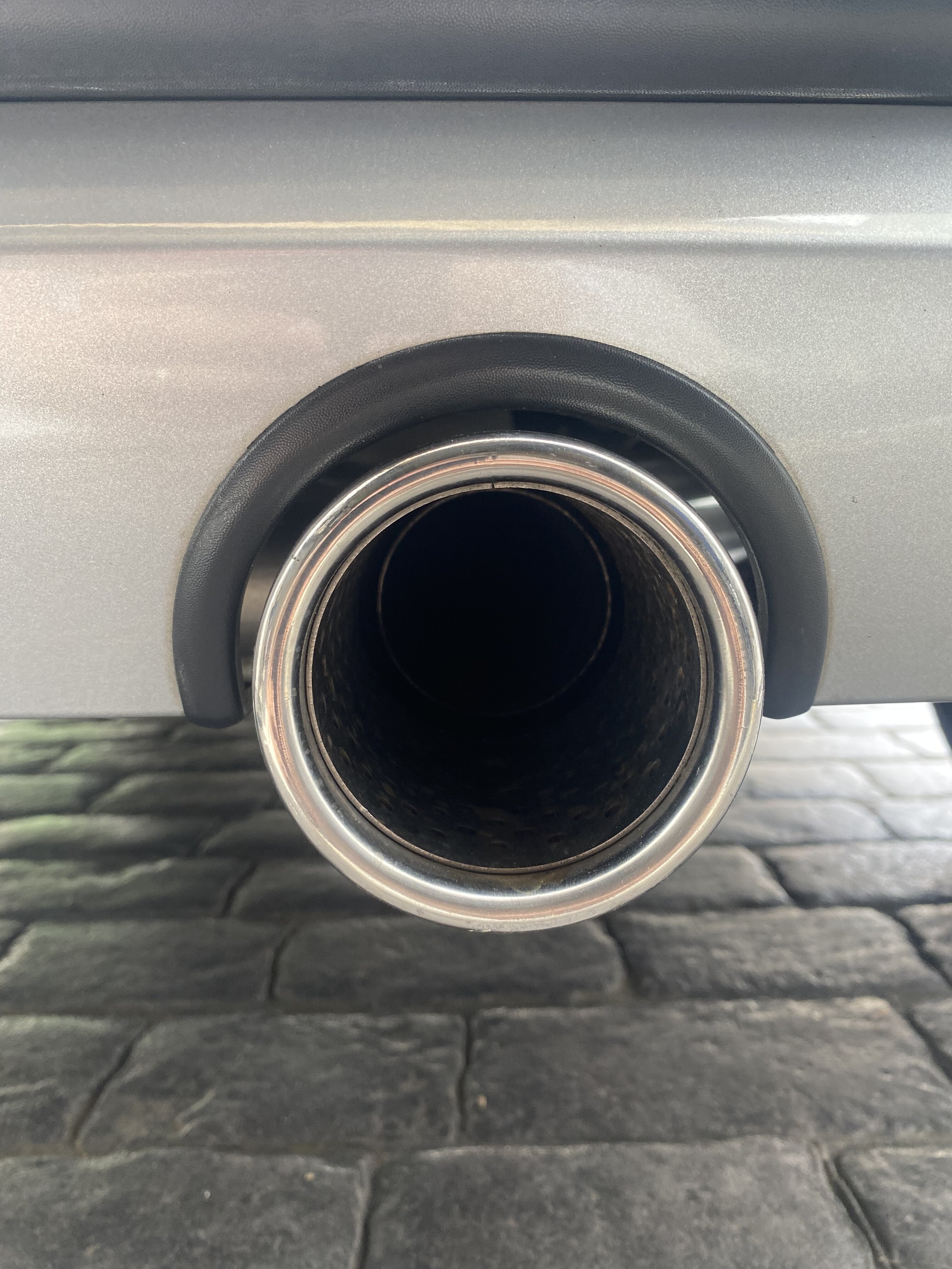

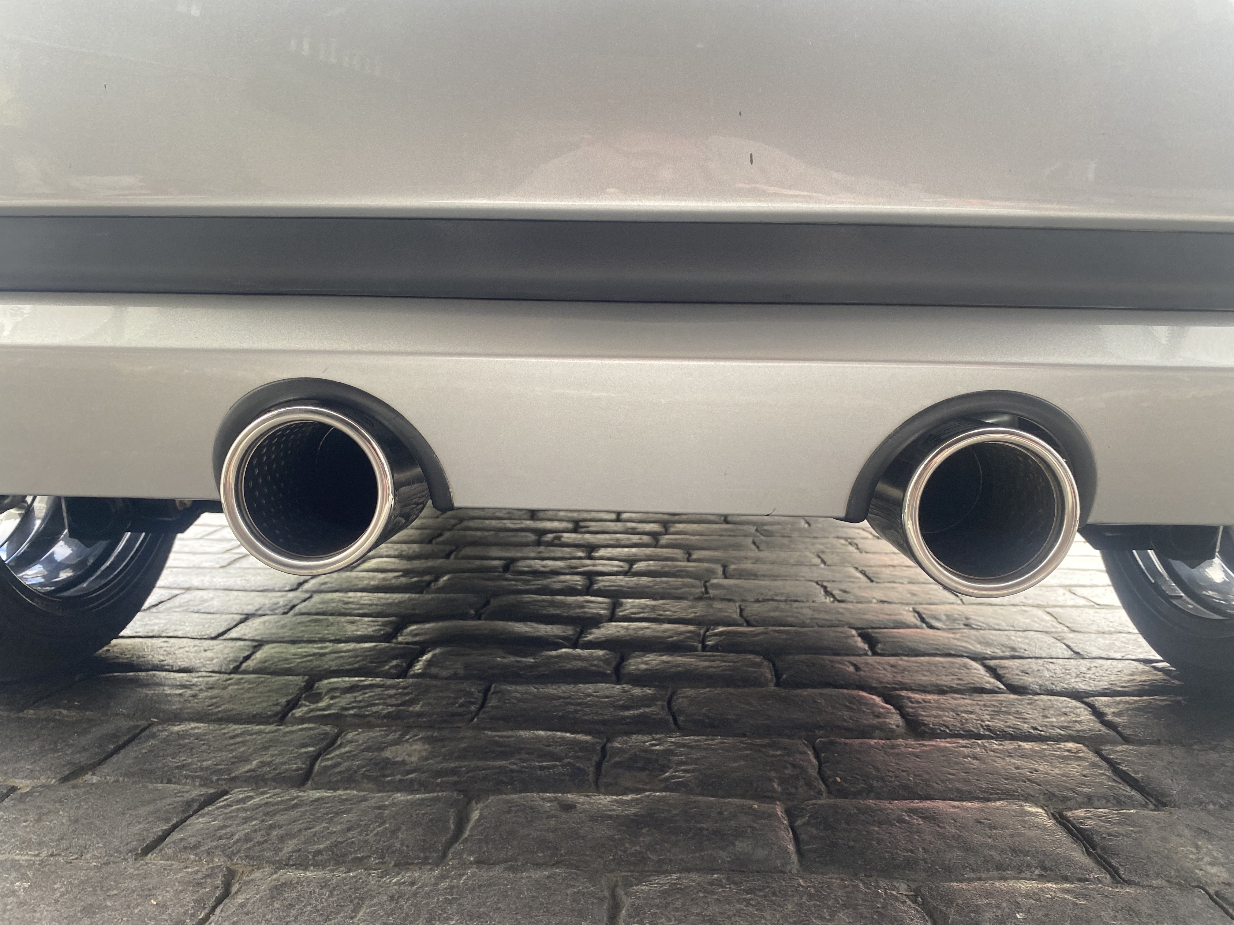

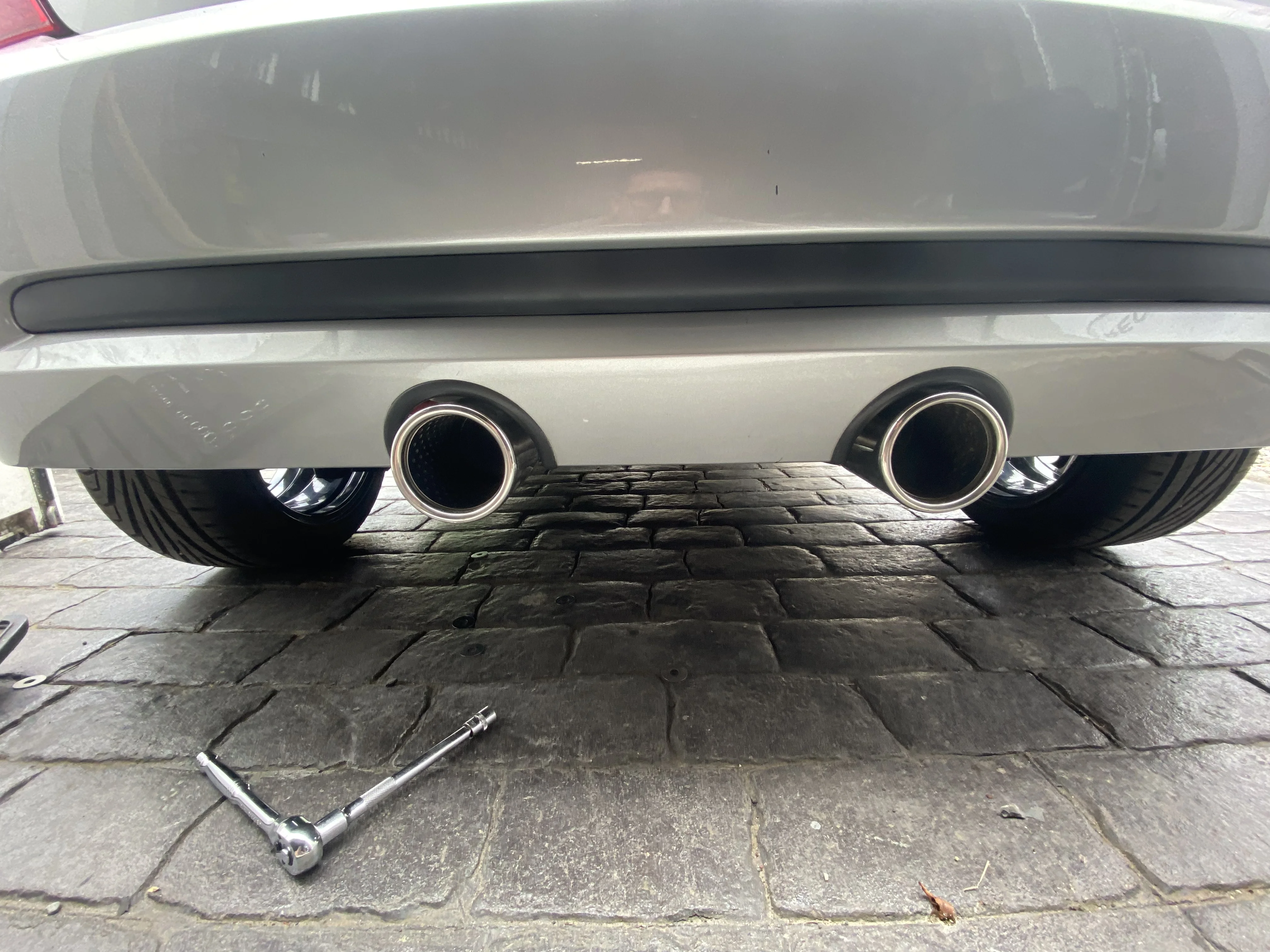

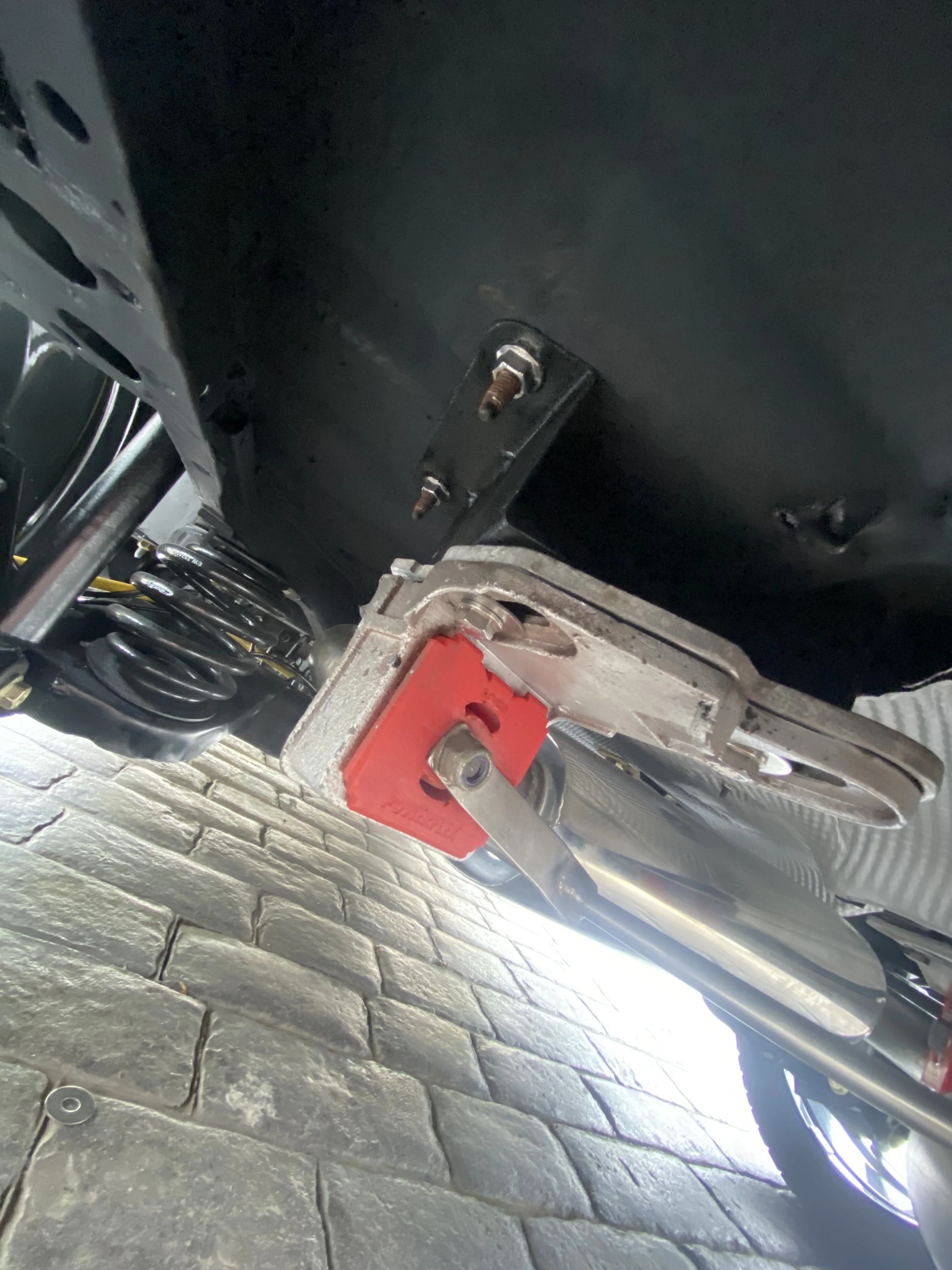

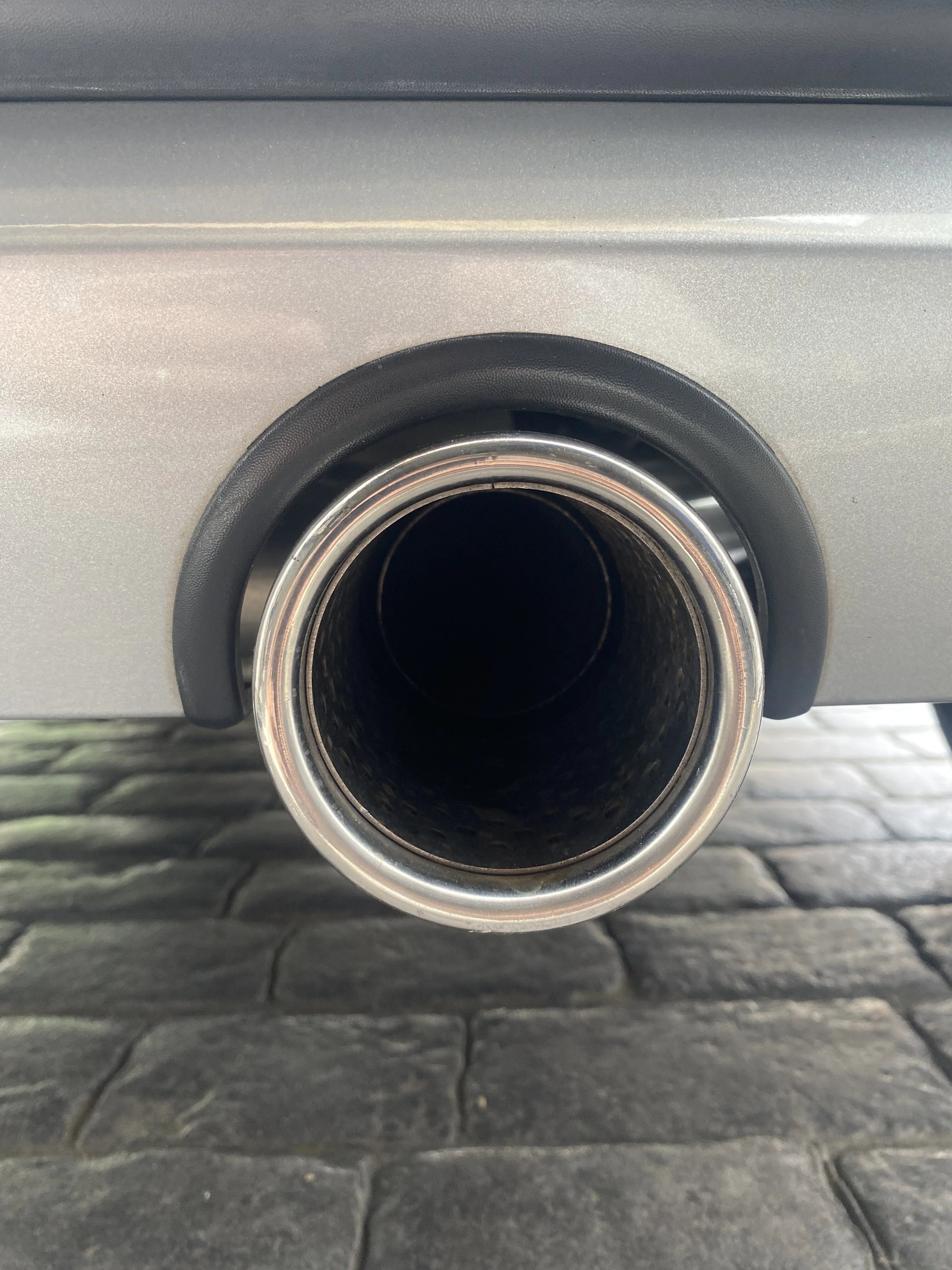

Today I started out by trying to sort that age old 182 problem…wonky exhaust tips. Since fitting my new exhaust I struggled to get alignment with the NS tip sitting closer to the bumper cut out. I had tried previously packing the exhaust hanger out with washers. But it still looked on the piss..bit like my teeth.
I had a brain wave, I had an old exhaust hanger bracket, which I hacked away with the angle grinder until it was flush.
pleased to say bolting this up to the underside of the bracket worked an absolute charm! Perfectly level exhaust tips…OCD satisfied

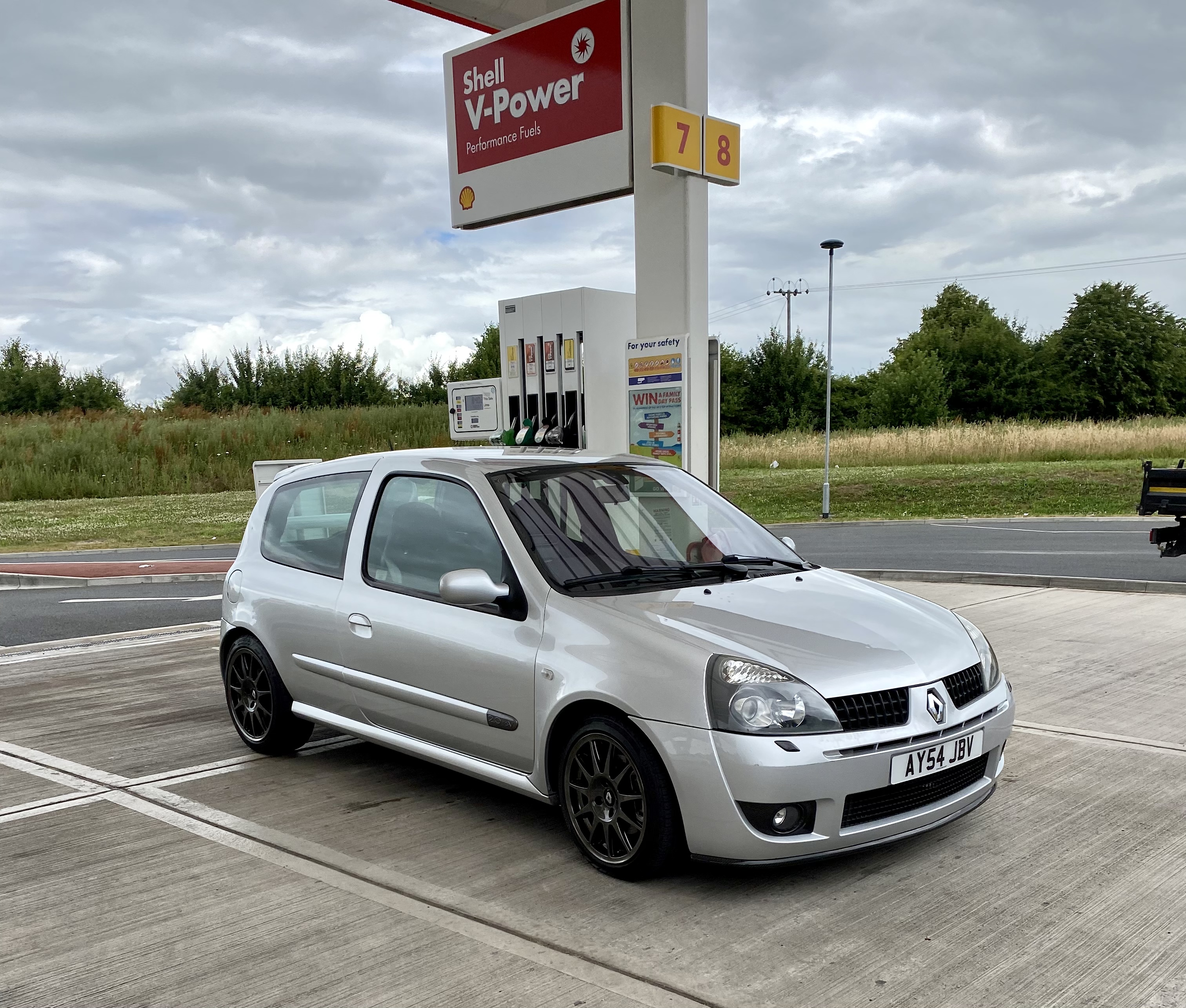

Next, I decided to give the old girl her first drive out in nearly 9 months. She was completely empty of fuel so £85 of shells finest and I set out for a 2 he hoon around the Cotswolds. I have changed so much on the car this last few months, I have been panicking about actually getting to Blyton. Pleased to say the car was flawless, in fact better than ever. Tighter than a drum, the new rear beam bushes have made the car feel much more composed, so I’m guessing the old ones were goosed! Couple of pics, car was filthy….but that’s next on the list, along with an oil change, new shifter bush and replacement CV gator. Then we are ready to go.

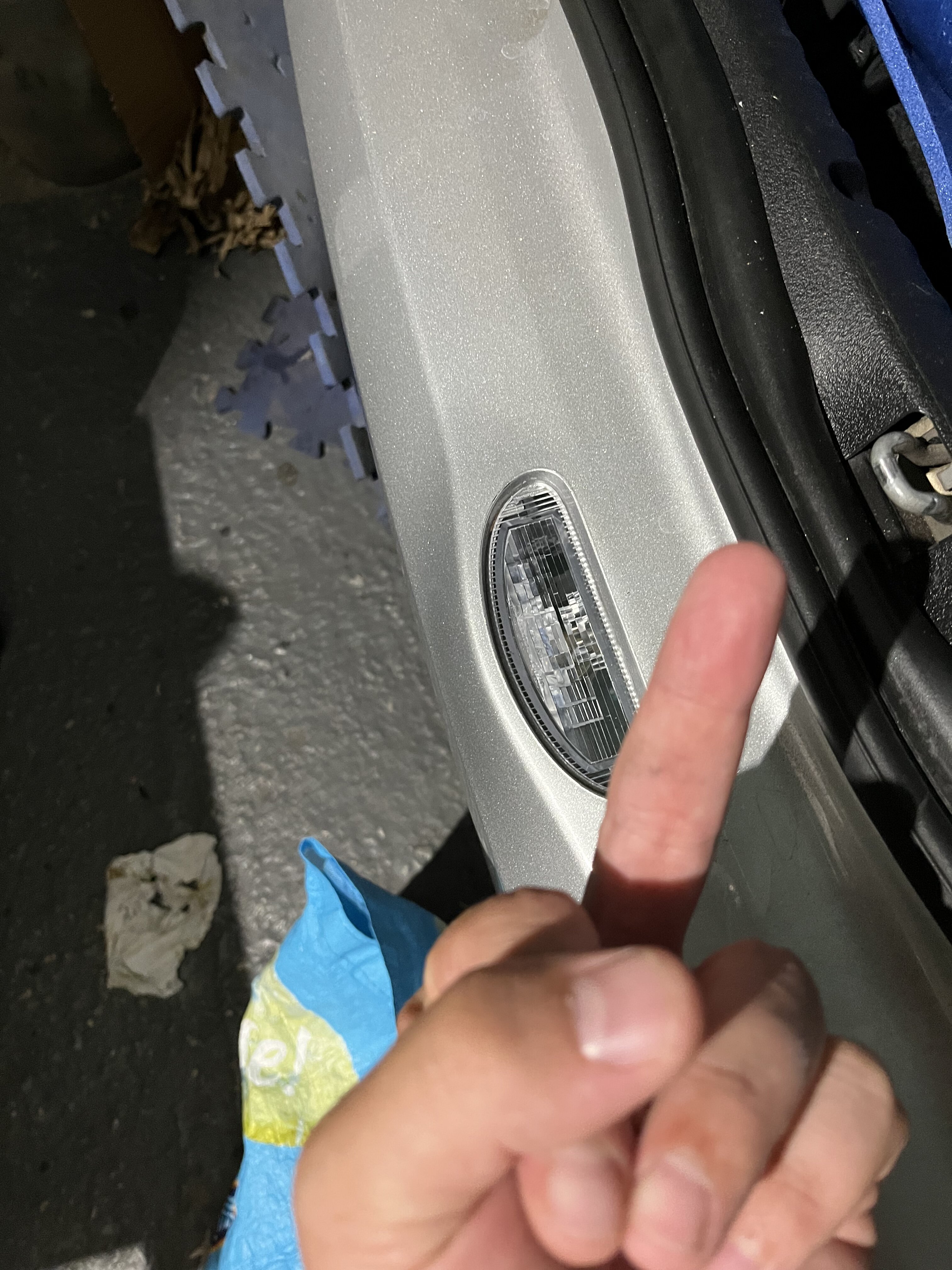

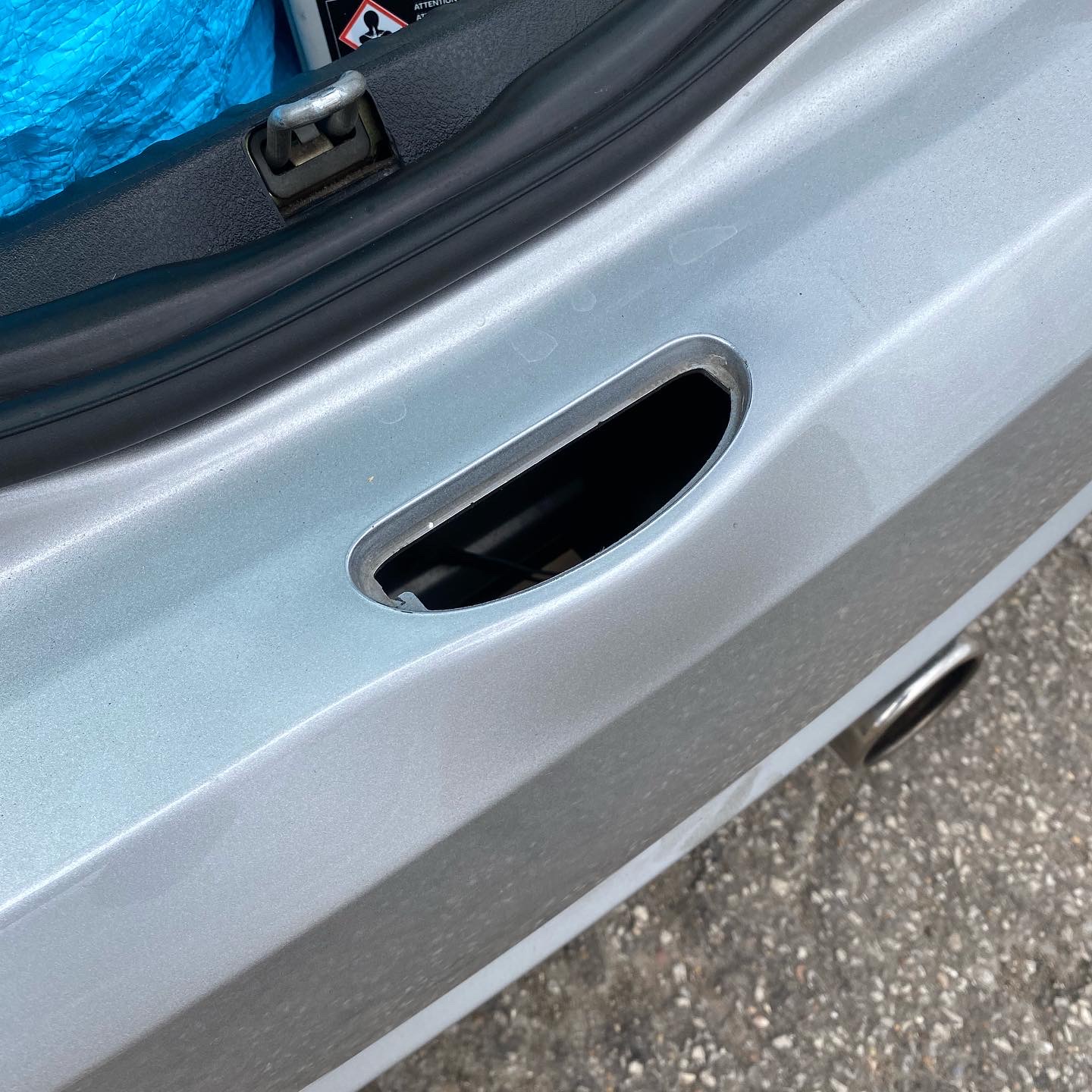

I’m pleased to say the car made it there and back with little drama! Bizarrely the only real victims for the weekend being the number plate light deciding it didn’t like being part of a silver s**t box any more
and the key battery, meaning the car was unlocked all weekend.,. Otherwise she was faultless, I’m frankly amazed and chuffed in equal doses. Whilst I’m at it I really should shout out the forum admin, mods and general membership. What an outstanding club this really is. Super friendly, accommodating and well organised place to be! Thank you!
Once back from CSF I set about repairing the two items of failure. Another new number plate light fitted snugly in place. I can only presume the last one was a fake as this clipped in so much nicer and a new key battery.

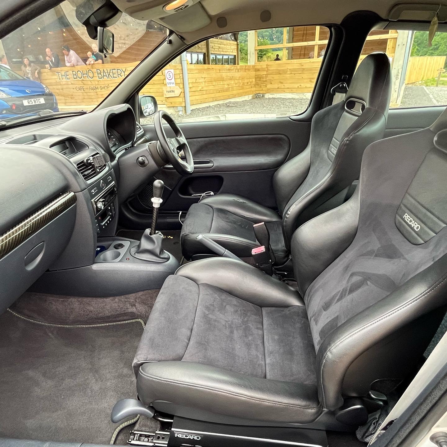

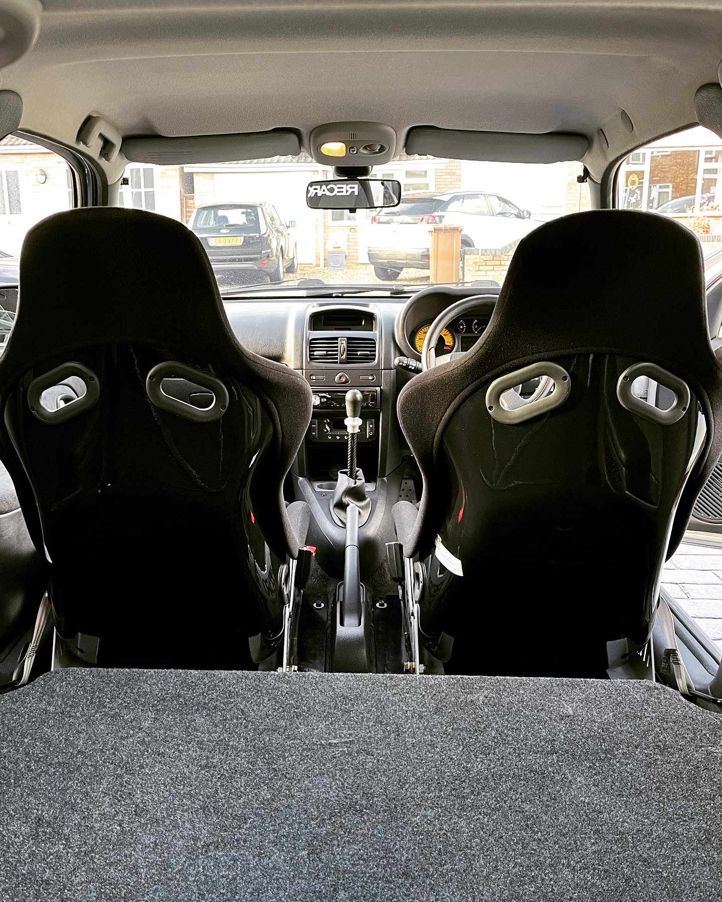

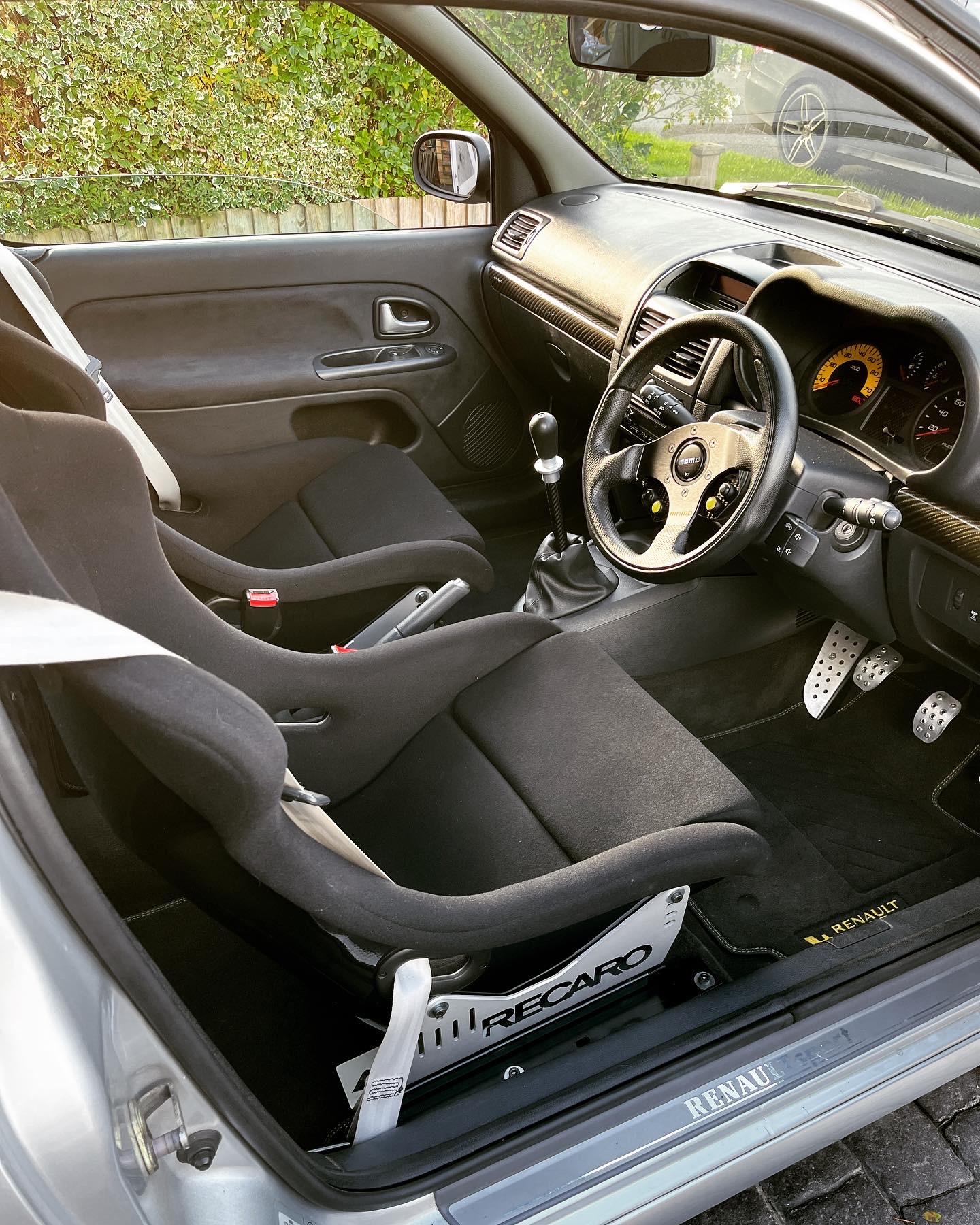

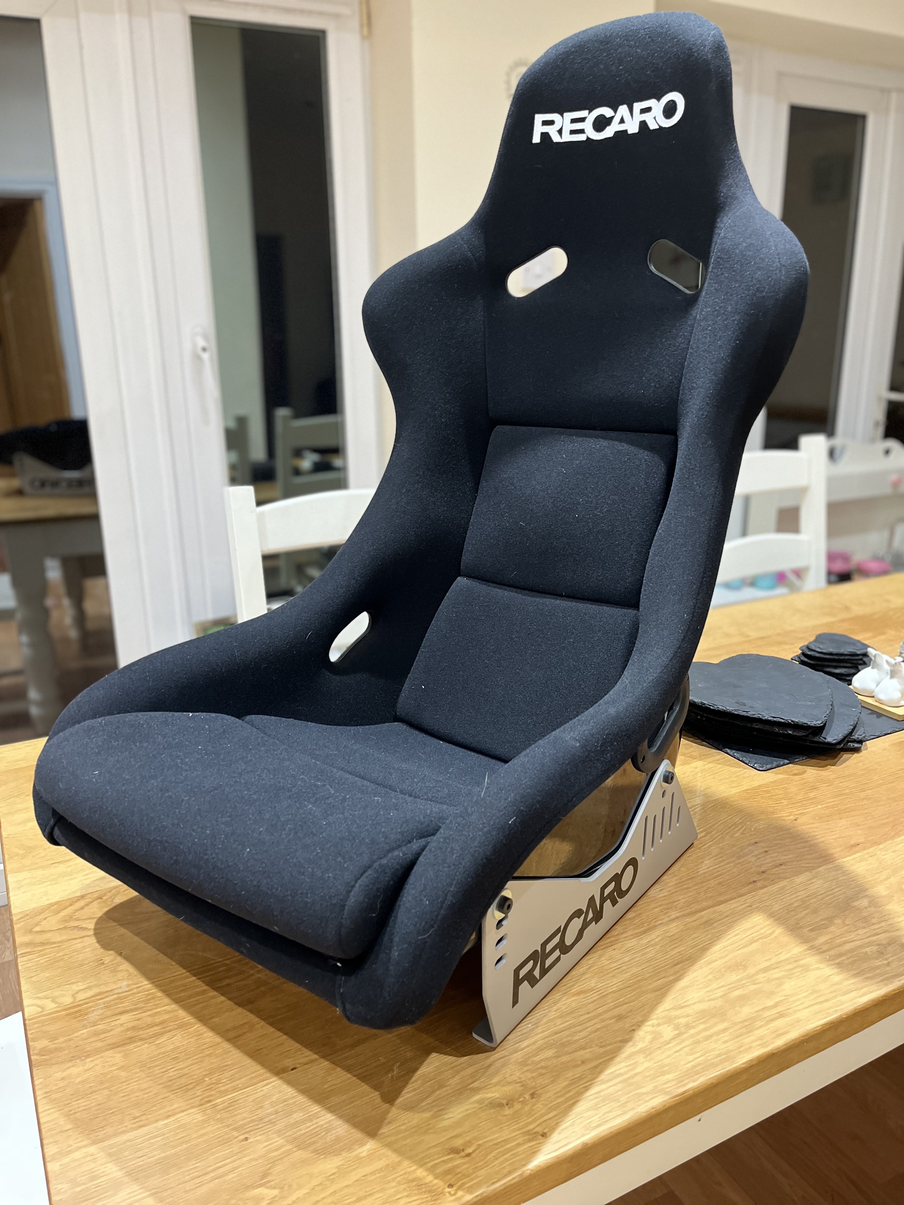

I’ll start this post with a question….what’s the longest it’s taken someone to fit a set of seats to their Clio?? Whatever the record, I’m pretty sure I have beaten it!
So, after deciding I wanted to make the Clio a little more focussed (on what I have no idea, but it’s all @Handbag Pudding fault as usual) I purchased a pair of Recaro pole positions from @Ph1 Tom. After @Louis kindly allowed me to sit in his at CSF.
The seats and side mounts had obviously barely been used and were in great condition.

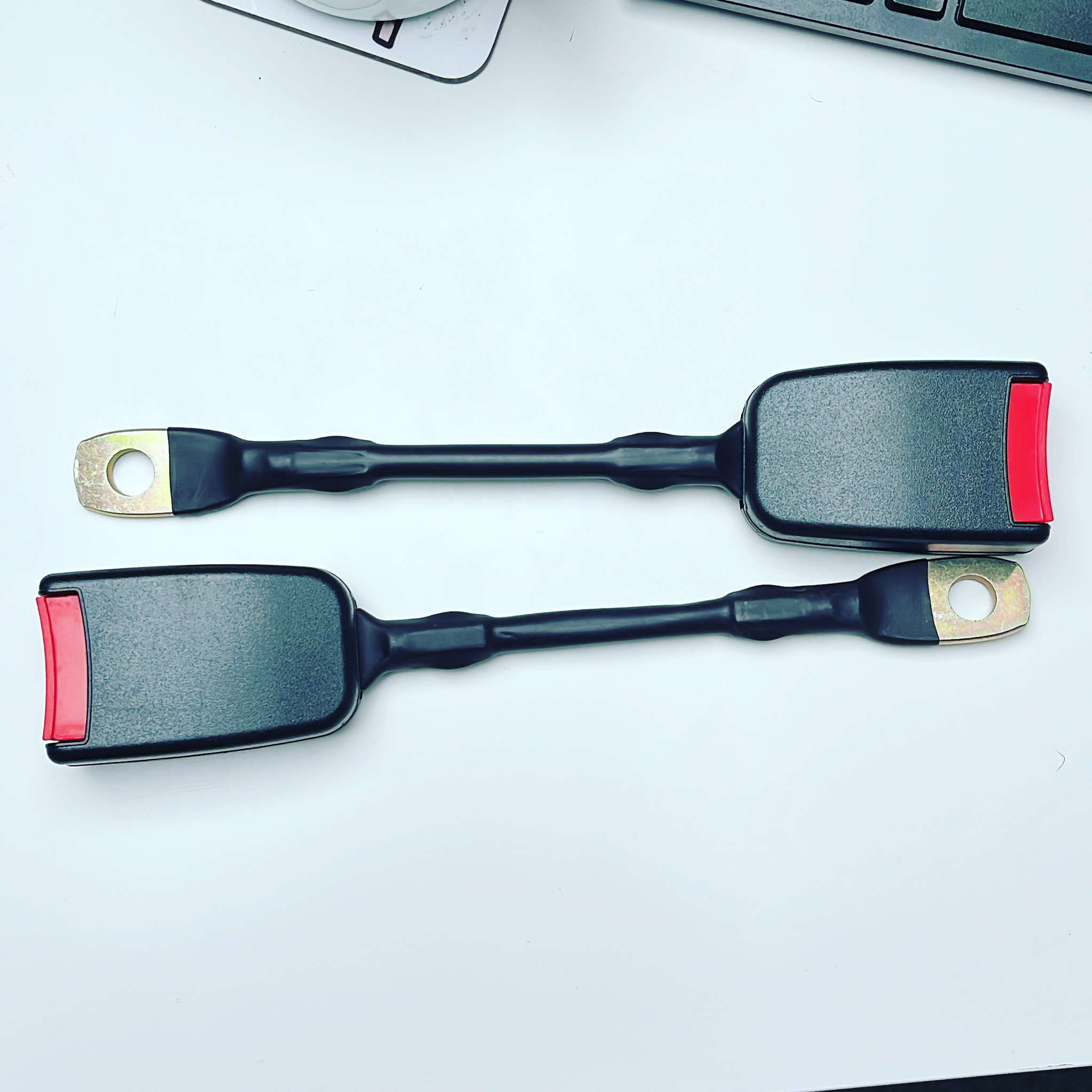

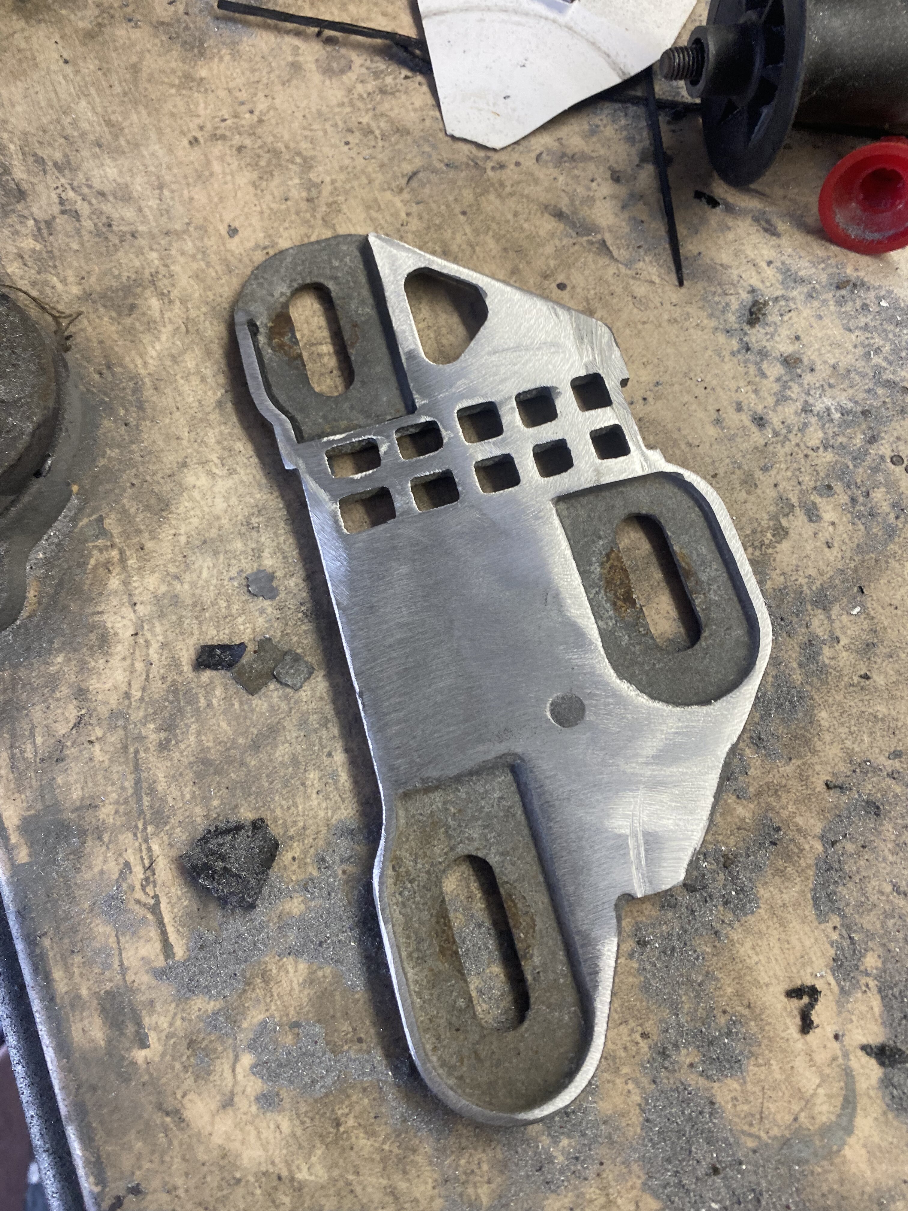

Having then removed and sold my Trendlines I needed to get my s**t sorted and actually fit them. So with advice from @frayz and @Louis I set about finding the bits I needed. Now true to form I forgot to take adequate photos. But low subframes were sourced as were the side mount seat buckles from universal seat belts
I also purchased a pair of universal double locking runners. To my surprise it nearly all fitted together, with only needing to elongate the subframe bolts slightly. Now the reason it took me so bloody long to complete…I placed orders for bolts on 5 separate occasions. Each time falling fowl of the postal strikes! I’m a moron, very much a case of measure twice order once. Instead of hit and hope the order button…anyway, all fitted in the end.
To celebrate my lad an I went for a Starbucks.

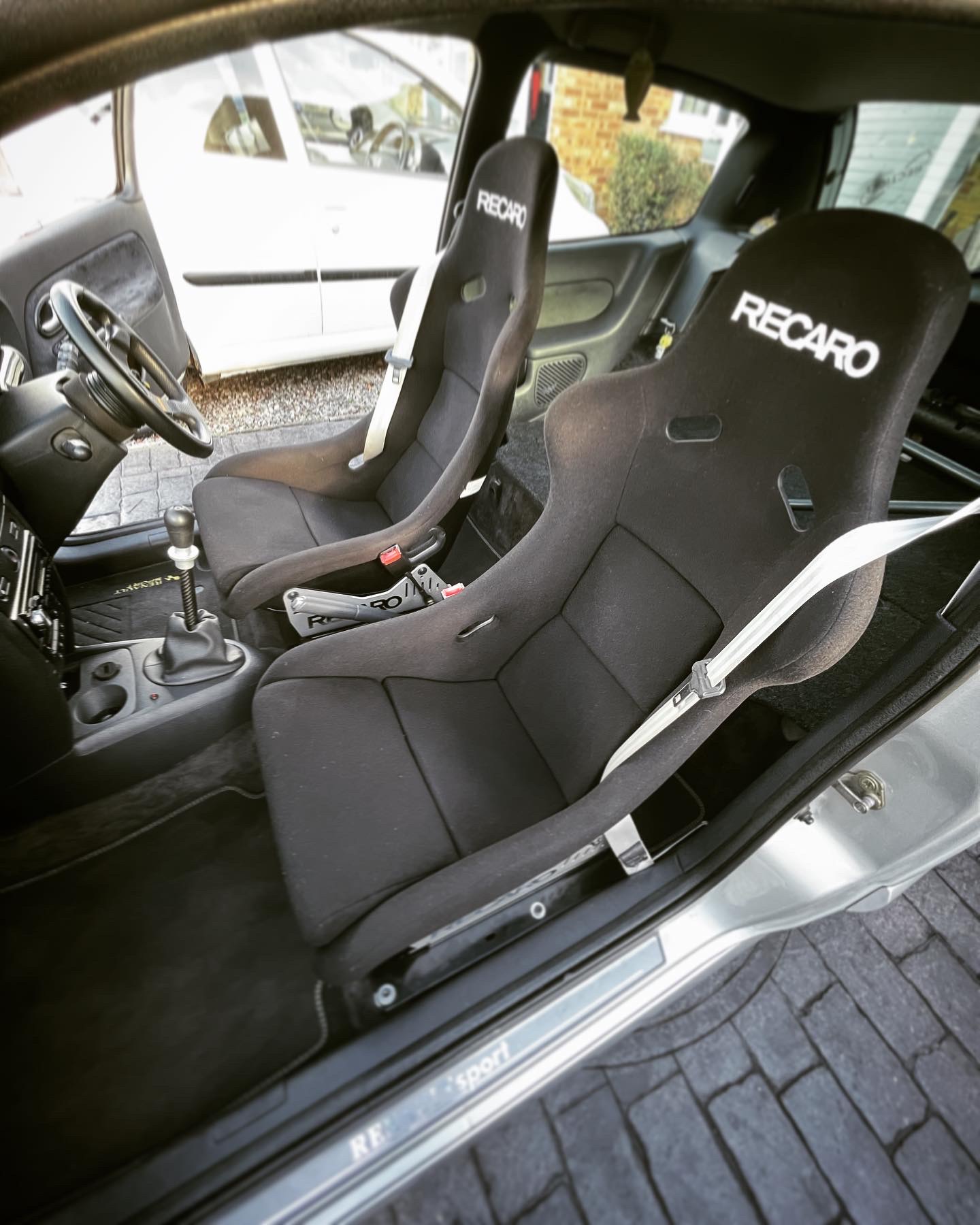

I’m pretty happy with the car now, the seats actually transform the feel of the car. I have some small bits to tidy up still in the engine bay, but likely next up will be a half cage. It will then need to get the belts done before next summer. That if the urge to buy a Porsche doesn’t consume me first…
