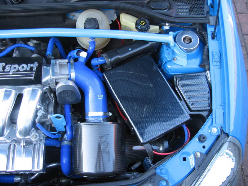

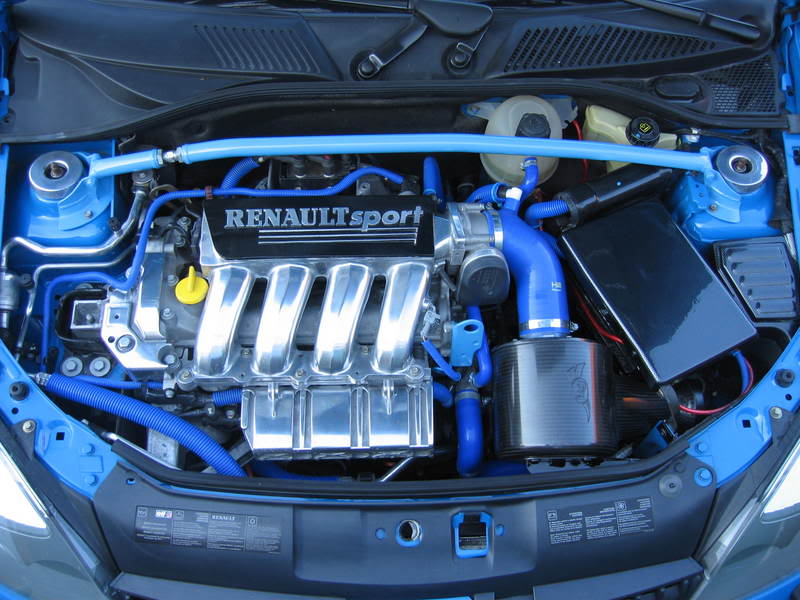

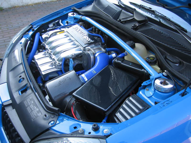

if you buy a samco or hillpower elbow for it them all you need to do is make some sort of support plate to hold it steady as the clio has a metal plate which you can attatch to the maxogen to stop it wobbling around
andy
you can see the plate at the front of the maxogen in these pics
it should be easy enough to do with a small piece of steel or alloy
