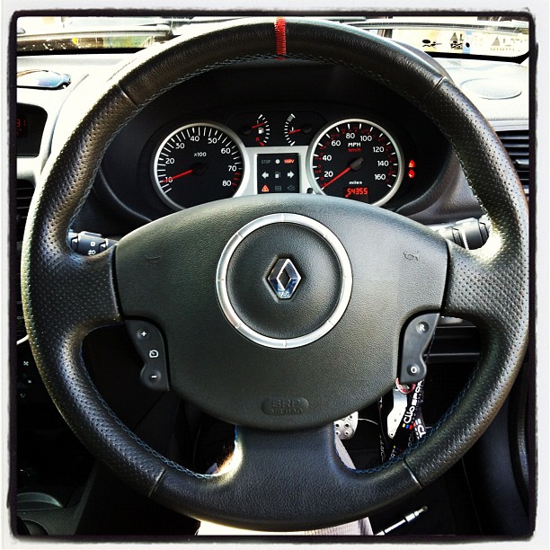

Straight swop, although it turns either way slightly as the teeth are different sizes to the column (very slightly)
I put two washers on and then the bolt to attach as it wobbled, this is sorted now.

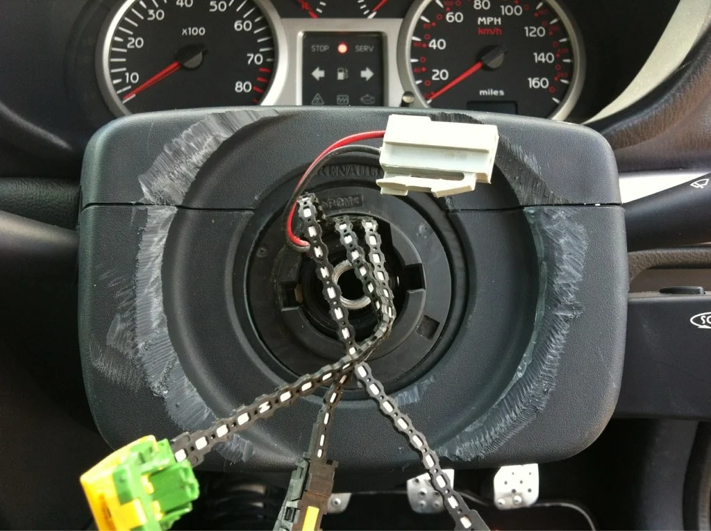

Cruise control works fine, you have to snip the connector off the clio wheel so then you can solder the CC wires to it.
The airbag wires - Wire C needs the notch trimming off so then it slots right into the airbag for the Megane airbag.
The column does rub, I've just shaved it down today. If you leave it for a few weeks you can see which bits need smoothing down.

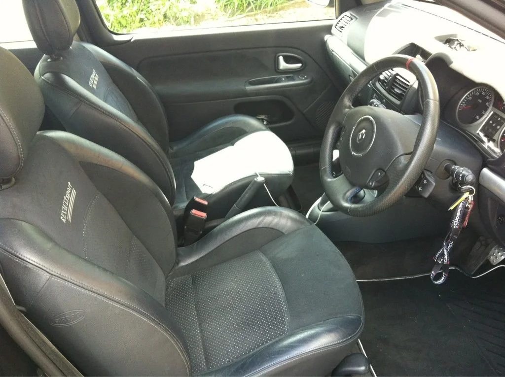

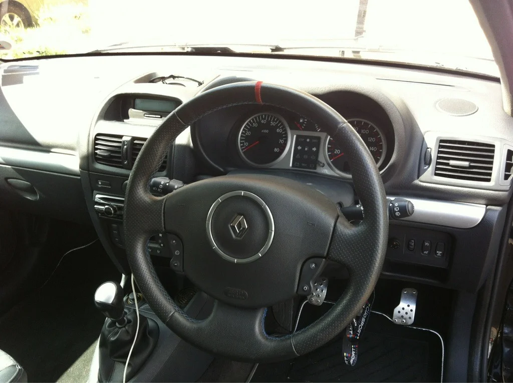

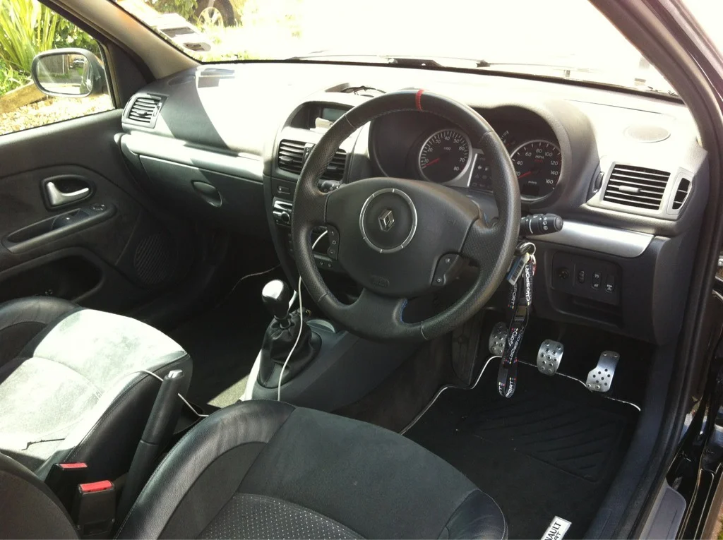

The car drives so much better with it, sounds weird really.
The wheel is skinner to hold so doesn't feel like a buss anymore either.
