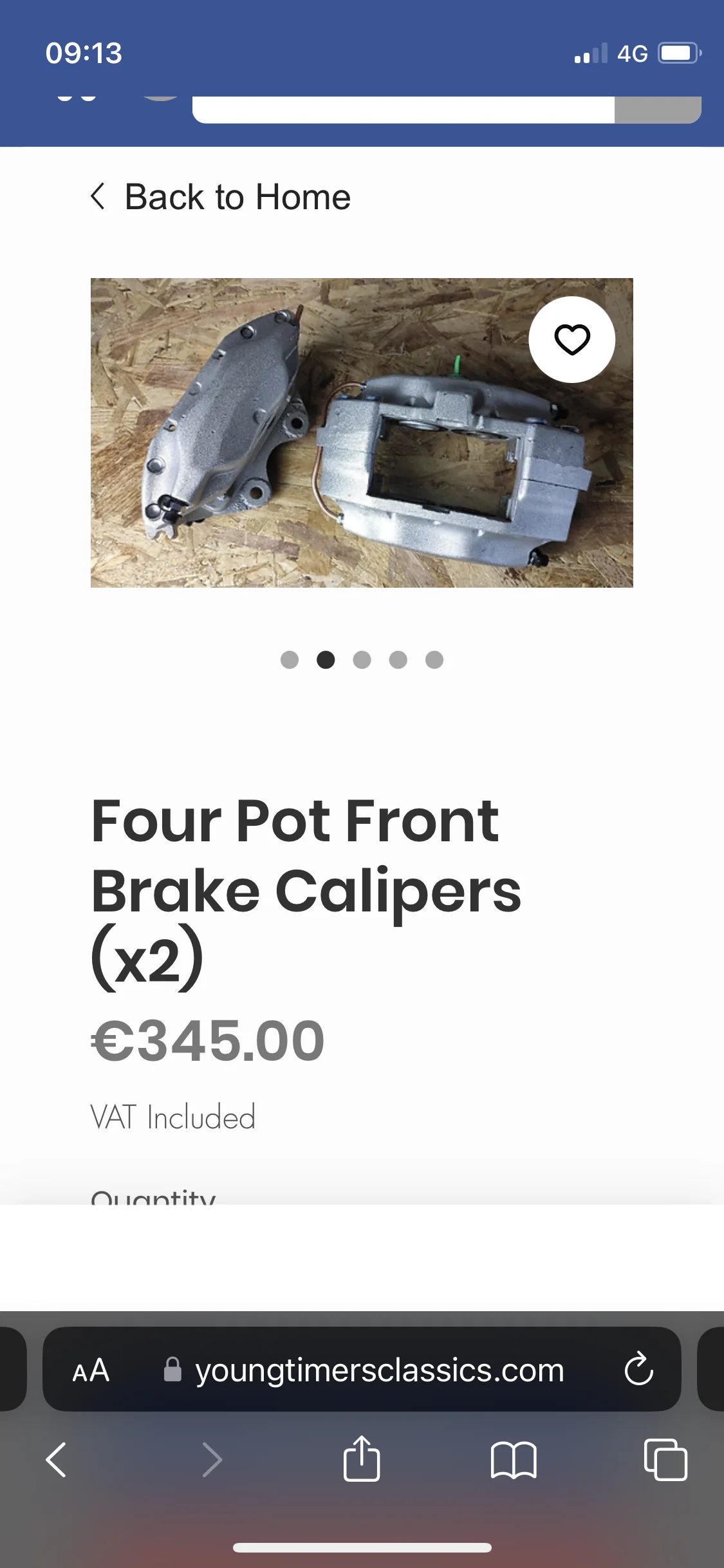

Has anyone fitted these? Or know if they are worth while?
Depends if you want them for looks or performance. The pic isn't very good but they look like they're the same Brembo calipers from the Peugeot 406 V6 which a lot of people have fitted over the years, you'll find that the pedal travel will increase with them unless you change to a different master cylinder.
If you're after a genuine upgrade in performance, the best route to go down is converting to the setup from the 172, have a look through this thread, it has details of the conversion in there plus lots of people have done it too https://cliosport.net/threads/mk1-f...chassis-rebuild.364502/page-132#post-11242040
It's a better route to go down because there's a lot of mega high quality performance pads available these days that outperform a lot of the 4 pots unless you're going for monster size discs etc

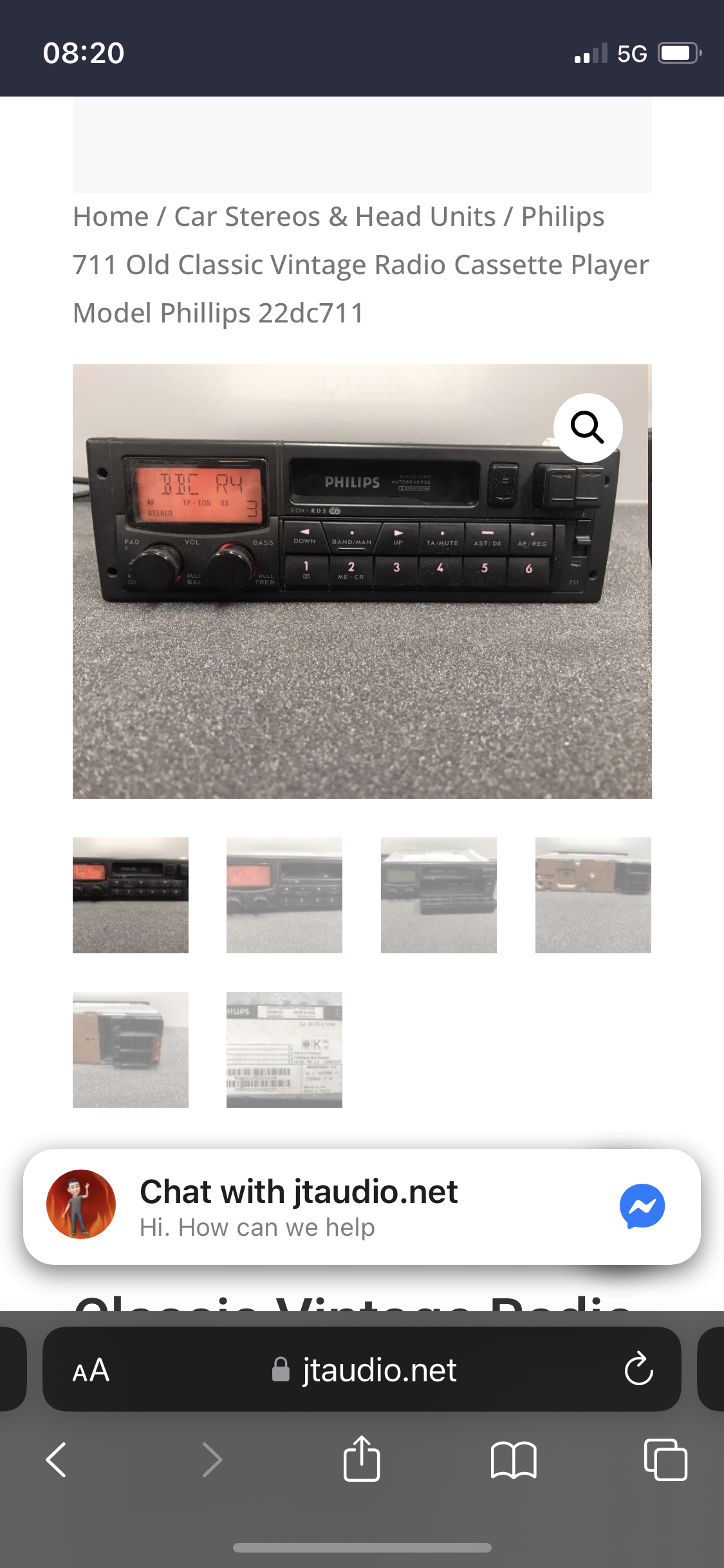

Does Anyone know if this is the correct radio for a phase 1?

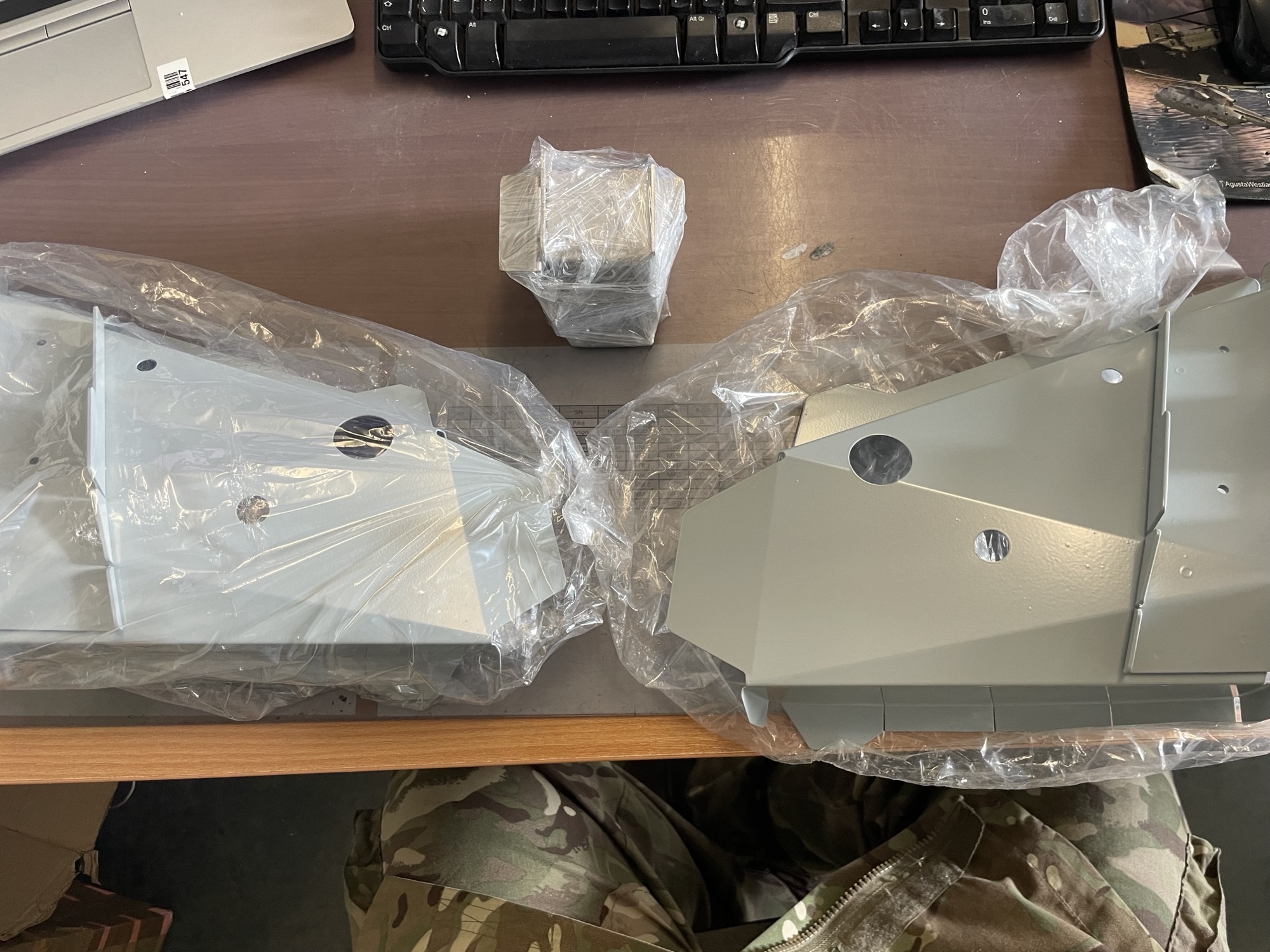

Latest bits came this week:
.Heat shield which I plan to refurb or use to make a new one from carbon Kevlar
.Engine mount cover
.Neg battery terminal
.Radio cover
still saving for more body panels but as things come up for sale I need to grab them. Did miss out on the williams subframe this week though.
