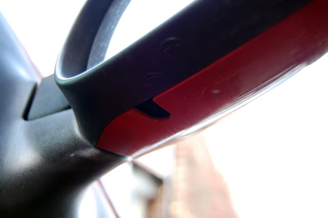

FlameR Car Mk4 .:R32 Oct 18, 2007 #1 Anyone found a solution to the whistling noise at high speeds?? Ste

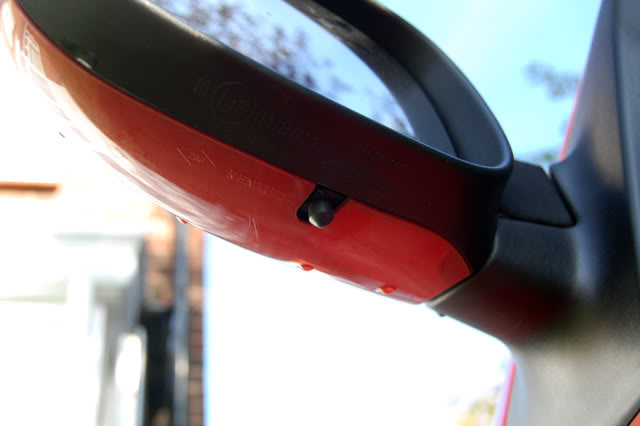

Andi-B Car Meggy Mk4 1.6DCI 160 Oct 18, 2007 #2 Might be one of two things, your wipers or your drivers side mirror. Your drivers side mirror has a hole underneath.. passenger side has the hole but the temp sensor fills it.. cover or fill the hole

Christopher ClioSport Club Member Car Z4M Oct 20, 2007 #4 it's the mirrors, they all do it. try running a bit of black electrical tape long the bottom edge of the mirror, it solved mine!

FlameR Car Mk4 .:R32 Oct 22, 2007 #9 I'm going to try covering the holes up tonight If that doesn't work, might think about getting the wind screen re-sealed
