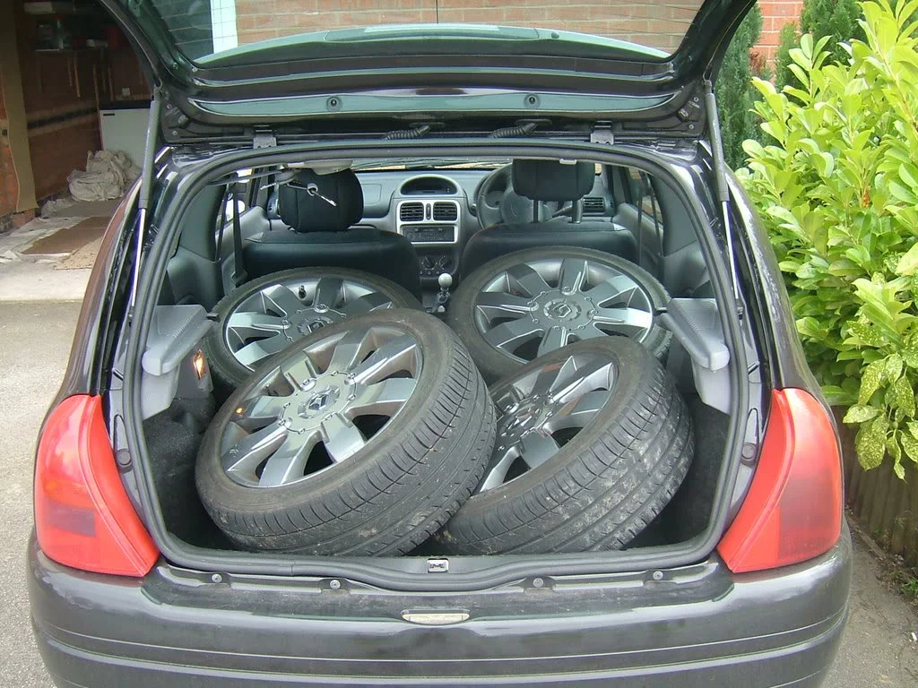

Went on abit of a road trip to pick my new alloys up (will post some pics when ive got them on) so was about 200 miles from home when...........

Was a good trip though got myself a nice set of 182 cup alloys + tires for £360 which i reckon is a pretty good deal!!
