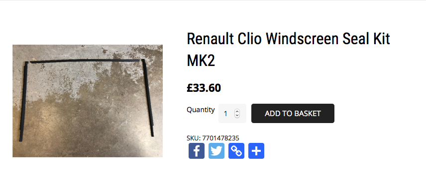

They come as the complete side pieces from RPD, not too expensive

Can these be fitted with the screen in place? Always thought you could only do it with it out. Might be wrong
cat171
Can do yeah, but I've heard that they're a sod to do and required a lot of whacking!
Gus
  182Turbo,DCi90
It's almost impossible to do this with the windscreen in place. The top one is the hardest. I wouldn't touch it personally. Keep sticking it down.
1985michael182
Yea windscreen out job. How much is your windscreen XS? Usually £50-80 crack your screen on the passenger side so you can still see to drive and claim on the screen insurance. New stonechip free screen and new rubbers all in one go! Simples
