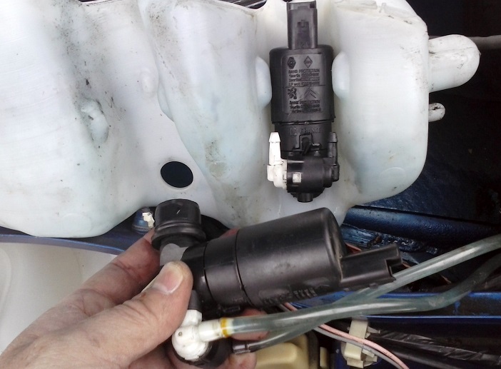

Windscreen washer pump, correct one?
  Blk/Gold 182 FF
  CursedTitanium 182FF
you have the wrong one, if the motor still works on the old one, just try and swap over the valve part near your thumb in the pic.
  Blk/Gold 182 FF
Bugger! The eBay shop said clio mk2 lol my fault for not doing thus research before the purchase! I need to get a wiper removal tool anyway as mine are properly stuck! I'll get a new pump at the same time I think
  Blk/Gold 182 FF
Just ordered one from ecp, 50% off as well I think! Also bought a removal tool for the wipers of eBay. Hopefully get them off that way!
