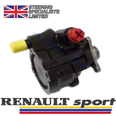

Hi Guys,
Just wondering if anyone has ever bought one of these refurbished PAS pumps from eBay?
Mine has been sounding like a supercharger for about 5 years now and as by belts are due I figured I should get it sorted at the same time. Birchdown have said that new genuine ones are no longer available.

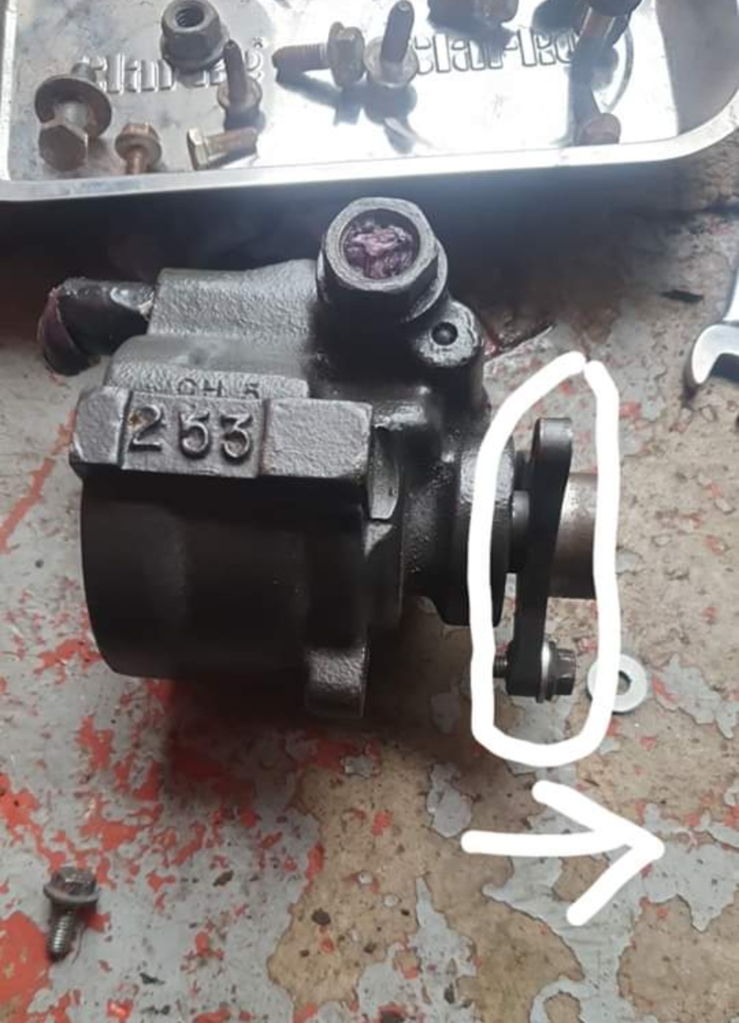

Just be careful to compare it to the one you are taking off. Mine has the mounting for the pulley fitted too far in so it misaligns my belt.

When you remove the hub that the pulley bolts to, be careful not to bend it.
Also need to get the spacing correct so that it doesn't misalign the belt like @RichValver said.

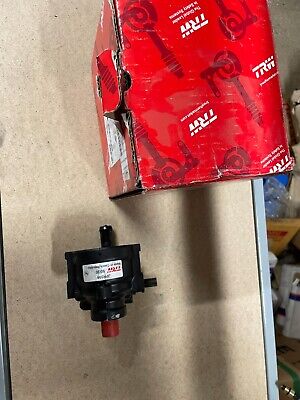

I had an absolute mare with my eBay pump (same as the one you pictured, same company).
It was noisier than the one it replaced, it was fully bled, new fluid (twice), shat it's orings when the fluid boiled 3 laps into brands hatch.
Company refused to take it back, didn't give a toss.
I think they just change bearings and seals then lash some horrid thick black paint over them. Would I buy another one? f**k no.

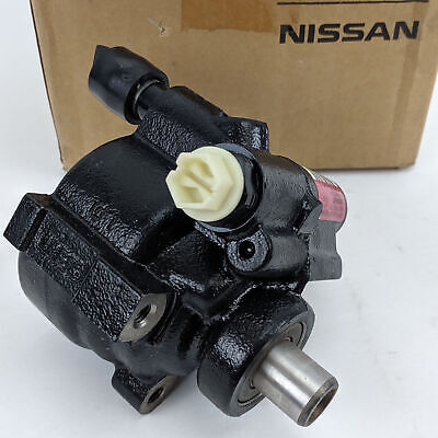

You can still find OEM pumps, Nissan (among many others) used the same pump for not a lot more money.

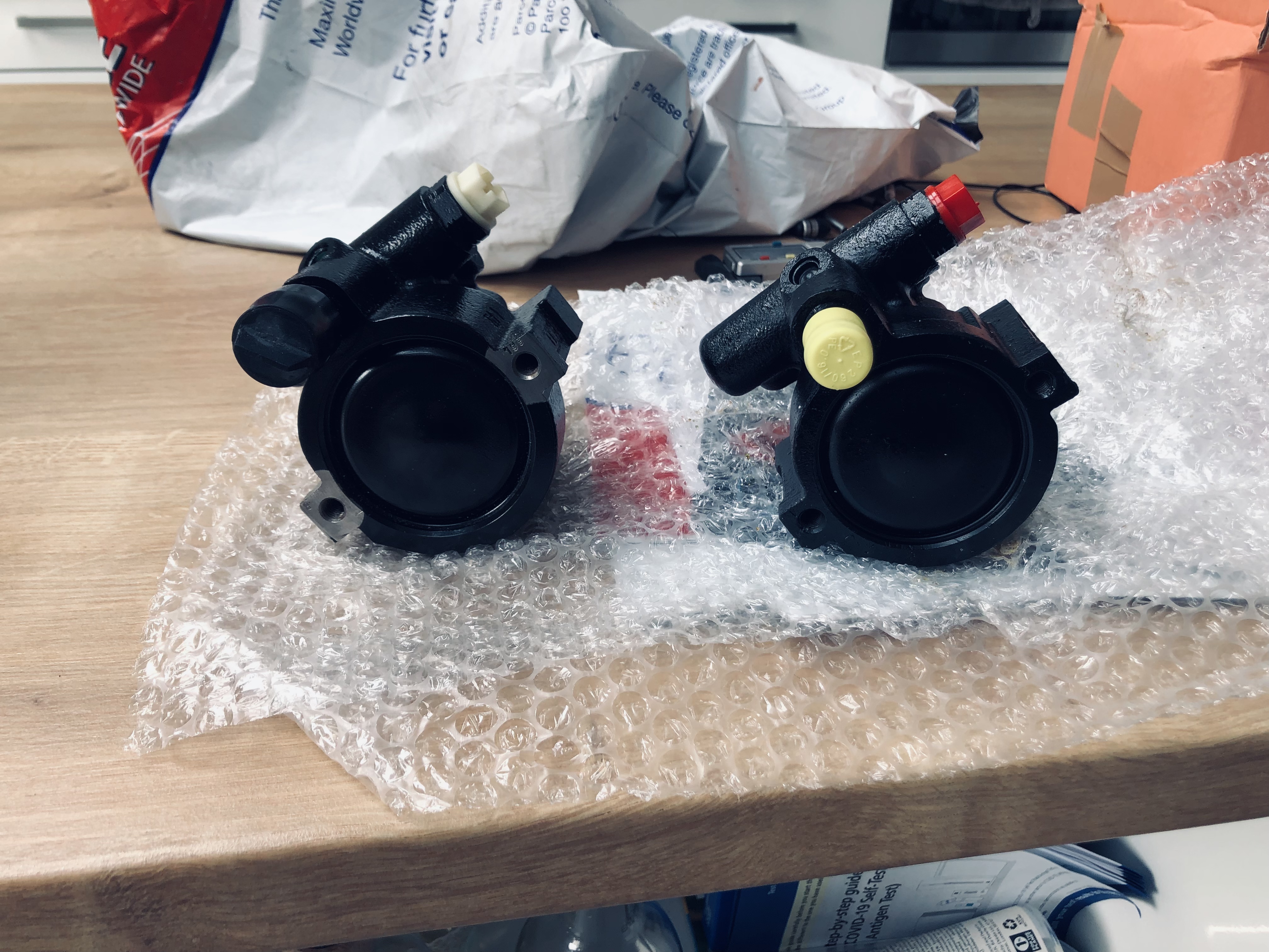

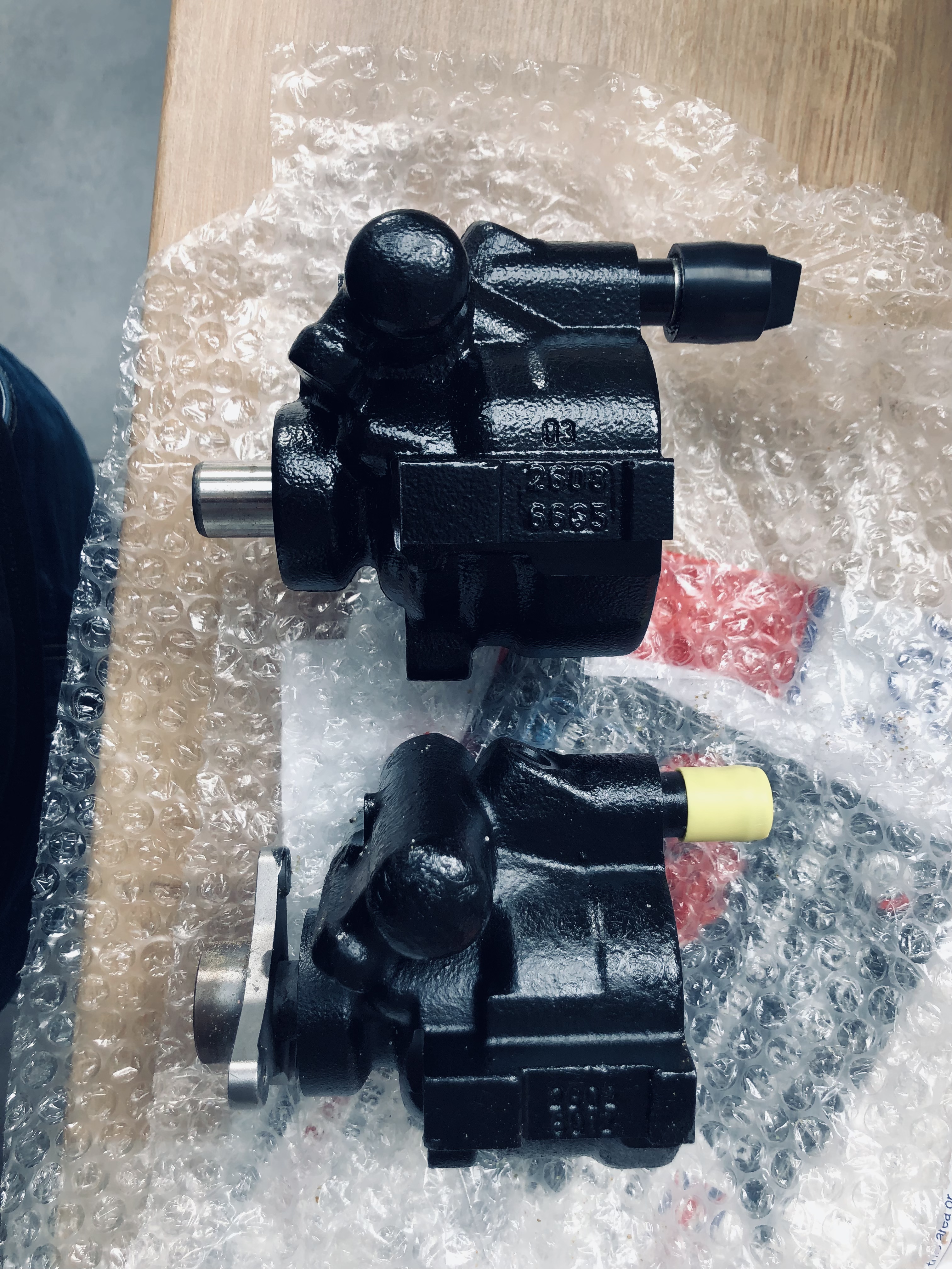

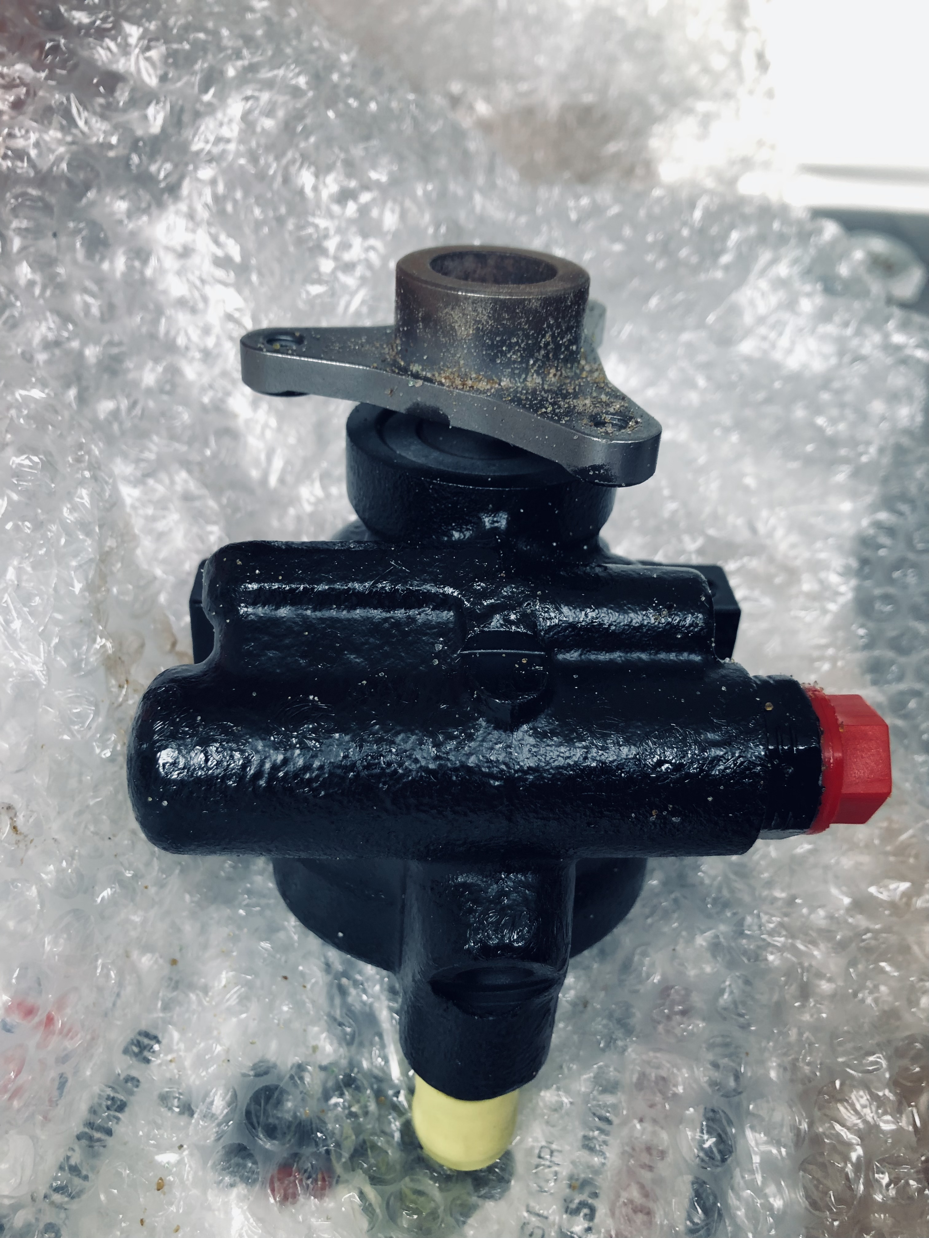

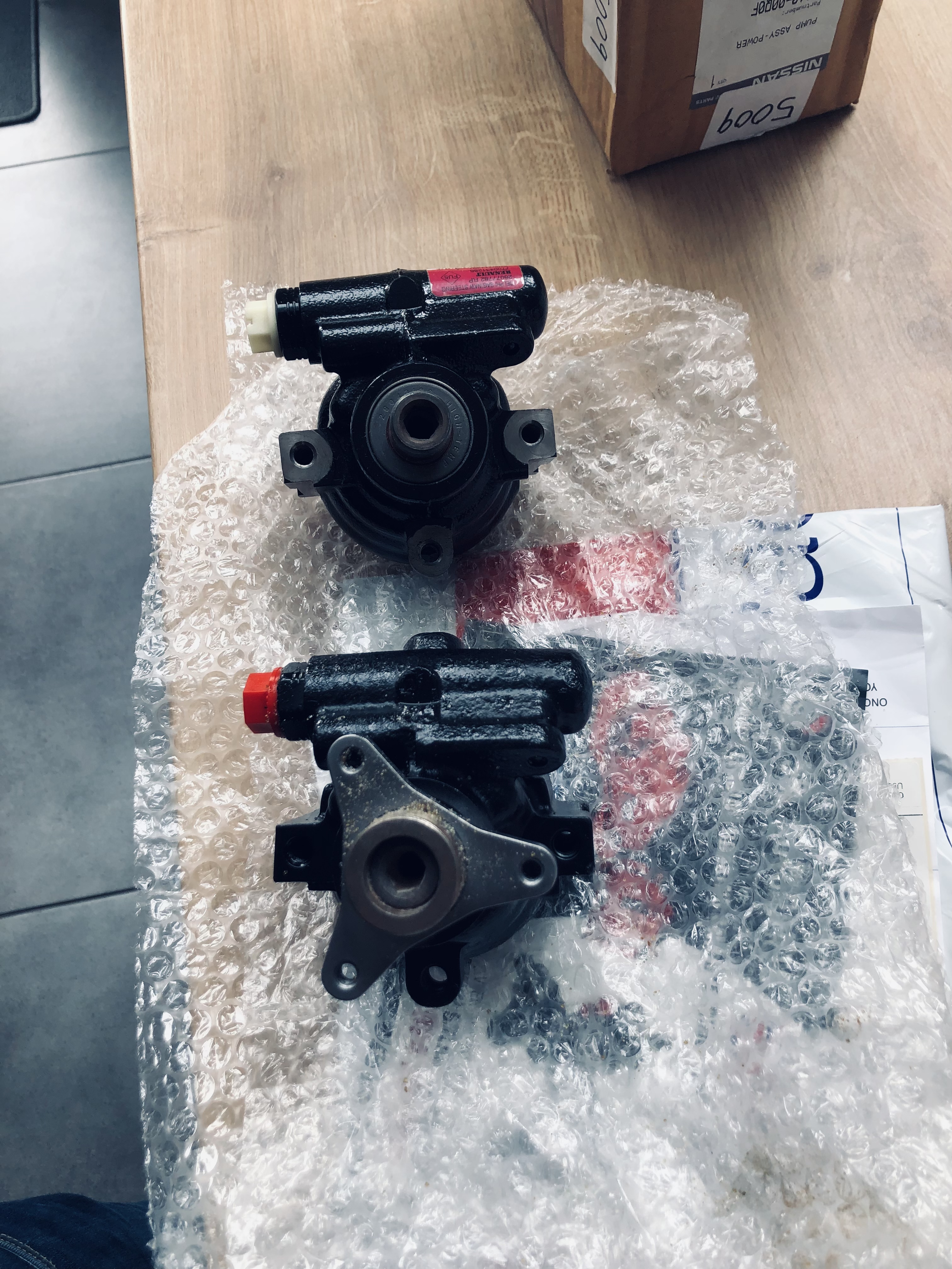

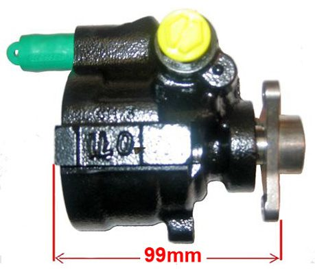

So I got a remanufactured ebay pump and the ‘Nissan’ one side by side and they look identical and the bolt holes have the same spacing.
The ebay one turned up with some sandy s**t all over it though, wtf is that?
Does anyone know if you need specialist tools to press on the flange for the pulley to bolt on to? @Touring_Rob
‘Nissan’ pump has Renault part numbers:
7700431286
8200711391

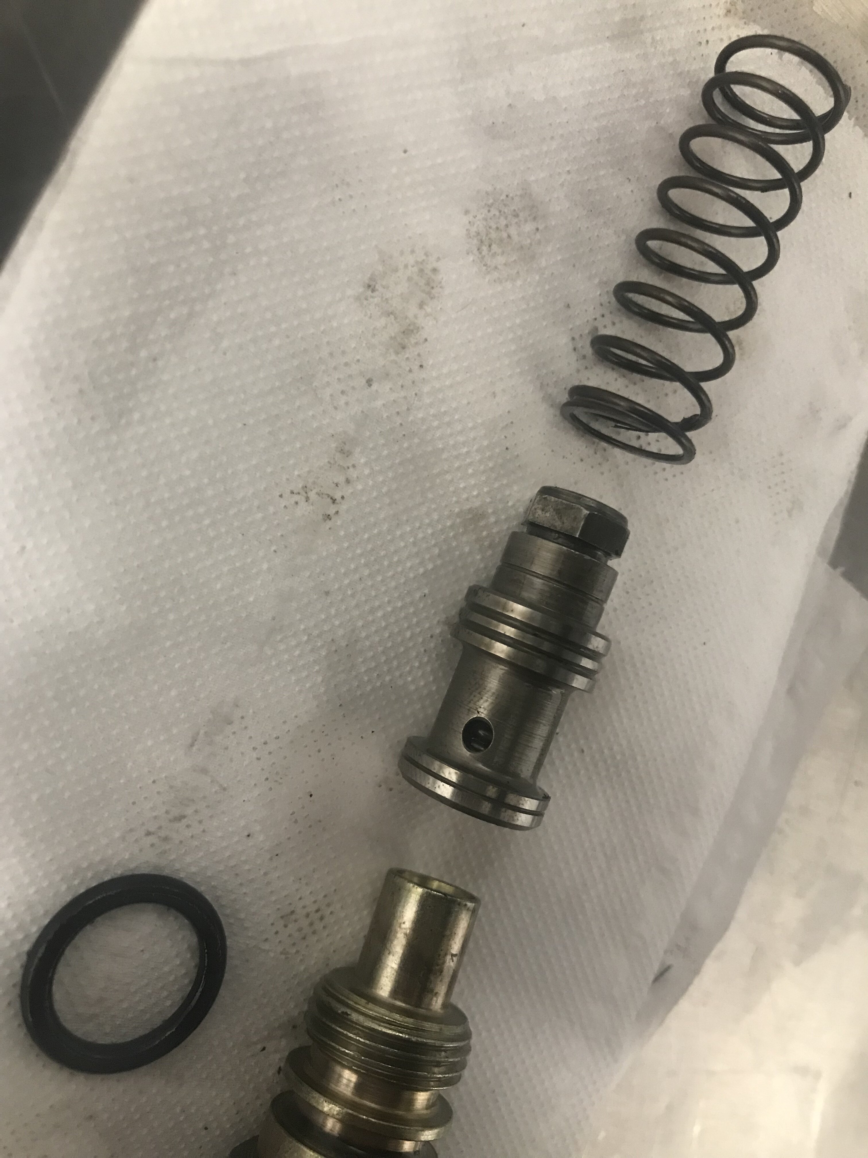

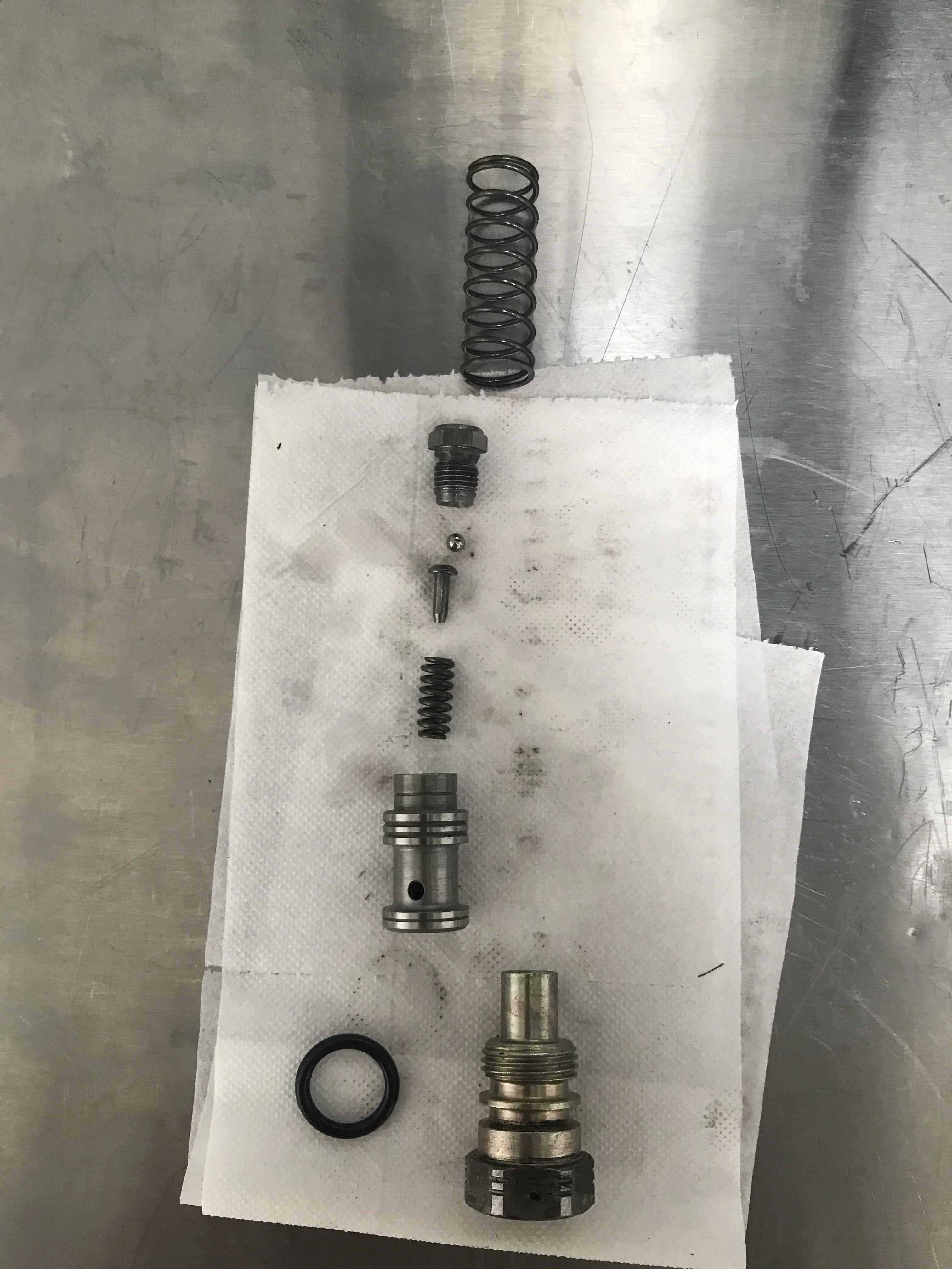

The pressure relief might also be set differently however I do not believe that to be the case, and even if it were I would ignore it.

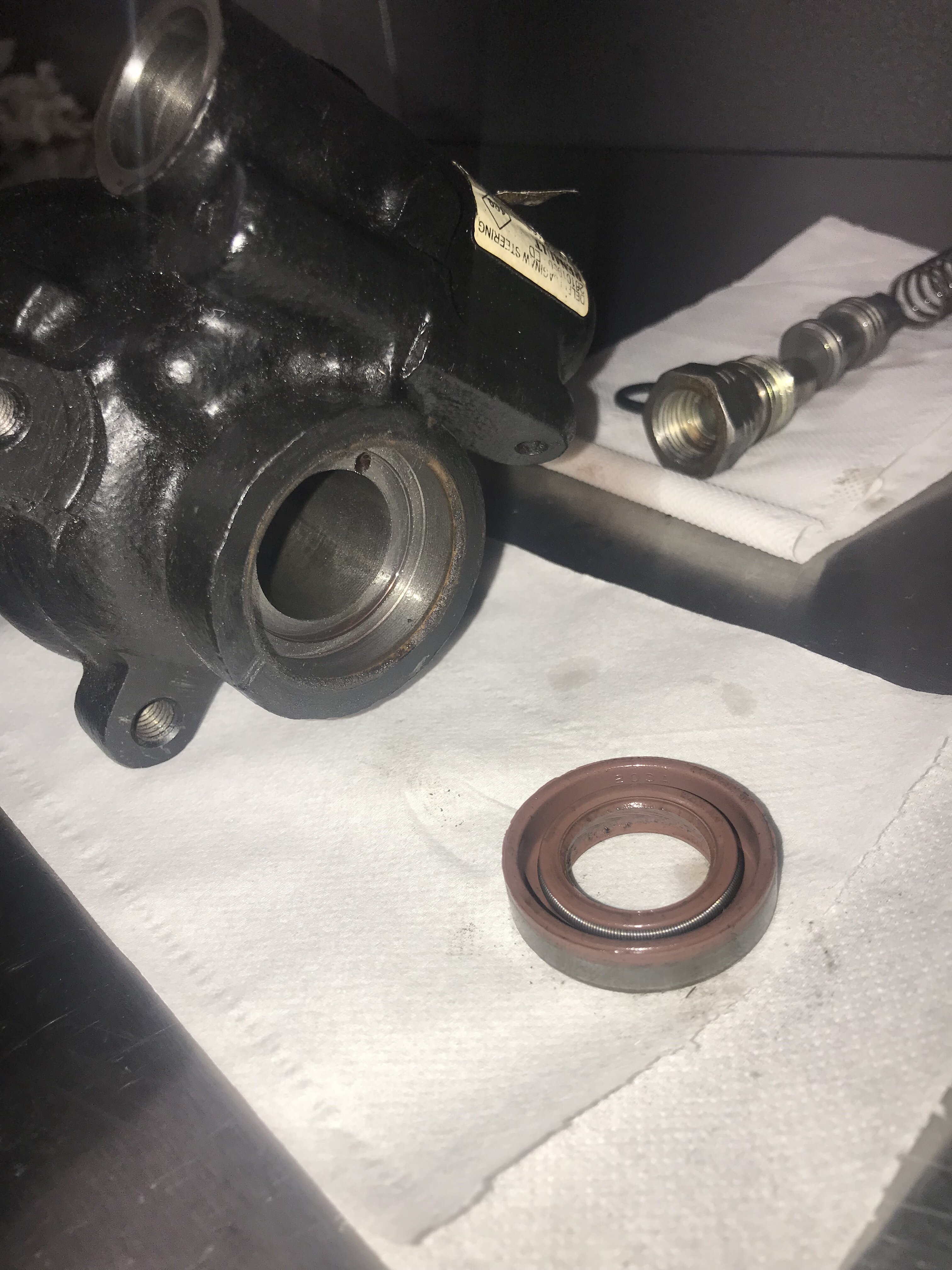

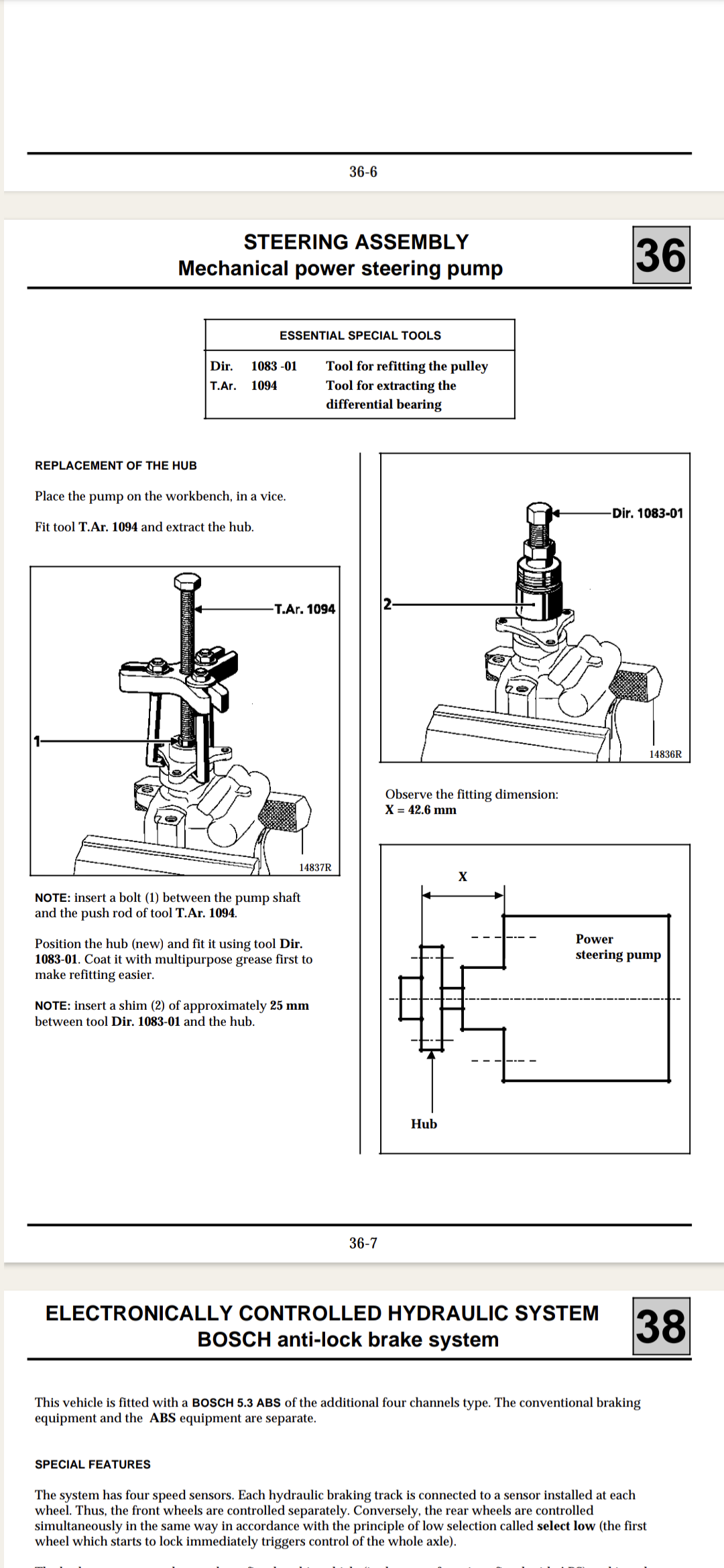

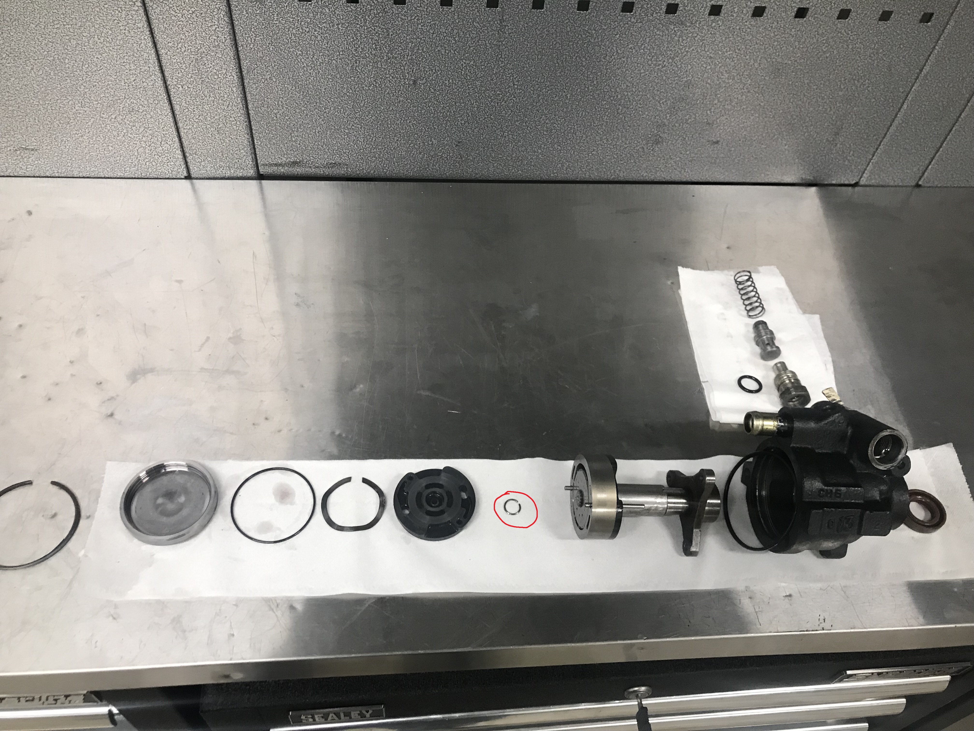

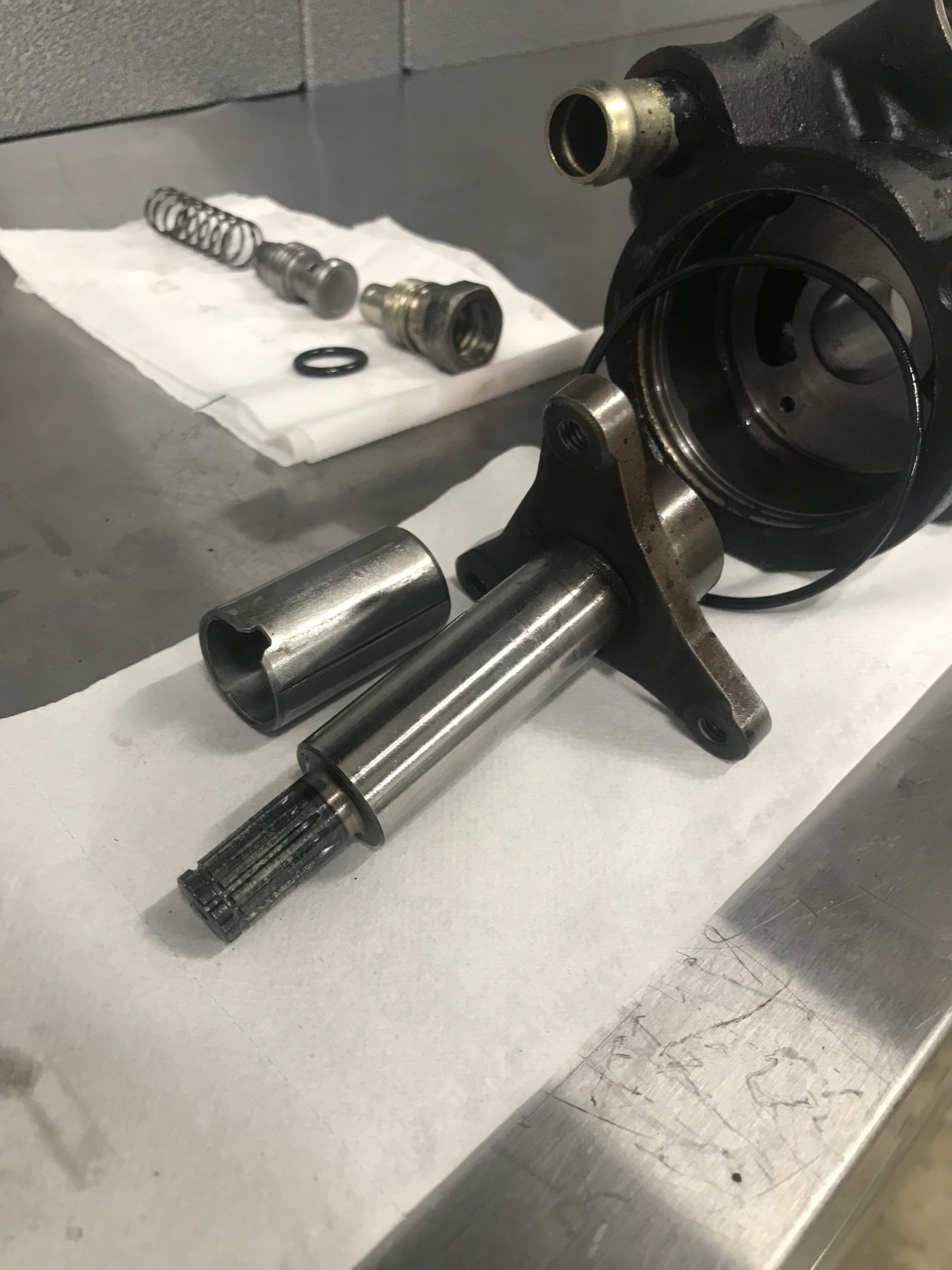

Do you have access to a press? Or a friendly garage near by? The flange is pretty easy to get off with a press. I used a 3 legged puller to remove it and a press to install it.
Note - I don't like the idea of just pressing on the shaft with the body flat on the press table, as all the force from the press is pushing the pump back in the pump body against a little circlip - instead I popped the round cover off the back so I could put a block right on the end of the shaft... if that makes sense - its very quick and easy with the parts in your hands.
I take if the Nissan pump works you will back the eBay refurb pump, or are you using the refurb flange?

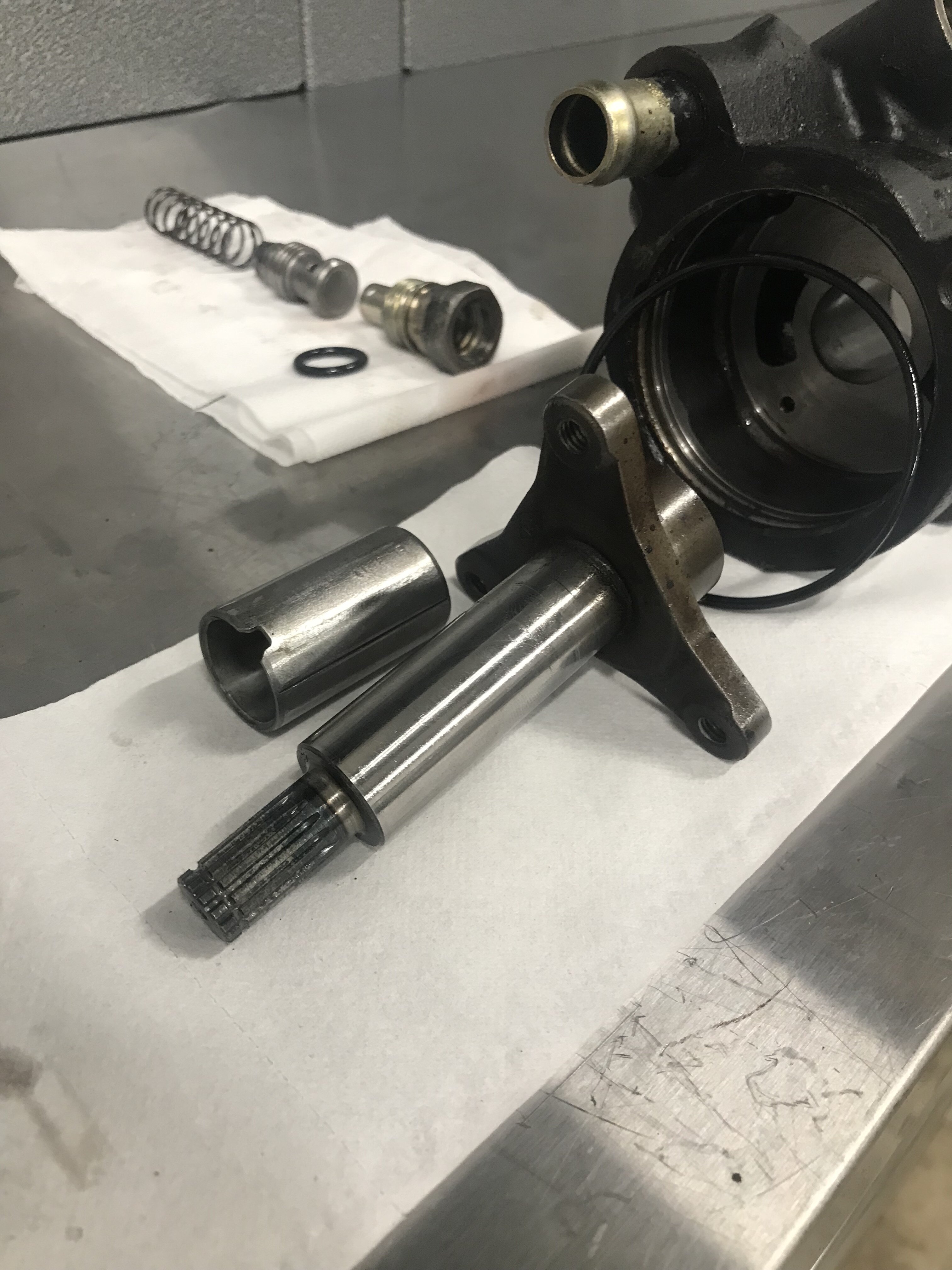

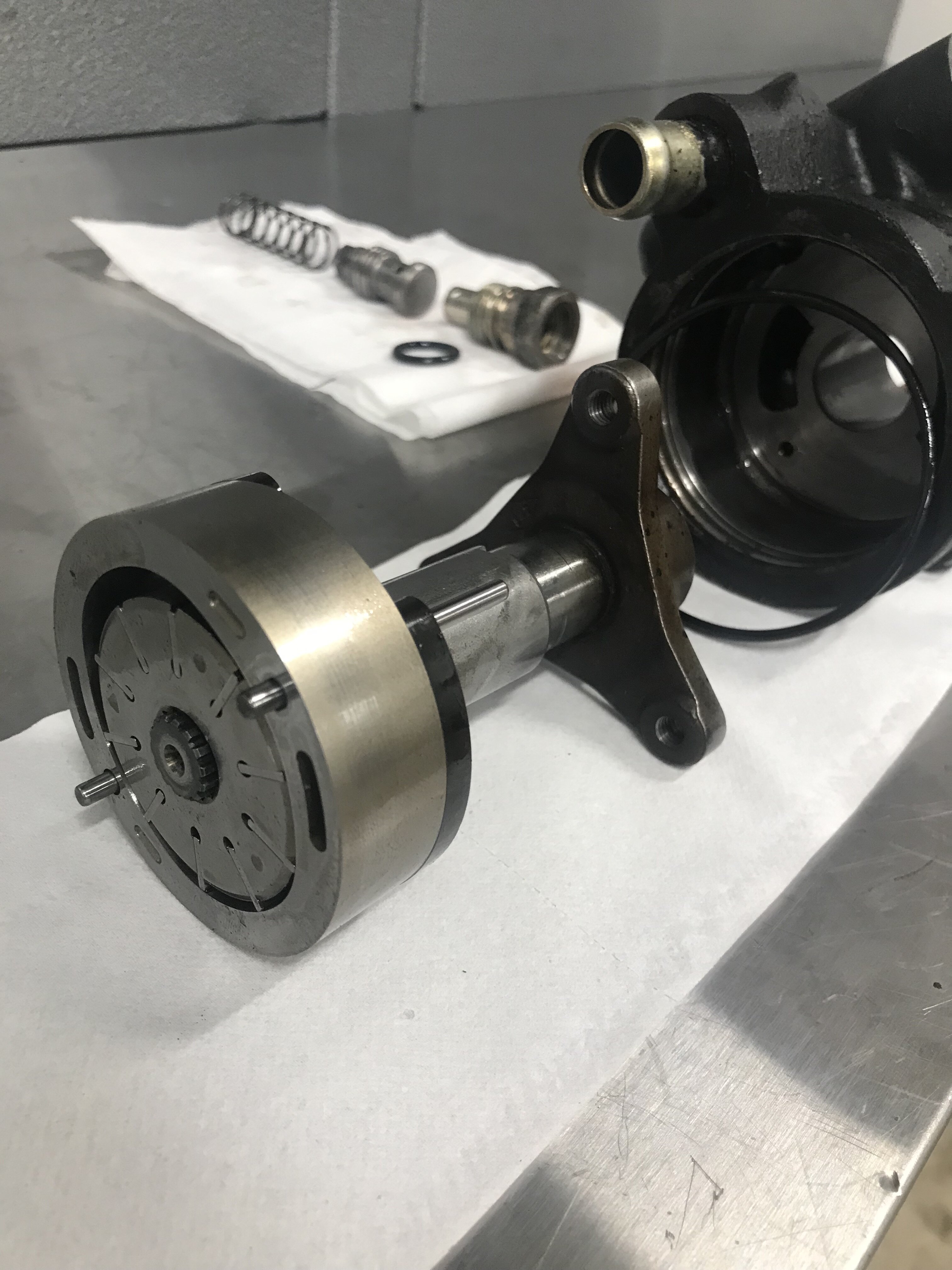

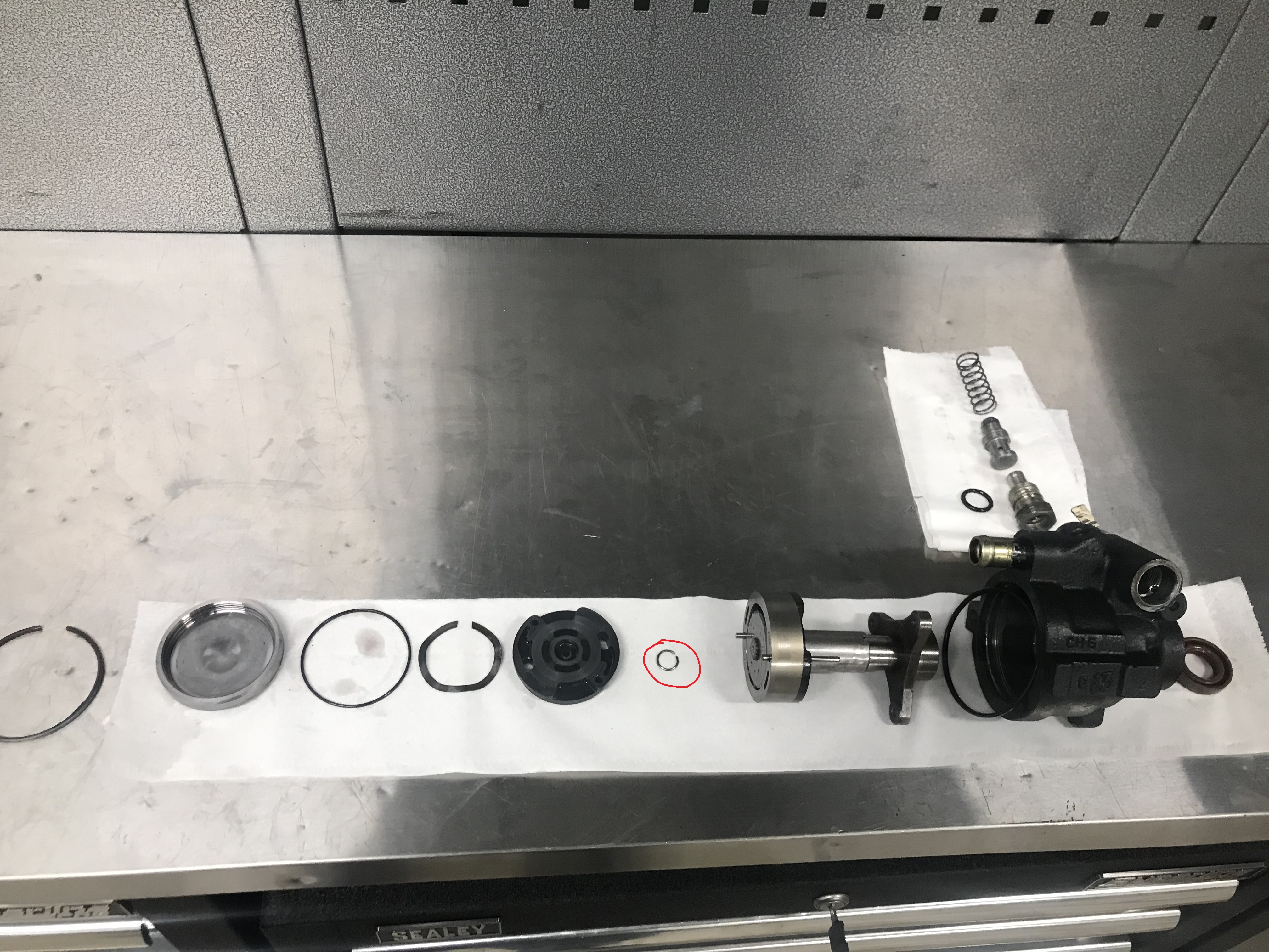

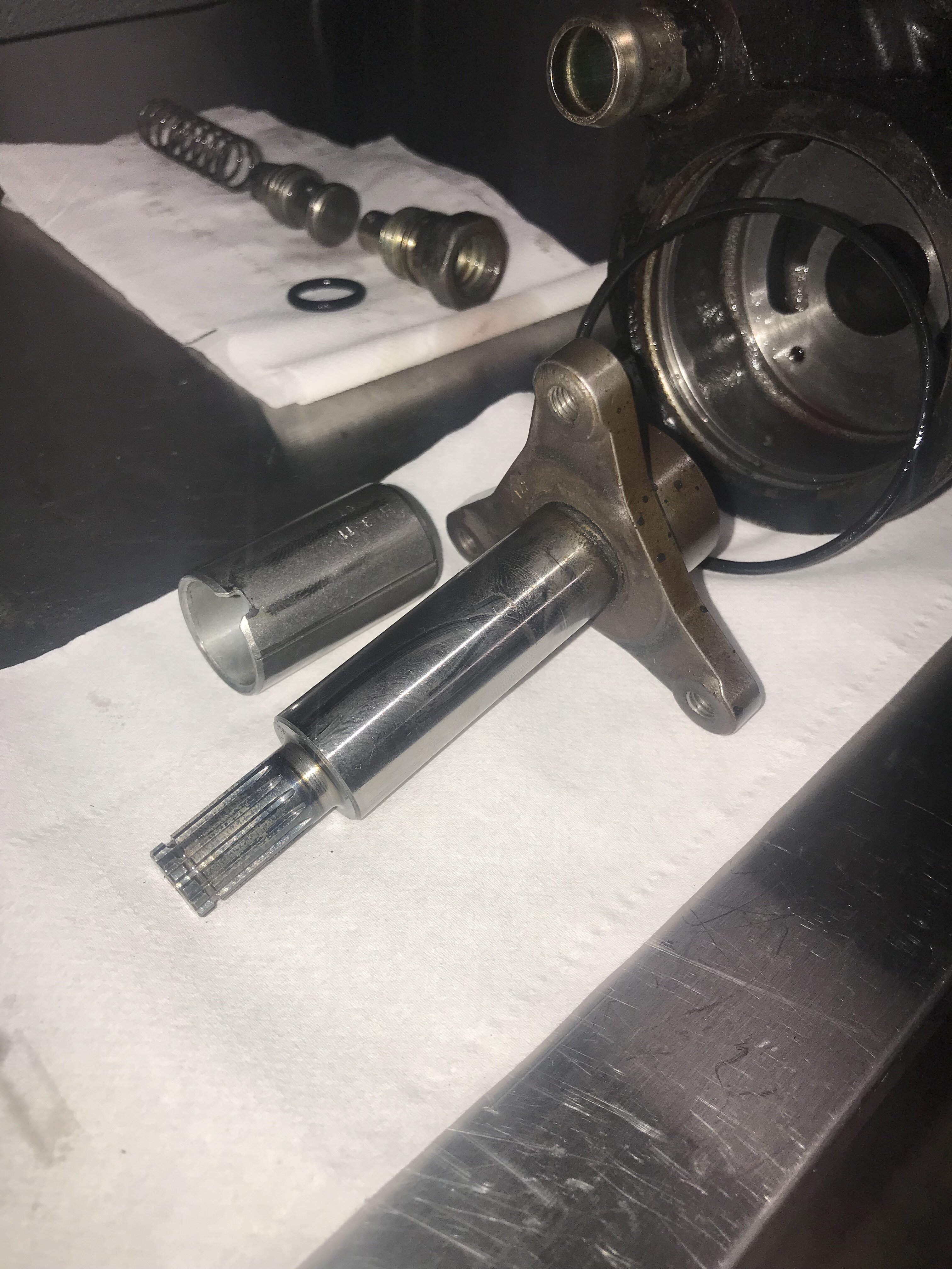

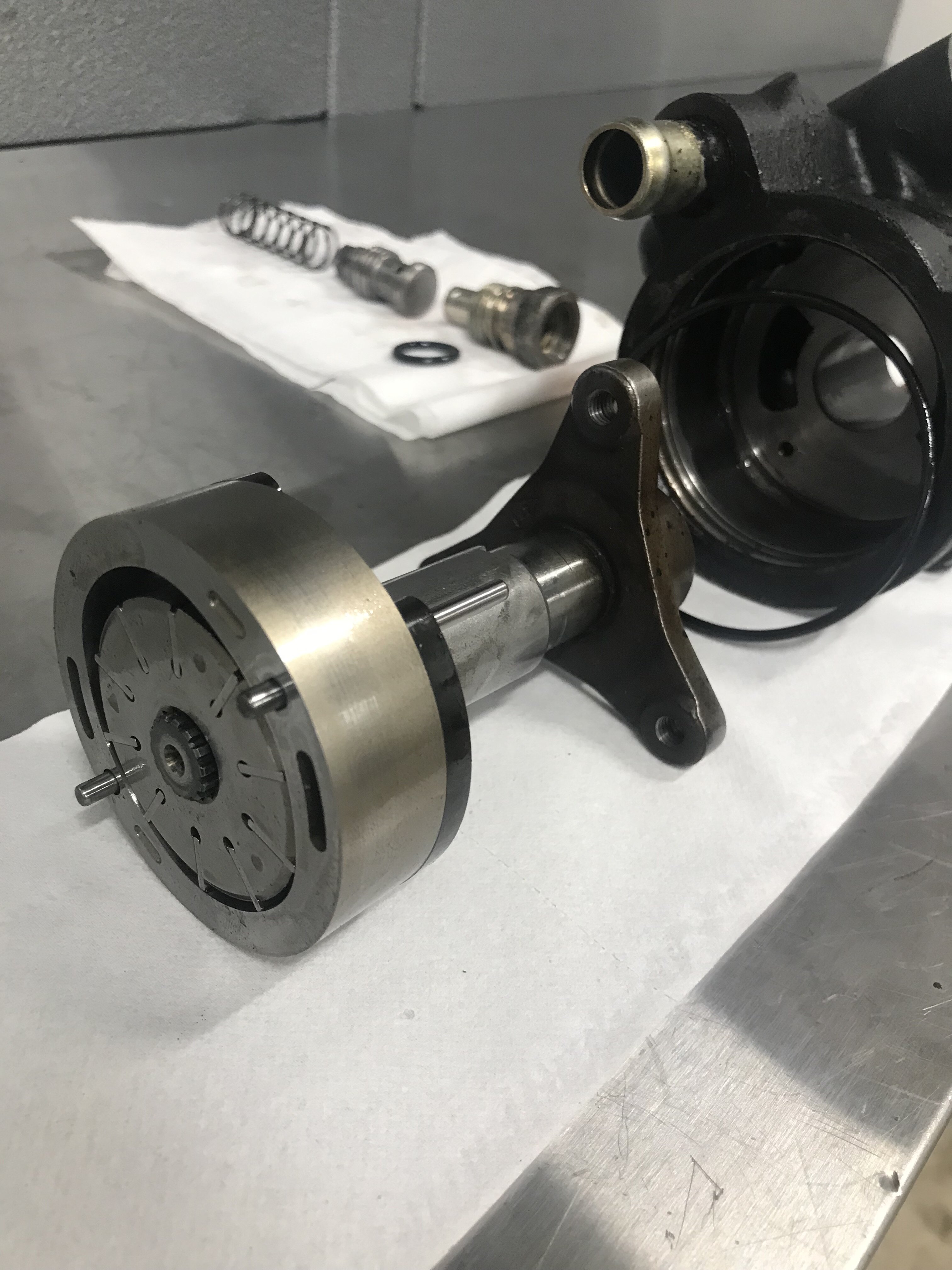

The little cover at the back is dead easy to pop off - from memory there is a little retaining ring/clip that pops out. @Beauvais Motorsport recently sent me some nice pictures which show this while we were discussing something different about pumps - if its ok with him I can post them here, he also knows a load more about PAS than me...

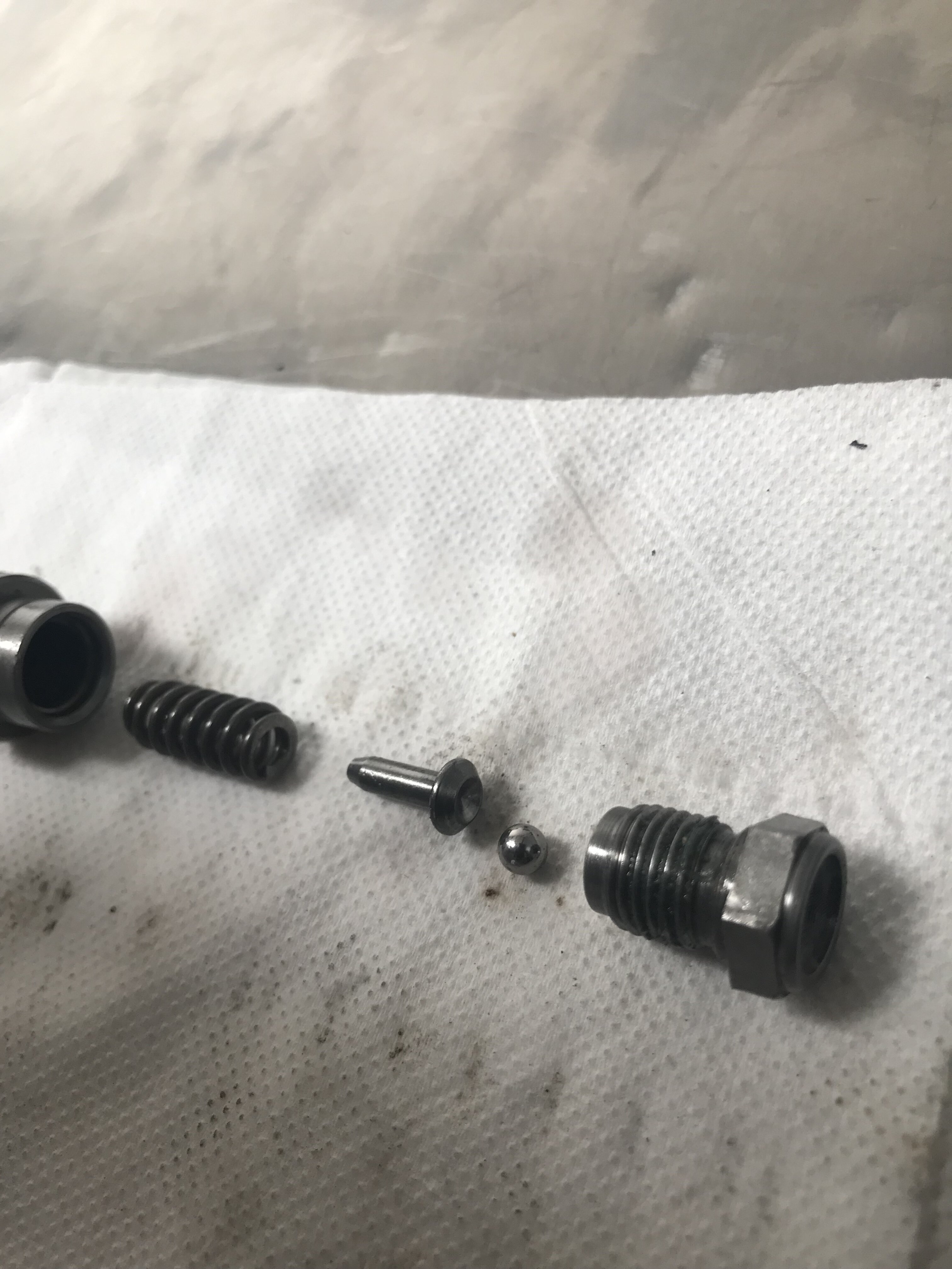

I believe the pressure relief sets pump working pressure which might alter steering weight. Even if the set pressure if a little different I would still choose to install the new OEM pump compared to the rebuilt pump given my experience with them - I really don't think they rebuild the actual pump section and just replace the nose bearing and seals - might me wrong but mine was 100% fucked out the box.

Ah right that makes sense. I agree with you there, I won't mind if the steering weight changes a little bit and would rather have the pump sorted for another 18 years. Is it something that can be adjusted? Would interested to see the pictures.
I've never tracked it and I don't plan on doing more than a few track days so I'm not too worried about the cooler but thanks for the tip.
I will take apart the valve when Im next at the unit. @Touring_Rob Did you fit the new pump and felt any difference? If engines out you can easily remove the valve (careful as spring loaded) from both pumps and check with verniers the dimensions. Inside the valve are shims which can be easily replaced with difference sizes.

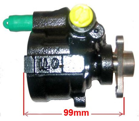

Seeing as the Nissan pump above is out of stock and hard to find on eBay, I've been looking at other Clio specific ones. A lot of saying "non aircon cars only".
Is there a difference in the pumps or is this just an error?
I'm having no luck with a puller on my pump. Do you think some washers to space it out would be OK or not? Its about 4mm out compared to my old one 😩

As a heads up, I fitted an alloy bodied pump which had correct part numbers for the Clio and it was noisy... I think it was the alloy pump I blew the shaft seal out on at brands.
Not saying all of them will be poor quality but I am always dubious about these kinds of brands as I figure they all have the same original manufacturer.
Ah b*ll*cks. Trying to get it sorted this week. So is eBay recon better?
My head is spinning with options. This is the kind of stuff that's starting to get on my t*ts with the Clio.

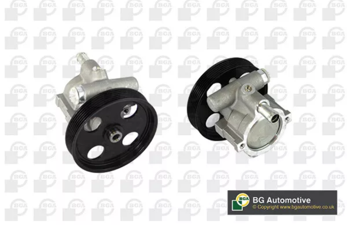

I am not saying you should or should not buy this - I've just glanced at it however I would personally feel much happier buying a pump from from someone like TRW assuming you can't get a genuine Nissan/Vauxhall/Renault one.
