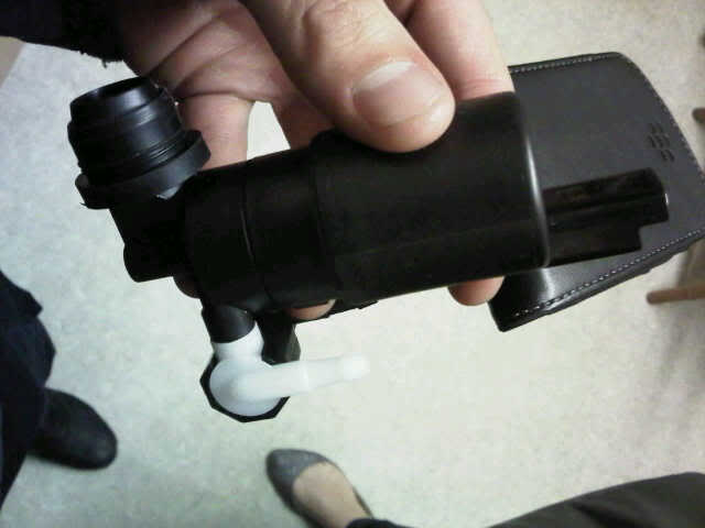

After GSF gave me the wrong pump, which they assured me was the "correct" one....it wasn't. I've bought one off ebay, its listed as '05 model. But am i right in thinking that even though its for an '05 clio sport, itll be alright for an '02 clio sport. (hope so lol)
also which side (as you look at the bottle) is the pump for the screen washers?

this is the pump ive got
hope its the right one. And thanks for lettting me know which side pal
was the right pump, the rubber seal was a different shape but used the original in the hole instead. can now wash my screen again :-)
