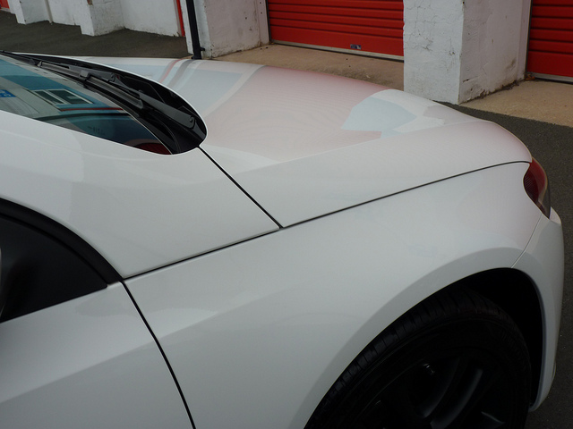

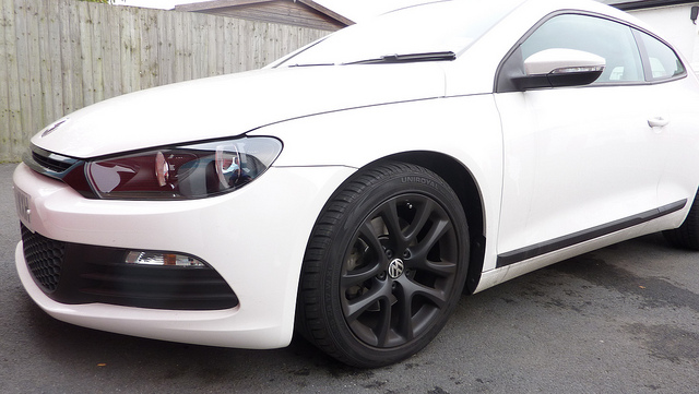

Some befores:
P1060523 by RussZS, on Flickr
P1060524 by RussZS, on Flickr
P1060525 by RussZS, on Flickr
P1060526 by RussZS, on Flickr

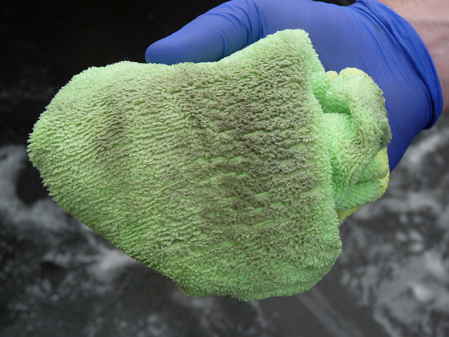

The car was then hand washed with Lather and Lambswool Wash Mitt, then rinsed.

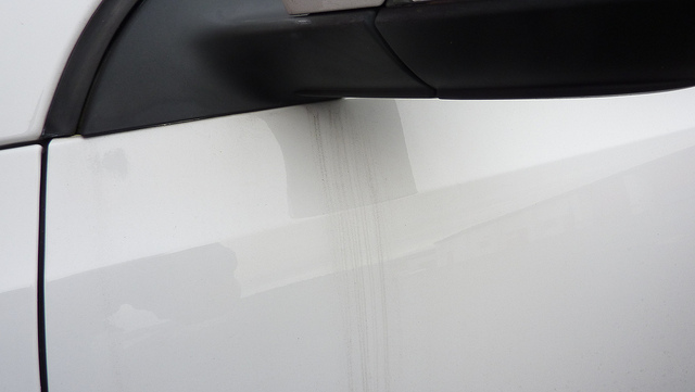

Next up, we attacked the Tar with Tardis:
P1040034 by RussZS, on Flickr
P1040035 by RussZS, on Flickr
P1040033 by RussZS, on Flickr
The car was then rinsed.

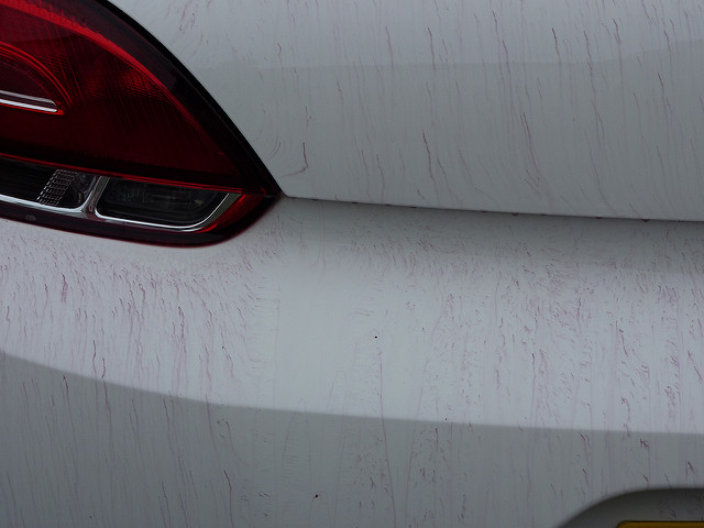

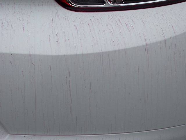

It was evident at this point, that the paintwork was LITTERED with small iron particles, orange in colour.
I had Autobrite's Purple Rain in my collection, so I began using this and working my way around the car.
It's quite slow to begin working, but when it does, the results look good:
P1040052 by RussZS, on Flickr
We decided to do a 50/50 between Iron X (right side) and Purple Rain (left side)
Quite a difference here:
P1040046 by RussZS, on Flickr
Iron X side:
P1040047 by RussZS, on Flickr
Purple Rain side:
P1040048 by RussZS, on Flickr
This pic was taken after a 7 minute dwell time.
I personally much prefer the watery consistency of IronX, as you seem to use much less product, and I like the way it runs down the paint. Also, it reacts far more quickly than Purple Rain.

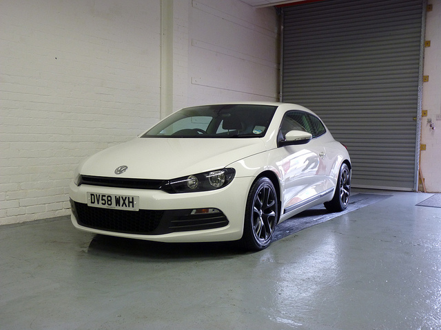

The car was moved inside for claying, with Glide and AF Clay:
P1040067 by RussZS, on Flickr
It didn't pick much up and no pics of the clay used I'm afraid (I was in a rush!)

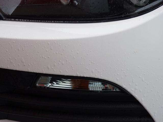

Then two coats of Tough Coat via applicator:
P1040072 by RussZS, on Flickr

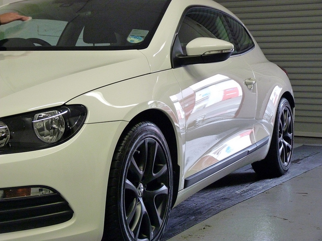

and the afters....
P1040074 by RussZS, on Flickr
P1040075 by RussZS, on Flickr
P1040082 by RussZS, on Flickr
P1040083 by RussZS, on Flickr
P1040084 by RussZS, on Flickr
P1040085 by RussZS, on Flickr

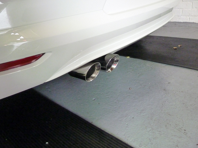

Optimum Metal Polish on the exhaust:
P1040086 by RussZS, on Flickr
P1040091 by RussZS, on Flickr
P1040095 by RussZS, on Flickr
P1040096 by RussZS, on Flickr
P1040098 by RussZS, on Flickr
P1040100 by RussZS, on Flickr
