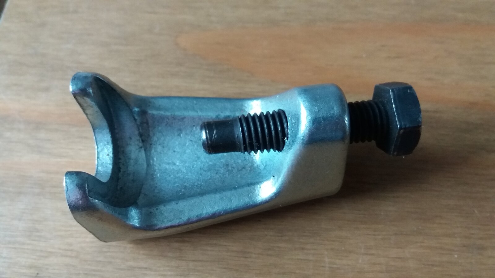

As said above. Give them a good soaking in wd40 first. Then get yourself one of these gear pullers from Halfords, it cost about 9 quid.
A good tip that @Darren S said and it does makes it easy to pull the arms off is to lift the actual wiper away from the windscreen. Mine had never been off before in 12 years and they came off a piece of piss. A bit of copper grease on the threads after should make them easy to take off next time.

Yeah I used that tool above, the end of it split and bend out of shape on the first try. Maybe mine were just really bad but they needed some brute force. Hopefully yours will be easier :)
