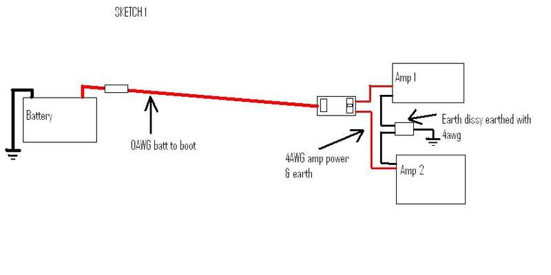

A quick sketch to show basic layout, ignore cable sizes and fuse ratings, simply use items suitable for yours...
Supply links to your amps and I will post what sizes/ratings you actually require...

one thing from that sketch wallop is that the earth from the earth distribution block to chassis should really be the same size as the main feed from the battery
