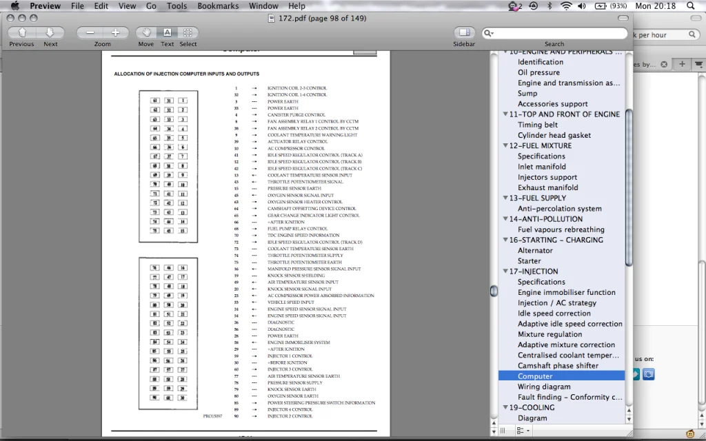

Wiring diagram for the ecu plug!
What is this program ? I have Clio Mk2 1.2 58HP D7F726 and have problem with map wiring. I cant find any repair manual.
