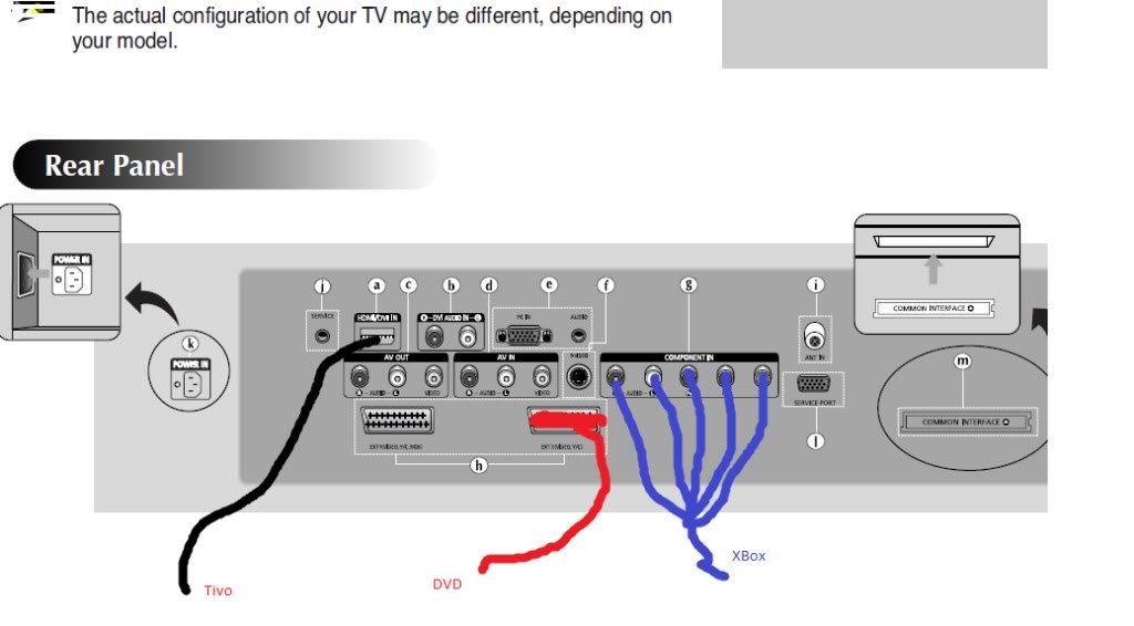

This is going to sound really dumb but how do I go about wiring it all up?
I'll explain.
I used to have this.
So TiVo into the Hdmi, Xbox into the Component and DVD into the SCART.
Now I want to get this....
http://www.richersounds.com/product/speaker-packages/onkyo/htx22hdx/onky-htx22hdx-blk
and add a blu ray player. How do I go about wiring it up so the speakers can be used for the TiVo and blu ray player. Do I have a problem because I've only got one HDMI slot?

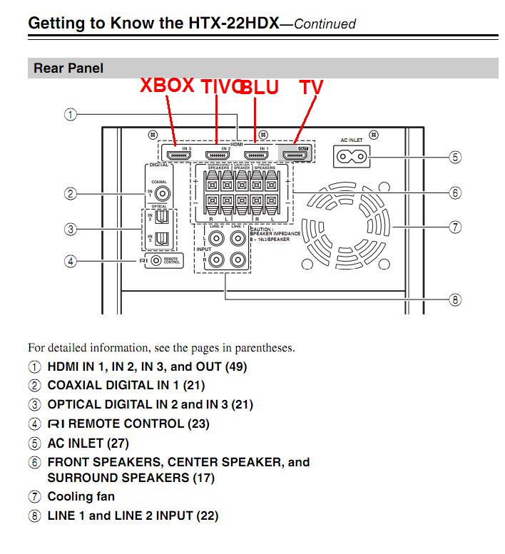

Simples!
One HDMI out, 3 in.

Yup, all you need to do is connect the main unit to the TV with HDMI.
Leave it on and switch inputs as you go.
Its either that or a new TV. This essentially saves you money by adding functionality to your TV.

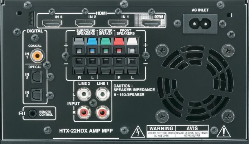

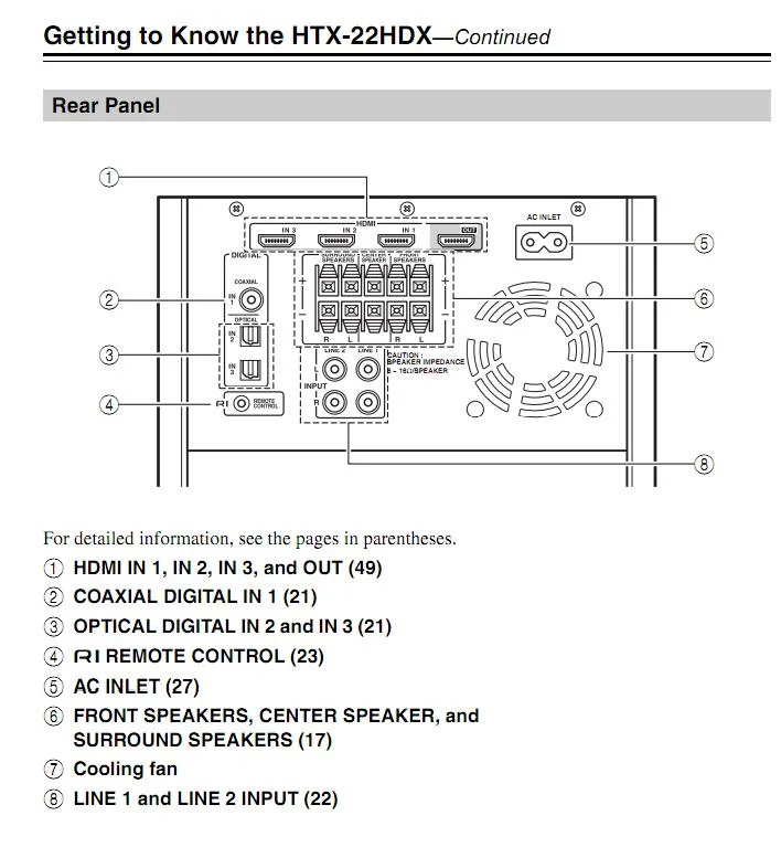

Yes the Onkyo in Mace's post will let you do the same, but there are less connections (e.g. no standard port for the Wii cables)
Onkyo rear; http://3.bp.blogspot.com/-wjQvgYyvk...BvY/txvB3-U_1mk/s1600/Onkyo_HTX22HDX_rear.jpghttp://www.avforums.com/forums/atta...sor-onkyo-htx22hdx-htx-22hdx-input-output.jpg
