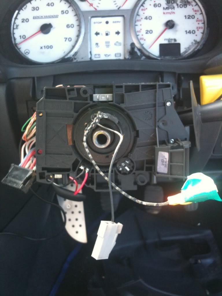

When the fire happend it caused this:
As you can see the Grey block which plugs into the original steering wheel controls the Horn, and has Red + black wire. but due to the fire the Red wire was fried.
Now i did buy a Ph1 172 horn instrument panel(the black part) and though it would be a straight swap but that wasnt the case, due to the different connections and horn button on the indicator stalk loom.

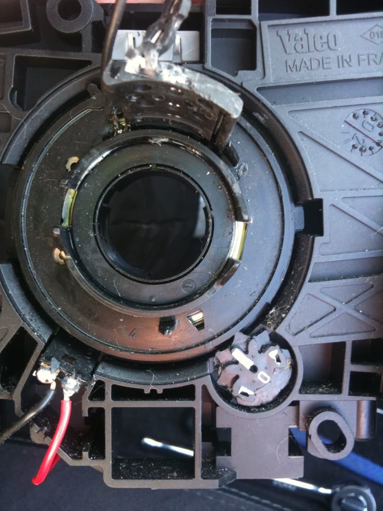

in this next picture next to the square block thing, you can see a gap were a black cable goes into, well thats also were the positive also goes, so i have tried to solder one in, but it still doesnt make the horn work :S Changed the fuse, checked the connection on the horn itself and still nothing.

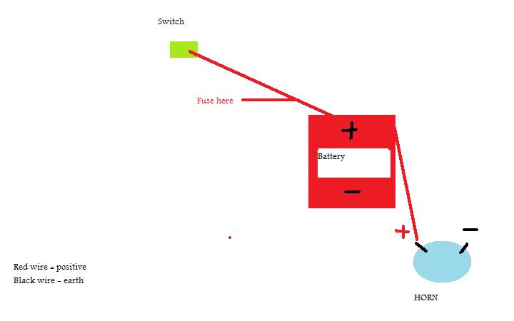

why dont you wire in a new circuit for the horn and mount a switch somewhere else. If only to get you through the MOT untill you fix it
  Astra 1.9Cdti SRi
i have though about that, but dont know exactly how i would do it, im not that good with wiring/electrics
Paddy_g46
You can do it really basically just to get through mot. Run a wire from battery to a switch in the dash (fuse the wire just after the battery), then run a wire from the switch to the horn. You dont need to worry about earth as the horn will be earthed where it is mounted.
If you dont understand this I will draw you a picture.

The left block which is black controls the Indicators and lights, and the centre does Horn & Airbag & white block does wipers, so in terms it doesnt run on the same part of the loom,
& also the centre block to the panel is a different connector

You're diagram is wrong above mate, its as simple as this....
Live from battery to switch
Live from other side of switch to horn
Ground from horn to ground.
Paddy_g46
Battery--- fuse--- switch---horn. iirc.
This. You put an inline fuse just after the battery. You can buy fuse holders from any auto store. The switch will have 2 terminals, 1 is a feed from the battery and the other is what you connect the horn to.
