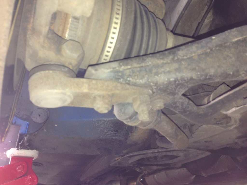

Had my cup jacked up today, dont know if these are any good for a comparison ?
  172 and R17 Gordini

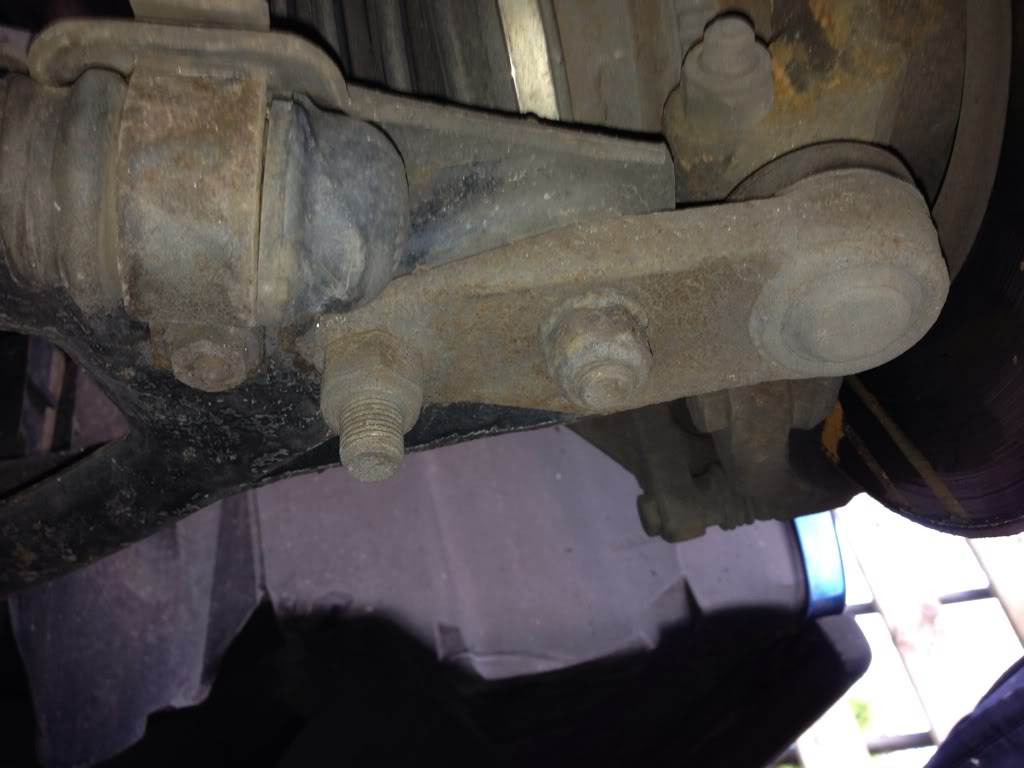

Hi from Australia.
This is the passenger side wishbone on my March 2002 build 172 Ph2, original, never been changed. I want to upgrade to the extra castor ones to see if it solves some of the drive shaft binding i'm getting. Great thread and detective work Chip!

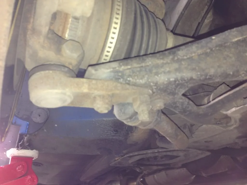

Hi from Australia.
Yeah thats certainly not the increased caster ones.
