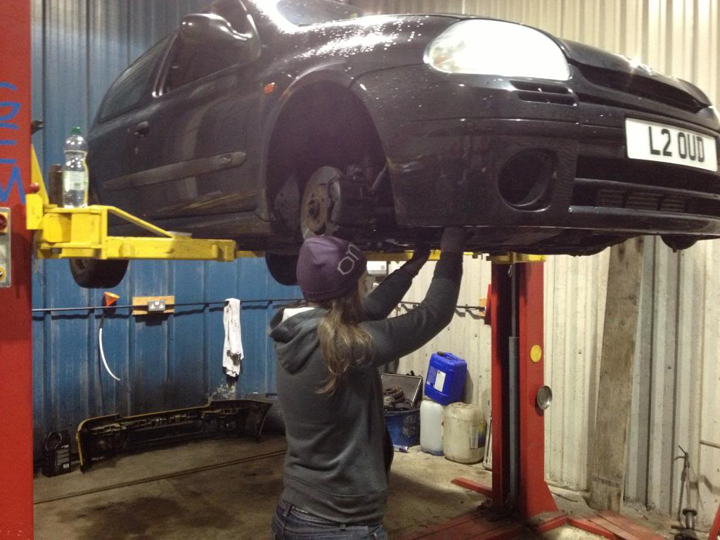

Yes its that simple, in fact here is my mrs doing exactly that the weekend before last:
Instant added caster, and no problems at all.

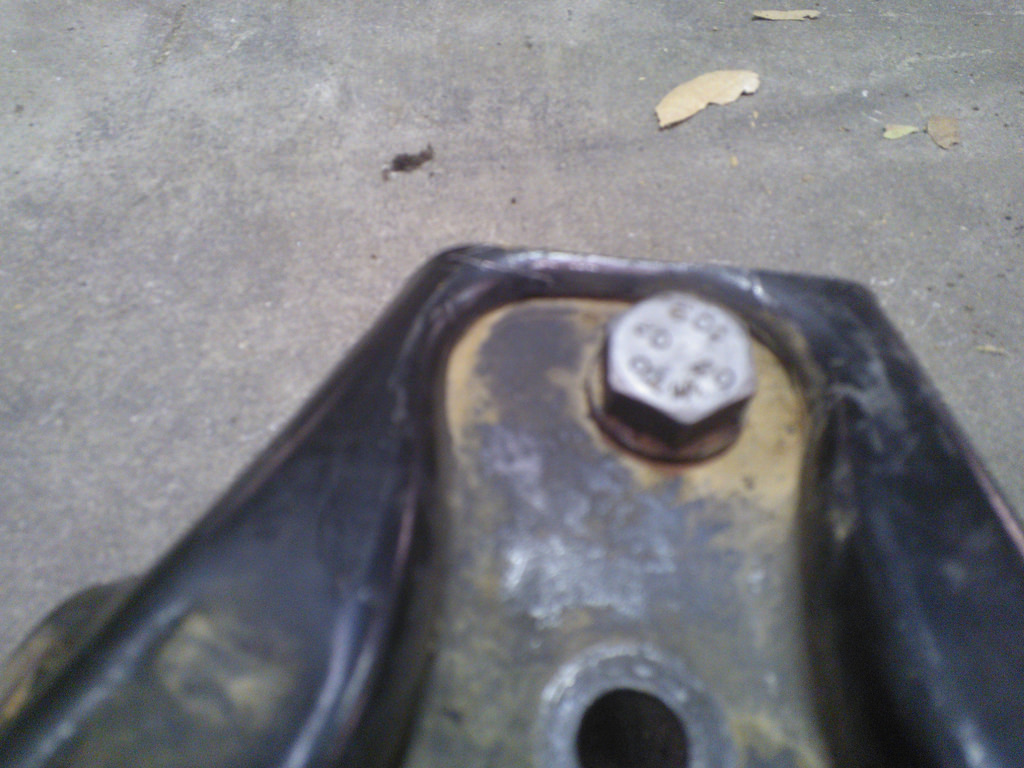

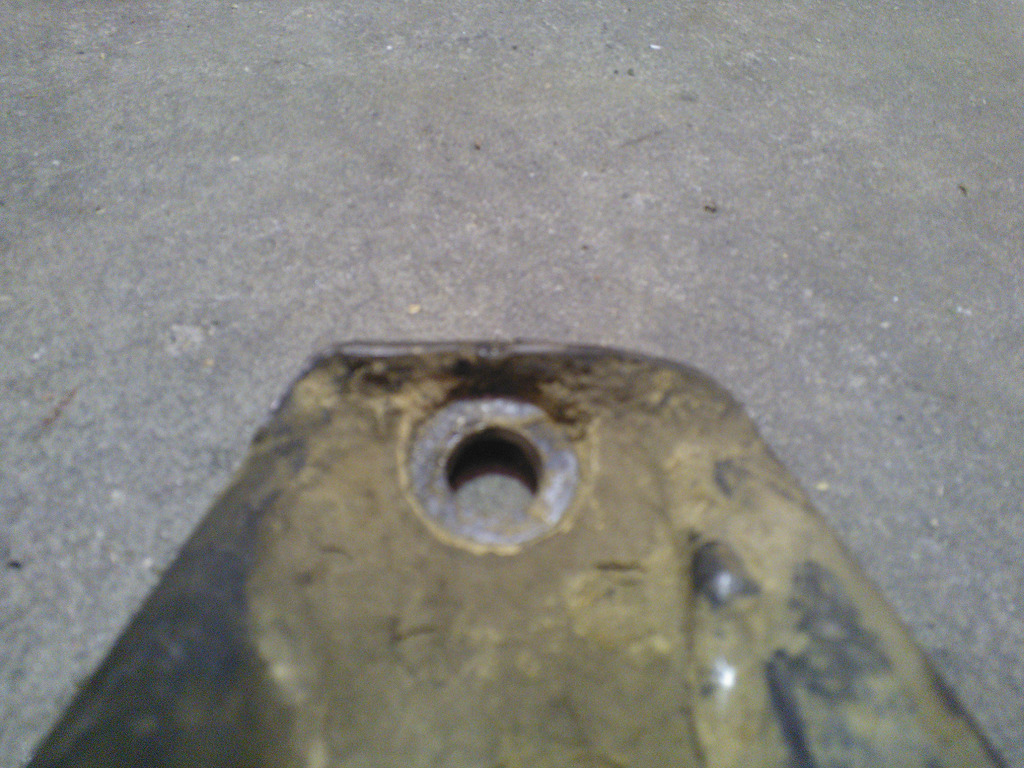

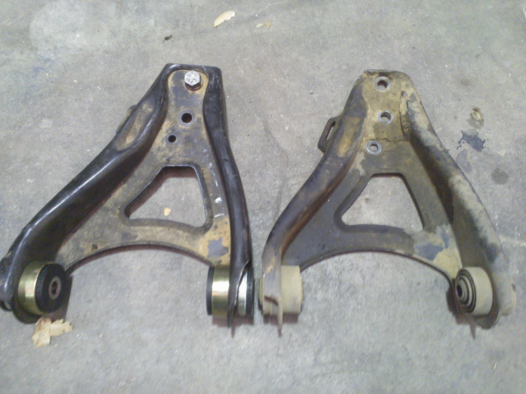

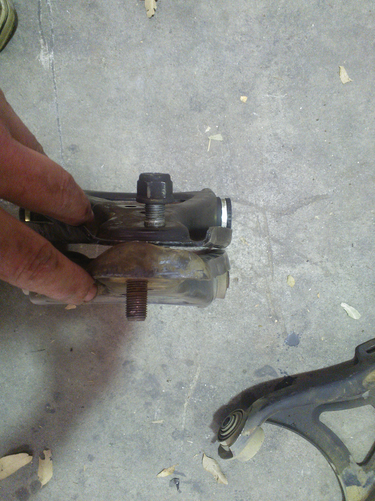

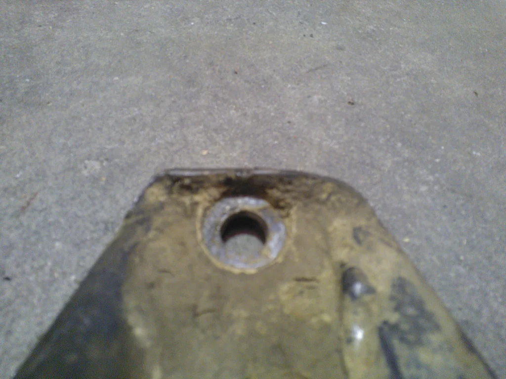

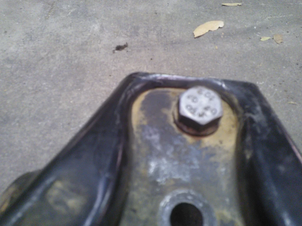

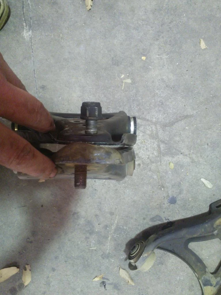

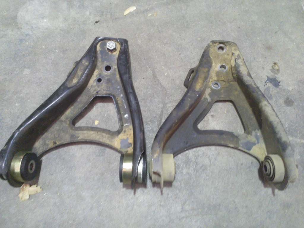

Here is a photo comparison showing the control arms from a 2001 Ph2 (non ESP) and a 2003 Ph2 (ESP), both non cup. I also have another 2001 Ph2 and they were identical to the other 2001 Ph2.
Early Ph2
Late Ph2
Late Ph2 on the left
When looking down from top the late Ph2 is pointing more to the front, hence why more caster.

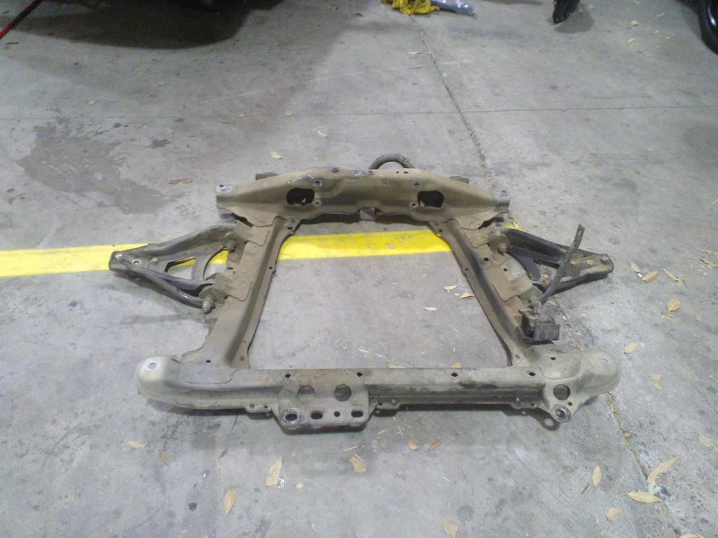

I also transferred the subframe from a 2001 Ph2 to the 2003 Ph2. I also fitted the 2003 (more caster) control arms onto the 2001 subframe without issues.
Here's the 2001 Ph2 subframe with standard 2001 control arms
