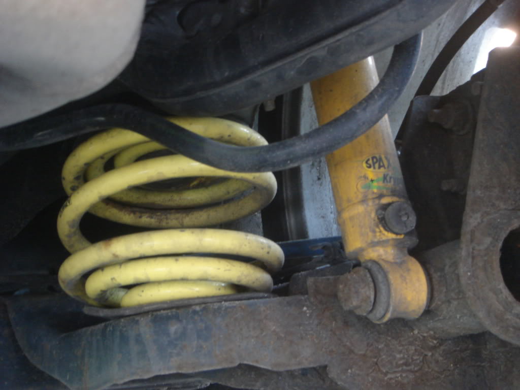

got these on at the mo
and the same springs with standard shocks up front.
i love the height of it, its just a hard ride over normal roads.
would coilovers solve this problem and keep the height but be a soften ride?

they are apex springs which are a pretty harsh ride but coilovers will not be softer. best bet is some sportline springs. they will raise your car about 20mm (from what it is now) but it will be a smoother ride.
they menna be at the back, but put them on the softest setting and i couldnt tell a difference from the hard setting...

would replacing the standard shocks with spax ones to match the back work? would it be a good thing to do? coz after doing abit of driving around its the front thats rock hard...
