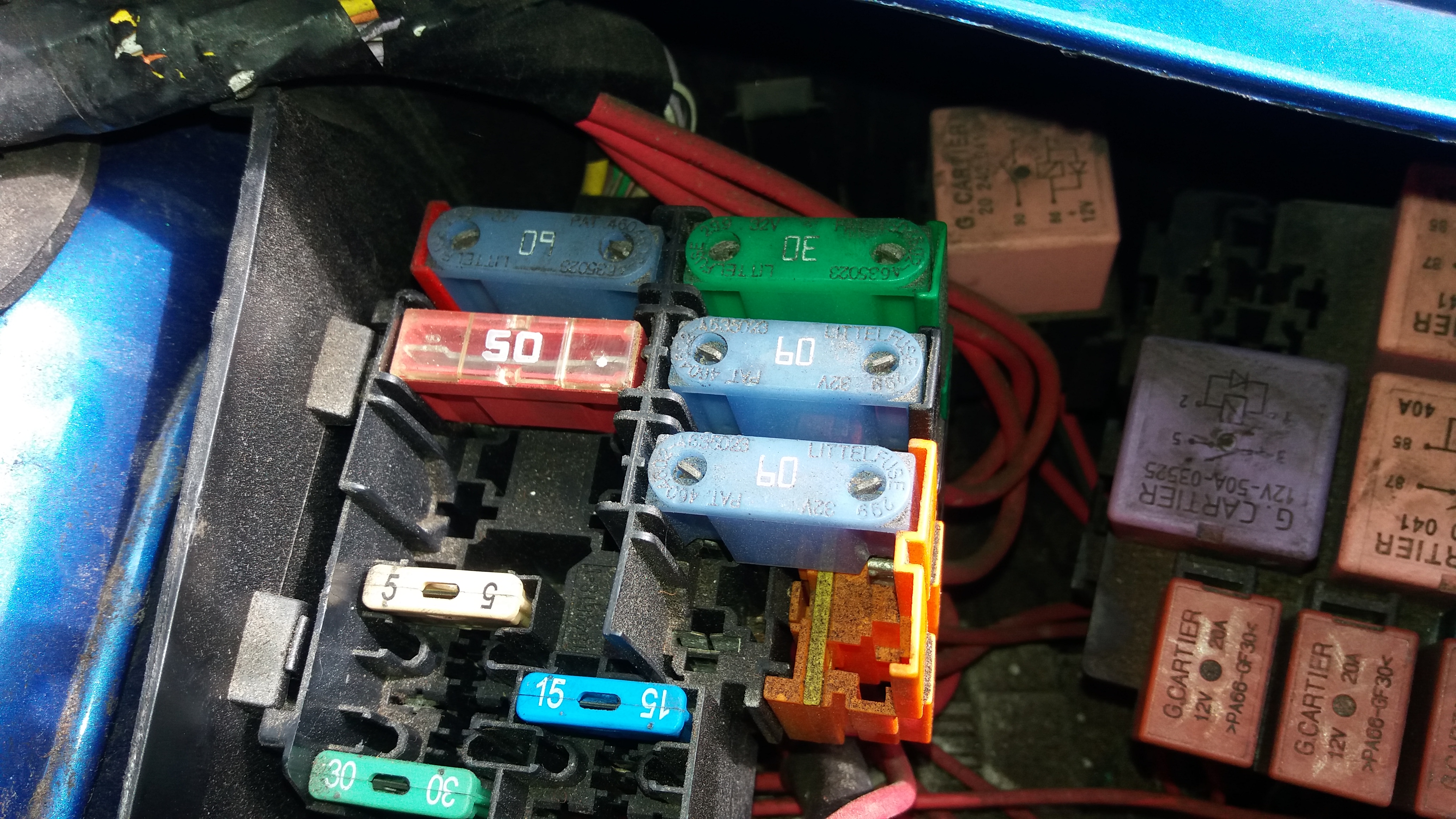

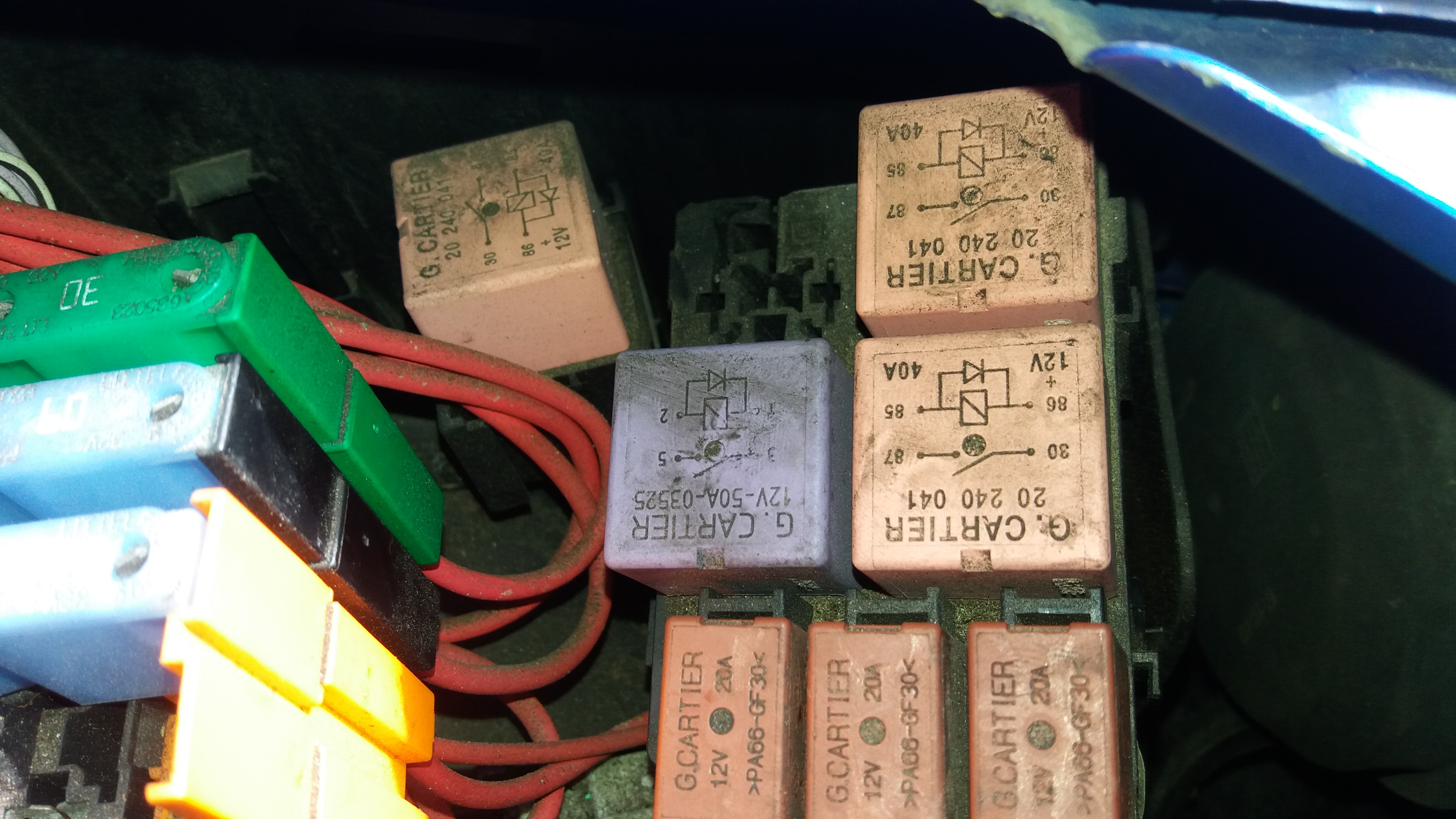

Changed the battery . Cleaned up the terminals on both + and - cables . The earth cable from the battery and loom were pretty loose , so tightened them up. The gearbox to body earth strap was in decent condition but put a 2nd one on just for good measure as I already bought one. I couldn't see this much talked about white fuse/relay ? Mine are pink , brown and purple. I'll see how I go from now on . I still get a feeling that it could be a combination of not driving the car much this past 2 weeks and maybe a slightly weak battery could have been an issue. Time will tell . Fingers crossed. Thanks @bloke for your advice mate . Much appreciated.
  dan's cast offs.
White connector at bottom of the fuse box.
If earth from battery wasn't tight then 99% that will of been your problem.
