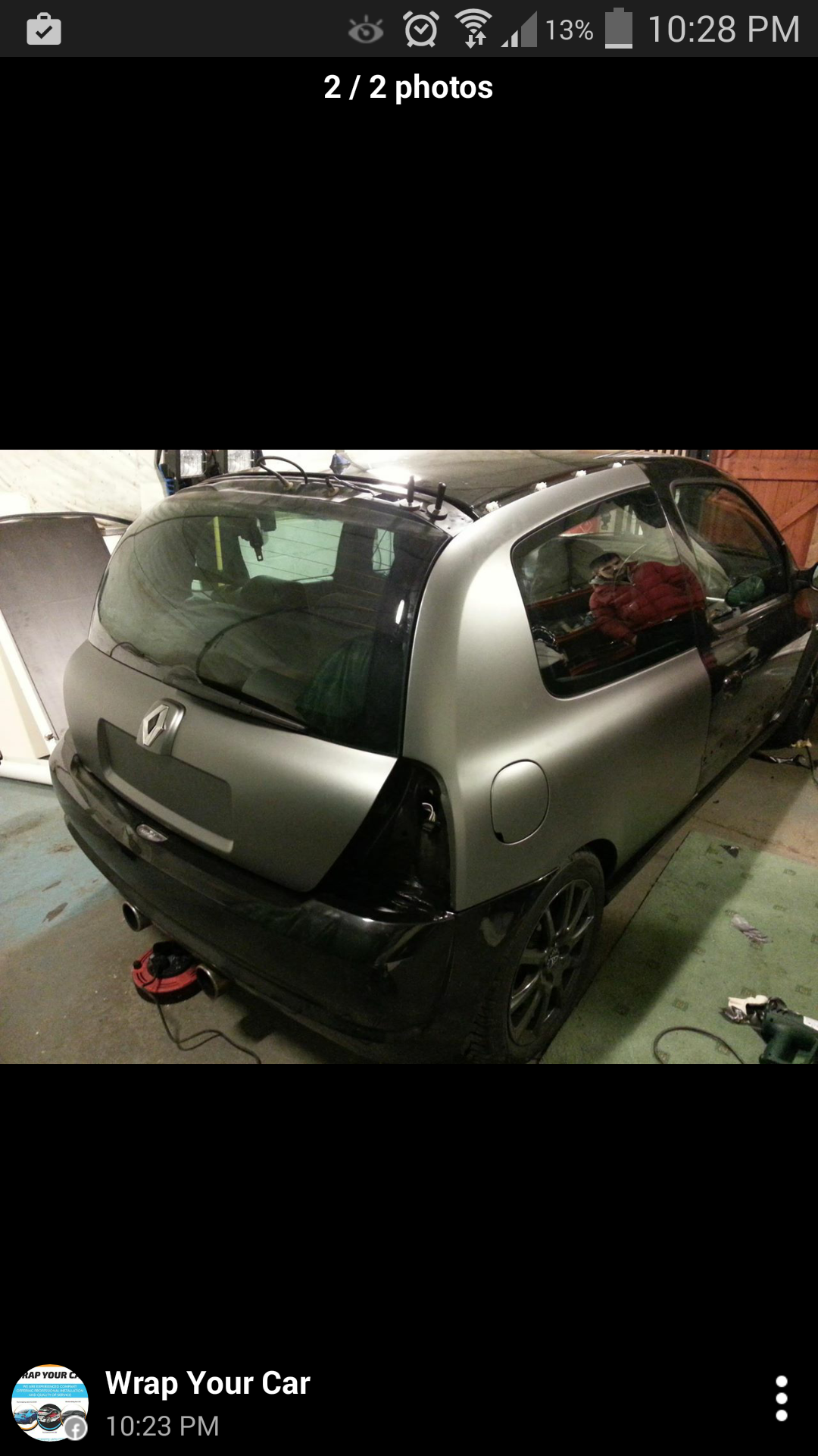

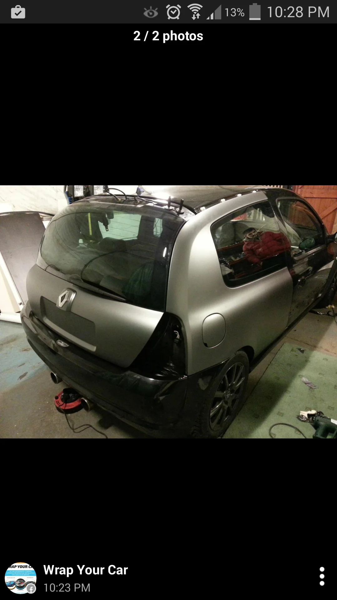

my car being wrapped.
the people who did it were crap.
Plastidip is Crap... I had mine done before the wrap. Ruined the paint when removed. and bubbled in placed.
