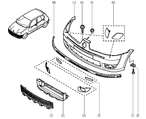

hello...im from indonesia n i have clio ph2 1.4L...i want to change my front bumper with front bumper from clio ph2 172..but de problem renault in here dont have a part number for that bumper...
so can i get part number for front bumper clio ph2 172/182?

Tell Renault to enter this chassis number into the Dialogys
VF1CB1N0F25519512 ( oval plate CB1N / Fabrication number K002148 - eqpt level ES4 for a standard 172 or SPL for the Cup 172
Then select Bodywork - go to external trims
select page 2 and the 172 bumper is number 1 on the screen
You will no doubt need a 172 upper grill - 6000073772 and a lower grill to match no 2 - 6000073773 and maybe a lip spoiler no 10 - 8200248910 ?
Can you tell what is the part number of item #3?
