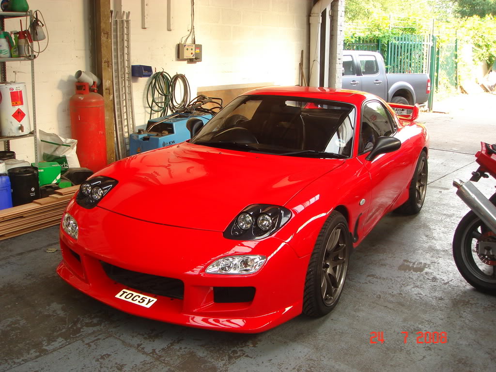

Pic 3, lol

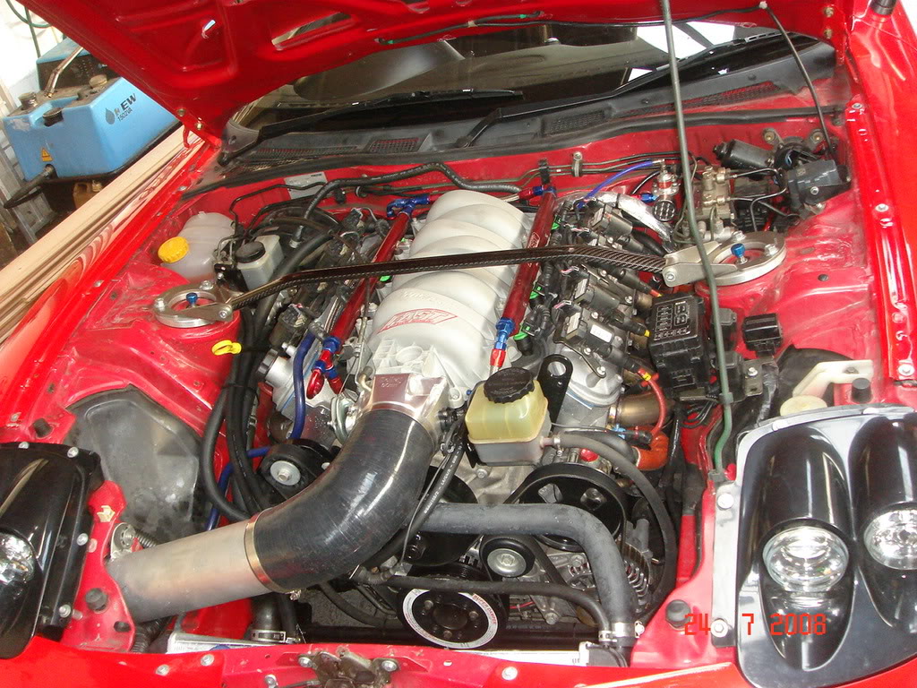

TBF maybe the guy destroyed his RX7 engine and this was a cheaper replacement. I'm not a fan of doing it but it must be stonking quick, and reliable to boot...

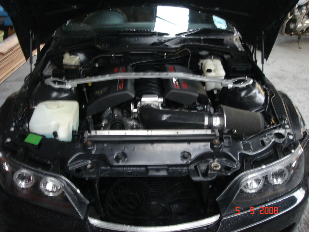

There's a Z3M done too.

red one has cheep nasty s**tty ebay lights on it... why spend that much on the engine and f**k it up with them lights and rotas lol!
the v8 is a popular conversion i wouldnt do it, people who slate the w**kel clearly havent used one or know anything about them, they are stupidly simple and are ALOT of fun to drive! josh you keep with your 1.2 mate clearly u know f**k all anyway lol..
one reason i dont like the v8 swap is the fd is classed as a mid mount engine not front mount as the engine is behind the front wheels... its perfect 50 50 distribution! sticking that huuuuge lump of pig iron in the front really really plays with the way the car handles... v8 for straight line drags yeh, f**k yeh lol seen v8 fd's do wheelies... but for more fun i would go with a tripple rotar lump and f**k 7k for a ls1!! for 7k you could stick a quad rotor engine in the fd! 7k you could hit over 700bhp on a twin rotor! u could get 800 on a tripple rotor!!!
a periphial port tripple rotor with a biiiig turbo cos of the porting will still spin up stupidly early hardly any lag and your talking a 10sec 1/4 mile car!

Looks very plastic in the red tbh. I'm also not convinced on the offset on the front wheels on that pic, look too far out of the arch and not feeling the stance either. If I had an FD it would definately be running some stretch tuck and camber.

I think the Red one has the shitty ebay lights because they were limited for space and the pop up mechanism needed to go in their install. Not a fan of them also and I believe most have the wrong beam pattern so are technically an MOT fail.

Dont criticise others if you yourself don't know much about the LS7 block you're speculating about.
It isn't that much heavier than a 13B. A triple rotor block would actually be heavier than the LS7 V8. Also due to its compact size you can get it mounted quite far back so it does not upset the distribution very much at all.
The LS7 makes a lot of sense as a swap when you think about it. Don't compare it to the older Chevy blocks which are very heavy. The LS7 is rather different. Plus that torque would make it an ace car to drive. 470ft lbs at just over 4000rpm...and it revs to 7000rpm as standard. Well it is set at 7000rpm the actual block is good for 8000rpm. Just cams etc limit top end power so it was set to 7000rpm.
Oh and also it might only have 505hp...but standard Z06 vettes with 505hp have clocked high 10's in the quarter. And they are heavier than the RX7's.
I supposed the only negative is if you are a Jap purist. However the V8 makes sense. Especially in a street driven car. As the rotoaries aren't well known for their torque. Probably gets similar MPG too and uses less oil.
