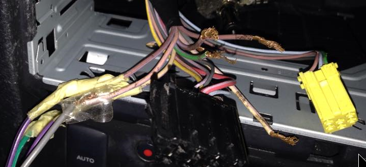

Wheels painted black, stickers, missing badges, lowered (eibach springs), stainless cat back exhaust, cat from a different car (not sure what, it's a renault cat but it's flanged on both ends not like a normal 182 cat), broken speaker wires with sellotape allover them (below, ugh)

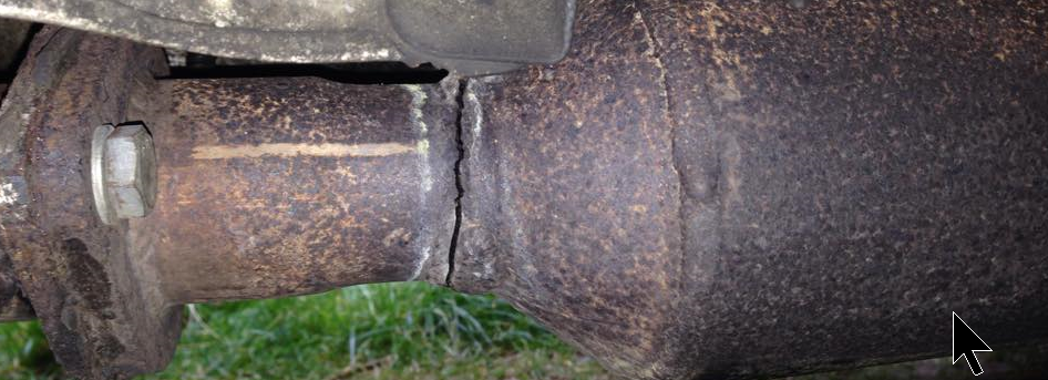

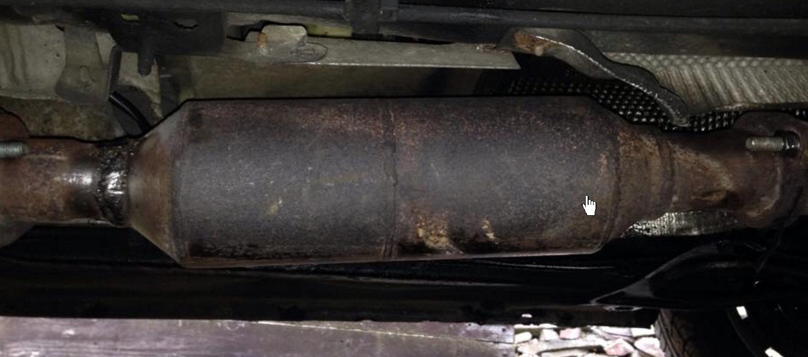

The cat is snapped, just welded it back together today, going to be taking the car to infinity exhausts on monday to fit my new 182 cat.

Next job is to fit the welded cat back to the car so I can drive it to Infinity on Monday and I will be taking the seats out laying my new speaker cables this weekend and getting that all hooked up to the new stereo.

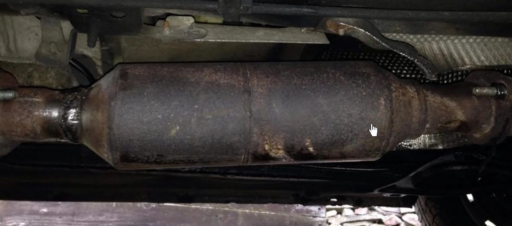

Meanwhile I just fitted the welded cat and the car is like a different car to drive, all the torque has come back at low RPM and it's no longer hard work in traffic, i'm glad because I was worrying there was something more serious wrong with the car the way it was driving.

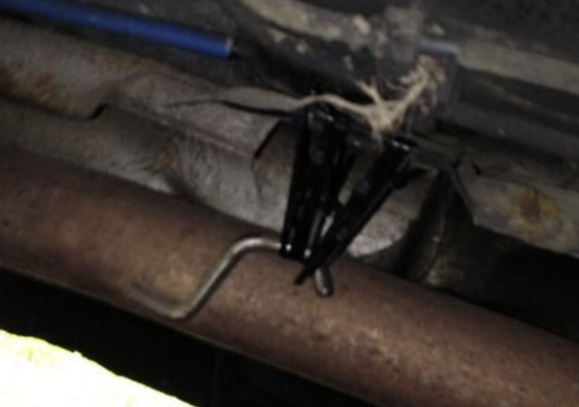

This is the reason the cat has snapped (missing exhaust hanger - I have used loads of cable ties to try take some pressure off the cat in the meantime)
I will still be going to Infinity on Monday to get it properly sorted, the whole system has been putting way too much pressure on the cat and it looks like it's been welded before, also I'd really like to fit my proper 182 cat and get the exhaust hanging right.

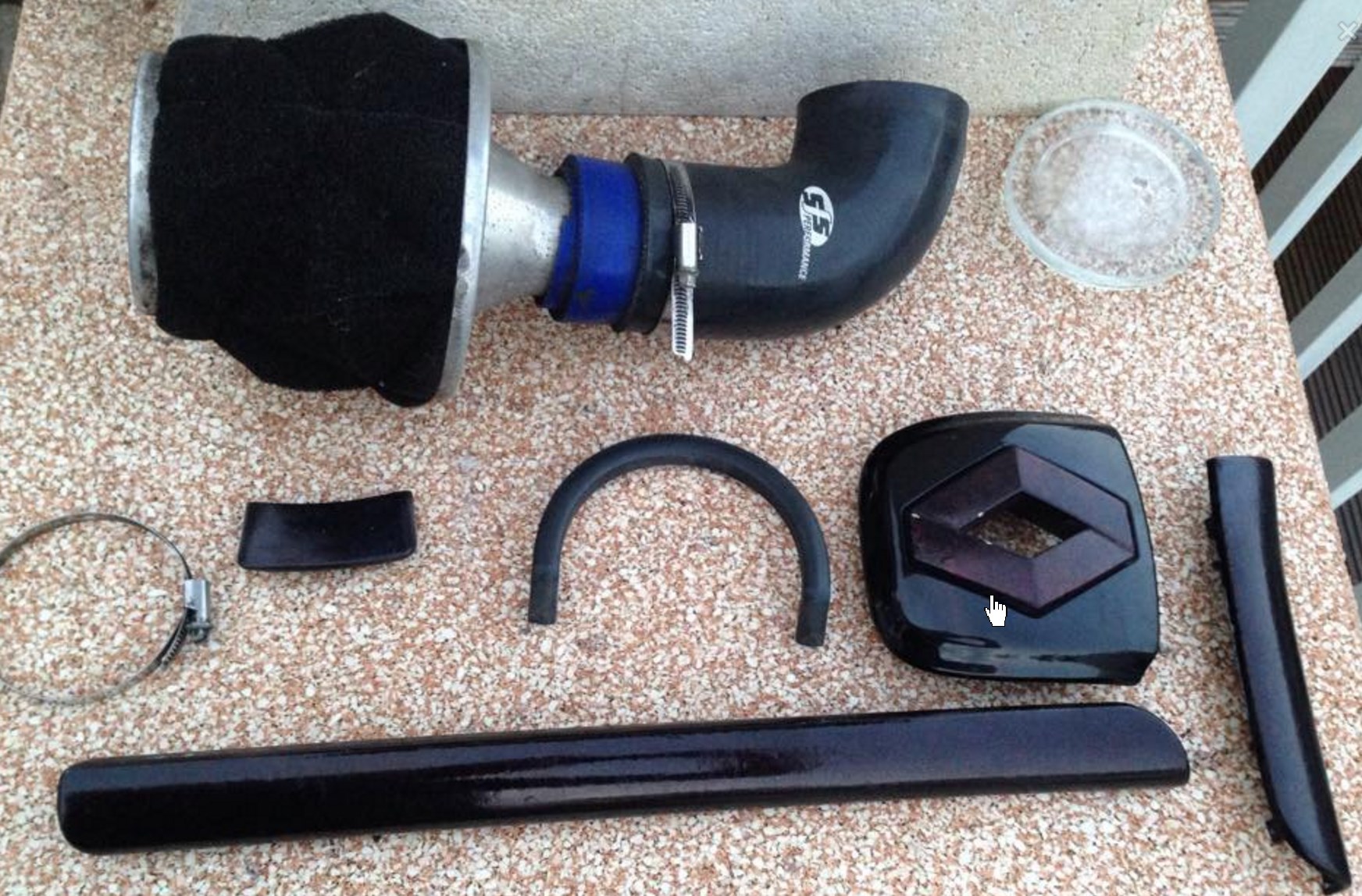

Would tuck the intake elbow and the exhaust u trim away, they will come in handy one day.

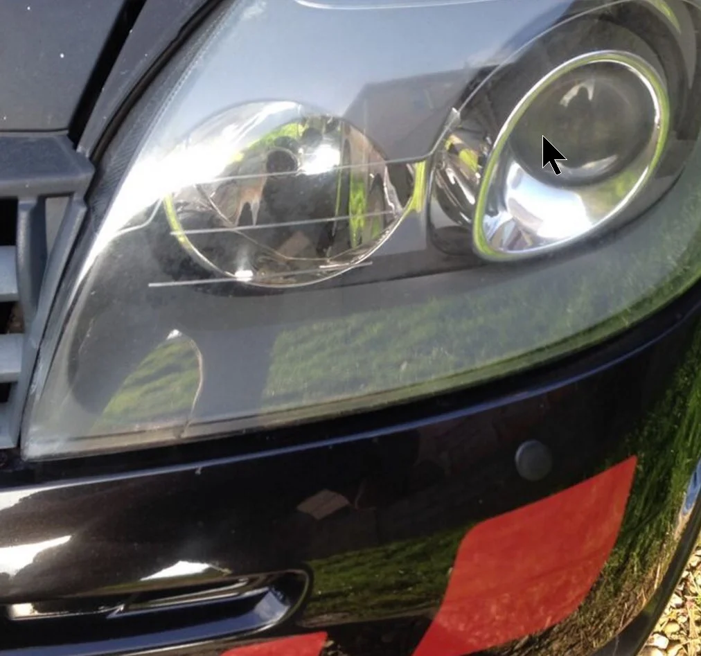

Replaced the headlamp jet and hole with rubber and replaced some bulbs in the headlights that were gone.

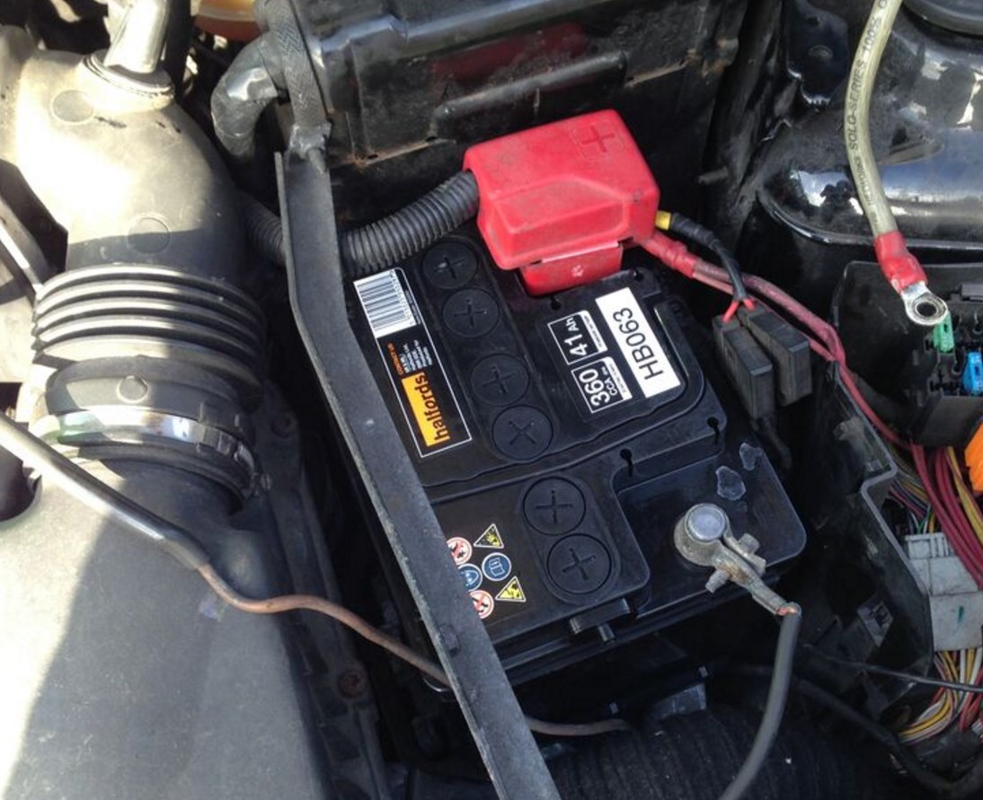

New battery, old one was way too big and preventing the air intake hose from fitting to the airbox, detached the sub-power cable that someone has run to the boot (now cable tied out of the way)

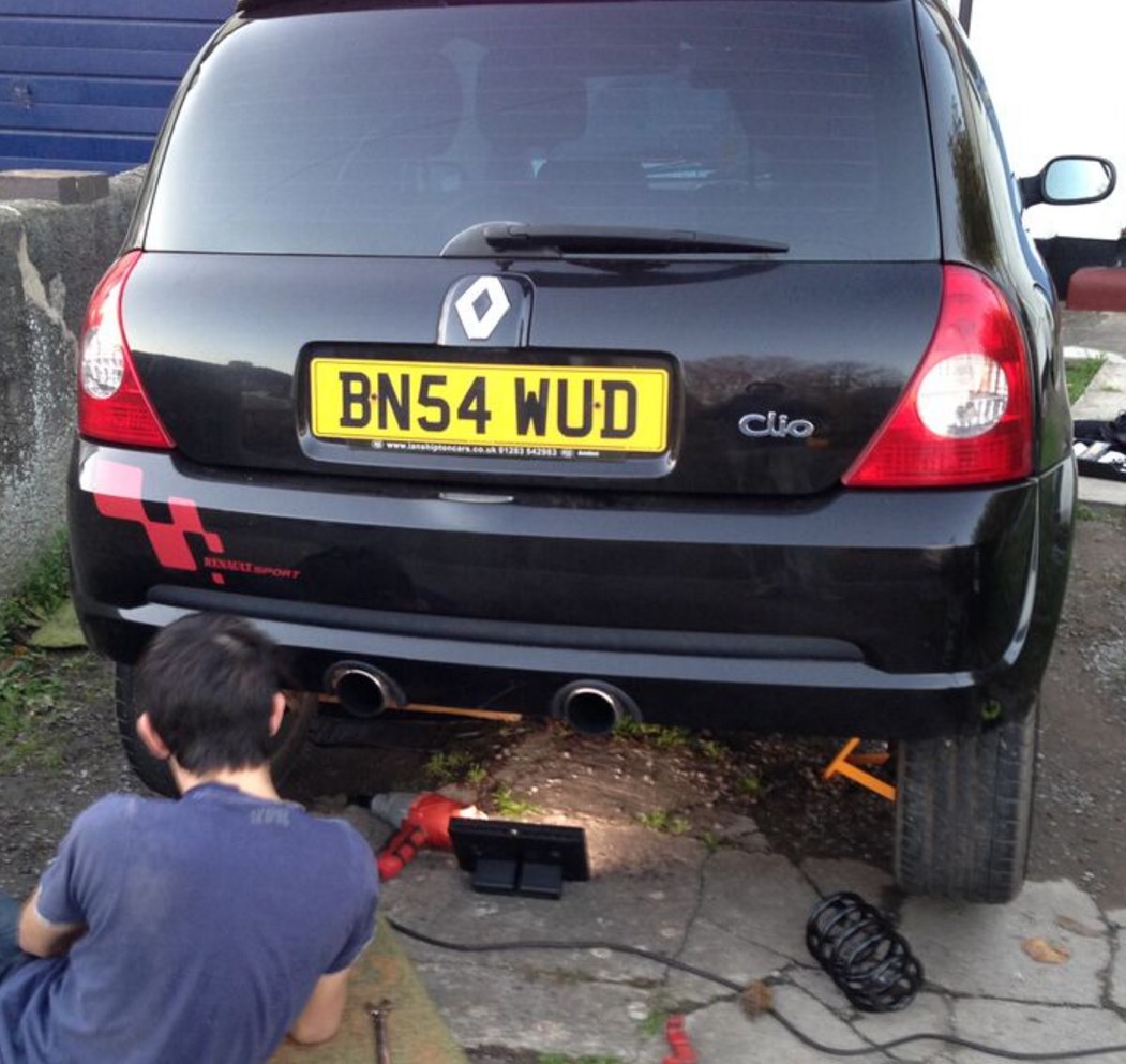

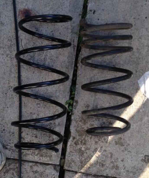

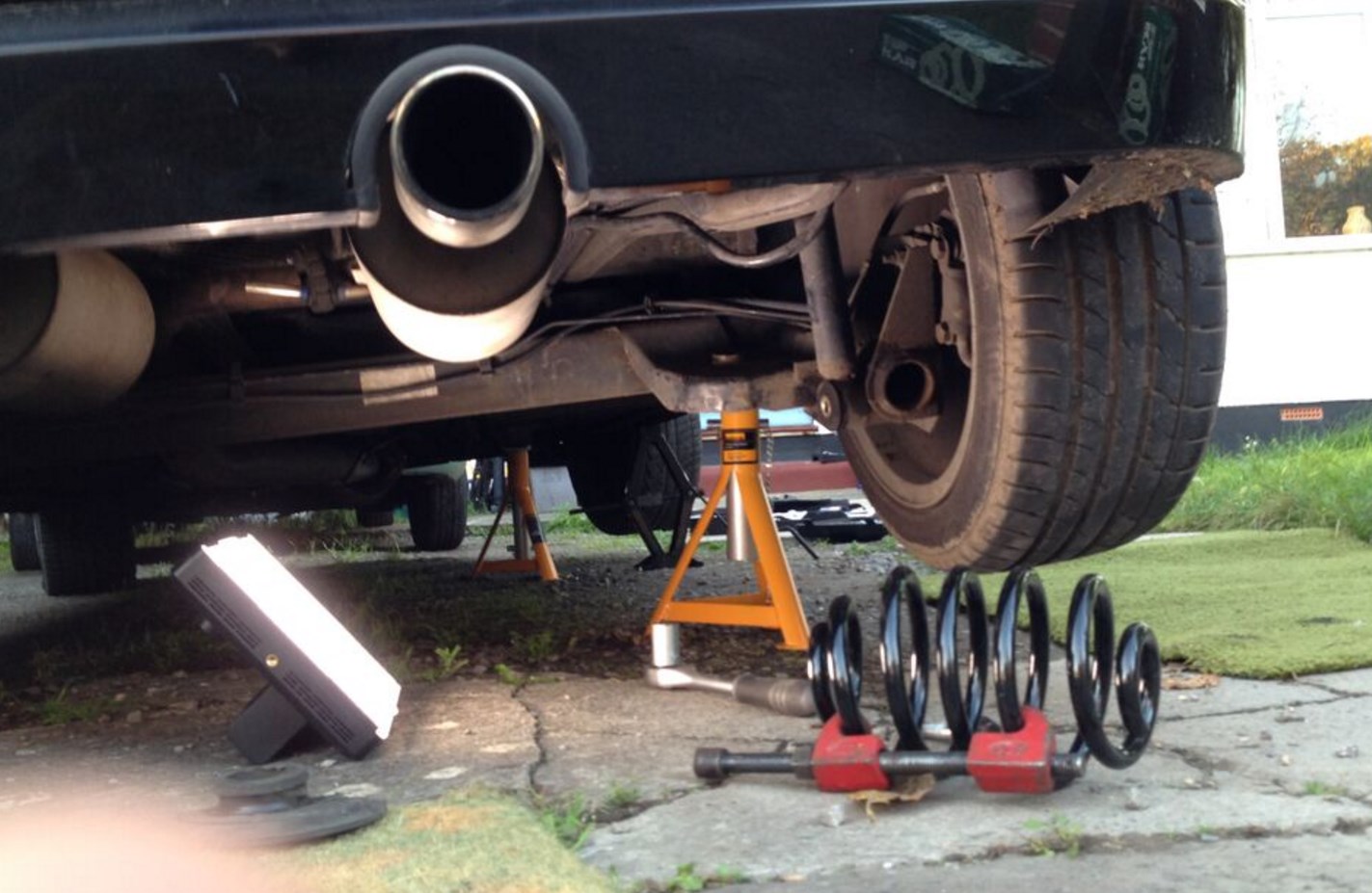

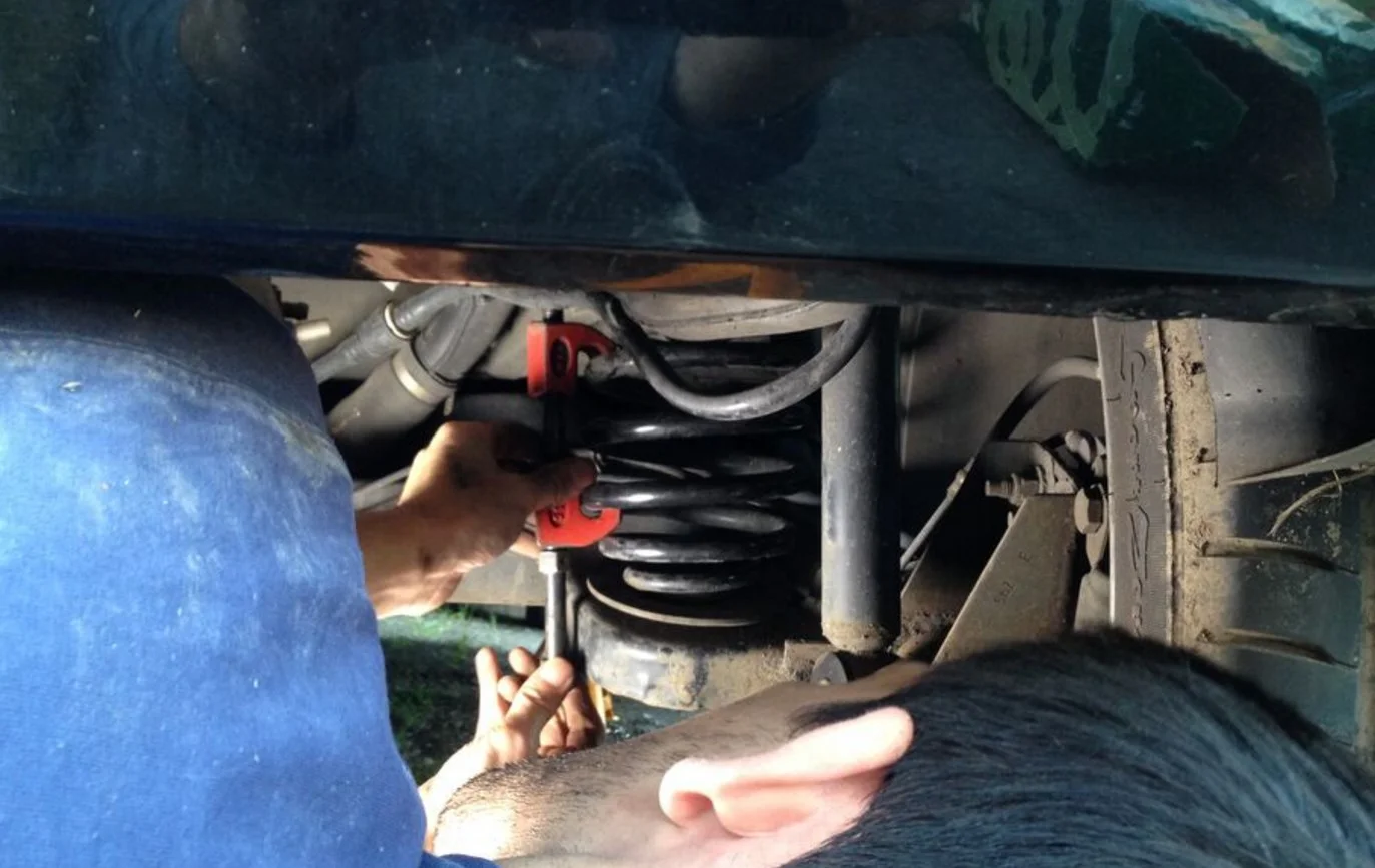

Old Eibach springs on the rear have come out.

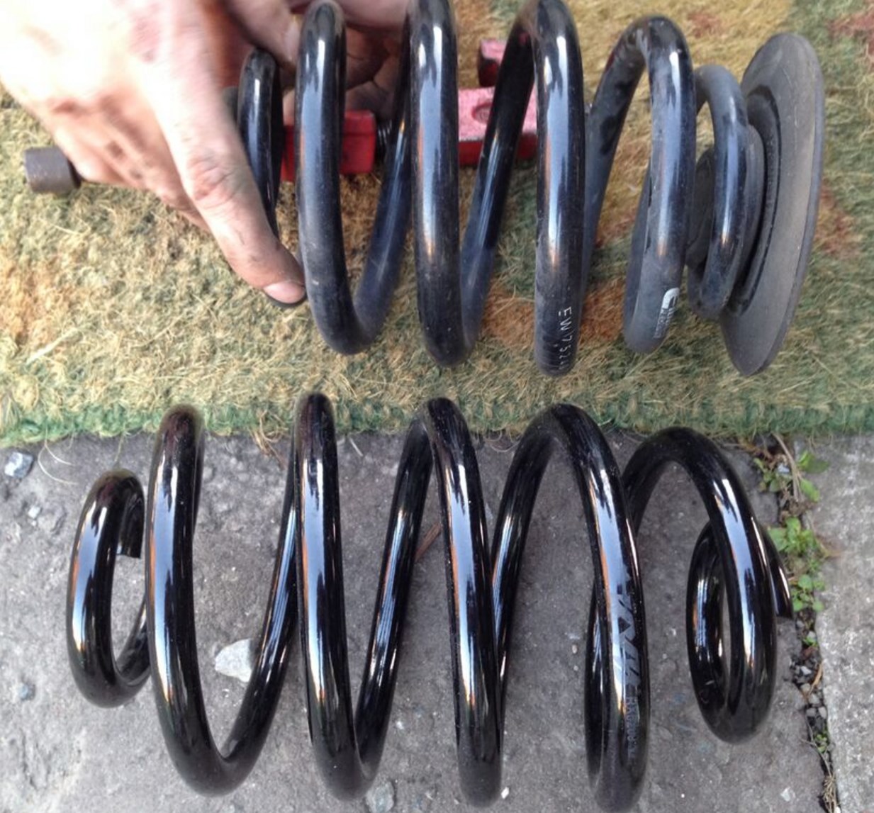

Here's the old Eibach spring vs the new OE spring

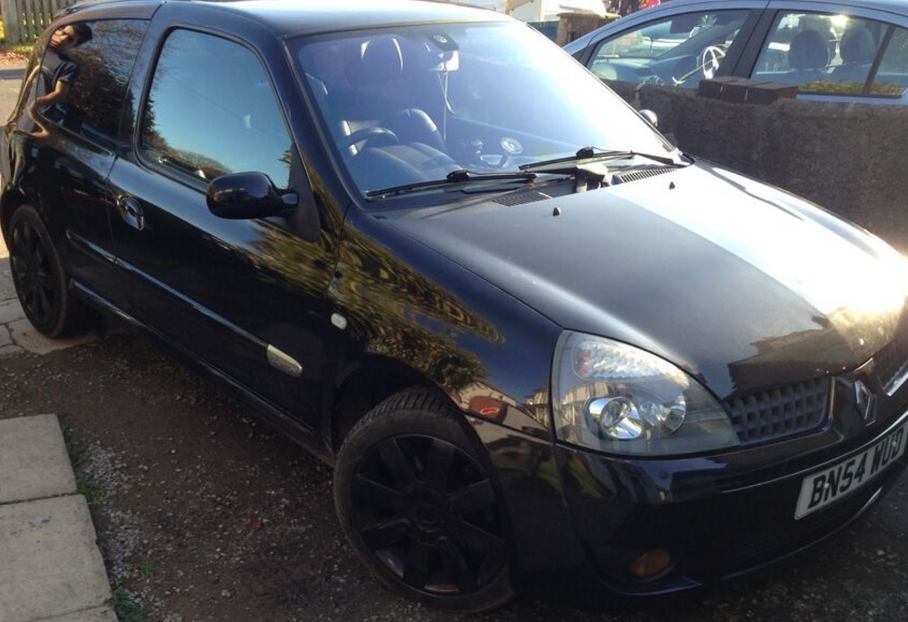

The new stance (until I replace the front springs tomorrow!!)

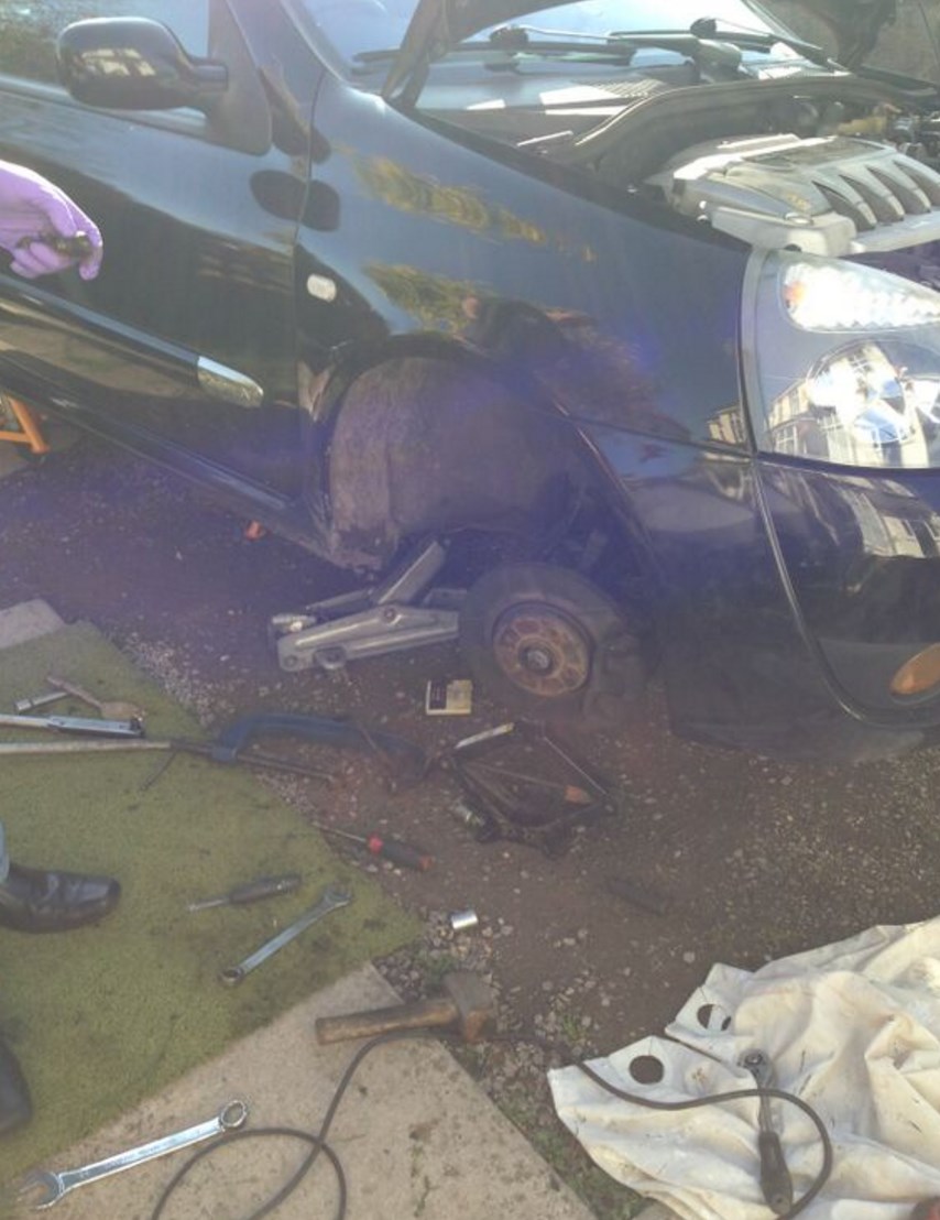

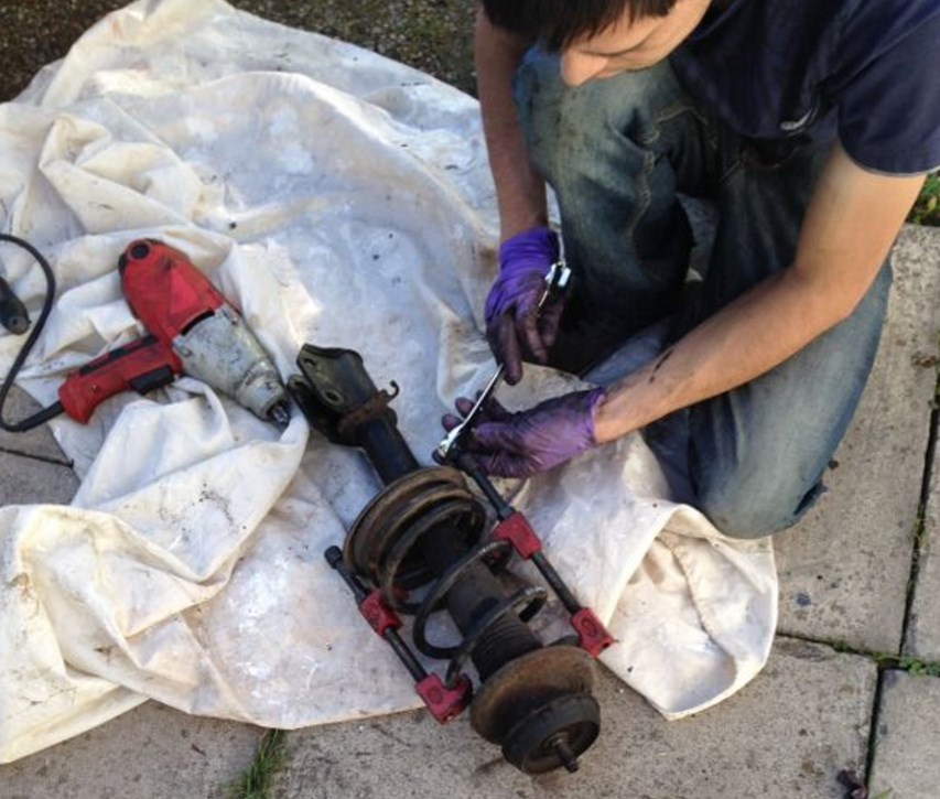

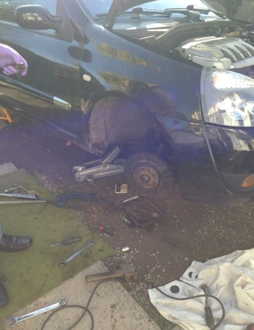

Did the front shocks today. What a pain in the arse!
Would never have been able to do it without the impact gun and a big hammer, spent about 30 minutes changing the springs and 4 hours getting out rusty bolts.
Pictures below, too tired to write anything! drives better now.

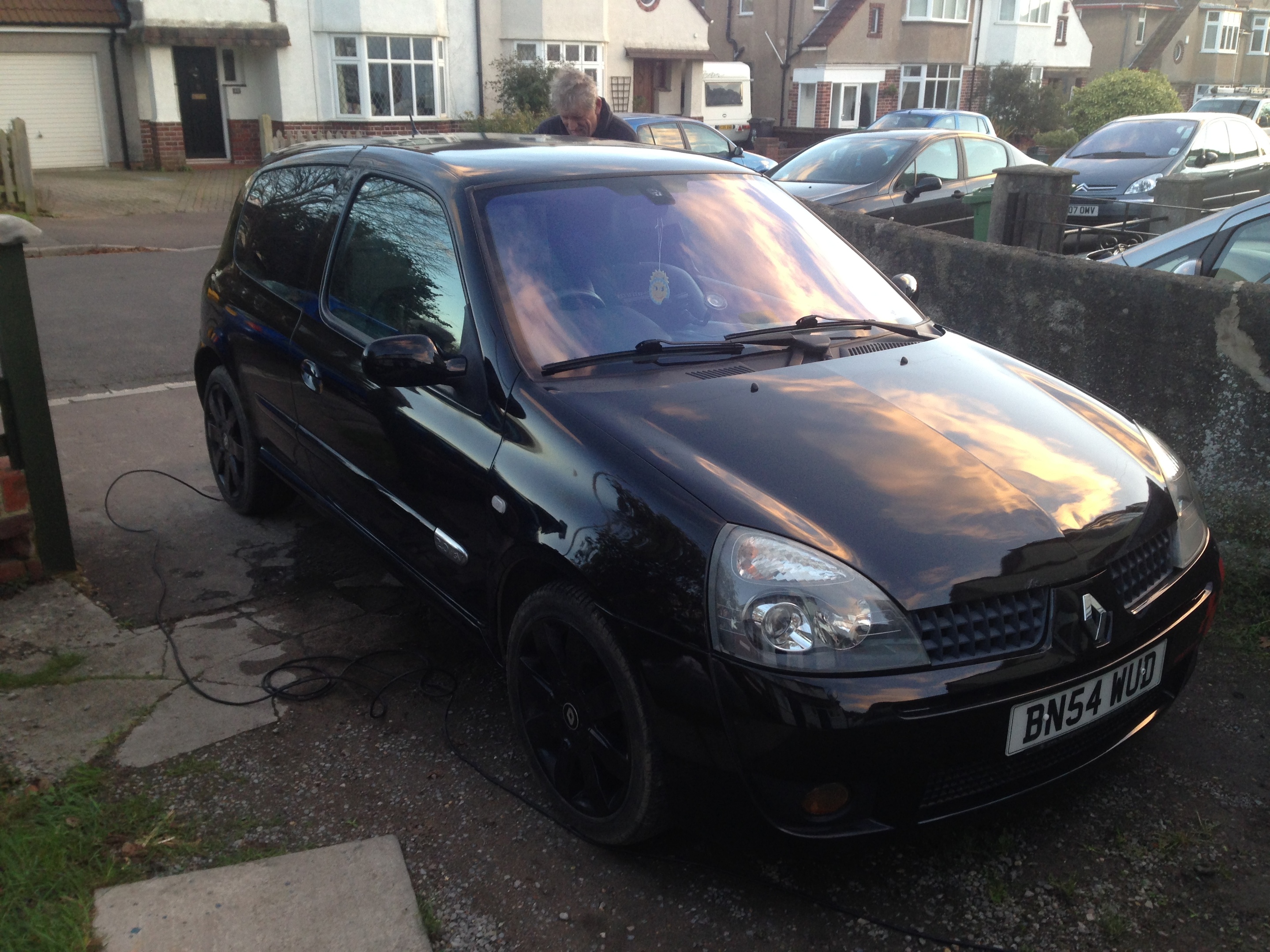

what the hell have you done?! Now its not low any more....now its to high!
are you shure that you did Mount the right springs?
I believe they are the correct springs, I'll take a proper side on shot when the springs have settled, the car had only just been taken off the jack in that picture and the springs had never been compressed.
Whether it's the exact factory height or not it drives lovely now and still corners like a beast!
Just been to Infinity Exhausts and they have fit my new Cat with some modifications, car is fast now! Still very loud though, not sure what exhausts I have...

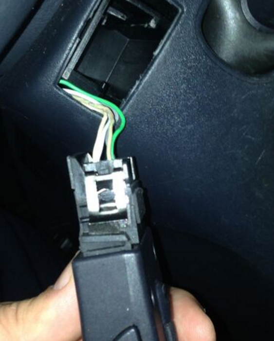

Fitted an audio stalk control to pioneer adapter today.

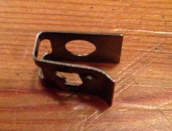

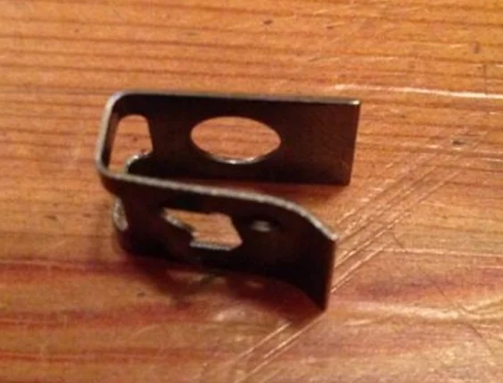

My audio stalk is broken and won't stay in so I fixed with a captive nut:
Inserted on the locking side in between the wiring connector so that the connector holds it to the stalk and when inserted it will lock the stalk in place.
