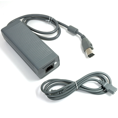

I've bough an xbox 360 and the plug on the power pack to power the unit won't fit into the back of the machine :S the socket on the back of the machine has 2 small plastic bit's on that won't allow the plug to go into the rear of the computer. Can anyone tell me why this is please ???
Thank's
There are two sections to the power pack. Check you have both.
I've spoken to the gent i bought it from and he has sent me the wrong power pack lol. It does look the same:
But this plug doesn't fit in
there is 3 different types, all with different male and female plugs, newer ones are all backward compatible but not the other way round
there are two different power packs with different plugs. They both put out different voltage, as earlyier model xbox's run off higher or lower(cant remember which way round) voltage to the newer ones. They have different plugs to stop people frying them
Three different PSU's each supplying different voltages and amps depending on motherboard/chipset revision.

from what i can see is that the new ones run on the same 12v + 5v supply but the new psu's only output about 12A where as the old ones used to do about 16A
also the new ones are lighter and smaller :)
tbh i had this same problem, i cut away the 2 plastic bits with a knife , the 2 bits that prevented the psu sliding into the back of the xbox console, bobs ur uncle, it works just the same, i did it as i really needed a power supply an thought what the hell lets try it and it did
