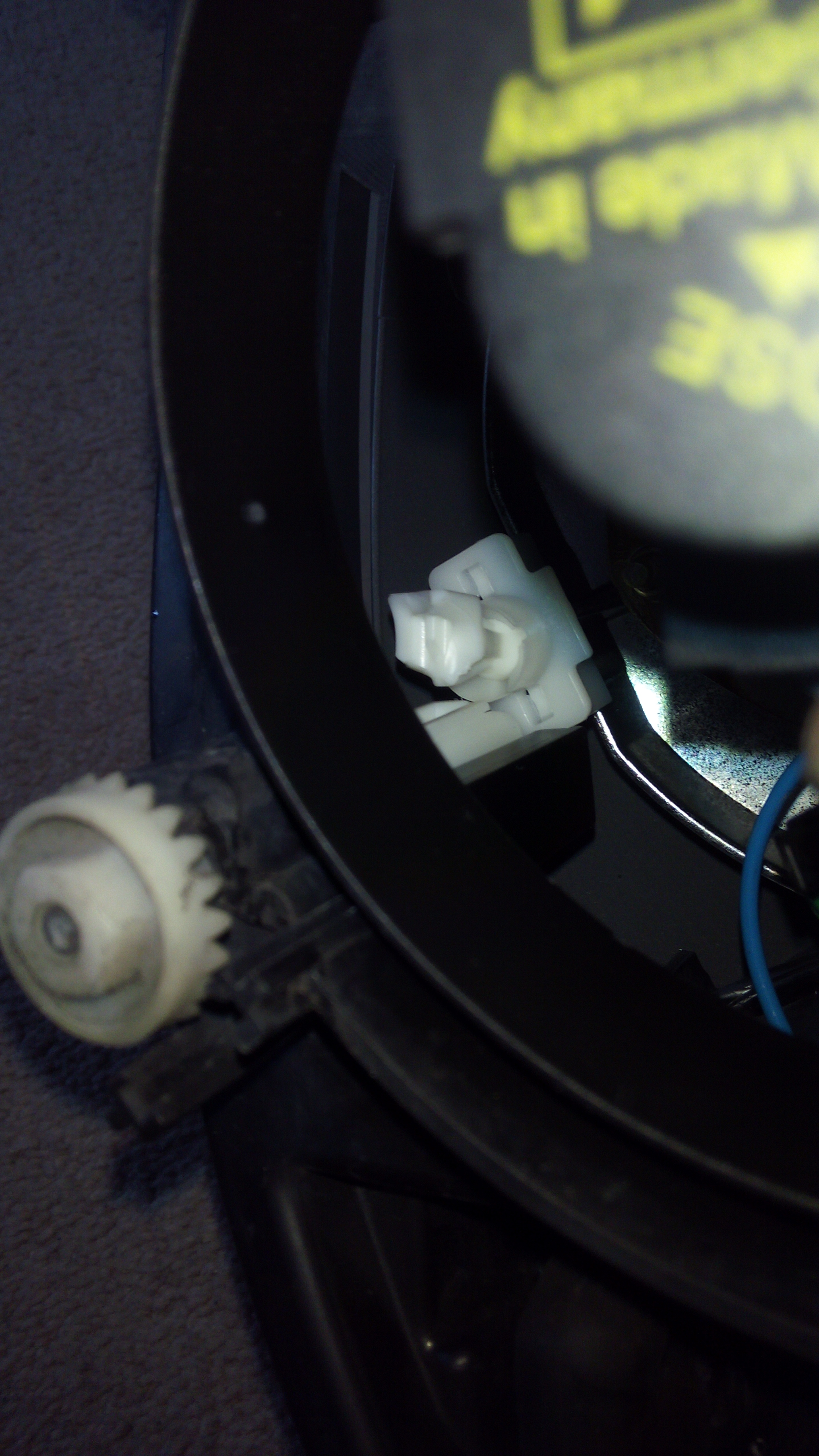

Thanks, I have Found the issue the adjuster has snapped, is this a case of new headlight or can the adjuster be bought on its own?

Cant be bought on its own unfortunately. You might be looking at a new xenon light unit.
When people post Xenons that is the first thing that breaks in transit. Annoyingly all other manufacturers - BMW etc have alloy replacement pieces on ebay but not renault.
Damn that's a pain as both lights have actually broken :( guessing thats not a cheap replacement light from Renault
replacement light are going to run you over a £100 - do not have them sent in the post if you do buy some as you know how delicate those adjusters are.
What I would do is take apart the headlight and see if you can retrieve both bits of the adjuster. Find someone to 3d print 20 - 30 of them and sell them on here for a profit. Or even better get some cast in aluminium.
The adjusters are the same as the normal halogen units. The cheapest possible fix would be to try and get a set of standard headlight units from a breaker off any mk2 Clio and swop them over. It's a very fiddly job but should only cost £20or so.
Mine snapped in the post too. Shouldn't be a problem though it's the dipping up and down beam that really makes a difference as long as those haven't broken you'll be fine I'd imagine.
My ham-fisted hands broke the plastic adjuster in my driver's side light and after reading comments on here I just opted for a new light unit.. with discount it was £230 with no bulbs, ballast etc from my local stealer. It took them 3 attempts to get me one that was intact too! The first two units the adjusters had broken in transit.... very delicate items!
