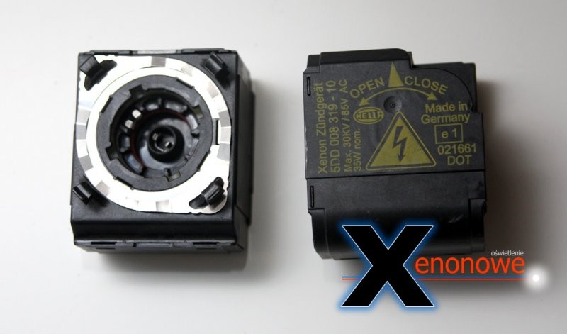

Push the connector firmly into the igniter and twist the igniter fully clock wise to lock the connector in place.
If the igniter has rotated, it may be because the waved locking washer is missing ( they are easy to break ).

Thanks for your reply. The igniter is definitely locked and twisted in place correctly and the connector is in firmly. I removed the igniter to inspect it and refitted it when done. The connector was slightly damp as was the body of the igniter. I'm wondering if that might be the issue

Worth the suggestion as it was the cost free solution.
The dampness is more likely to be condensation than rain water.
You can swap the LH bulb or igniter over in situ for elimination purposes, but if the ballast has gone, it`s a bumper off job to remove the headlight.
