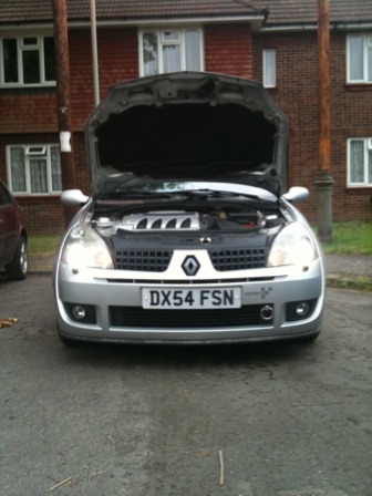

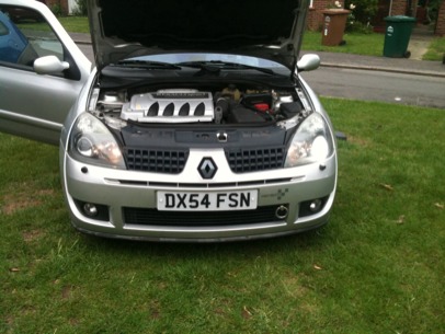

My drivers side xenon seems to have died on me. Manual says only Renault dealers can change them but im guessing thats bollox. How do i get into the damn thing to change it?

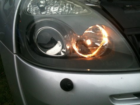

It's alive! Decided to have another look at this. Took the rubber cap off and gave it a good wiggle and that seemed to sort it. Turned it all off them tried again and it was off again. Few minutes of poking it again and it seems to be working ok.
