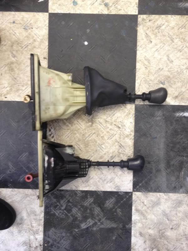

Here is the megane shifter next to a standard one.

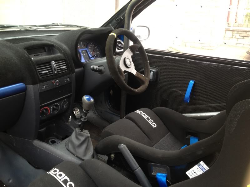

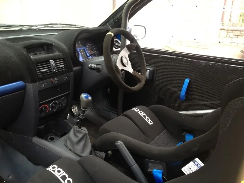

This was it fitted and sitting in 1st gear, shortened the rod at the gearbox end to bring the stick back.
Jack car up, mark with a pen along the side where the two pieces meet, undo 13mm nut, pull out shaft and you should be left with about 6 inches of rod.
Cut about 10-15mm off this piece and connect back up, the gear lever will now be more inclined back towards you, if it's not enough, then cut a little more off.
