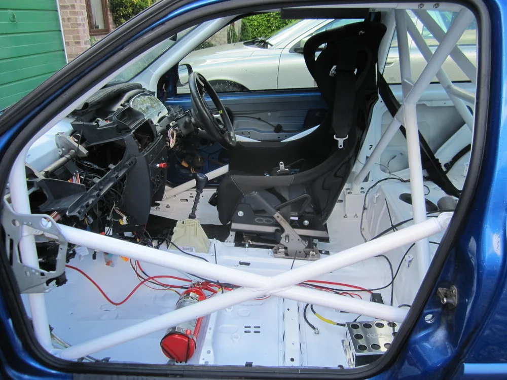

Another update. I managed to get it to an acceptable level to let the scrutineers take a look at the Brands, Tin Tops meeting last Monday.

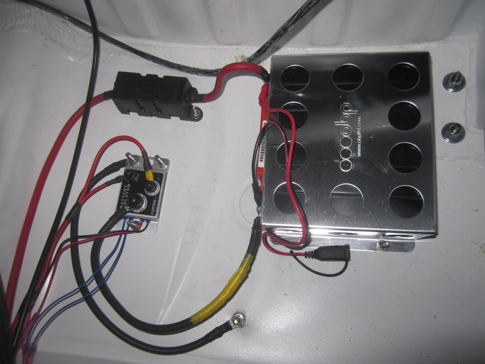

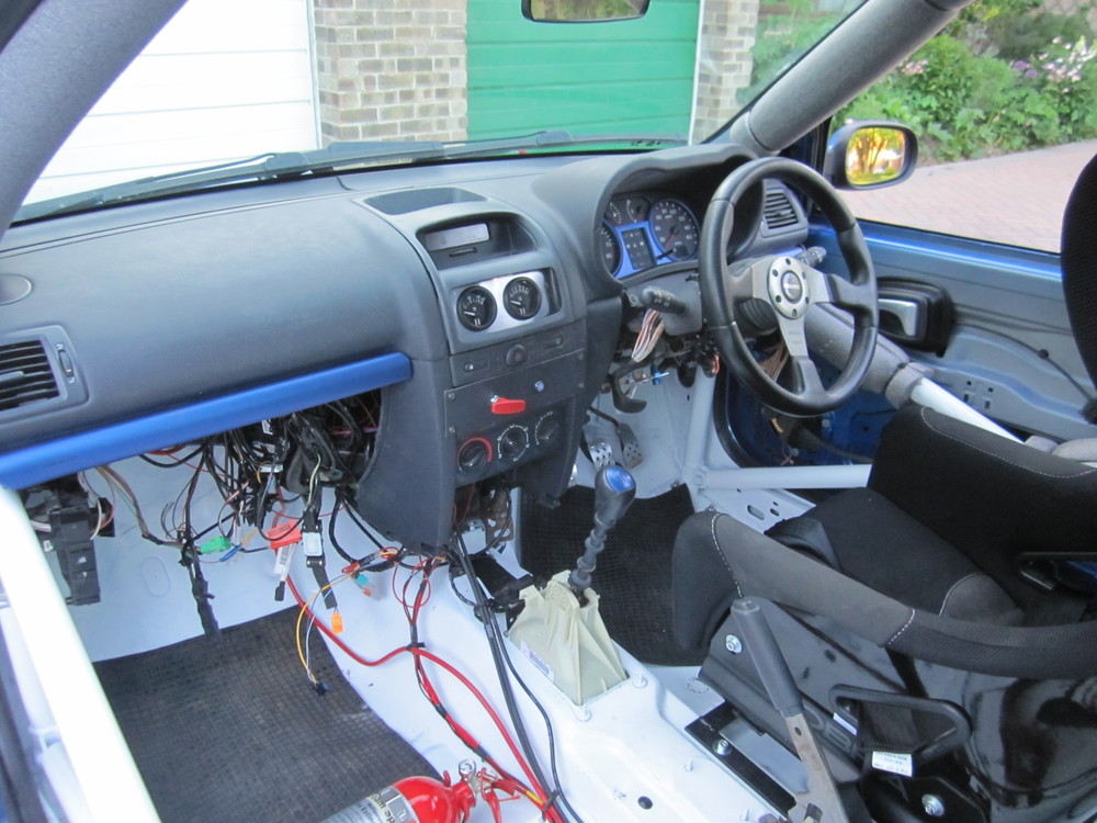

Wired in the cutoff

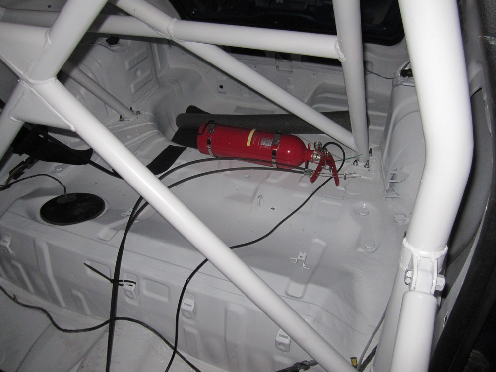

Put the extinguisher in the boot so I can get to it more easily when I have a second seat in

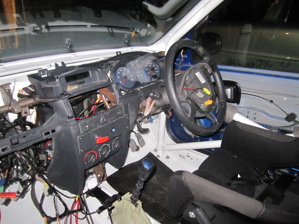

Was getting short of time so bodged a bit of plastic onto the dash to take the cutoff and extinguisher switch/pull. Got some aluminium plate to make something a bit nicer up when I have time.

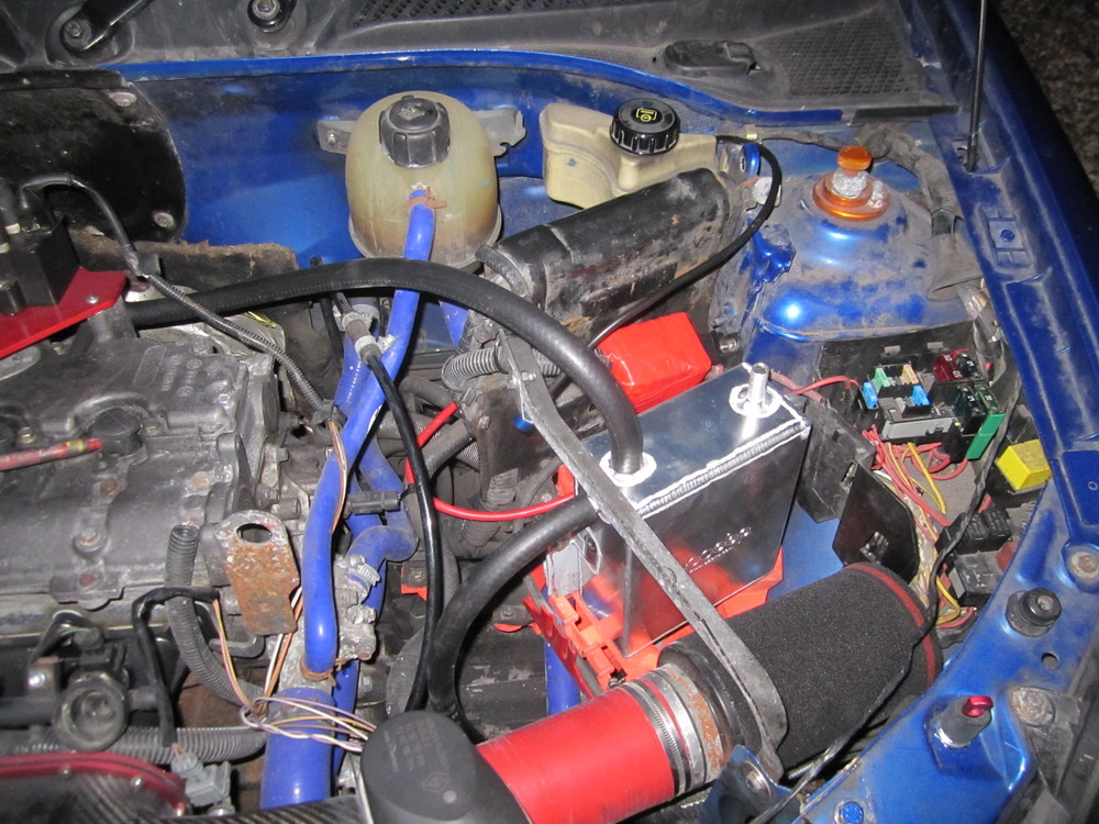

Catch tank in, although still needs finishing off lol

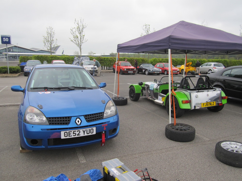

Seat back in and ready to head to brands. Still needs the wiring tidying, dash top re-fitting and various other bits and bobs but nothing major.
Forgot to reconnect the heater controls (stuck on hot) and electric windows so it was a nice hot drive up to Brands. Scrutineering went well, just a few minor things. I think fitting door cards was the most significant thing. So very relieved about that.
Met up with the rest of the clio racers - nice to meet every one. It was a good days racing to watch.

I've now got the dash top back in and oil temp and pressure gauges where the centre blower holes used to be. Watching the oil temp though seems to be just something new to worry about. Amazing how a 1 minute run round some cones in a car park takes the oil temp from 60 to over 100 degrees.

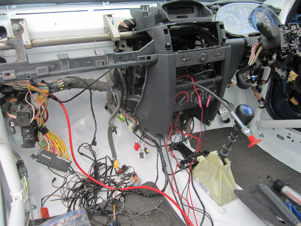

Got the dash looking a bit neater. I still need to chop out the air bag wiring and neaten up the cut off/ext bit in the centre console.

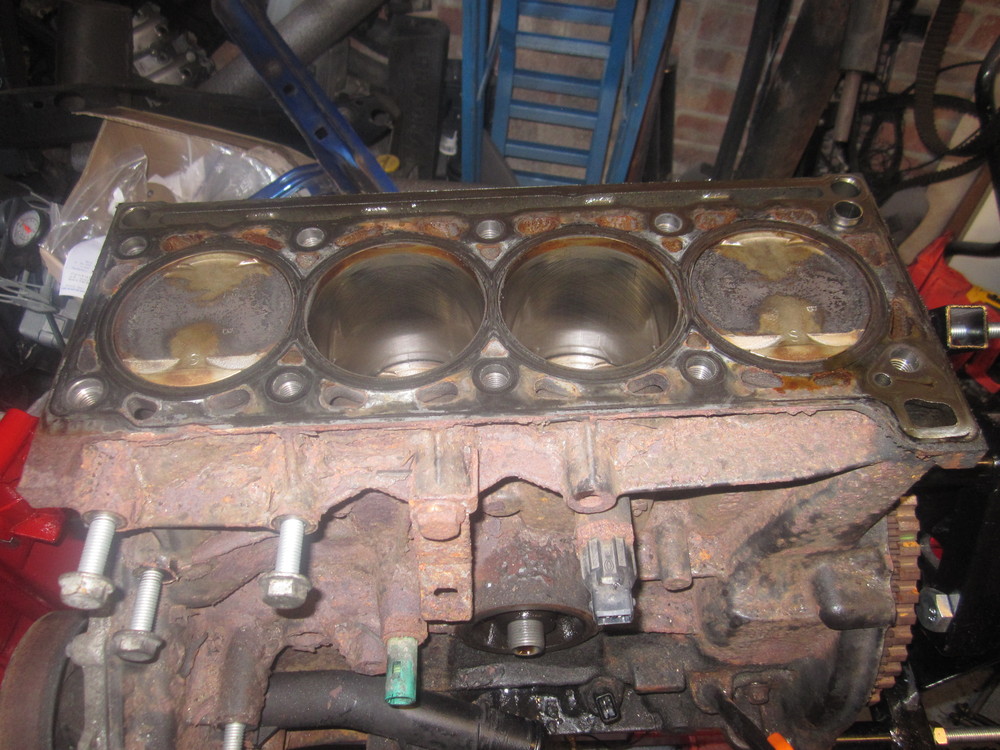

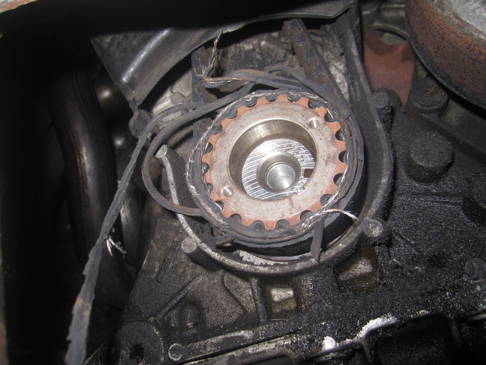

I missed my first race at Anglesey after a little mishap with my aux belt.
I put a new clutch in. Had the engine back in and started it up started fine and I was giving it a once over when I thought something wasn't right with the aux belt. Then I saw it was shredding itself so went for the key, but it was too late. Before I got there it went tap, tap, tap and stopped.

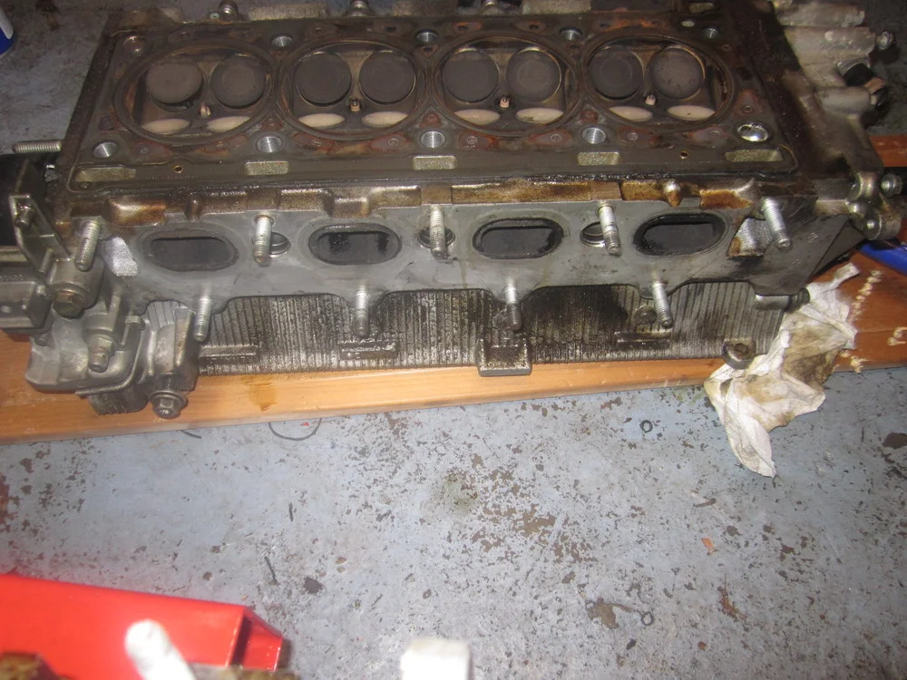

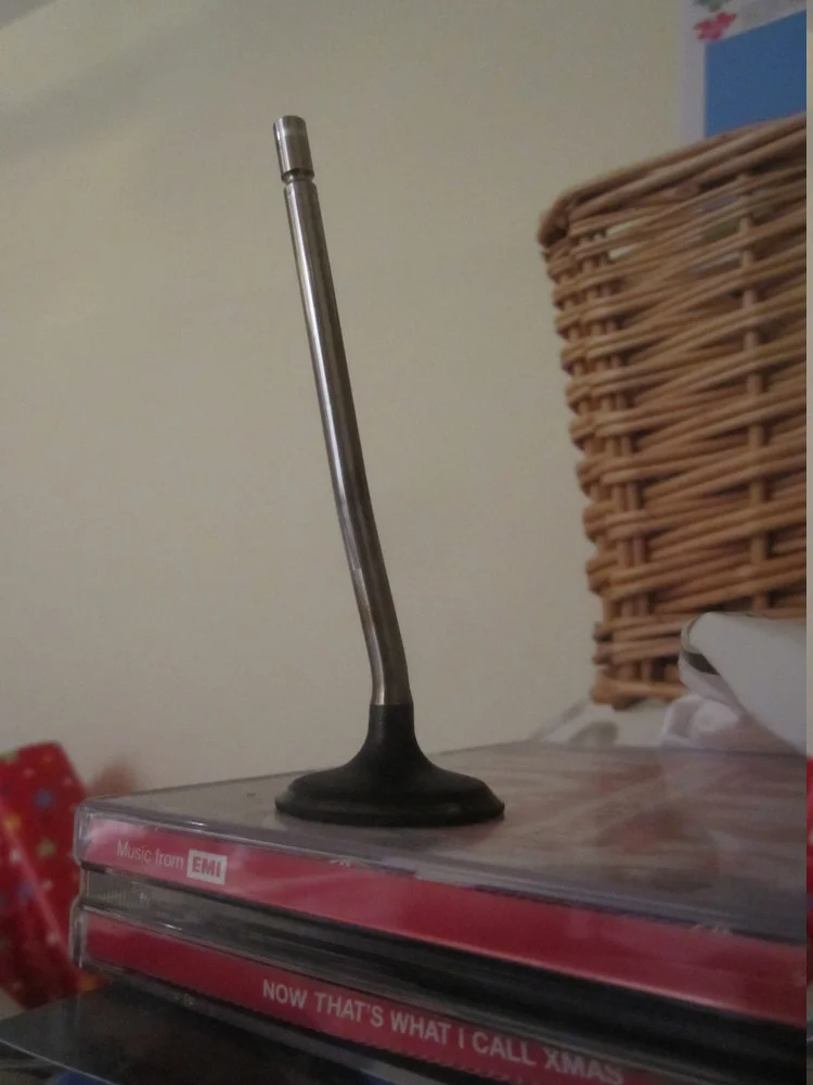

I timed it all back up the next day but it wouldn't start and had 0 compression on all cylinders :(

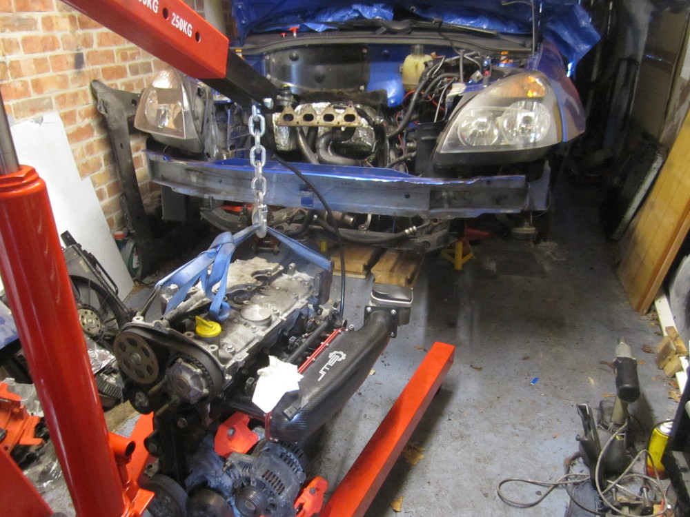

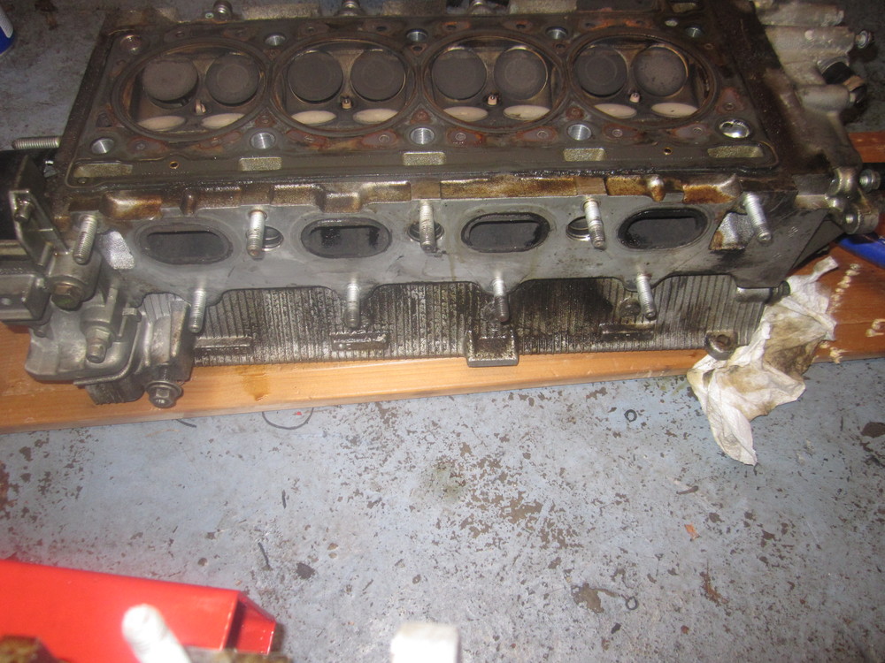

I priced up new head set, bolts, cam belt kit and seals and it was approaching 300 quid. So I decided I'd just give my spare engine a try as it only needed a cambelt. It was a bit of an unknown quantity though as it had no history and a hole in the sump. Although I had checked the big ends to make sure there was no oil starvation damage before I bought it.

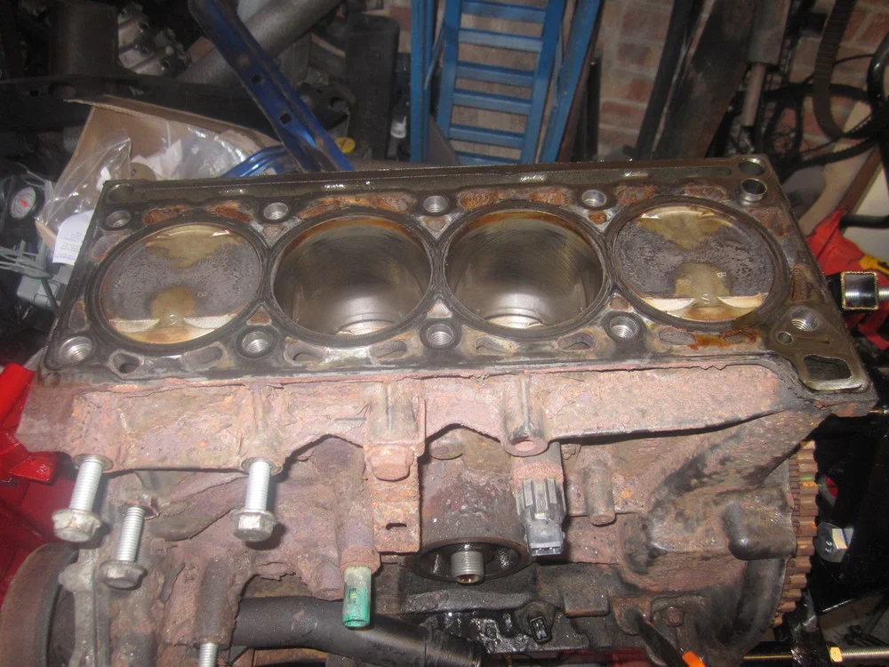

Pulled the old engine apart to have a look at the damage. As good as could be hoped for really looks like just inlet valves although I haven't checked it out properly.
Interestingly after 138k miles it still had the original honing marks on the bores.

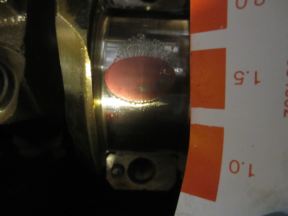

Swapped the sump and my ARP rod bolts to the new engine. Bearing clearances looked good and no significant scoring on the journals.
New engine all together and ready to go back in.
Got it in and started no problem. Have done about 20 road miles and all seems OK with it.

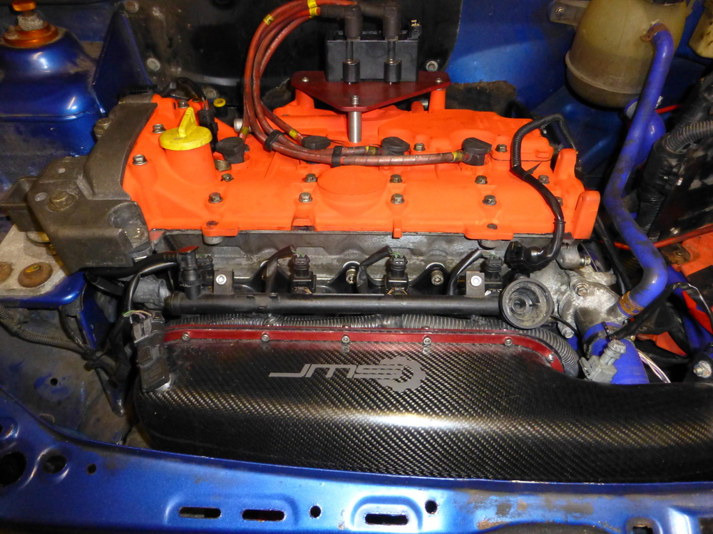

Now I need to put my 428 cams in it, as that is what my ECU is mapped for, and fit a new cambelt kit. There was a suspicion that my 428s where from a "dodgy batch" so I decided I'd take the time to dial them in this time and see if the timing marks are machined incorrectly.
That's were I am up to at the moment. Hopefully get the cams and belts in this week.

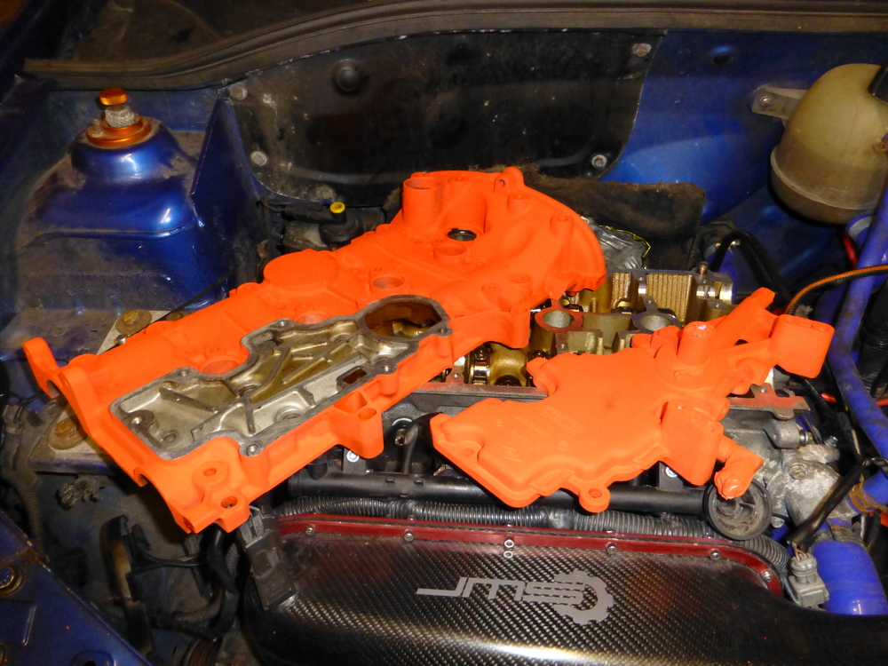

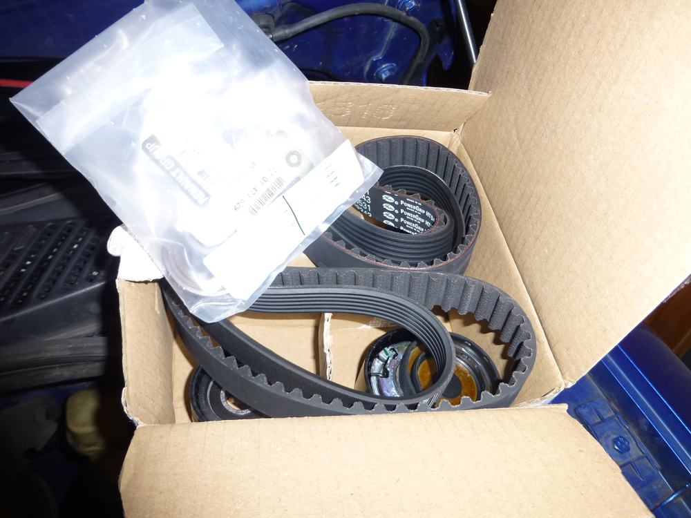

Fitted a my cams and a new cambelt yesterday.

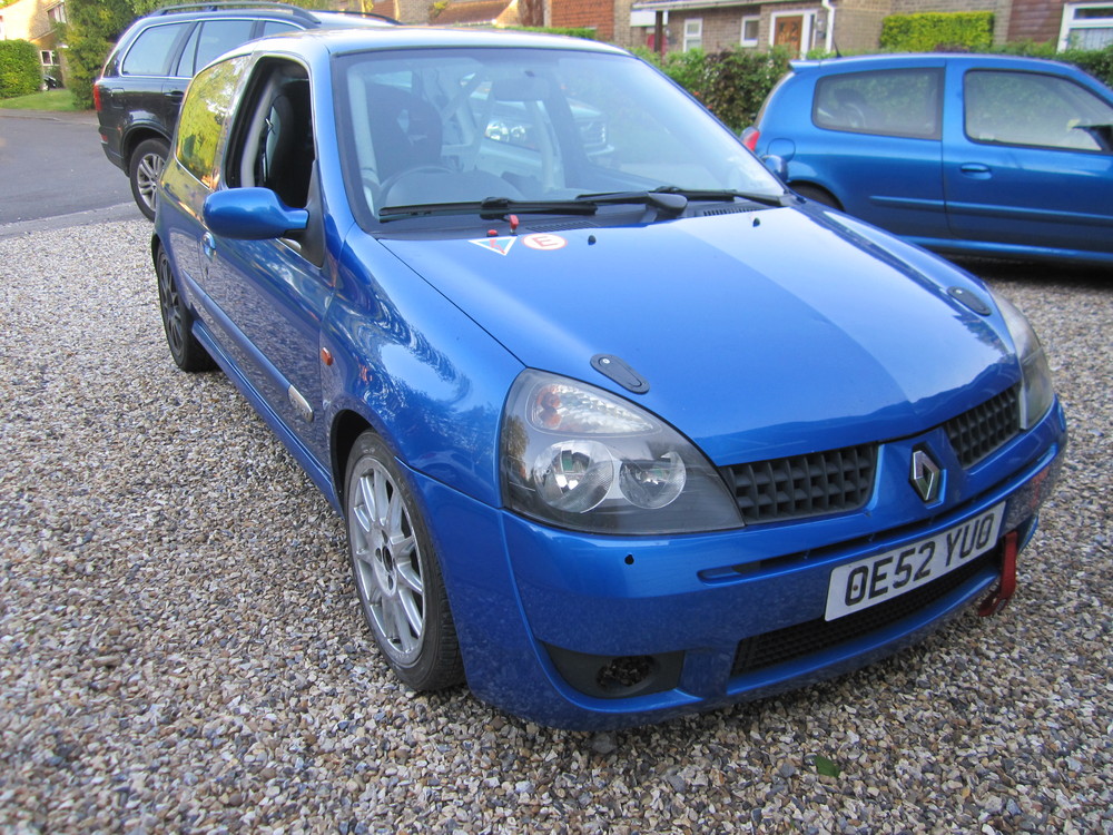

Decided on a red cam cover this time.
New cambelt and bits to go on.
All back together.
Took it out this evening and did about 20 miles in it and it all seems fine. So now I am back were I was 6 weeks ago lol!

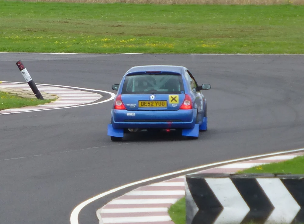

Another update - Castle Combe Rally Day 18/8/12
My local car club were planning to attend the Rally Day at Castle Combe so I thought I'd go along.
Loads of interesting cars there. I had 4 track sessions lined up and some goes around the mini rally stage.

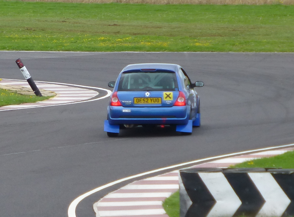

So I needed to make my car look like a rally car. So I added some mud flaps :)
Looks the part I think. I am hoping to do a couple of tarmac stage rallys next year. Although I'm not quite sure how I am going to reconcile my circuit suspension setup with potentially bumpy rally stages. But plenty of time to figure that out.
Circuit time was good fun. Was track day rules but since my sessions were all rally cars they seemed a bit more relaxed about over taking... Shame my gopro battery ran out at the start of my final session as there was a scooby with some sort of problem in front of me who did a spectacular spin in front of me.
Also had a go on the mini rally stage - it was a bit short but good fun non the less. I even managed to hit some hay bails when doing a handbrake turn - no damage fortunately.
Car behaved again.
Just need to remove the mud flaps and a few other jobs ready for Mallory on Sunday.
