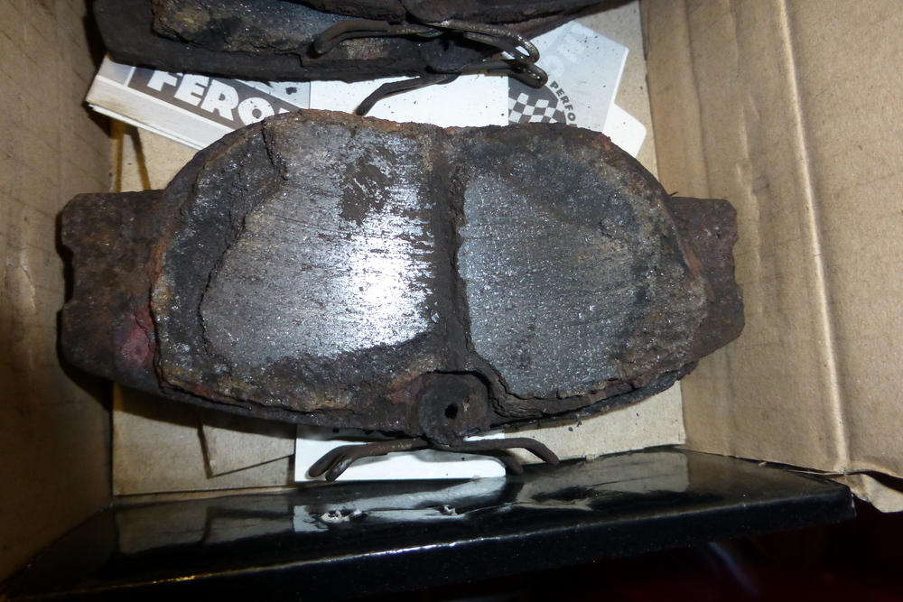

I think the DS2500 pads don't have as much feel as the DS3000s under heavy braking. This lead to me regularly out braking myself into the corners, especially at lodge the final corner. I didn't actually get any fade from the pads though, it just wasn't stopping as well.

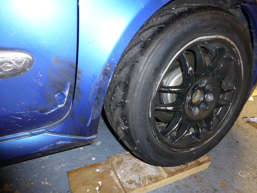

My front right wheel is knackered after the first corner incident apart from that there is just some minor scuffing.

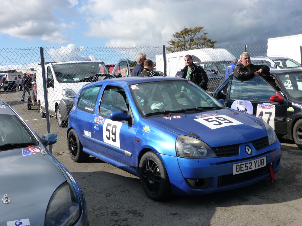

Me and the ktec clio

Great stuff Mark - try some EBC Yellows worth a punt at £85 for a set of fronts, don't have any issues with them at all (not the CS choice pad though lol) and get great bite and stopping from cold, better when hot though!

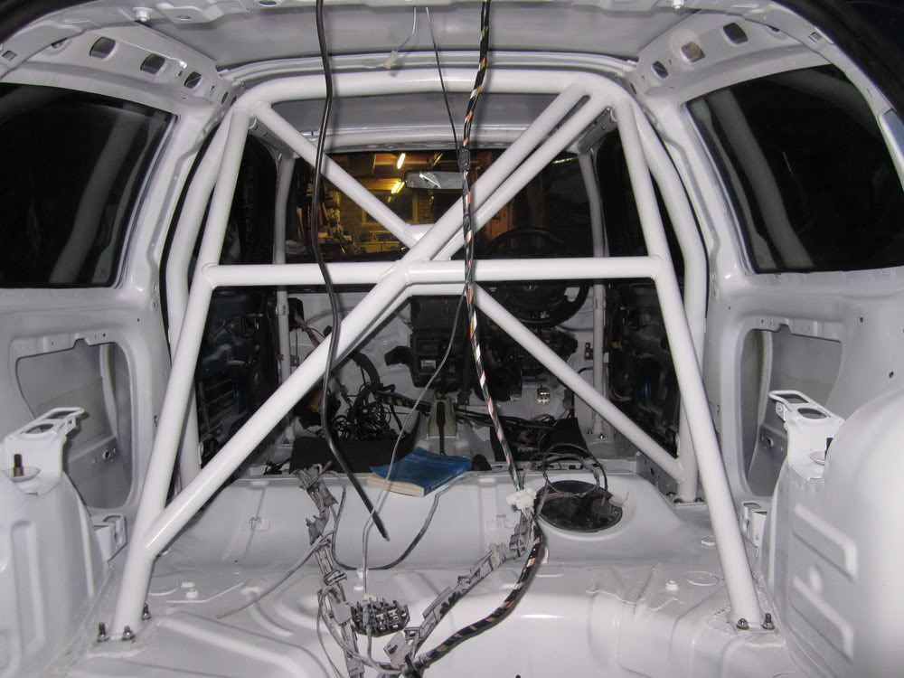

Do you have a part no for the cage ? also I see they need welding up as they are tacked together, how much needs doing and can you get the cage in and out again once its all welded up ? I assume its bolted to the floor plates ?

It is an OMP AB/105P220H (the picture OMP is wrong http://www.ebay.co.uk/itm/AB-105P-2...arts_Vehicles_CarParts_SM&hash=item27cac11d47) I paid 540 for mine in July last year delivered from tweeks so I'd shop about a bit. Although I had been watching them for a while and I wondered if they'd made a mistake when I saw mine come up on ebay as it was over 100 quid cheaper than normal so I bought it ASAP.
It bolts to the plates yes. It is 90% welded at the factory. All you need to do is weld in the floor plates, the ones they send you are a bit strange - I think they had not updated the plates from when it was arch mounted, I managed to use them without much bother though. You need to weld in the door bars, you only get a single bar per side I added the cross myself. The only bit that is tacked is the cross in the main hoop - I asked OMP about this and the idea is so you can adjust the position. I cut the tacks and removed the X as it was several mm too big. I could have got it in as it was but it would have meant cutting into the sills a bit and I didn't really want to do that. Sounds a ball ache but it wasn't so bad really. I did it all with a hobby welder and grinder in my garage.
With regards to getting it in and out it all depends on how you weld the door bars in. IIRC it just comes with some bar so you would be welding the two parts together with the door bar. I made my door bars bolt in as well so I could remove the cage - in reality though I can't see why I ever would. The dash and seats have to come out to get it in and out.
I added the harness bar myself. The FIA cert says you can modify it according to some drawings in the FIA regs - basically any of the std additional bars you see about are fine to add.
The bolts for the rear points are also a bit of a pain. They go through the boot floor and out of the spring platform. I have ASTs so this was no problem for me but I ended up cutting the nipple thing that the original spring went on and then welded a plate over that as well. If I'd taken a bit more time about it I probably could have saved the original spring pick up points. The boot floor is paper thin so be careful with the welder.

Thanks Pete. I definitely need to try some different pads the EBC ones seem a lot more wallet friendly. I only managed 1 test, 1 race and 2 wet track days on the Ferodo pads, although I think I have some mild binding.
Just re-reading this and I thought it sounds like I didn't refit the cross in the main hoop. I did refit it but I had to shave about 10mm of the bottom tubes to make it fit.

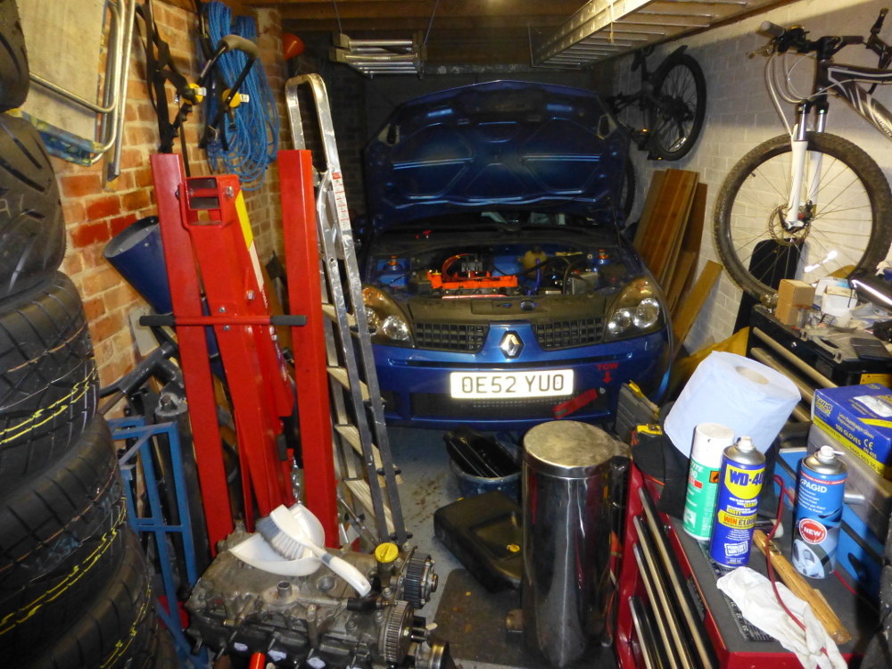

Well I have been busy buying things lol.
I have actually only started working on the car this week! I haven't touched it really since last year.

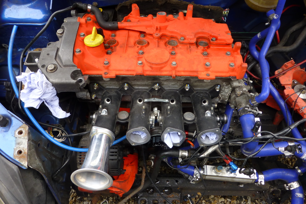

I have some ITBs and am going to get rid of the std loom and ECU. I will have some fibre glass doors from the group buy and I already have a boot and bonnet. I have some plastic windows. Plus lots of other little bits I can't remember and will probably never find in my garage again lol.

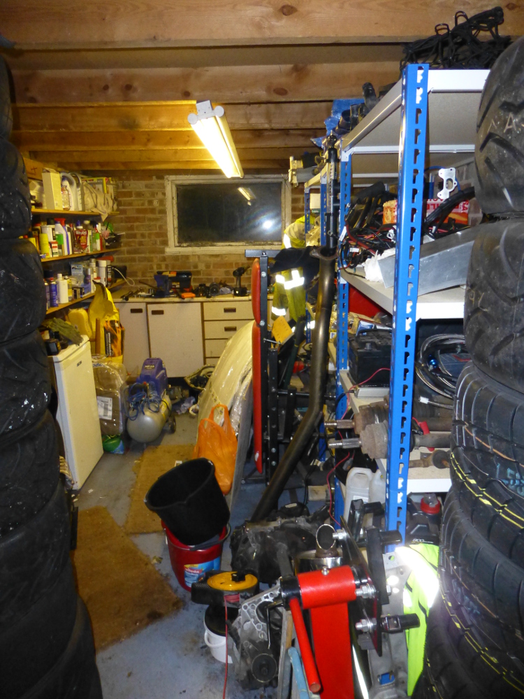

Current state of my garage

Aladdins cave ! is that a big swirl pot next to your tool cabinet lol
Plenty to do then, I think time especially with a young family is the hardest thing to find and throw a wedding into it you will be very busy.

If you need some of the R1R's out of the way more than happy to move them for you! :)
Need a bit of a tidy up in there Mark.
You're not wrong. It is actually worse now...

Yes I think it will go nicely in the clio. Once in, I reckon I'll be able to pull 9g without any fuel starvation issues ;)
Wow...where do you sleep?
​engine for sale???
In the car - except it is also full of stuff.
Looks like my garage lol
The only thing that keeps me going every time I go between my 2 tyre pillars is the thought "I don't think I'll need to buy any new tyres this year...". There are also 4 ad08 on the car.
I'm doing an autosolo this weekend but using the 182 for that as the race car is in too many pieces.

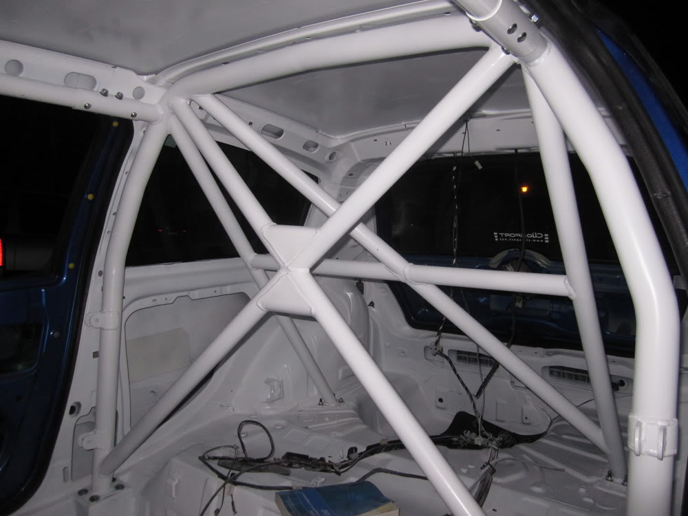

Hi Mark
A bit of a strange question for you, do you think you could fit the trim back in around the cage ? I need to run with all my trim in 1B but I am running with 140nm springs in the standard position so I was thinking of fitting this cage so it feeds some load into the cage rather than than into the mounts as I think it will bend the shell after a while.
​Cheers
It depends if you're allowed to cut it.
The main hoop clearance is very small so I'd say you would not get the head lining or original seat belts back in. You could get the head lining in by cutting it. Seat belts no chance as there is just not enough clearance on the B pillars.
At the front you won't get the interior light back in and will need to cut dash.
For the rear stays you'll need to cut into the seats but it might well go back in. It wouldn't be useable though.

Blue book says you can cut trim to fit cage but doubt I could get enough back in, the safety devices cage will fit around trim but not sure if I want a dash dodger, although saves a large amount of work ( and possible wiring/running problems) but doesn't pick up spring mounts.
Will have a rethink.

Might not fit right out the box but trimming an inch off all 6 legs and using a ratchet strap to pull the legs in before welding and I can't see a problem IMO. It won't be easy but any cage fitting is tricky.

​Are you allowed to pick up spring points with the cage?, Some regs do not allow this.

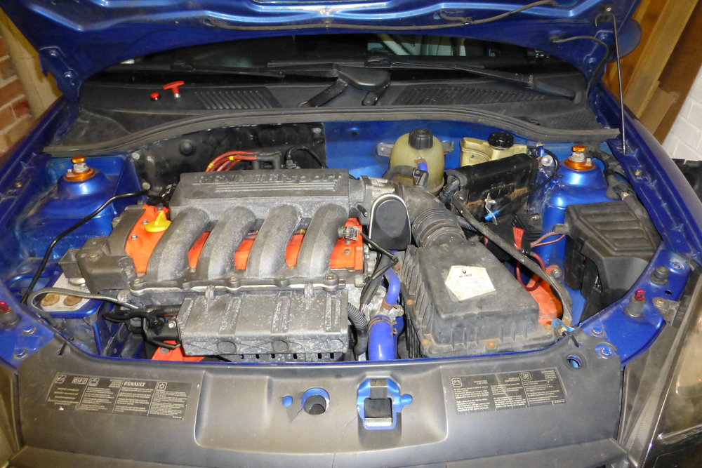

I started to fit my bodies and new loom. I got this far by early May...
and realised there was no way I would be able to get it ready in time. Seeing as I was getting married on the 11th and had some stuff to prepare before hand, the wife was going to be away on business for the 3rd week of May and we're all away for most of the 4th week of May. There were too many uncertainties and I didn't want to miss Thruxton with it only being 17 miles from my house and also a track you don't get to race at very often. So I decided to stick the standard looms back in and the standard inlet manifold. I sold the RS2 in January.
I had it all back together last week and got it taxed and insured yesterday and went for a spin today. All seemed fine so I cracked on with my job list.
Today I changed the lower ball joints, inner track rods and track rod ends - I'd noticed there was significant play in the inner track rod ball joints. Changed the pads while I was there and discovered one of the DS2500s had disintegrated and lost about 50% of its contact area. So now I know why my brakes seemed a bit dodgy at Oulton last year.
Still got a few jobs to do before Thruxton but they're mostly minor so hopefully I am nearly ready to go.
Are they 120mm trumpets? Thanks & great read :)
They sure are :) It is a tight fit with the angle the ktec bodies come up at, I'll need to trim a bit of the inner bonnet skin away.
