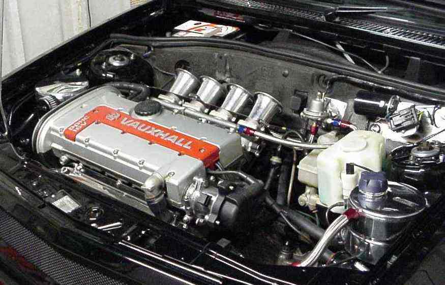

the TB trumpets sitting above the exhaust manifold isnt a good idea. I recently saw an ad in CCC for 180 degree trumpets that will allow you to have them facing forward with a proper filter. That should give you quite a few extra bhp. Looks mint otherwise. How much did u spend on your mods and have you touched the brakes/suspension too?

I have an Izuzu Trooper / Vauxhall Monteray bonnet scoop fitted to get a decent cold air feed to the trumpets. I have an ITG air filter which covers all the trumpets whilst driving it on the track or road.... SBD kit is reckoned to be 208Bhp, but once i have stainless manifold fitted ill be taking a trip to SBD to get the car mapped up properly, which should hopefully release a few more horses!
Ive got Bilstein suspension all round with tarmac spec springs, rear disk conversion (astra GSi gear with Hi-Spec cross drilled disks) up front Vectra V6 Calibra Turbo calipers & 288mm cross drilled disks.... still got an uprated Helix clutch to be fitted.
Ive had the car for over 10 years now, and lost count the amount ive spent!! throttle bodies was one of the last major mods i wanted to do!
They dont?!
On that engine, the exhaust manifold is on the front of the engine and the inlet manifold (& TBs in this case) is at the rear of the engine.

Very nice setup mate, very nice.....top job, the cars not for me, but the engine is. Its far easier to get power out of the XE lump than the F7 lump.........
philip, those 180 trumpets, awful for flow patterns and a last resort....id rather cut into the bulkhead.

Rich.... yep finally all in, just waiting for JP Exhausts to finish polished stainless manifold, then got to arrange a trip to SBD to get mapped up!
