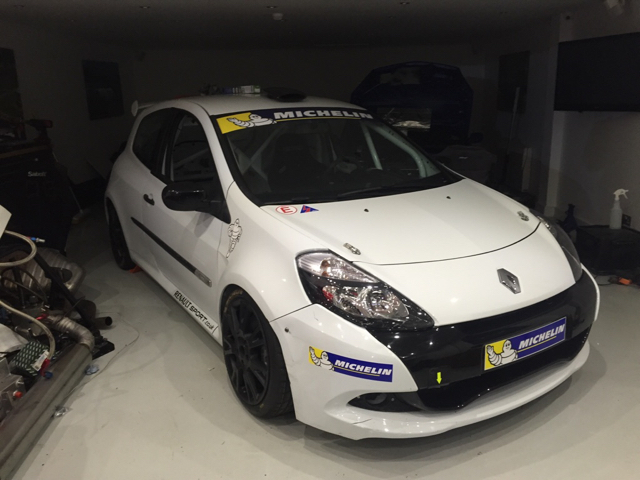

Wow.... that is pornography..... although i prefer your garage set up to be honest :smiley: let alone the contents of the garage.
What airbox/induction set up is that ? i am guessing that could not be done to a regular 197/200 due to the location of the fuse box and battery ?
That induction set up is a v6 airbox mate and it requires the relocation of the battery - no big drama tbh.
It's the maxi evo that requires the relocation of the header tank as well. They're £££'s though.

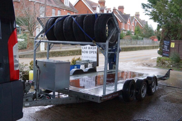

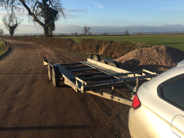

I've got my trailer sold and was going to order a new one from Brian James but then spotted a good one second hand for sale that's the perfect size so im collecting that in the morning

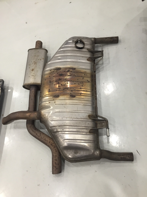

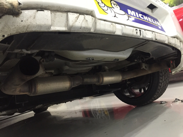

Bedford is a week today and there is no way it will pass noise testing so I've bought a standard exhaust system and its booked in at Hayward and Scott on Tuesday for them to fab it together so it will be a really quick swap between the two systems

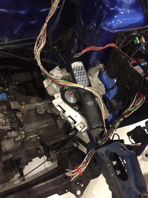

In other car news been busy sorting out Porkies Clio which we've been sorting out the engine loom on

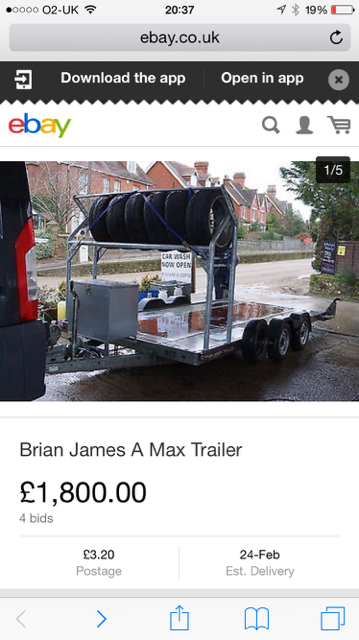

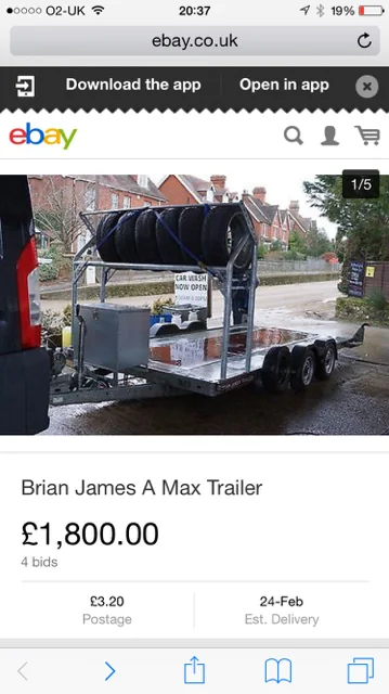

I'd have been getting the trailer posted for £3.20! You'll use more than that in diesel just starting the bm up! Lol!
Haha too true!

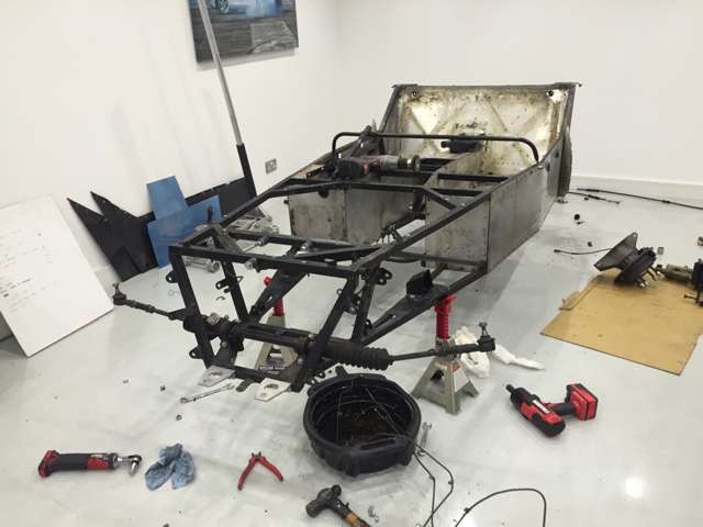

Whats the plans for the Westy mate, just a re fresh or a few improvements?
Yeah a few improvements and refresh :) Diff cage kept cracking so modified and reinforced the chassis. Swapping to proper pedal box with hydraulic clutch as the clutch cable was suffering being located right by the turbo. Modifying the rear diff and getting it running cooler, engine check over, sequential box check over, full re wire, few bits of carbon paneling and a million other things I can't remember :)
Sounds cracking mate, ill look forward to seeing the up dates.
Does Lee have a project thread James?
Thanks mate :) no he doesn't I'll try keep putting a few bits up. The Westy is the interesting car and the plans for putting it back together it should end up even more special than before!
New trailer looks sweet too!!

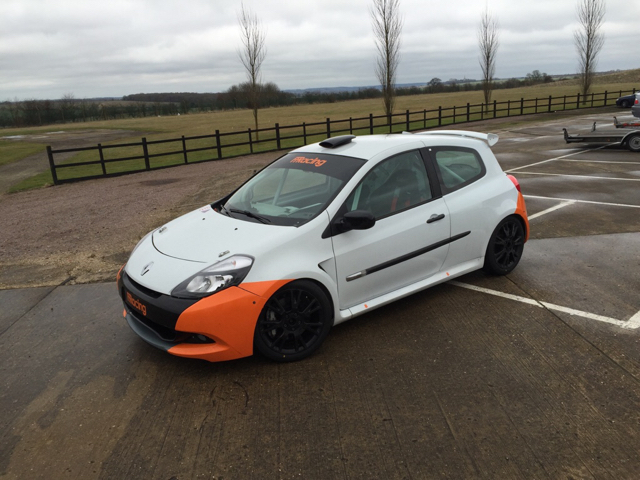

Awesome day at Bedford today! First session was on wets and the car was mega! Last session of the day was cool too! Had a few others driving it and common consensus seemed good!
Standard Road backbox felt like a real restriction so looking forward to a noisy day and run it on the loud exhaust.
Other than that a quick check over and oil change and ready for the next one

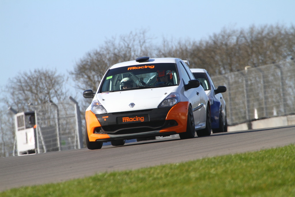

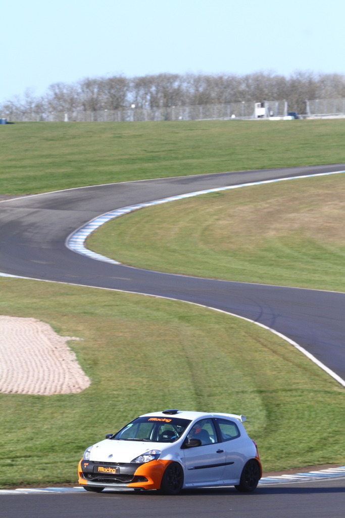

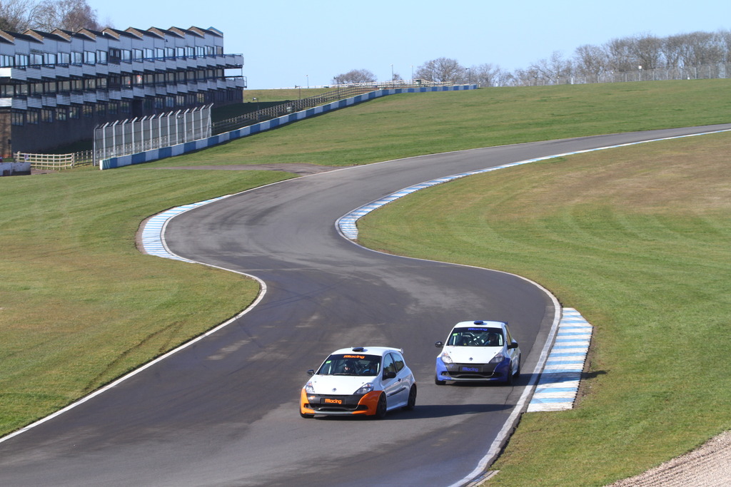

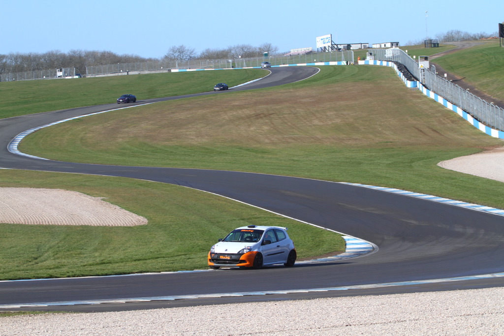

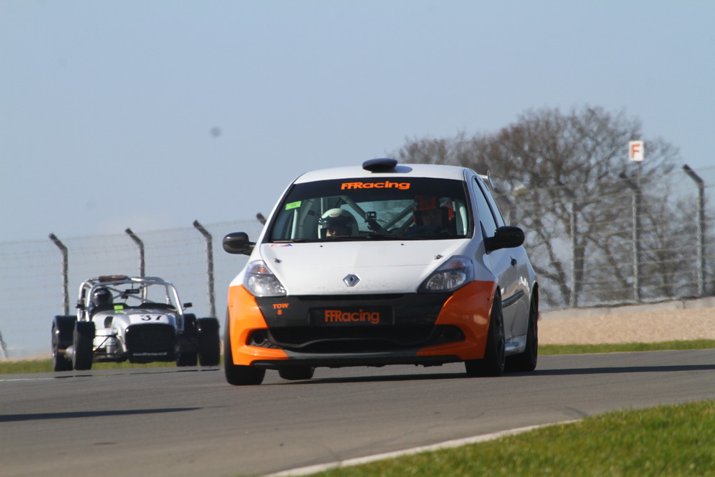

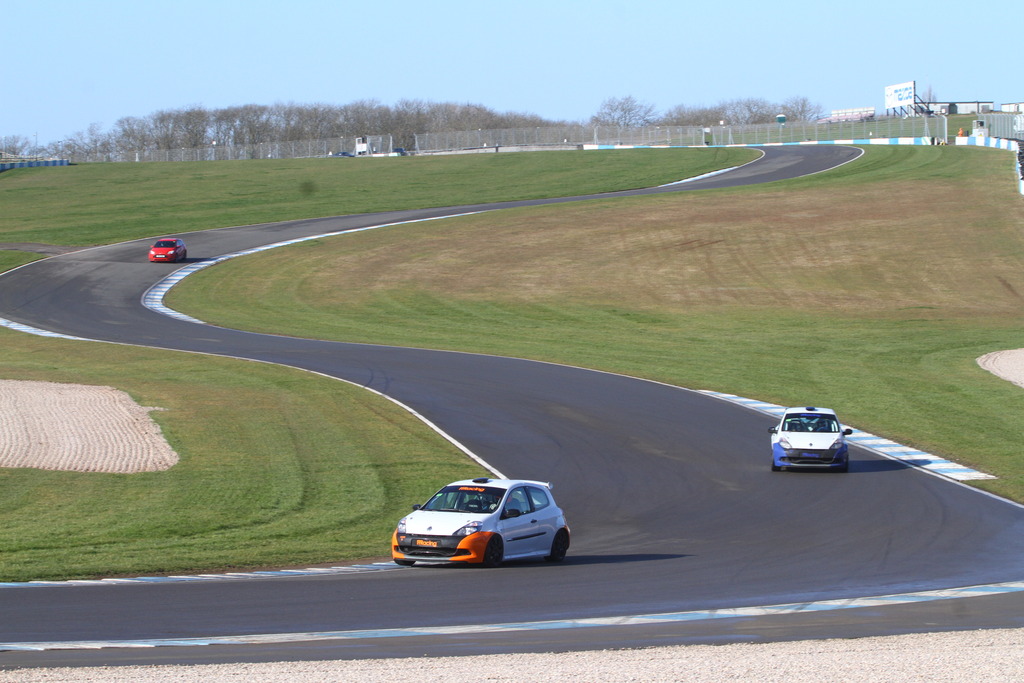

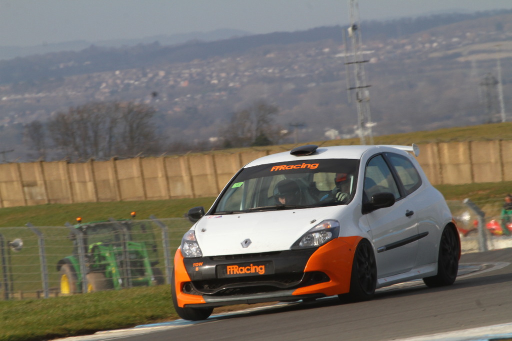

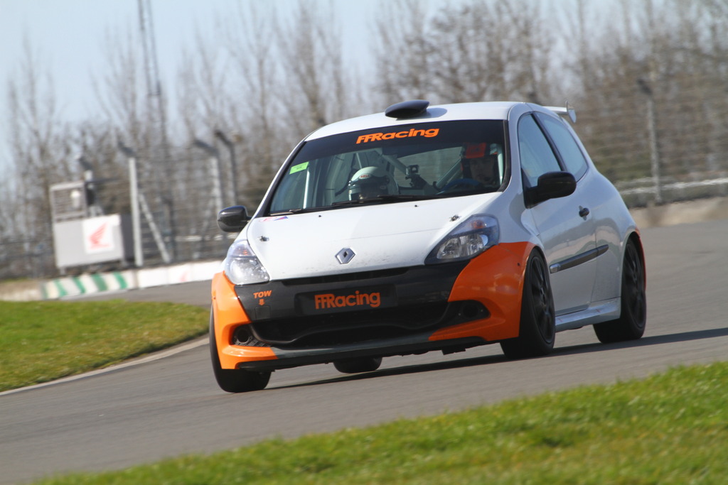

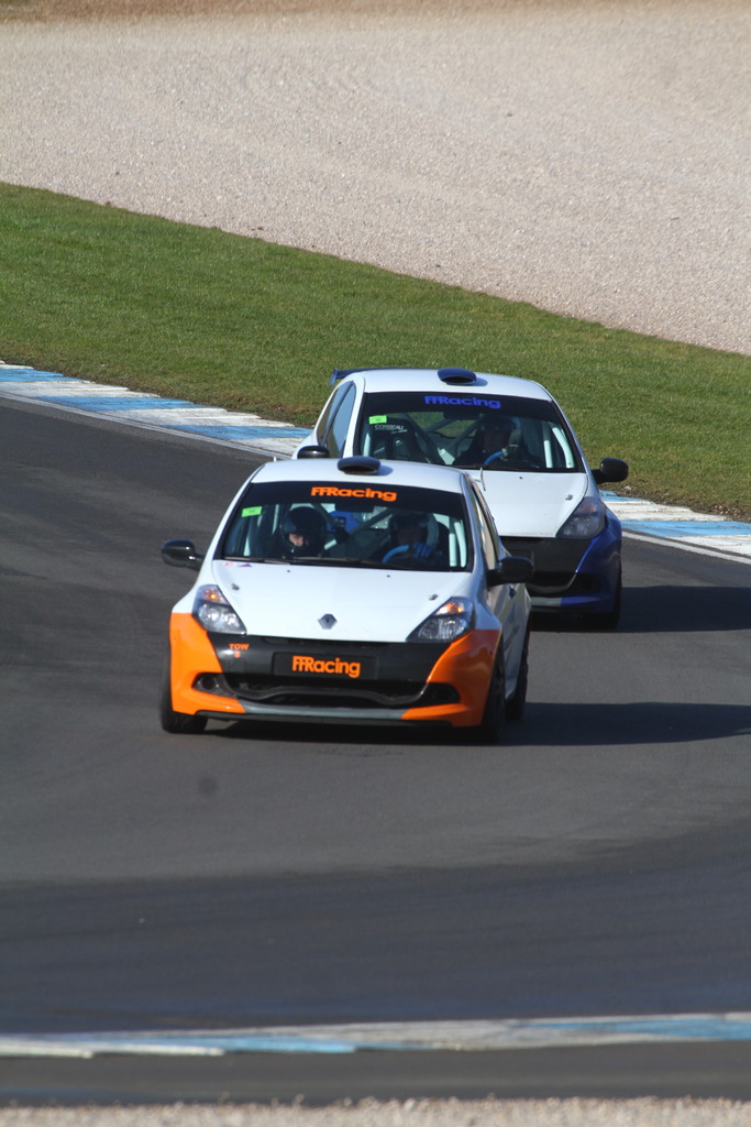

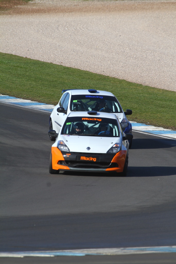

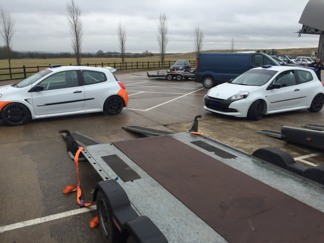

Great day at Donington on Tuesday with the car and Porkies car :)
The cars ran faultlessly all day, we left them on the Dunlop DZ03’s for the day (The tyres we would run if we opt to race in the CSCC Millennium series) Setup is feeling pretty good, a few bits to tweak but nothing major :) We were surrounded by some special cars with a 2005 LMP1 car out with us!
Video of both cars having a bit of fun :) Very difficult with trackday rules to overtake without breaking the rules between the two cars. Both cars are setup identically which makes for lots of fun!
Plan from here is to give both cars a good spanner check and they need fluids, filter changes and we are going to dyno them to get some base figures and compression test and then we can monitor health moving forwards :)
