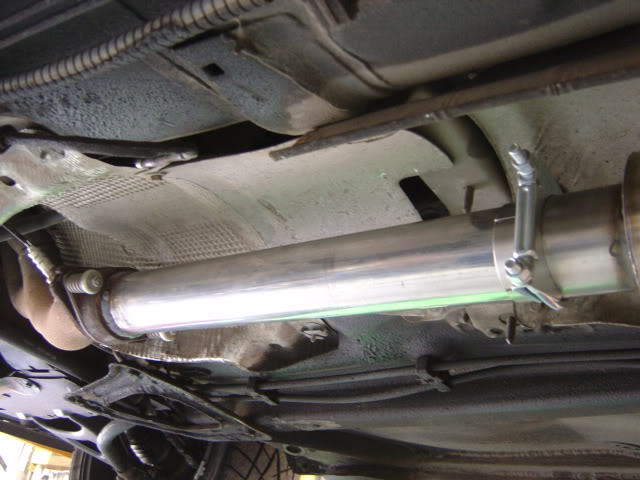

Its just chopping both the olive ends(or flanges in your case), so you have two end bits of pipe, flaring it out slightly so they fit inside each other and then a clamp.
That's one 519Automotive did.
Yeah I saw that in my other thread! It looks good!, but what would I have to do to my cat to do this?
And flaring, what does this mean/involve?
Sorry to be dumb but I know nothing :o
It can be sleeved on a cat pipe too. The tapered section is chopped a little with a pipe welded. That fits over the centre section then a clamp on it. Sleeve joint. It's the best way. Fred done mine. His welding skills are second to none too
Not really cos there is a flange on the end of the cat.
If you want to run a sleeved cat it will need to be chopped and welded.
Or you can do like i've done and buy a miltek decat, a sleeve joint, 2 clamps and chop the end of the centre section off.
