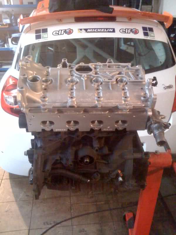

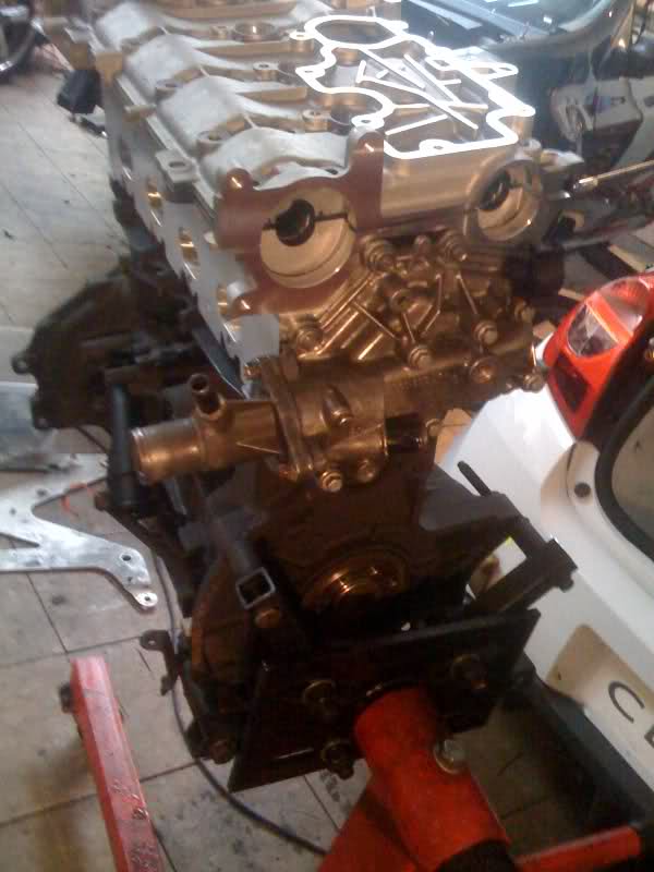

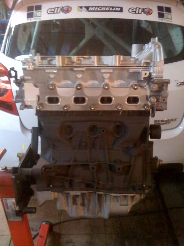

Built this over the weekend for the Super Cup and for Super-2000 inlet manifold testing:
Not a bad weekends work.

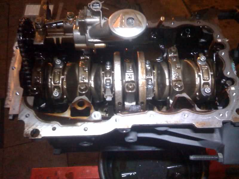

Spec is fairly boggo F4R 736 but with a bit of safety added for sustained high RPM use.
- Brand new F4R 736 Cylinder head incl valves, seats, guides, springs, seals etc. etc.
- Standard bottom end bar ARP 2000 big end fasteners
- Cometic MLM head gasket
- New roller rockers and lifters
- Few other bits.
It will get the CAT428's from my current engine along with new timing gear, clutch etc. etc.
Just need to find the time to get it into the car now!
Cheers
M
How come you haven't done anything on the head dude?
Inlet manifold details please ;)
Because I need a completely standard to original brand new Renault spec head in order to correctly gauge the performance increase the new inlet manifold gives.
If I have a fiddle or have the port shape tweaked etc. then the results aren't comparible to the standard data I have.
Cheers
M
Makes sense! How come you're fitting cams? Can it only have valvetrain changes?
Race regs or just curiosity for the open market?
Cams are part of the engine spec. Will do testing with standards and 428's. All on a standard cylinder head though.
Open market once all the testing and validation is complete!
Cheers
M

It'll be productionised and available from March. Complete bolt on kit which retains DBW throttle body for cruise control, traction control etc. etc.
Cheers
M
Once the prototype is done and the design validated then I'll post a thread with pics, details, graphs and prices ;-)
Cheers
M
More power........... why else would we be doing it? ;-)
Essentialy greater flow and velocity with much less restriction and a much more direct patch between TB and Port than would ever be possible on the standard manifold. F4R's respond so well to matched inlets and ITB setups because the standard inlet manifold is so poor.
What Ben and I have done is put together a package thats as straight bolt on and removes 95% of the restrictions present in the standard system. Each cylinder is fed by a 45mm air horn which is mounted in the base of a plenum. The plenum carries the standard DBW throttle body which is plenty big enough to flow way more power than you'll be making on an F4R with remotely standard internals.
At the moment all teams running to S2000 regs in BTCC, WTCC and Rally are using a very similar setup as S2000 regs dictate the use of a single throttle body. GM are currently generating getting on for 300bhp in the BTCC Vectra from a 2 litre, 11:1CR, 11mm valve lift, single throttle body fed engine which shows how much potential there is in a single throttle body setup if its designed and implemented correctly.
Cheers
M
