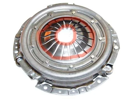

  Trophy, Audi TT,
here is a picture of a clutch cover (its not a Clio but you will get the idea...)
you need to spray where i have highlighted in red. To be honest, with the engine running you are going to get good coverage in these areas anyway! critical points are where the bearing touches the fingers and the diaphragm pivot points (of which there are many but you cant see them in the picture....) spraying with the engine running means you will get them all.

ok, this is clear now, thx! I have some lithium based grease, do you think I should buy some motor bike chain oil instead?
  Trophy, Audi TT,
you mean the fork (or lever as you said initially) fingers that press the release bearing onto the pressure plate? is that where you greased? never heard of clutch diaphragm before
Cars use different types of clutch cover. they used to use a spring type which used a series of coil springs to put pressure on the the driven plate. Most modern clutches now use a diaphragm spring for this purpose. its a single piece spring, pressed from a flat piece of spring steel. Most clutches use these these days as they are lighter, cheaper to make and last longer. Even motorcycles use these now...
