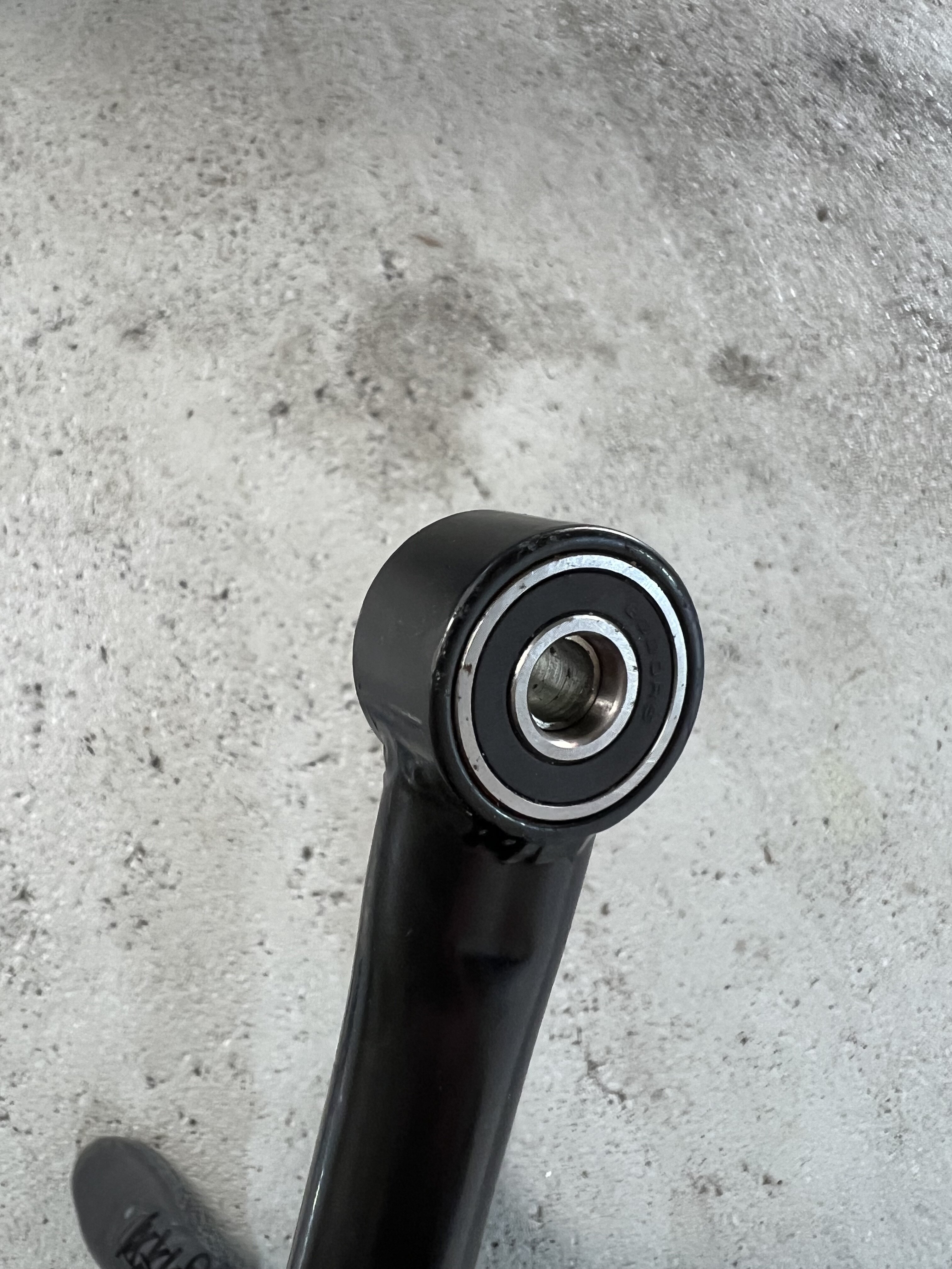

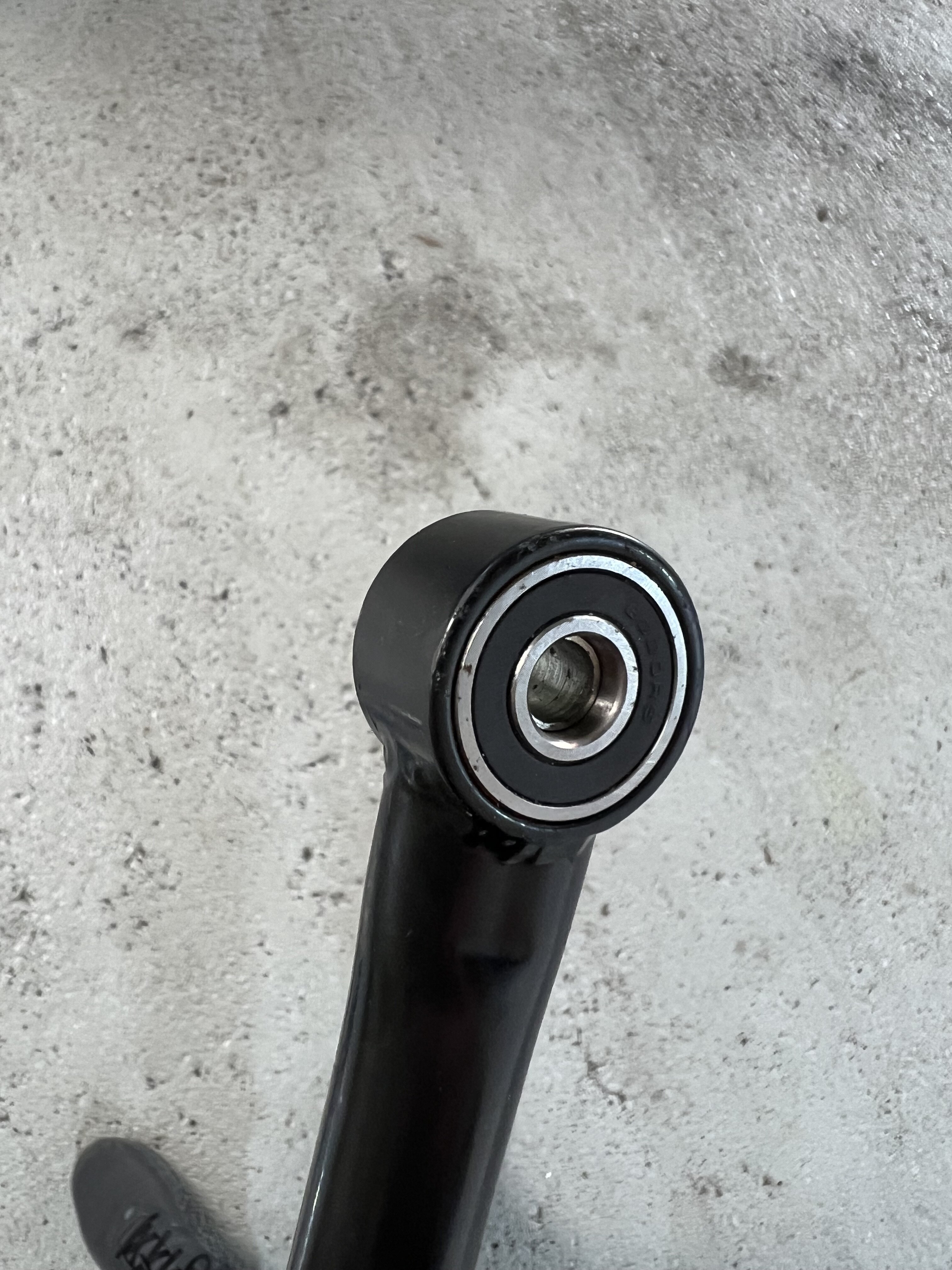

Didn’t get much done today.
Spent an age pissing around with the PMS shifter trying to get the bearings out. Given up, and will probs just order new assembly.
The bearings in mine are all completely shagged. Not sure how long they’ve been in but they’re all seized solid.
Got the oil and filter done though at least. So one thing ticked off the list.

  • PMs shifter rebuild kit. All new parts. Upgraded bearings. NMB ABT12

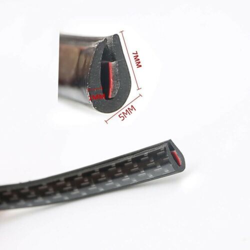

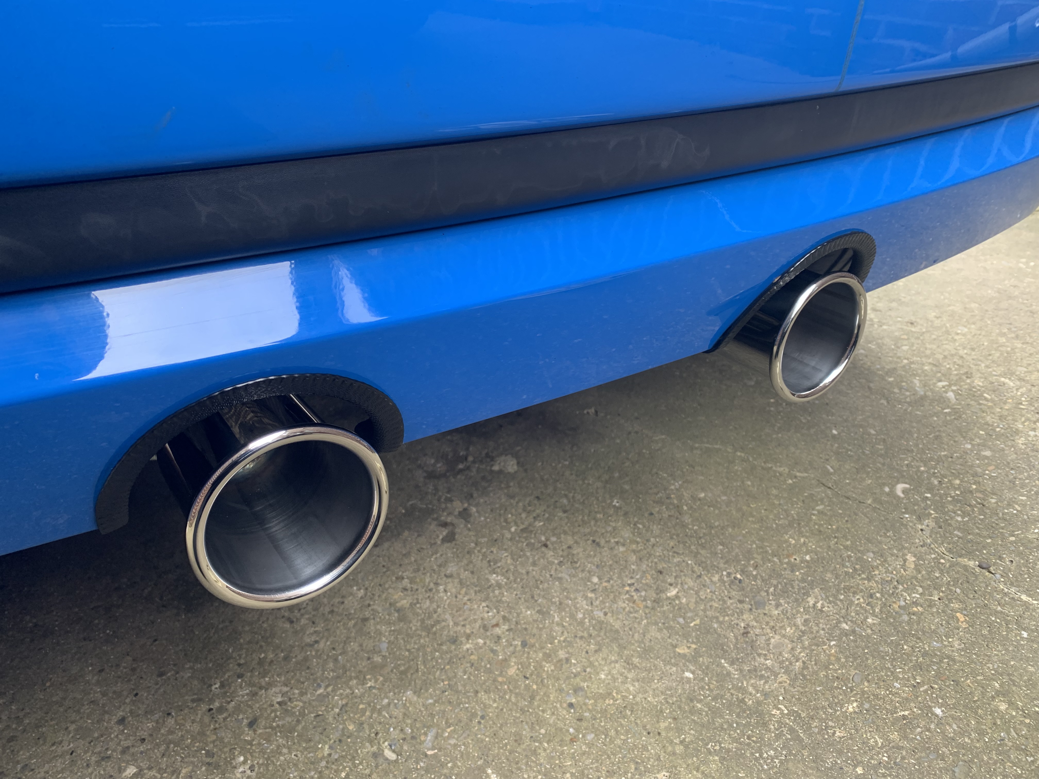

That looks nice, but will probably melt or worse, set on fire. Designed for door trims.

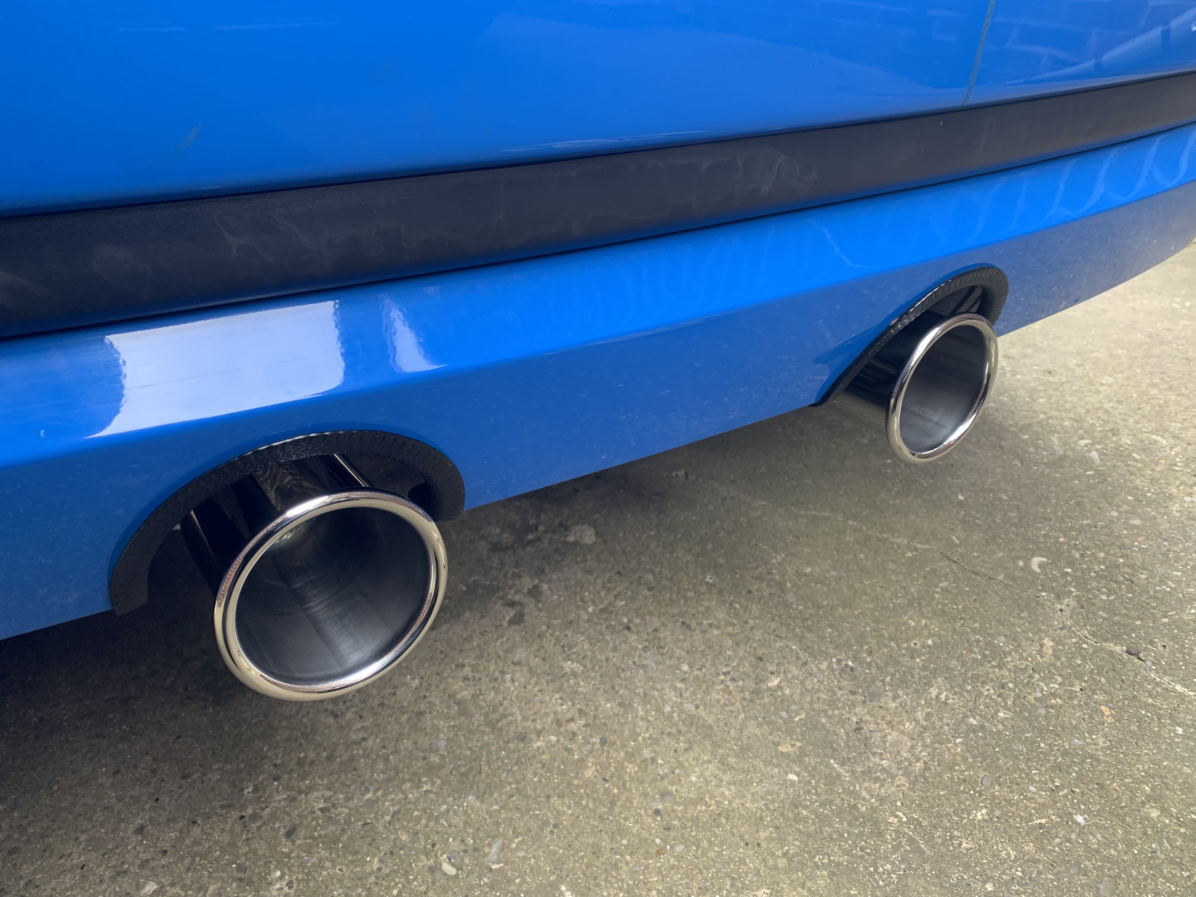

I must have had 3 sets of original exhaust trims over 7 years of ownership. My biggest issue is the PMS exhaust tips expand, a lot, and melt them. It’s partly why I opted for 3” rolled tips over the 3.5” slash cut ones. The stuff I use is for commercial purposes and is designed to withstand heat. Popular on track/race cars.
Finished off the last bits on the clio this morning. Gear Selection still isn’t perfect but it’s close. So a little fettling to sort.
Thanks to @Mr Underhill for the recommend as always, these cheap trims are exactly the ticket and look s**t loads better than the old gopping plastic snotters. Pictures don’t really do justice to how much better these look.
Before
After
