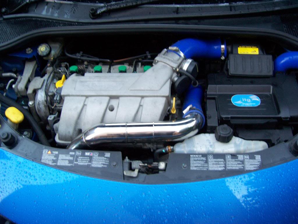

Cheers, no real plans, the inlet temps on this seem very high compared with the FRP engine, so I might use some heat wrap on the inlet pipework to see if I can reduce those a bit. I would like to smarten up my brakes, but doing it properly (strip down, powder coat, rebuild) is quite a big job, so not sure if / when that will get done. Next thing is to actually get the other set of wheels refurbished, then I can get my tyre pressure monitors fitted.

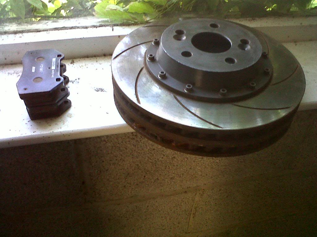

I have also just bought some used two piece AP discs, which came with some DS2500 pads; while they are a bit worn, I might give them a try if only to see how the DS2500's compare to standard. Also got some black speedlines with 888's on them, and have booked my first track day at Cadwell, so v. excited about that, just hope it stays dry, otherwise the Conti's will get a pounding.

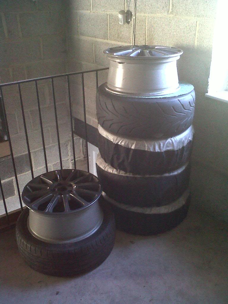

Stack of Speedlines, w/888's, and a couple of spare standard wheels
Two piece grooved discs

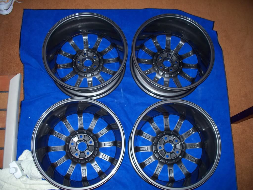

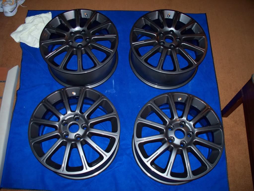

Went and collected my powder coated wheels yesterday, really nice job, definately recommend LSN Coatings in Castleford. I will probably also get my inlet coated once I have had some work done on it, not sure what colour though, possibly anthracite.

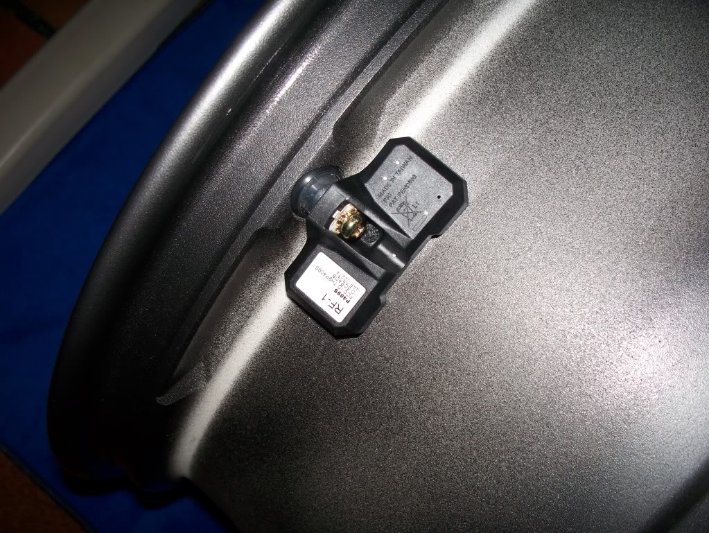

Anyhow, here are the wheels after a coat of Auto Glym SRP, and with the TPMS sensors fitted;
Hoping to get these fitted over the next couple of days. Not quite worked out where to put the display for the TPMS yet, but I am pondering it.

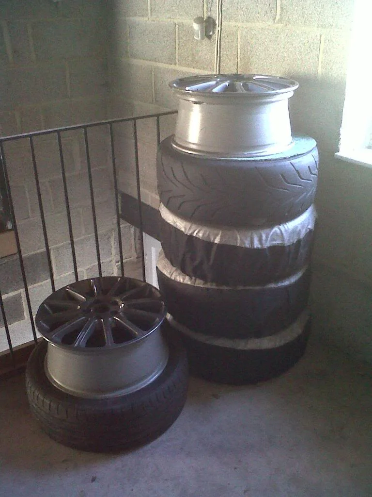

So, my preferred tyre place (who want £20/wheel to swap my tyres over) don't like refurbished wheels until they are two weeks old, which is disappointing, and means I need to find somewhere safe to put them for the next week. Fortunately someone is hopefully collecting my Puma Recaro's over the weekend, so I should be able to make some spare in a spare room or somewhere.

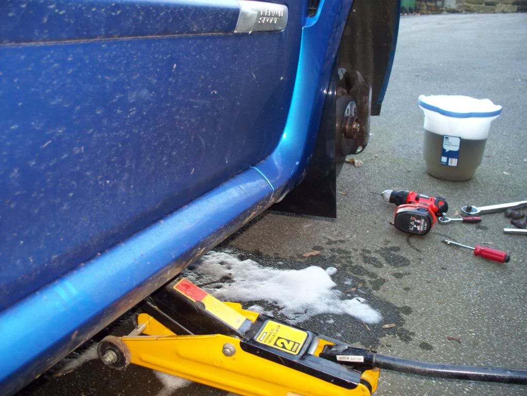

Given that the little car isn't going to be going anywhere between now and next Thursday, I decided to stick my Speedlines on in preparation for next weeks track evening, I am now pondering leaving the standard discs on for the time being and getting the bells on the AP's powder coated, but I'm not sure what colour to go for, and don't want to warp the standard discs as they will be going back on when I sell up.

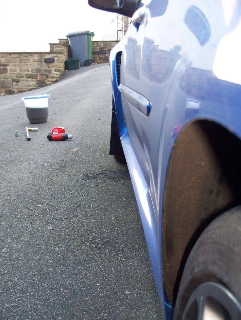

Topically given some of the recent posts, when my small child was helping me to fit the anthracite centres to the black Speedlines, she asked me "Daddy, why are these the wrong colour?" perhaps a question for Renault?

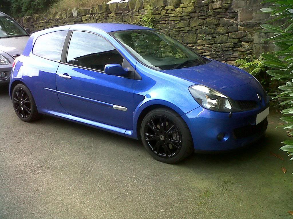

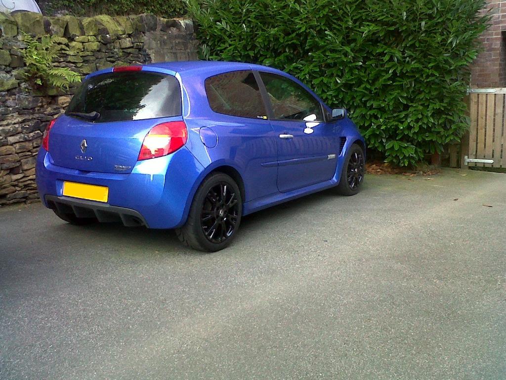

I have only driven a mile or so on the 888's, but they seems to transmit more surface vibration, which I guess is to be expected.

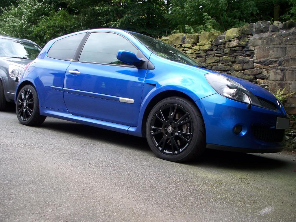

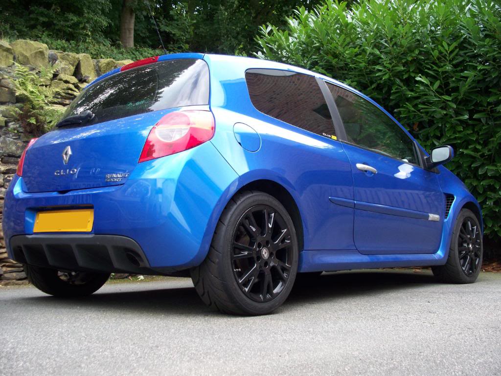

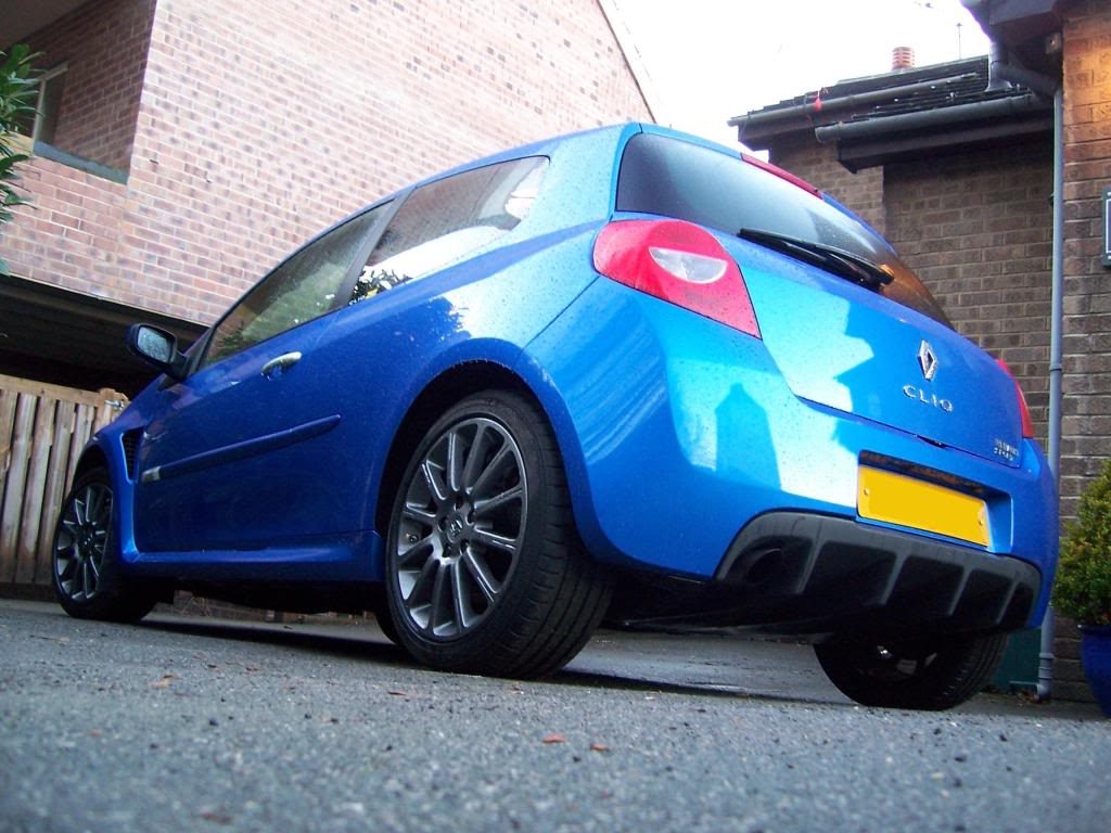

Need to give the car a wash, and when we have some daylight I will take some pics. It does look strangely good with the black Speedlines though, would look better with a 200 / gloss black 197 diffuser though.

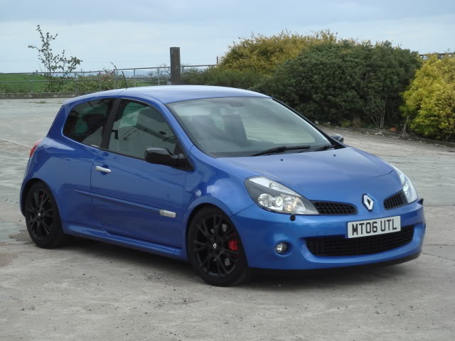

Excuse the dirty car, and poor quality pics, but I really like these wheels!
I wasn't a fan previously, but they look great!

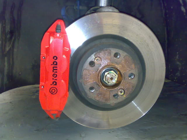

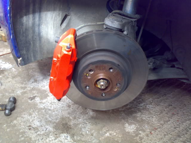

Added H&R Coilovers, and the speedlines. Painted the brembo's red, nice and o.e looking :)
Gaz_
  Extreme mode

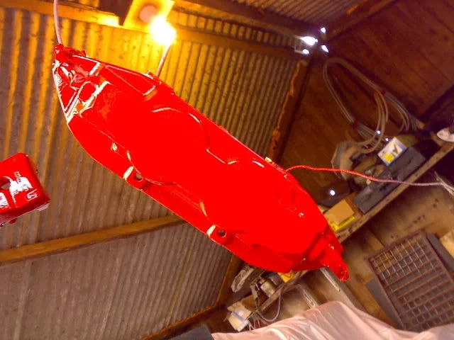

I took them off, and sprayed them, very good fnish. Dont brush them, will look w**k lol.
Would be better to powder coat, maybe source some off ebay to send off etc..........?
Gaz_
  Extreme mode

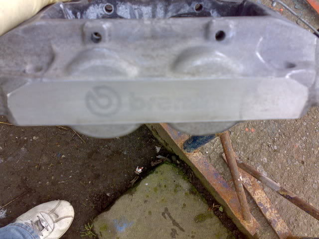

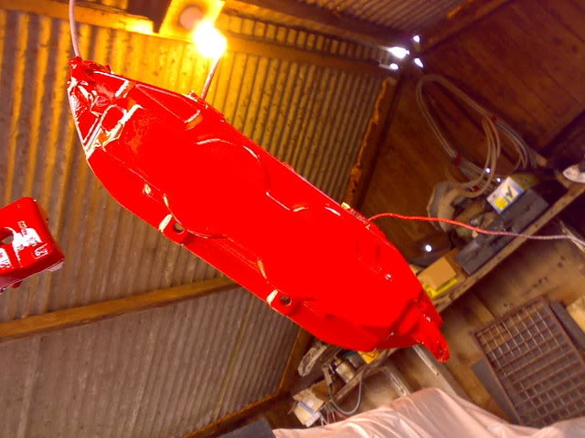

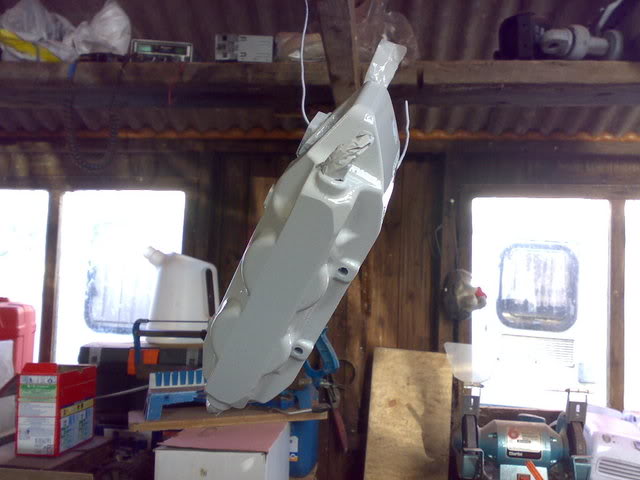

Well yeah got my mate to remove them, then sprayed them up over one weekend. Removed the calipers, primered up etc. :)
Gaz_
  Extreme mode
Pistons stayed in, masked up the seals etc. Removed the nipples and fitted some 'blanks' steve from Brichdown made, so not to contaminate the chambers. Also left the link pipe on as they are red from Renault :)
Then we refitted/bled etc, left the a fortnight to cure whilst using the car, then reapplied the decals
Primered,
About 50 coats of smooth red
Refitted,
Finished
Did the rears also to match. With painting they can chip is knocked by a wheel, i just touched up to suit. Powdercoating is much more durable

Added some pics for you, i actually masked up the link pipe on mine by the looks of things!
Gaz_
  Extreme mode
No problem!
I just used hammerite primer, then smooth red....... i takes alot of coats of the red to get a uniform finish though, so be patient! I didnt laquar, and the finish did dull after time, but was brought back with some SRP. Adding a clear coat would help that though imo

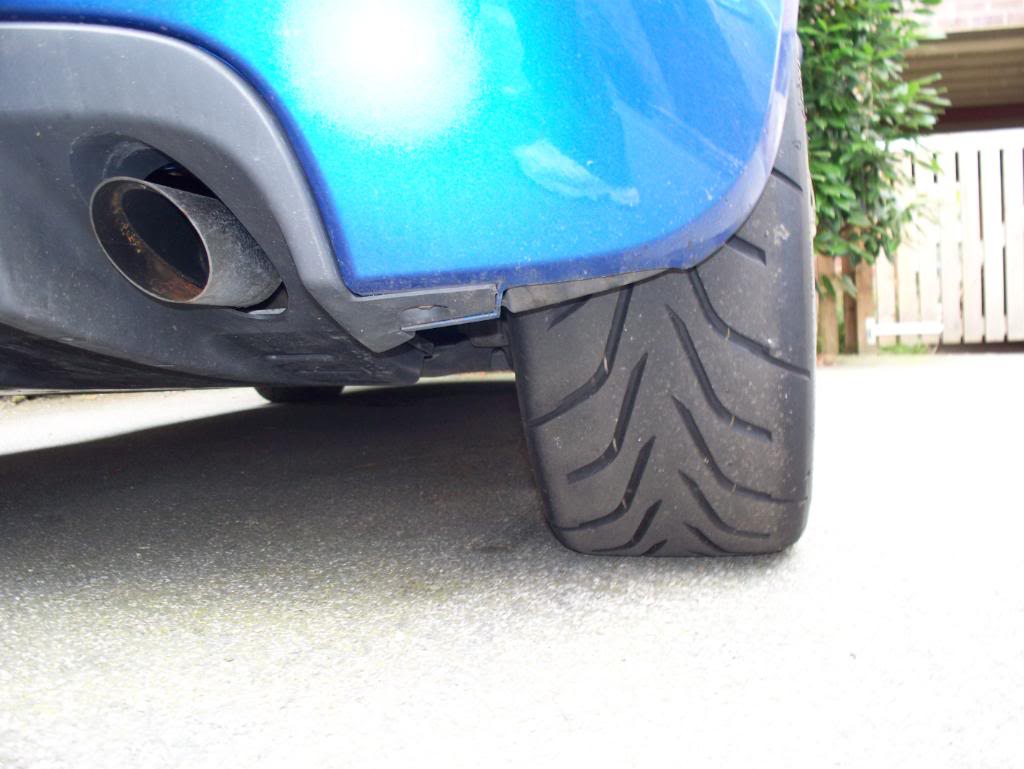

R888's for track use only, too expensive for day-to-day use, no good in standing water, can't have punctures repaired, and too noisy around town. Sticking with Conti's in Raiders for day-to-day.

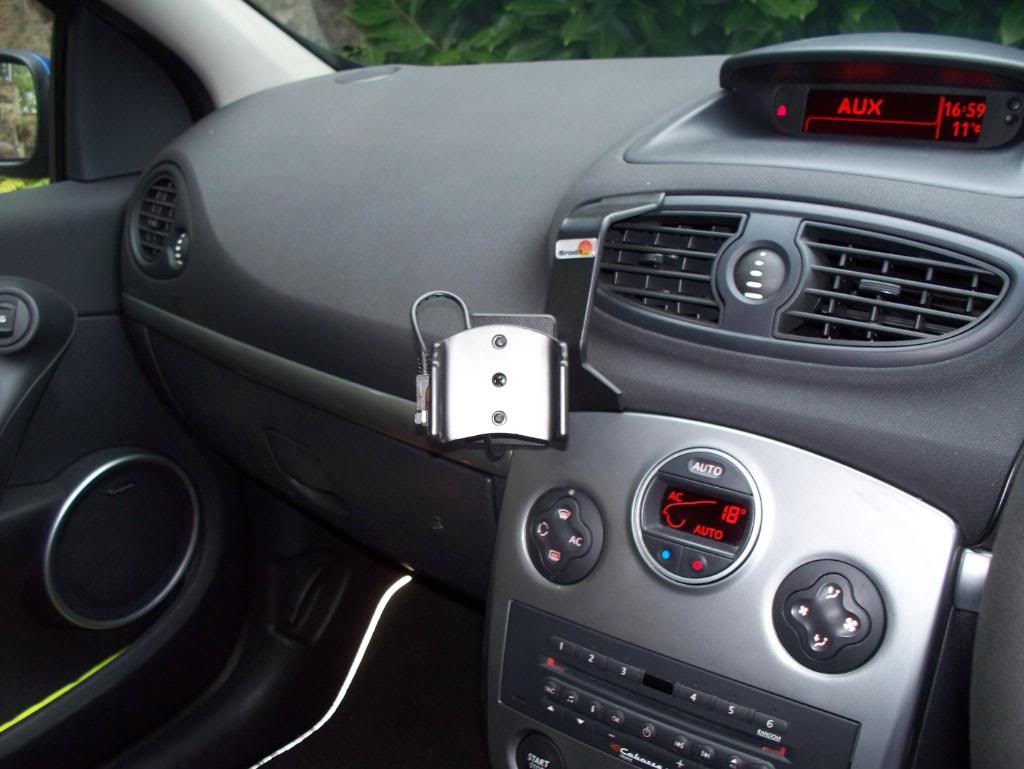

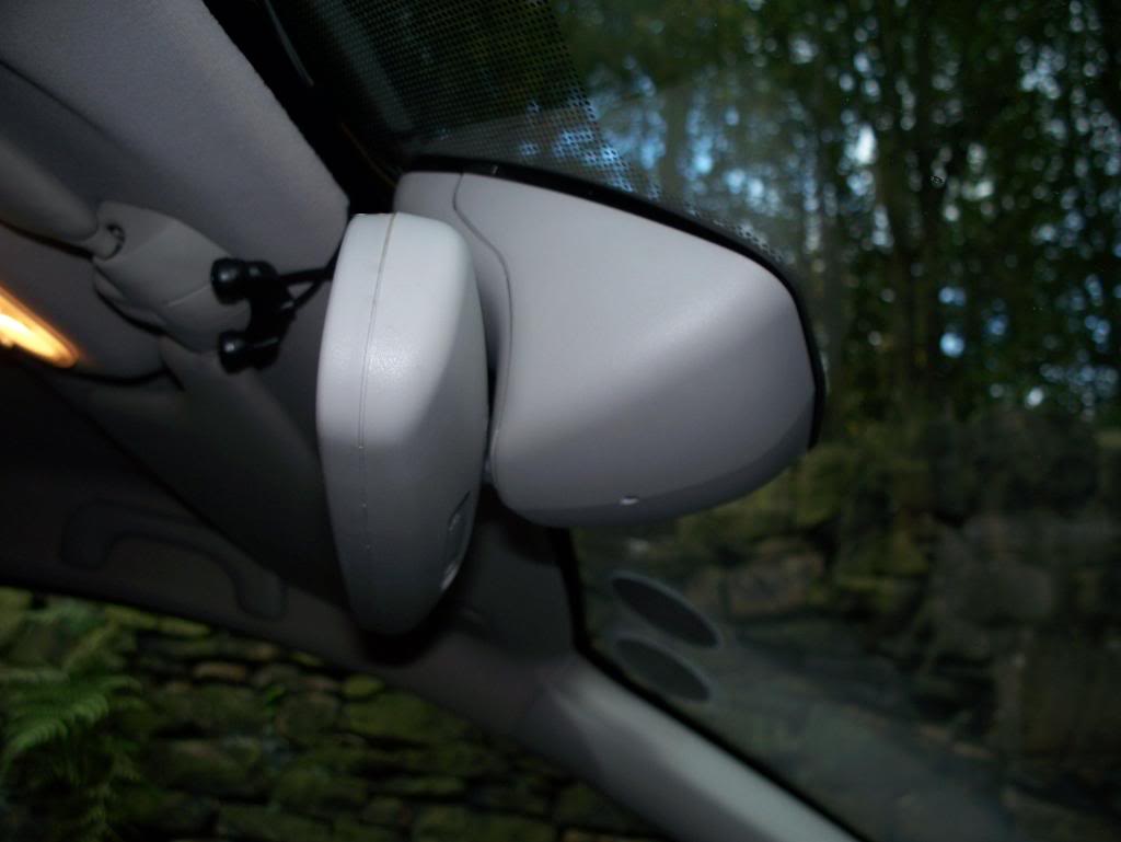

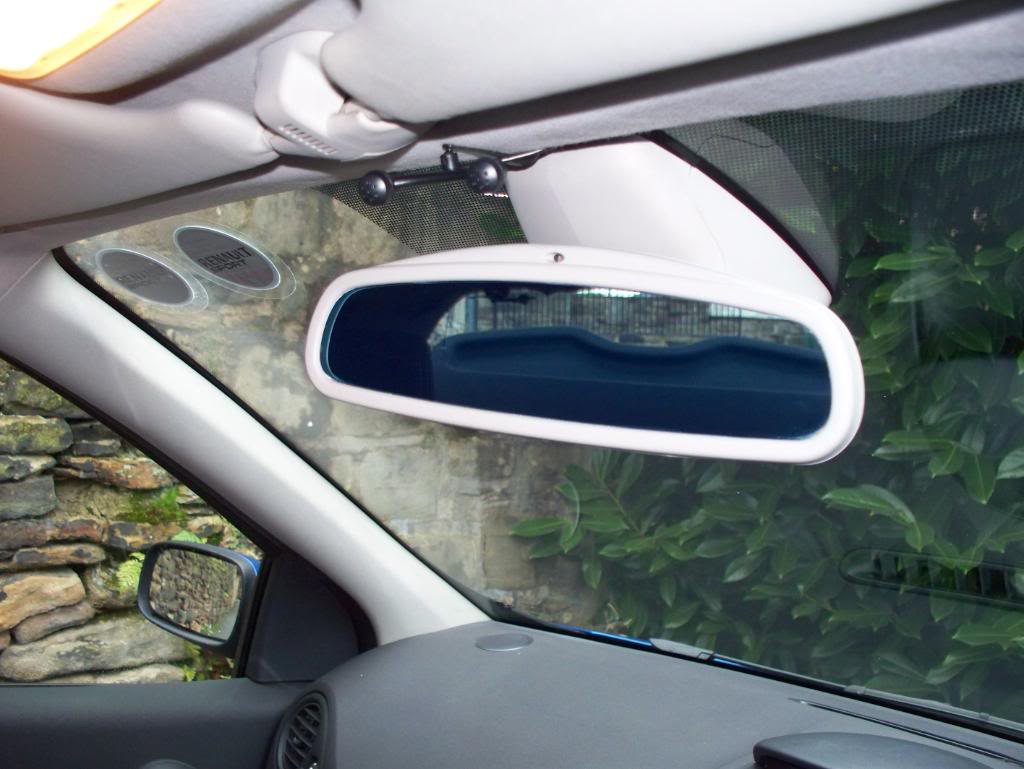

So nothing especially exciting to report, but I have just fitted an auto-dim mirror from a Laguna 2, which was pretty straightforward, also took the opportunity to hard wire the TPMS display, phone cradle, and prepared for a nav unit.
Couple of pics from my recce to Buttertubs on my way back from Glasgow yesterday;

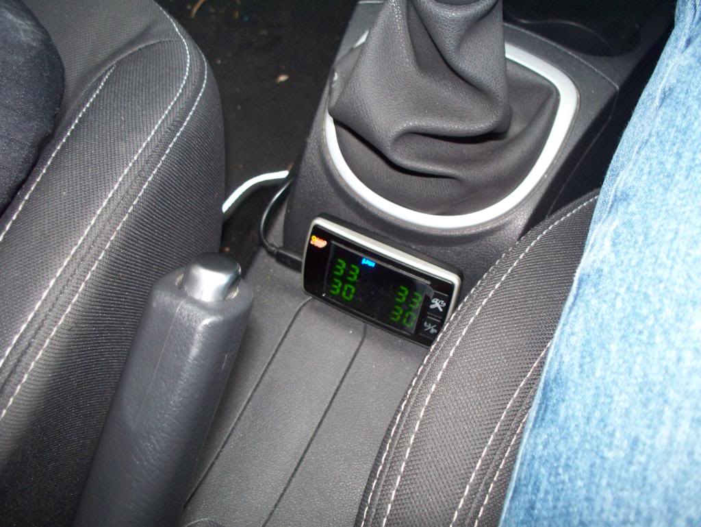

TPMS now hard wired;
Phone cradle with the wiring now tucked away;
And a couple of the auto-dim mirror;
The car is absolutely filthy at the moment, it hasn't been washed for ages (work on house, holiday, week away on a job, etc.), so please don't judge from the pics!
Also as I knew I would be ferrying two colleagues around this week, I removed the boot tray thing, which really helped the versatility of the boot, especially with the full sized spare, so I don't think that will be going back in, for now at least.
Also I rewired the car kit, using the ISO plugs tucked away behind the head unit, rather than running the whole lot under the drivers seat, and back. The only additional wires that now go to the tuner part are the mute wire, and the four line-in wires, which makes it much neater.

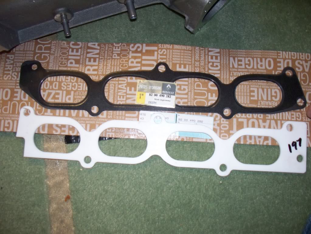

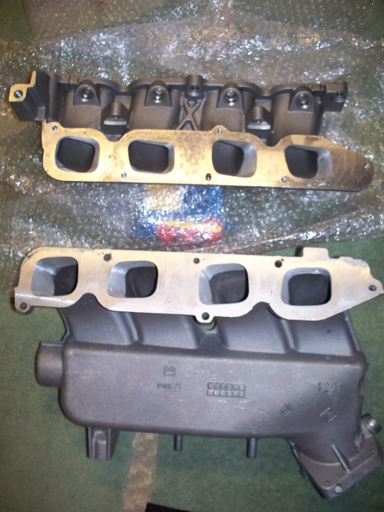

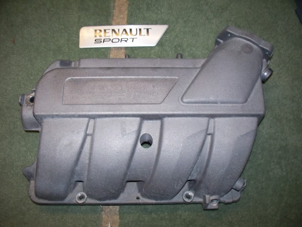

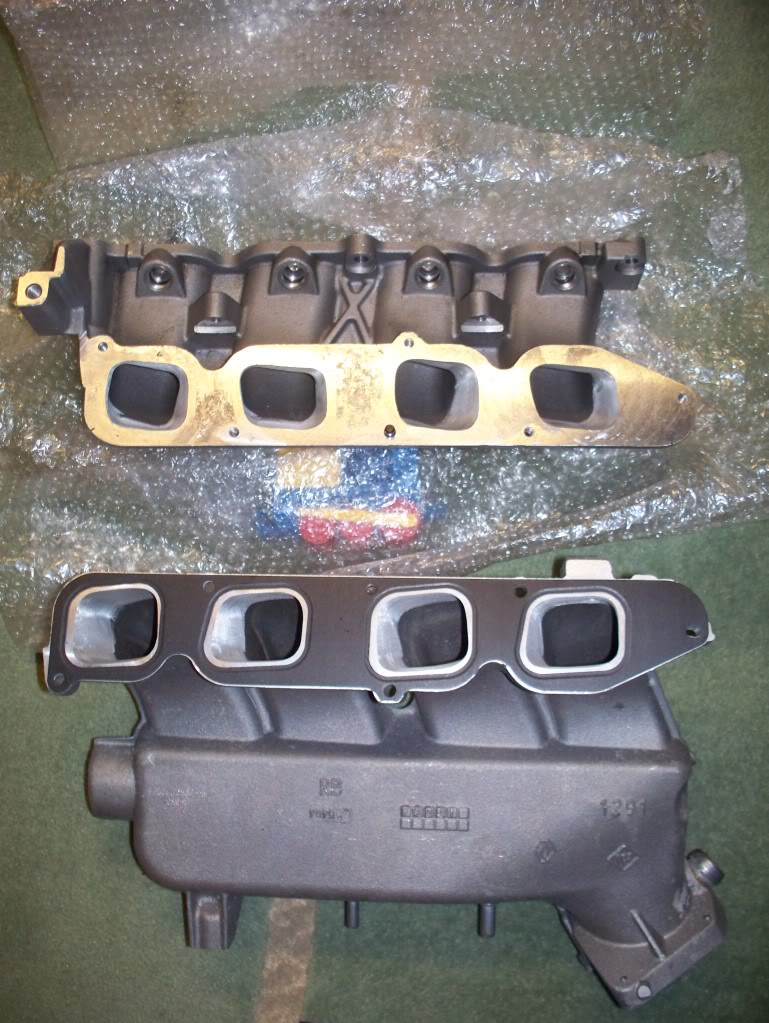

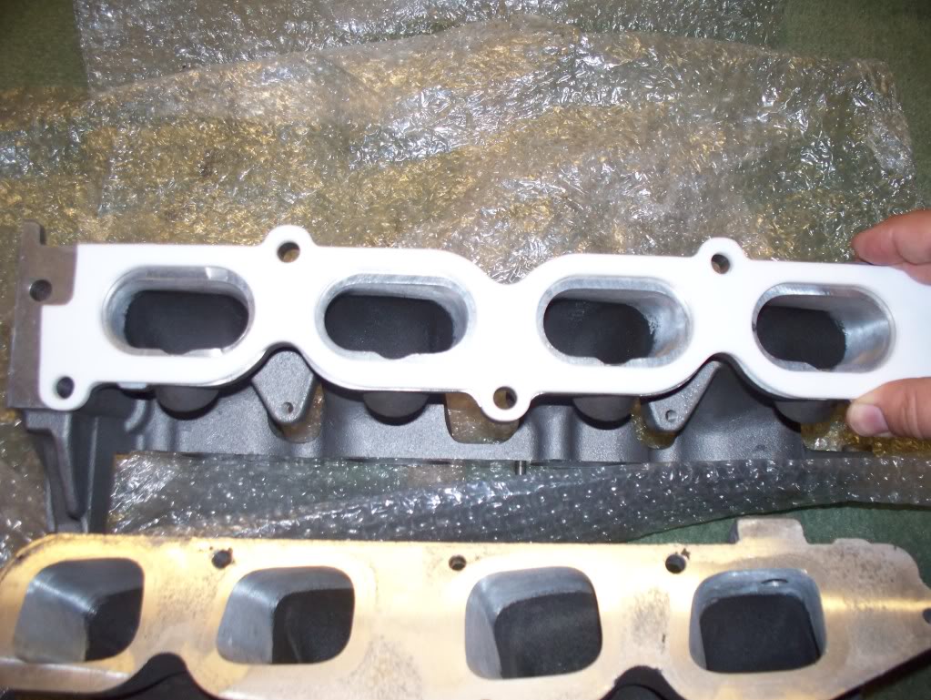

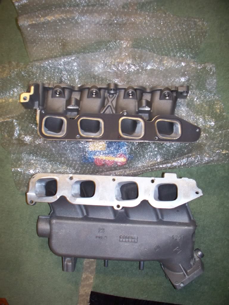

I have a second inlet manifold which was port matched by APD a couple of months ago. Unfortunately when I received it back the vac nipple by the TB was badly bent and cracked, and snapped off when I tried to straighten it, I sent it back to Craig and am hoping to get it back this week.
On the subject of the manifold, I am planning on getting it powder coated, and am open to suggestions, I am currently torn between anthracite, bright red, or a bright / candy blue? While I obviously want it to look good under the bonnet (with blue silicon hoses), I don't want to limit it's appeal when I put the car back to standard and come to sell it (the inlet). Also I am not planning on getting the lower inlet coated as you can barely see it, does this sound sensible, or cheap?
Finally, in preparation for all of this, I set to removing the "Renault Sport" badge today, as follows;
Fan assisted oven @ 200C for 10min, then carefully remove using a wallpaper scraper. Once cooled, removed adhesive by rubbing, using brake cleaner to soften.
It has come off very well, and should be fine to refit once the manifold is powder coated.
Pics;
inlet with badge removed
upper and lower
gasket on lower
gasket on upper
PTFE Vs OE gasket
PTFE Vs. inlet to head mating face
Of course these pics would mean more when compared with an unmodified mani, but those pics will have to wait.
The PTFE gaskets seem to have mixed reviews, but I have to replace it anyway, so it isn't any extra work.

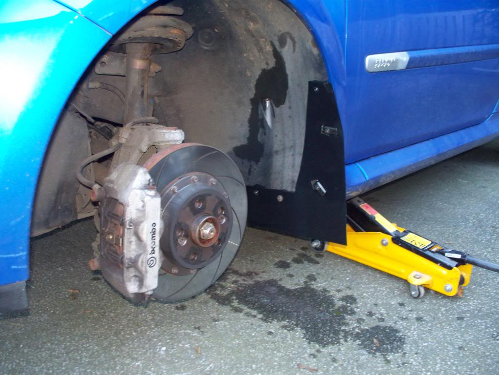

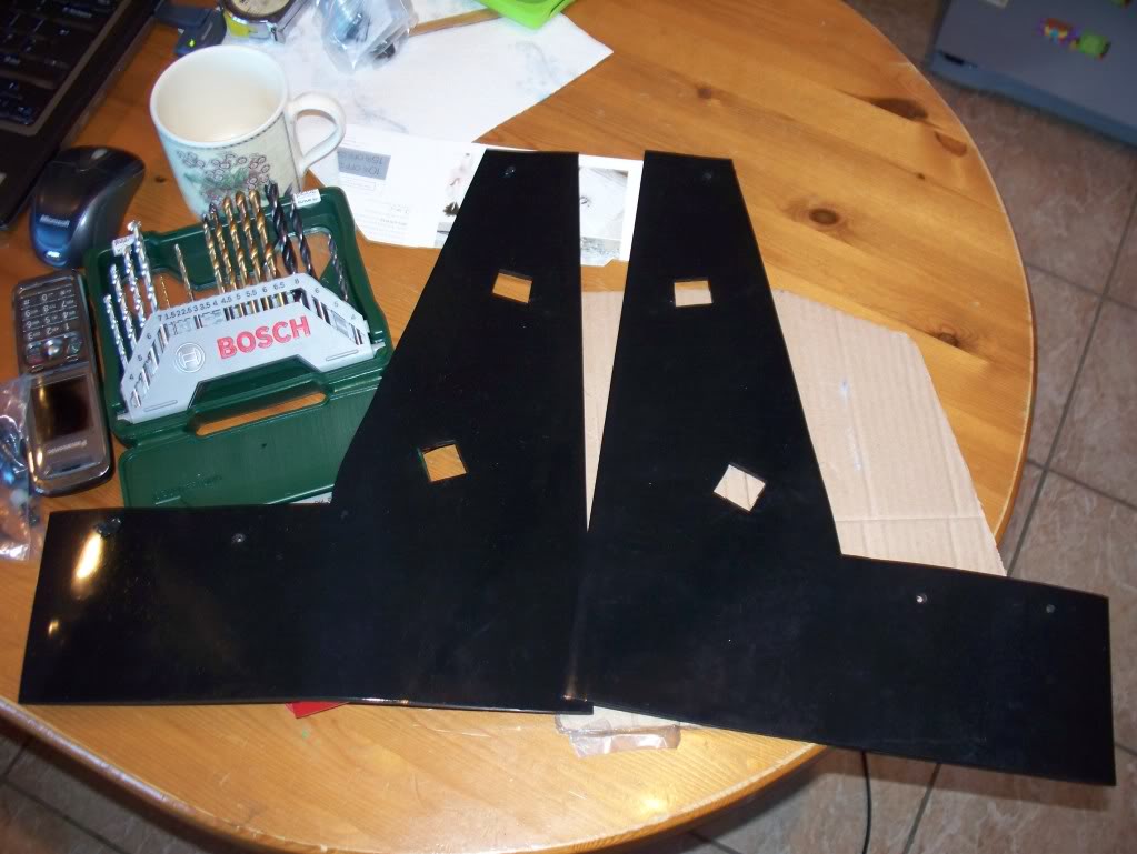

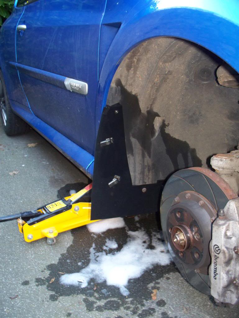

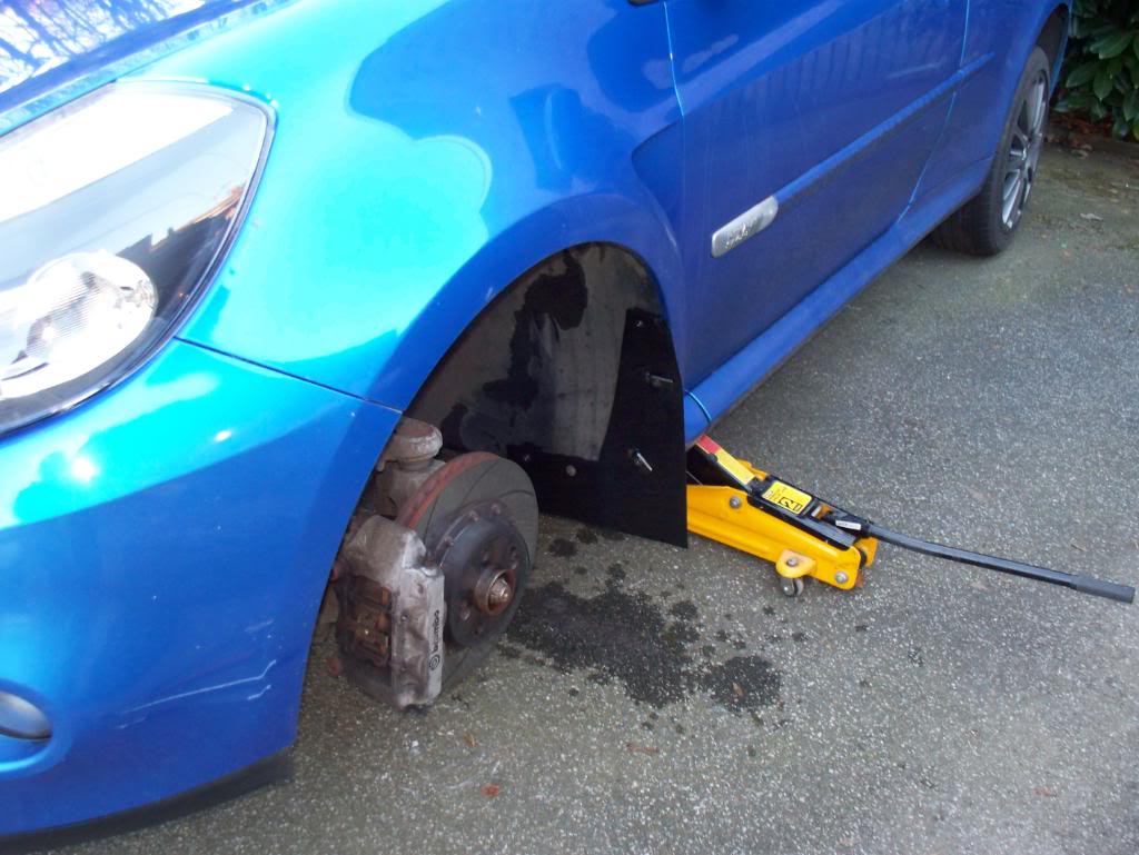

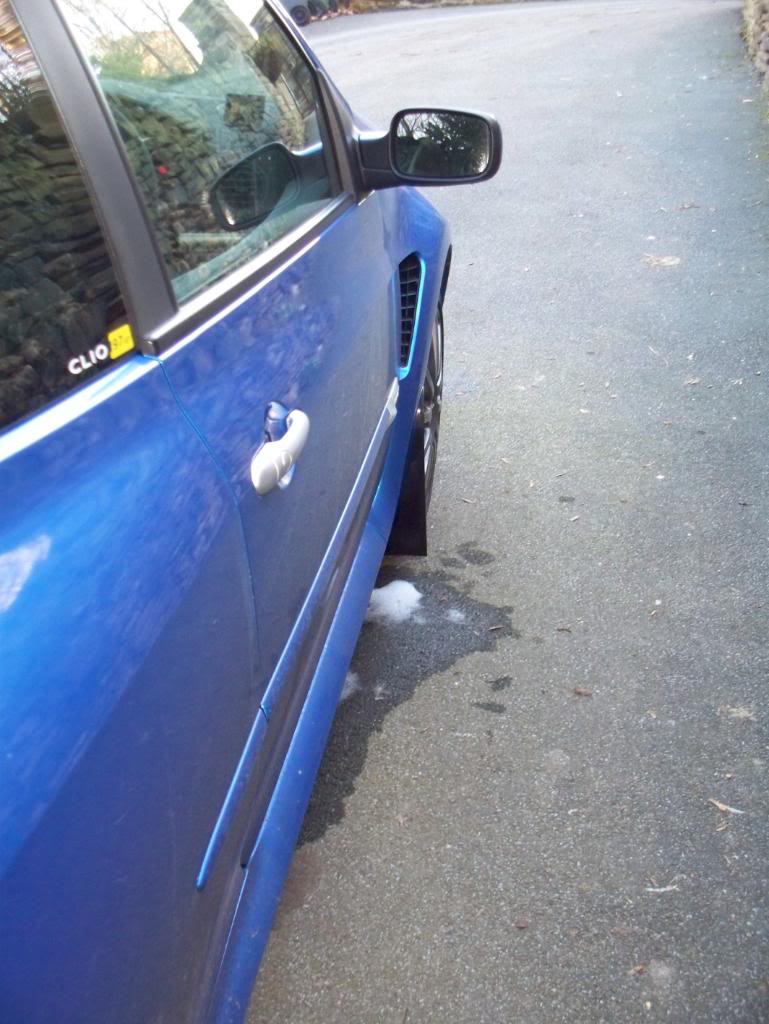

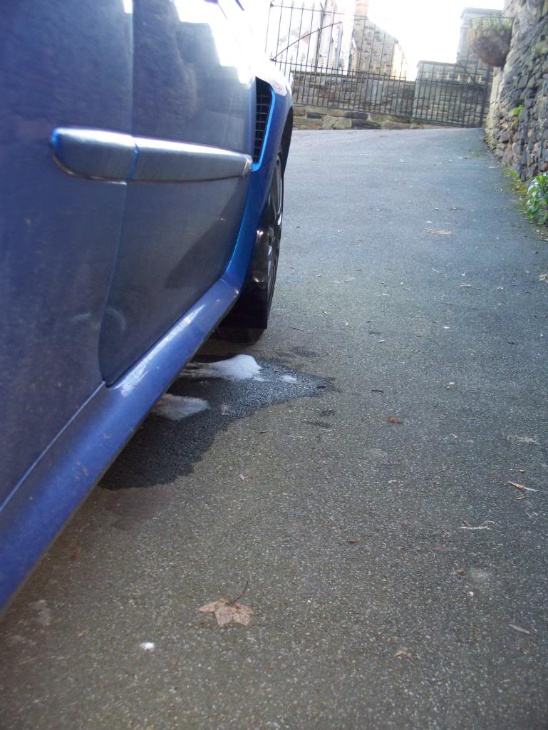

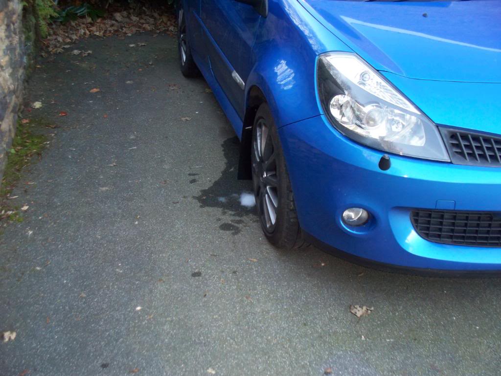

Couple of weeks ago I made some rally style mudflaps for the front of the car, started off with some 4mm black rally flap material, made a template using cardboard, and fited into place using two self-tappers, the original screw for the liner, and two Ford mudflap clamps that I had knocking around.
If I am critical, I haven't quite got the angle right, the bottom corner sticks out a touch too far, but at this time of year that is no great problem, I will probably give them a tweek at some point. Good news is that both came out of a single piece of rally flap material, so I have some left to have a crack at the rears.

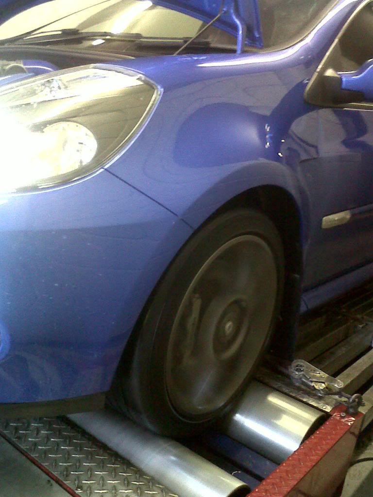

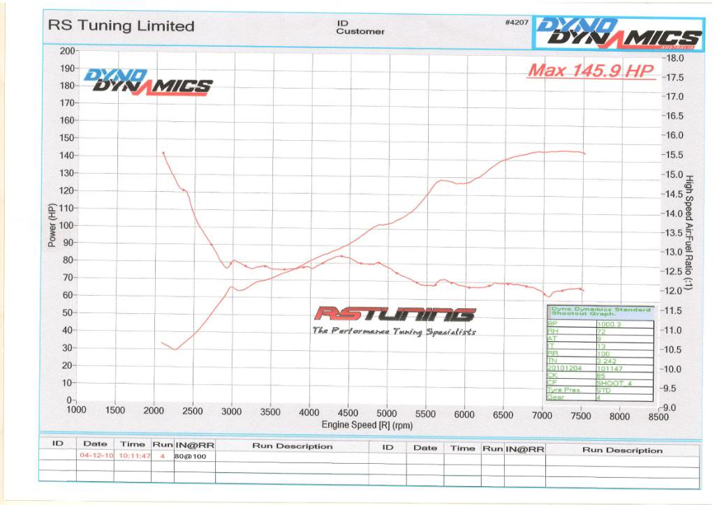

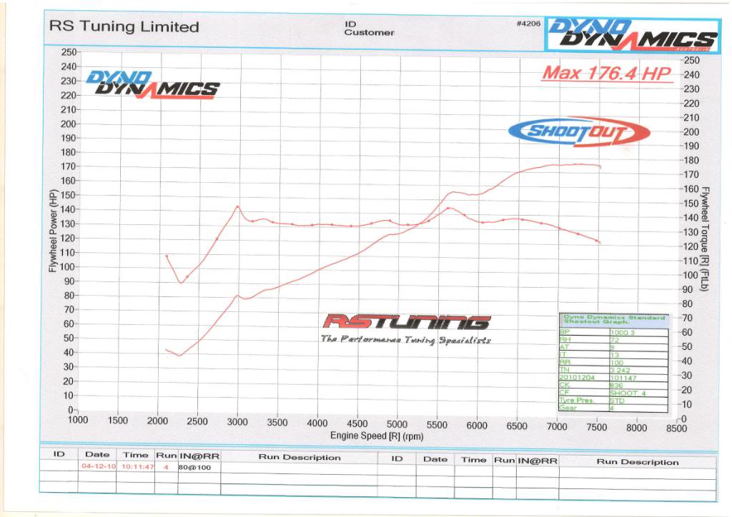

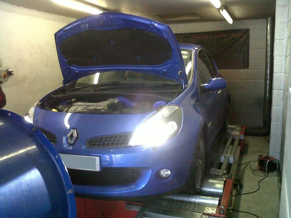

The latest news (from today) is that the little car got its first drive for about a week today, took it to the RR day at RS Tuning. The results were probably about what I expected @ 176.4BHP, I would have liked 180+, but can't really complain, the curve was relatively smooth, and the car is quick enough to drive, so at the end of the day it is just a number.
I saw 2 200's get tried, one made 181, the other 191 (interestingly with it's airbox lid removed?), so my 176 isn't too bad. I plan on taking it back when I have had the APD inlets fitted, to see if they make any difference. I think a couple more 197's rolled in just as I was leaving, so it would be interesting to know what they made.
I will get the graphs scanned on Monday, but in the meantime here are a couple of (rather poor Blackberry) pics of the car on the rollers;

Thanks, and I know what you mean about the mudflaps, but they serve a purpose at this time of year, I would prefer something more OE, but there isn't anything available really.

So yours is 10% down, and mine is 11% down...
It was only 5 BHP down on another 197 and 8 BHP down on one of the two 200's, plus there is nothing apparently wrong with it from the curve. I am going to get the oil changed, along with the sparks, fit the new inlet and run it on 99RON, and see if I get a better result.
  Clio 197
Drives really well, I really like this car. If anyone has any ideas as to why it is down though, I would love to hear them!

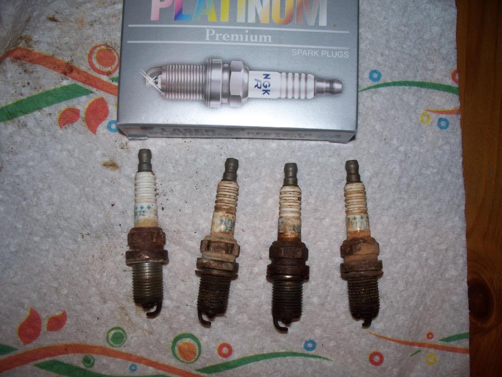

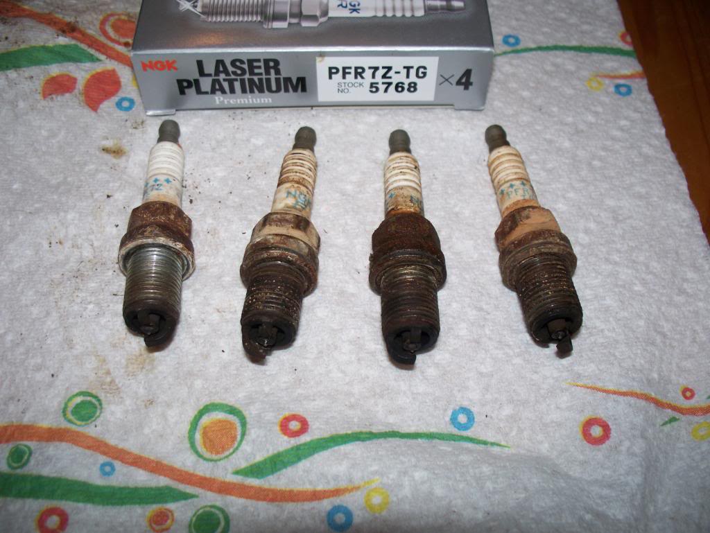

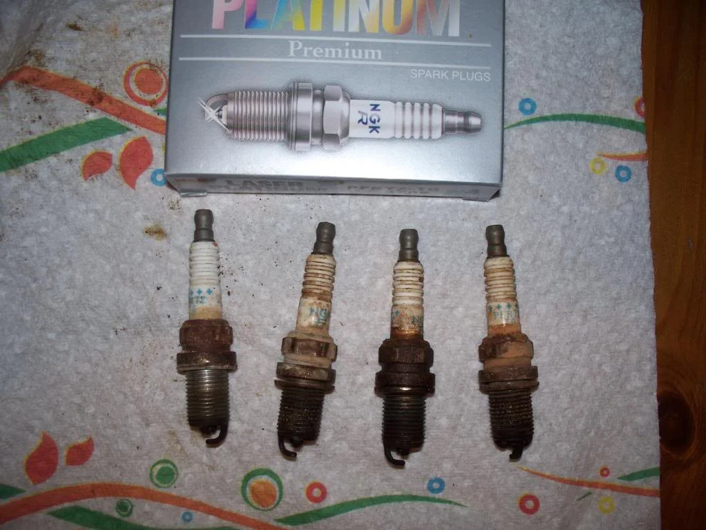

Changed my spark plugs, great service from Opie Oils for the new ones, think they cost just over £37.
The car had a 72k service in May, around 6,500 miles ago, shortly before I got it, which apparently included plugs, however these bad boys look older than that...
To be fair it was driving ok with the old plugs, but they may have contributed to it being a bit under power on the RR.

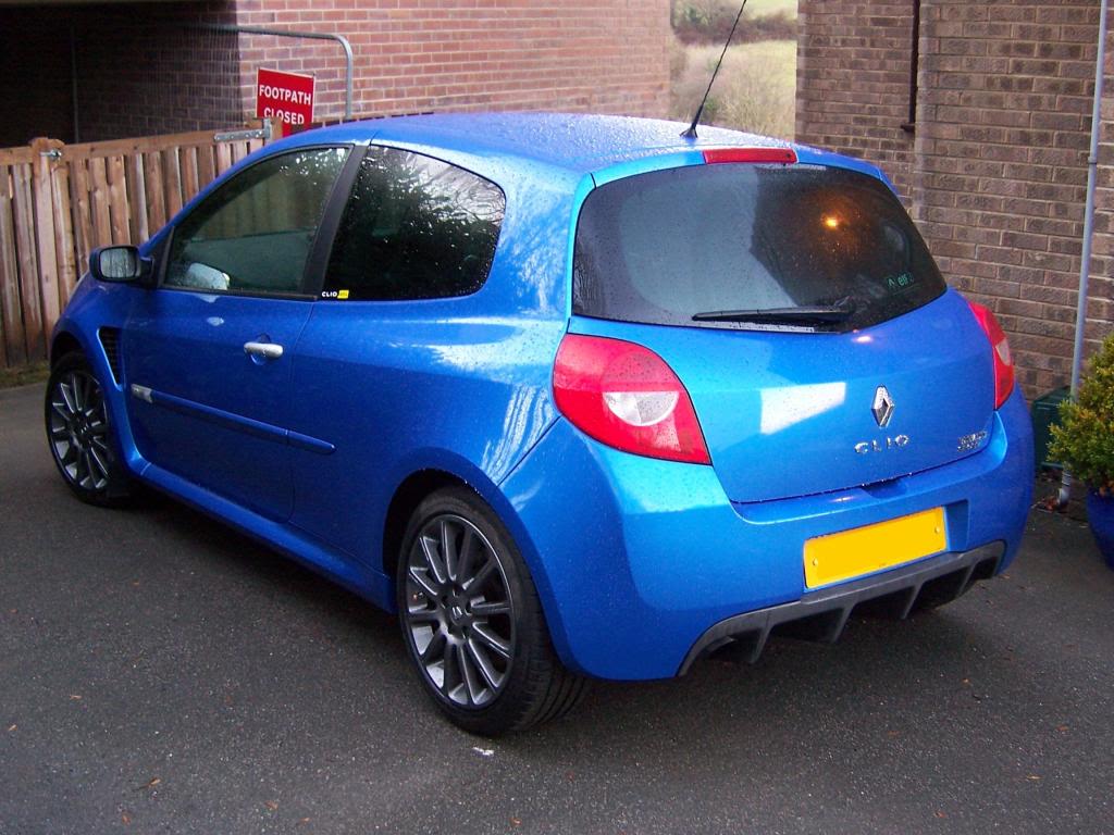

The car got a wash late last week, and hasn't really been driven since, so was still presentable enough for a couple of pics, nothing particularly new, aside from the inlet manifold and new ignition coils, neither of which are especially photogenic, I have finally got around to fitting Jase's s/s inlet pipe and the silicone hose to join it up.
