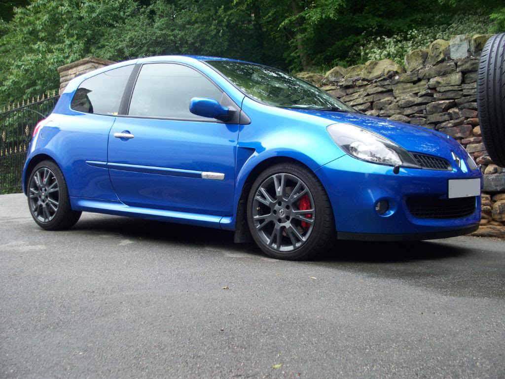

06 Albi Blue 197
Chris205
  Many Things
Just read the full project so far, seems like you're into the attention to detail things, I take my hat off to you and glad you're enjoying the 197. I take it you arent looking to move on as you've had it for over 3 months :)
I'd be too tempted to have the speedlines as the daily wheels as it looks so good.
Do you have any plans for suspension mods?
  Clio 197
Cheers! Had the car for around 7m now, still very fond of it.
I do really like the Speedlines, if some come up I might get a second set for daily use, but we will see, actually thinking about going back to silver Raiders.
RE: suspension, all I might do is replace with either new standard, or new Cup spec, possibly with Eibachs - don't really want to lower the car though as I have a couple of awkward surfaces to deal with on a regular basis, and occasionally kiss the ground with the rubber lip spoiler as it is, plus on my Eibach lowered Puma the cat used to catch on speed bumps, etc., I am quite enjoying not having to worry about that!

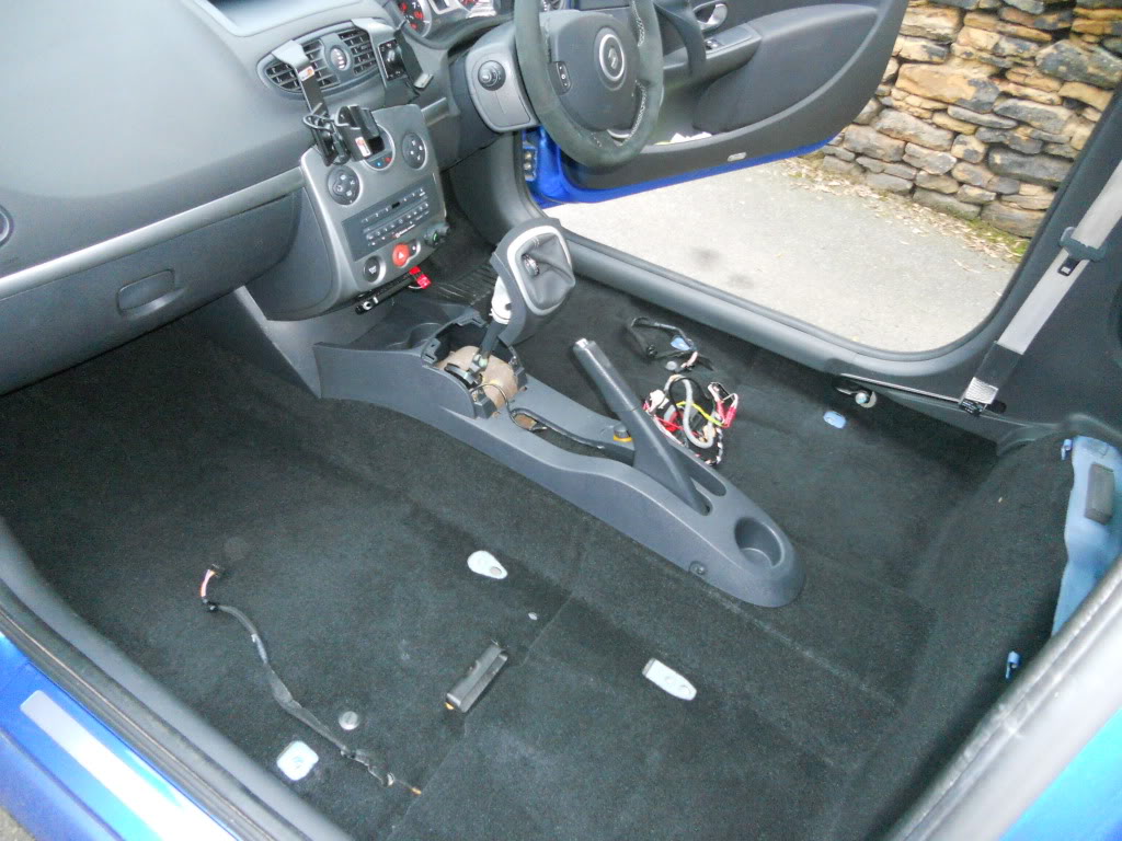

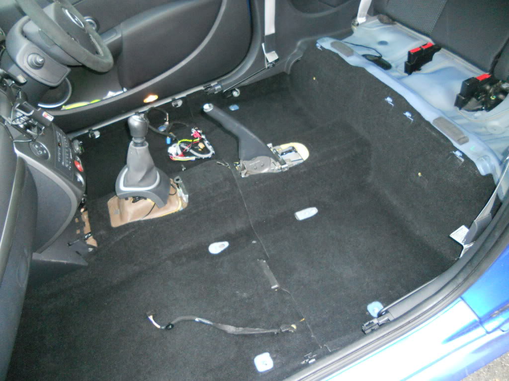

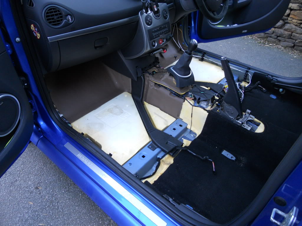

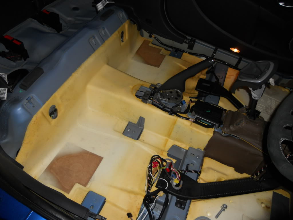

Not updated this for a little while, nothing major has changed, but I have replaced the carpet due to a split behind the heel pad;
Front carpet out;
Rear carpet out;
New carpet in;
Trim refitted;

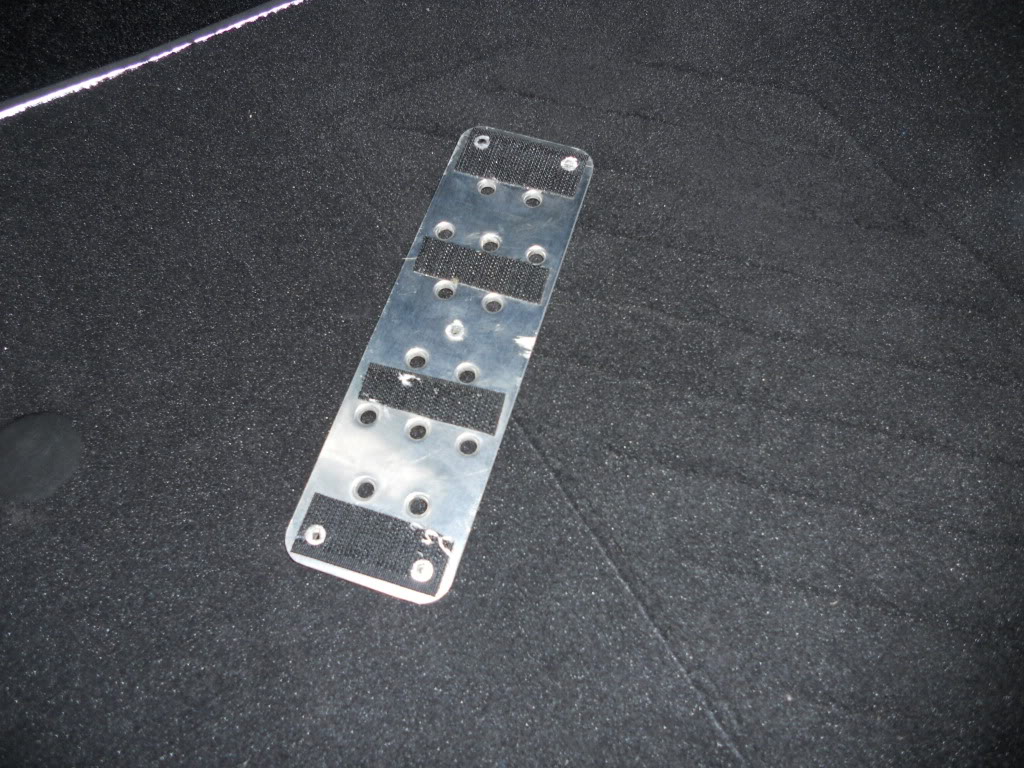

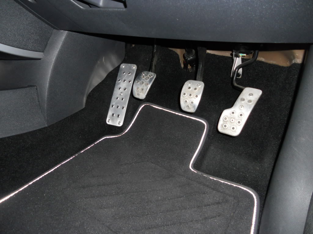

Couple of quick pics of how my footrest is fitted;
and yes, I know I need to get some metal polish on my grubby pedals, all in good time!

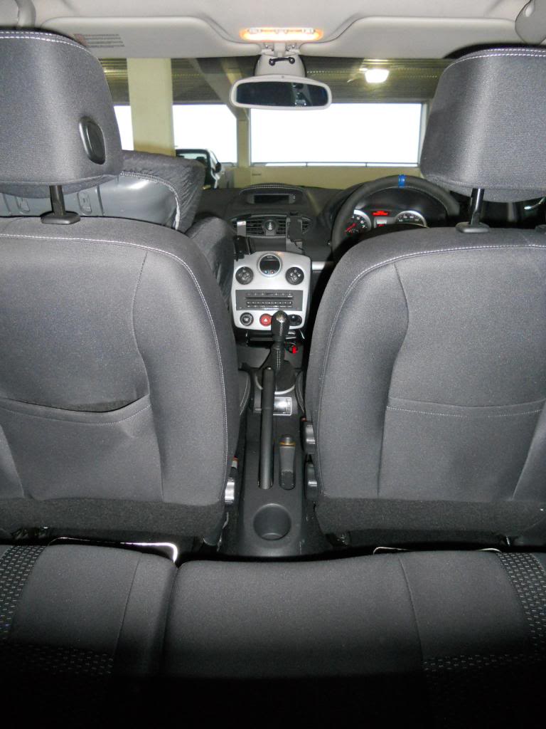

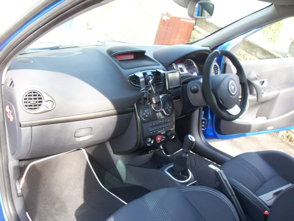

And some more minor interior changes, forgive the filth, it needs vac'ing out.

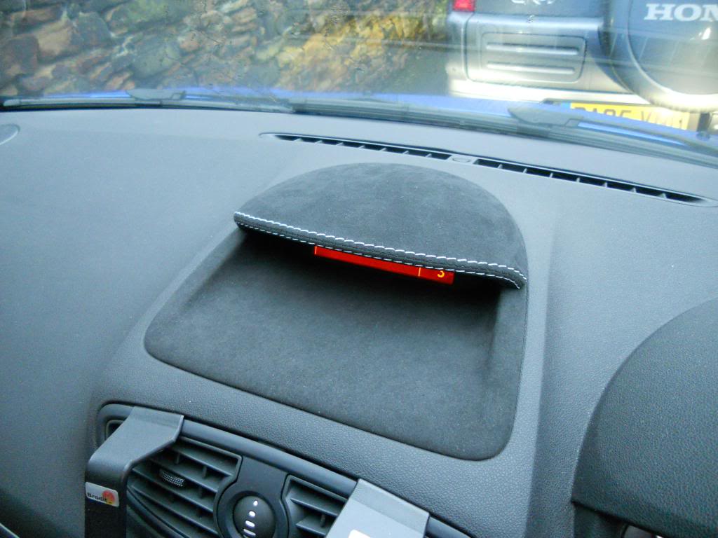

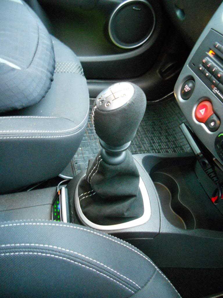

I finally decided that I needed a steering wheel trim, and do rather like it, the angle makes the wheel look more dished I think.
Also, major credit to Steve @ Edge Automotive for my alcantara stereo/clock display, gear knob and gaitor, which are really nice, top work Steve!
I also had the seam moved around on the gear lever gaitor to make it better follow into the seam on the gear knob.

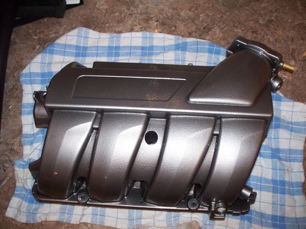

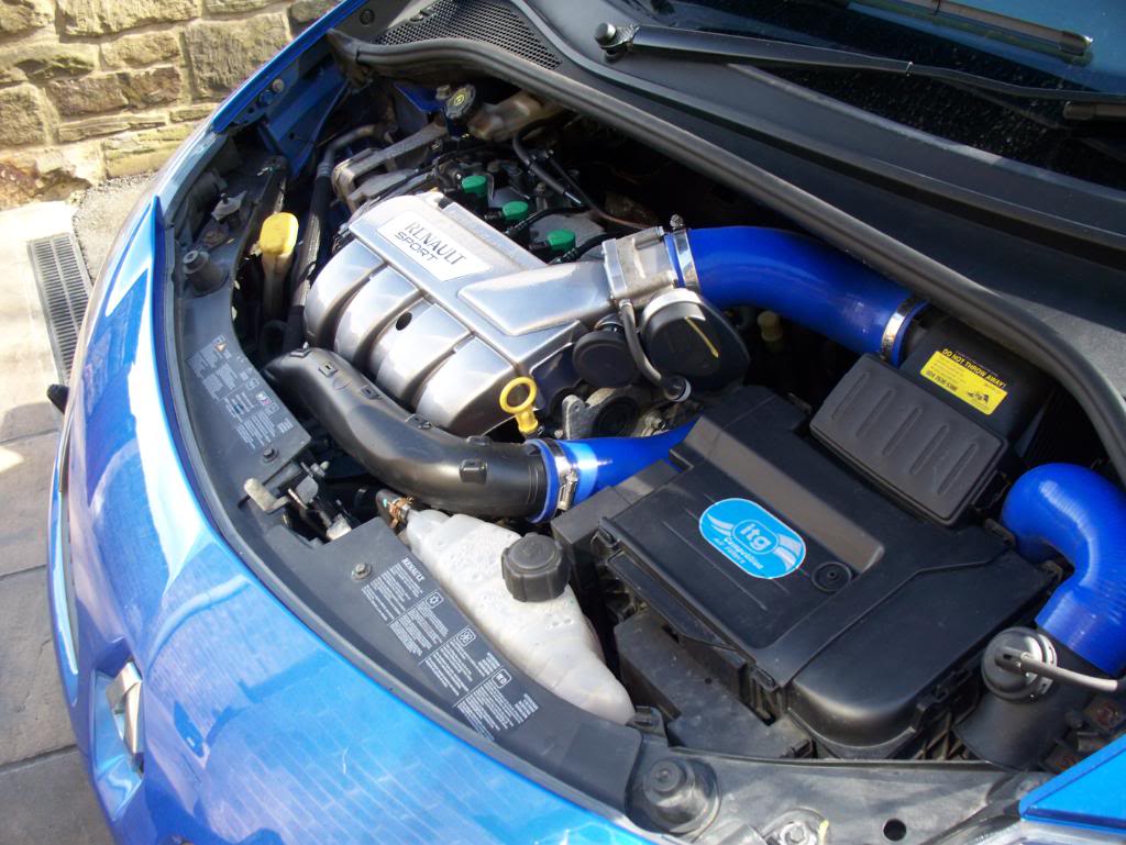

Unfortunately the little car gained a small war wound on the rear bumper a week or so ago, nothing major but the bumper is damaged. This prompted me to take the car to the garage to get the rear discs and pads changed, along with red calipers, cup springs and dampers, and track rods. Also gave me an opportunity to remove the dash strips to get them painted, and upper inlet manifold to get that powder coated. Once the mechanical stuff has been done it will be going to get the new rear bumper painted and the front bumper tarted up at the same time to remove stone chips, etc.

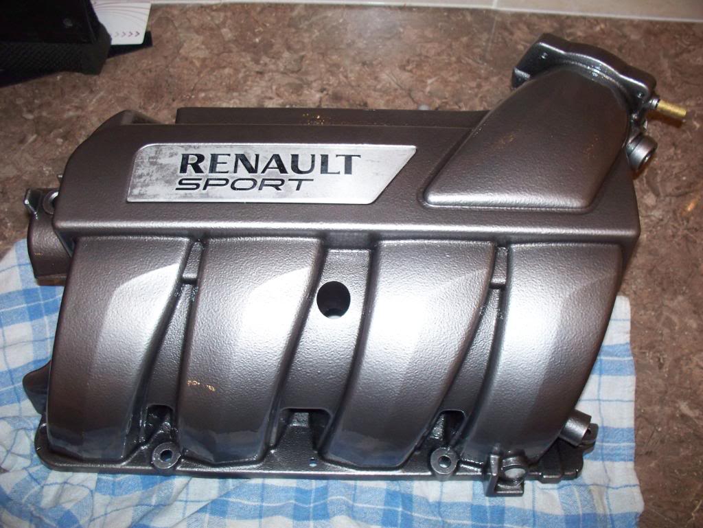

Inlet mani;

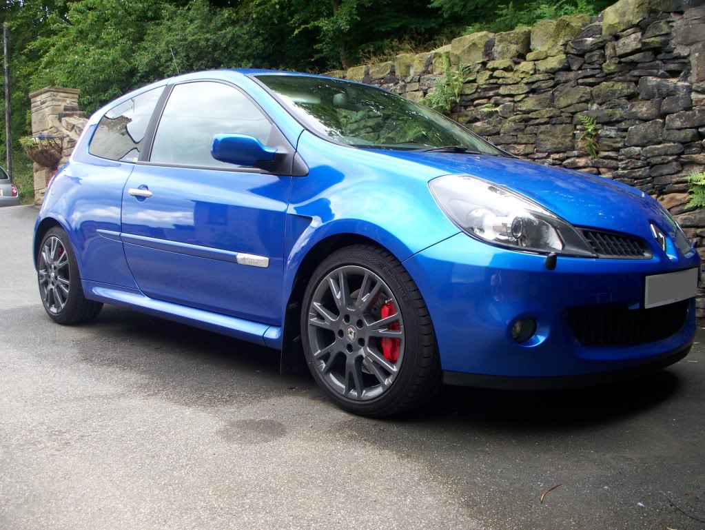

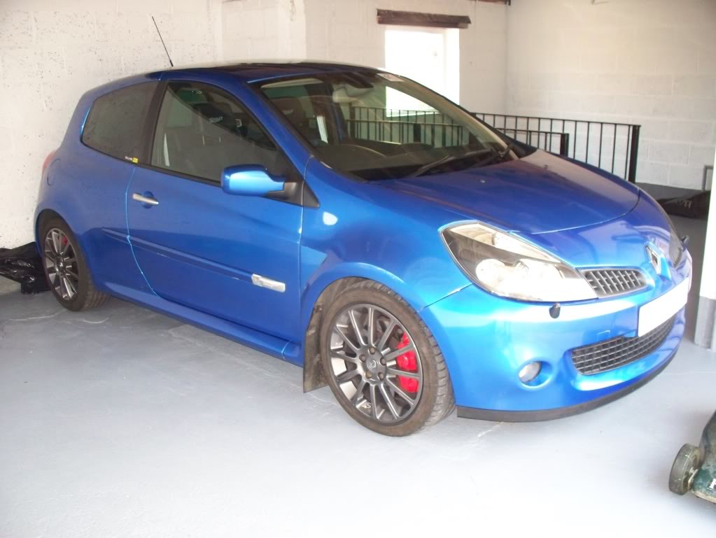

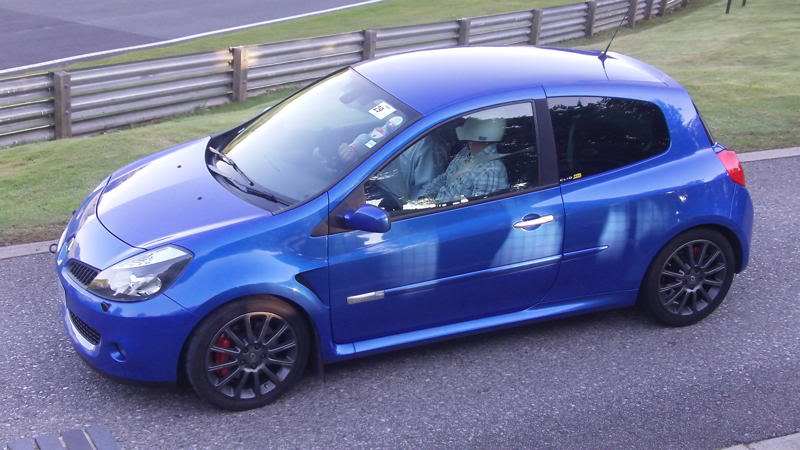

I was so happy to have this back, really missed it. Plus I think the red calipers, anthracite wheels and albi blue paint look great against each other.

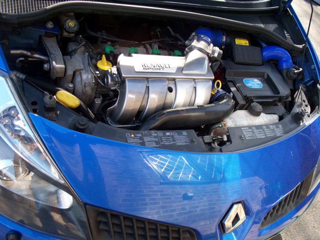

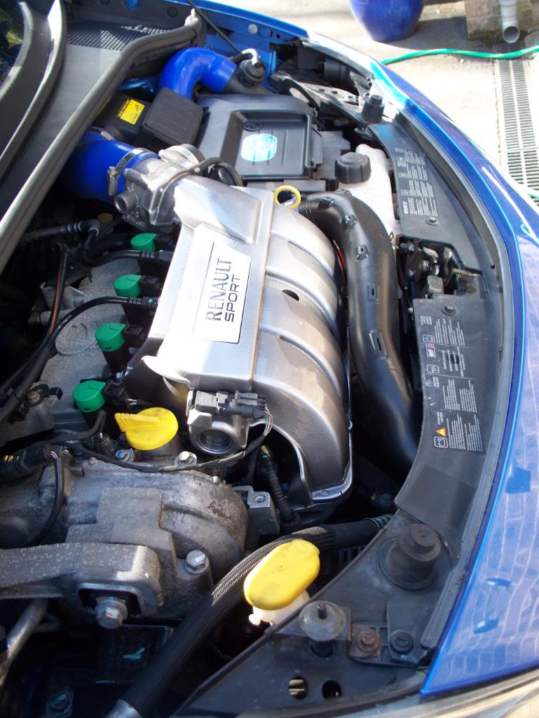

Gave the interior and engine bay a spruce up;
Firstly not the interior, but the engine bay, not particularly clean but at least presentable, and inlet manifold powder coated;

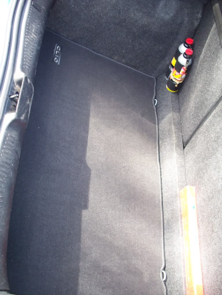

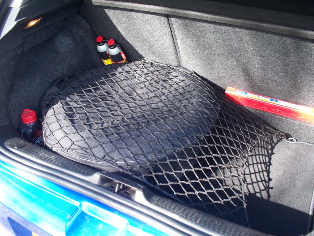

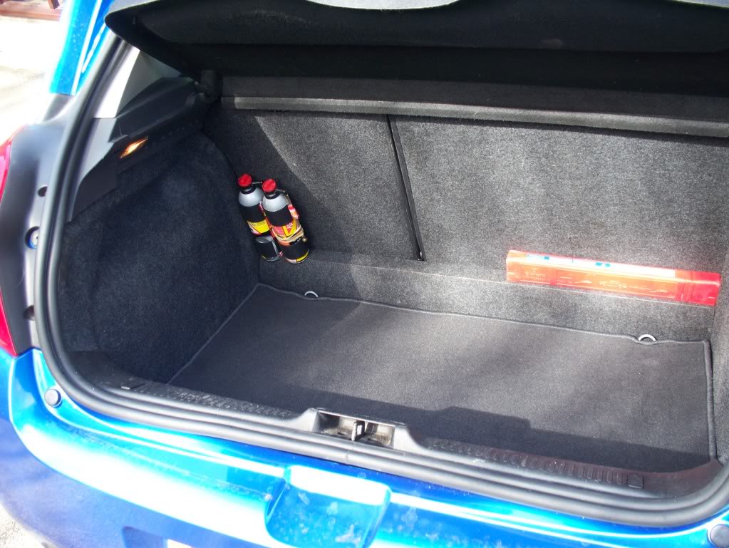

Switching to the opposite end of the car, we have the boot, with Clio plush mat;
And with full size spare;

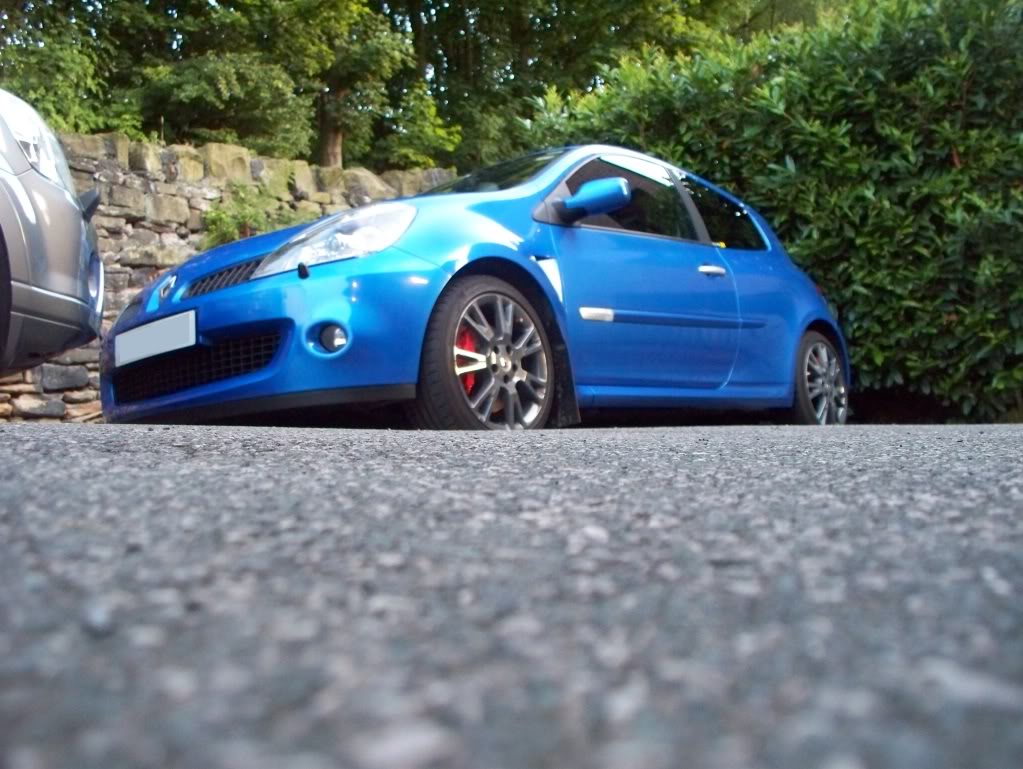

Couple of exterior pics, not great but the car looks quite good;

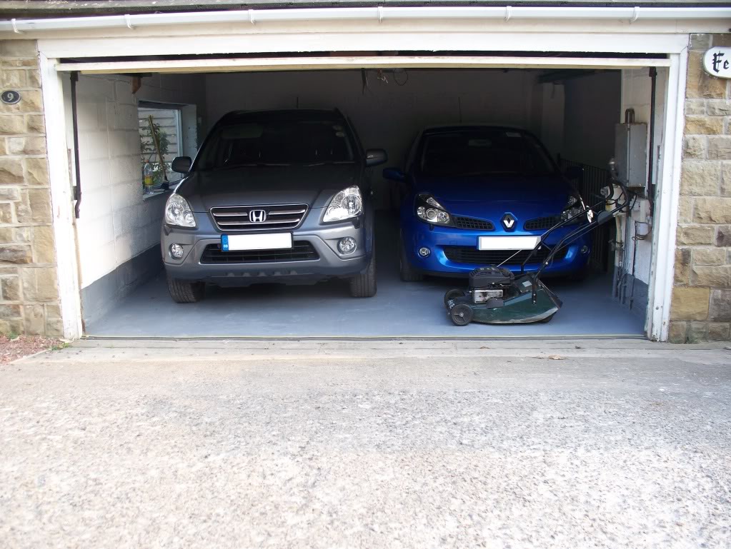

We don't usually wedge both in like that, this was just to see if we could actually fit two cars in the "double" garage.
Couple more pics, playing with the settings with my bog standard Kodak, rear arch looks very flared in this one

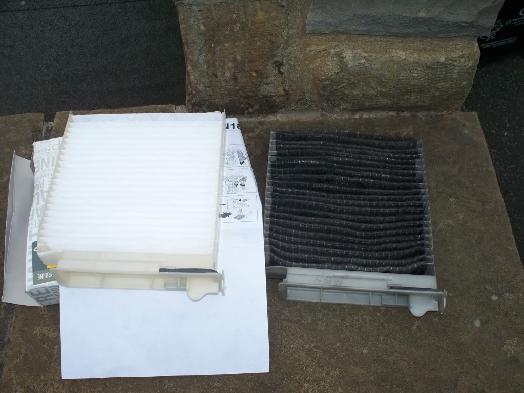

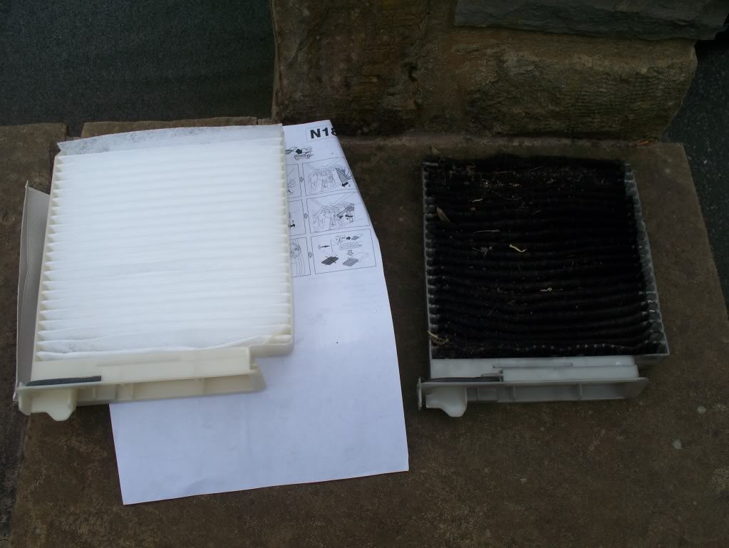

Following on from the issues with the climate control, and given that it had been almost 12m since the car was last serviced, I decided to change the cabin filter. I have had one knocking around for a while so it was just a case of getting around to it.
I read the guides, though they didn't really illustrate quite the extent to which you have to fold yourself up to get into the footwell and get the bloody thing out, or how awkward it is to get the new one in. Not difficult, just fiddly.
Some pics;
Looks like it was due for a change!
Interestingly though both were genuine Renault, the construction was quite different. I am assured this is just due to parts being superseded, and in any case the clean filter must be better than the filthy old thing.

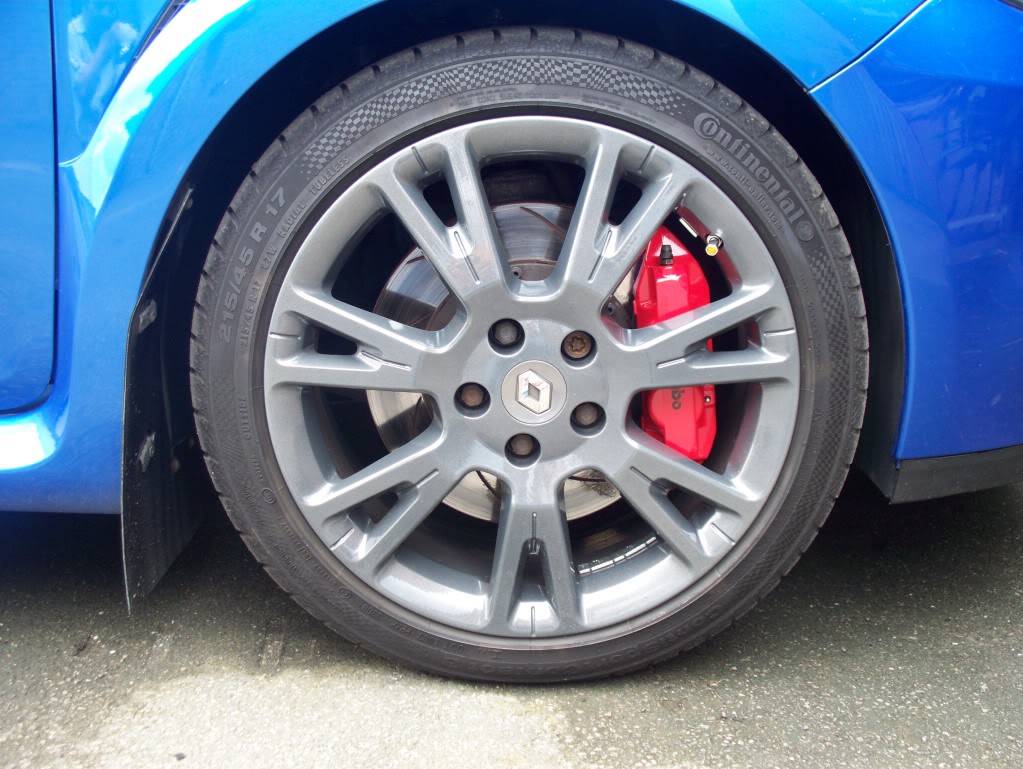

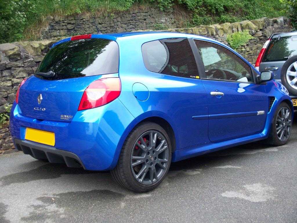

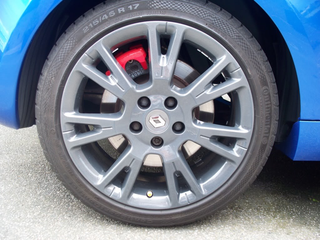

New wheels;
Not entirely sure about the shade but it'll do for now - my previous powder coater is having some issues so I went elsewhere and while the service was ok, price not too much more, the shade isn't quite the same as before.
Conti's have a nice slight stretch on the 8J wheels, perhaps not clear from the pics.

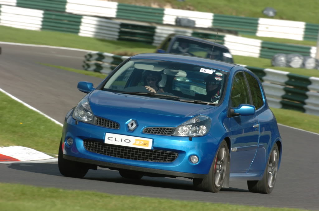

Little car did really well at Cadwell last night, the Toyos probably helped but the car was great. Took a couple of mates with me, one of whom is more of a biker and he was astounded about how it went around corners. I seemed to have forgotten most of what the instructor had told me last time, so I think the next time I book a day at Cadwell, I will try to get an instructor booked early on so I can practice for the rest of the day.
Also, got the tyres filled with nitrogen yesterday morning, adjusted them later when cold, 33PSI @ 20C = 40PSI @ 50C, so much for nitrogen not expanding!
Brakes continue to impress, there are a couple of places where I could brake harder and later, and once or twice I overbraked going into Park. At times it felt like there was a touch of debris stuck to the disc but this soon cleaned itself up. No fade though and good feel, despite standard pads and standard brake lines. I am probably going to whip the pads out to check them over when I change the wheels back later this week.
This was my first track event with the 197 Cup chassis, and to be honest I couldn't notice much if any difference. One day I will get the 200 Cup steering rack fitted and will see if that makes much difference. Not that I am at all dissatisfied with things as they are, as the car does seem really well setup for road and track use.

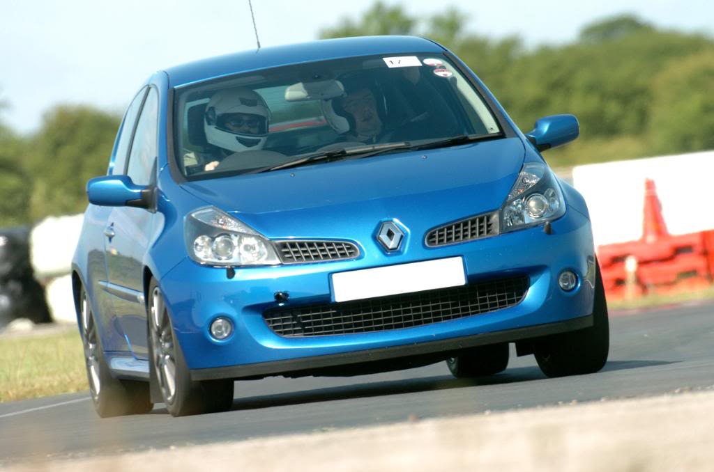

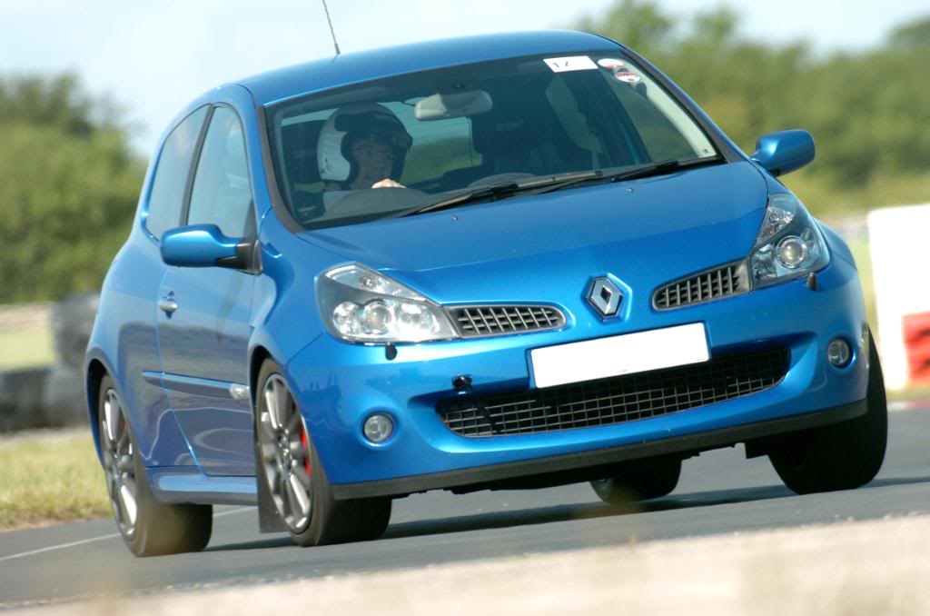

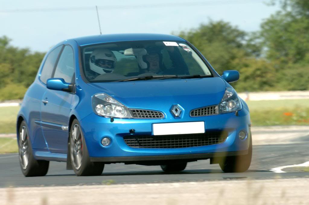

Few pics from Blyton today, my first time there and my wife's first track event;
Car went well, circuit is a bit tight for my liking, prefer Cadwell, but we still had a lot of fun. Harder on the brakes than Cadwell, and it was a really hot day, but the car still didn't miss a beat. Only issue we had was heat soak from the hot front brakes into the front wheels, confusing the TPMS system.

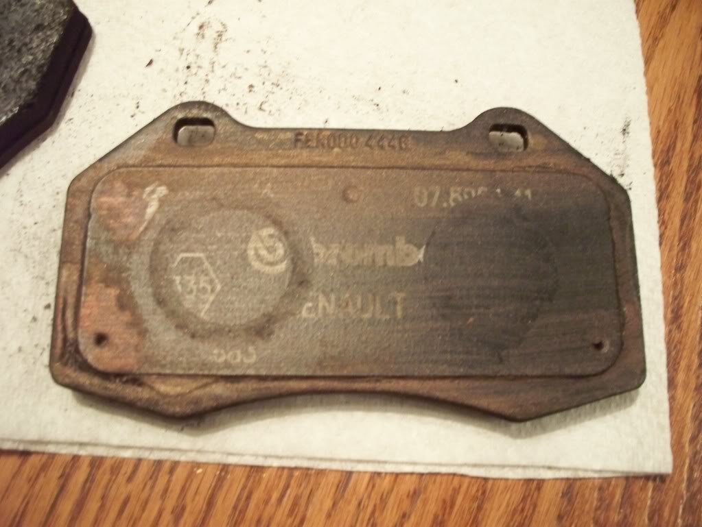

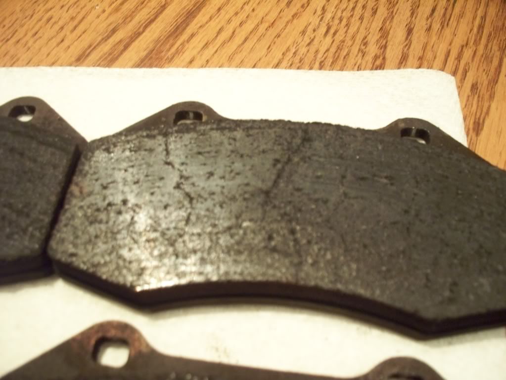

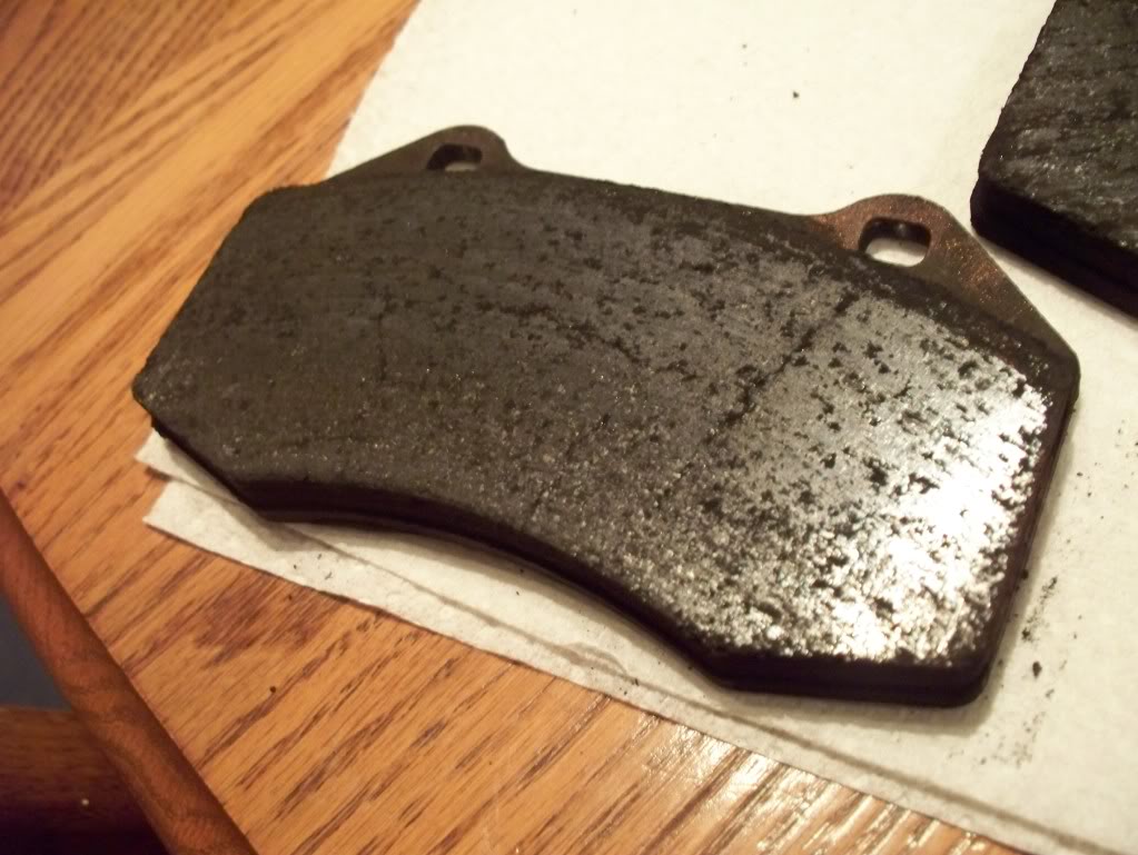

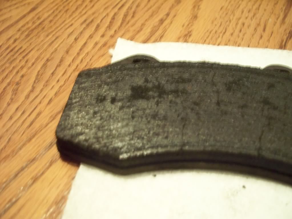

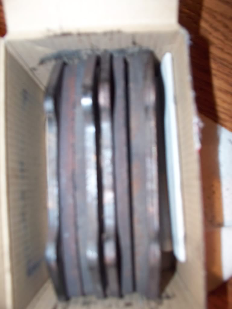

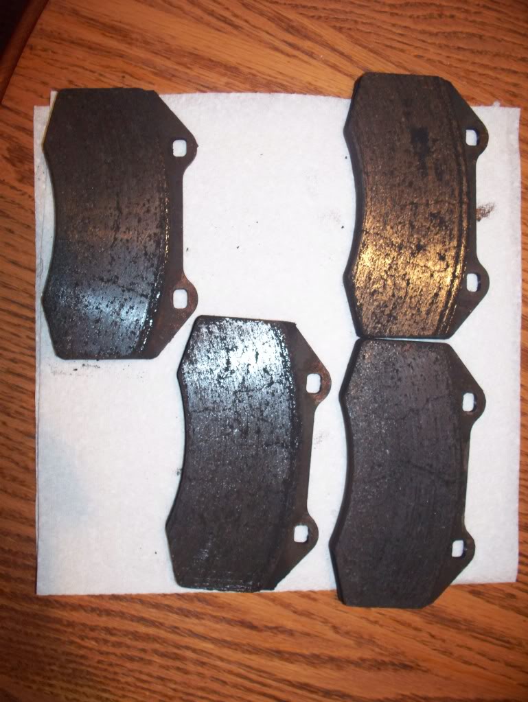

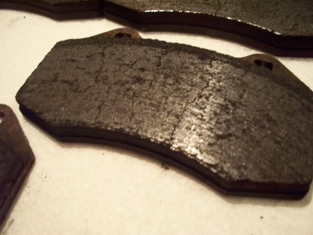

Not been upto much since Blyton, replaced the front pads with some standard Brembo pads. They feel very similar to the OE Brembo/Ferodo pads but I am thinking that I might be better biting the bullet and going for DS2500's.
I needed new pads because despite there being plenty of meat left on my old ones they were starting to crack, and one of them had a bit missing;
The previous pads were genuine Renault ones, Brembo branded but made by Ferodo, type 4446. I didn't want to spend the £80 for genuine Renault so I got some Brembo pads from a motor factor for £37.
Took the car for a short drive after fitting, they feel fine, but I guess the proof will be how they perform when I get some real heat into them.
I got a massive 8,000 miles out of the last set so if I can get closer to 25k out of some DS2500's then they would be better value in the long run.

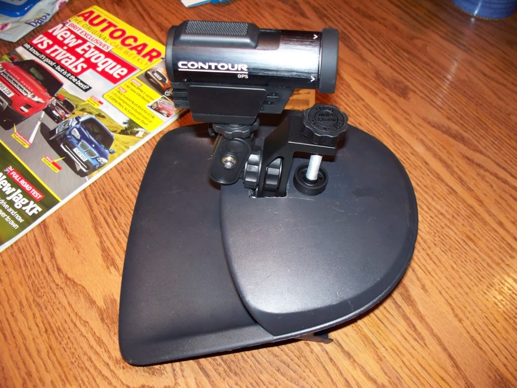

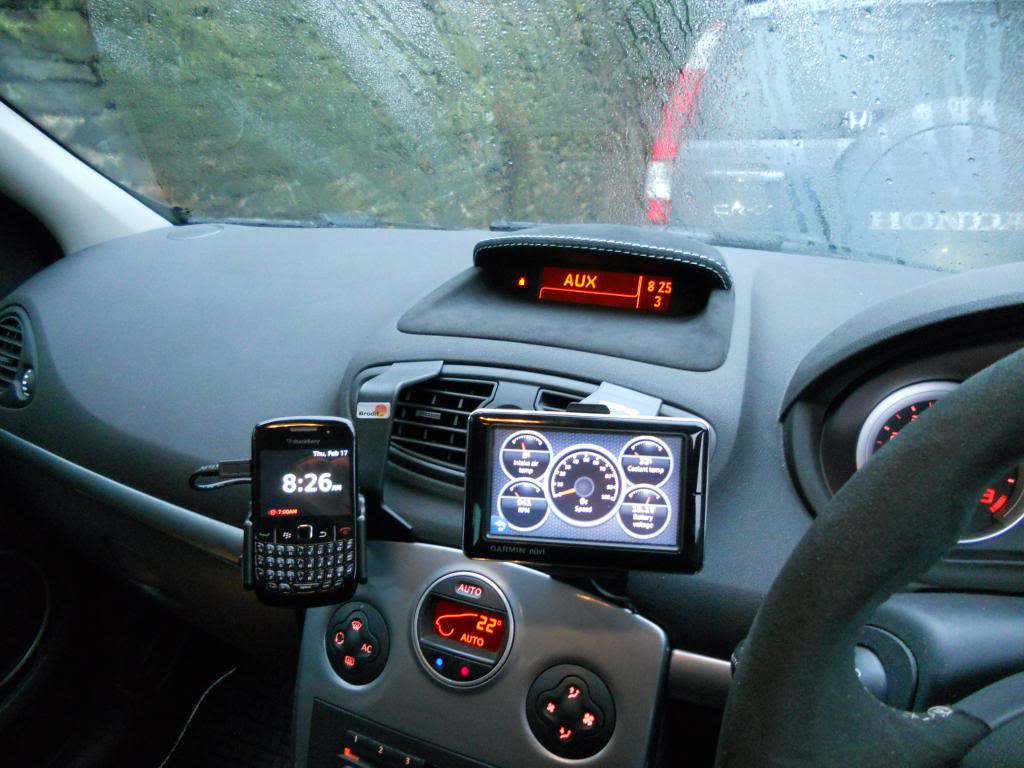

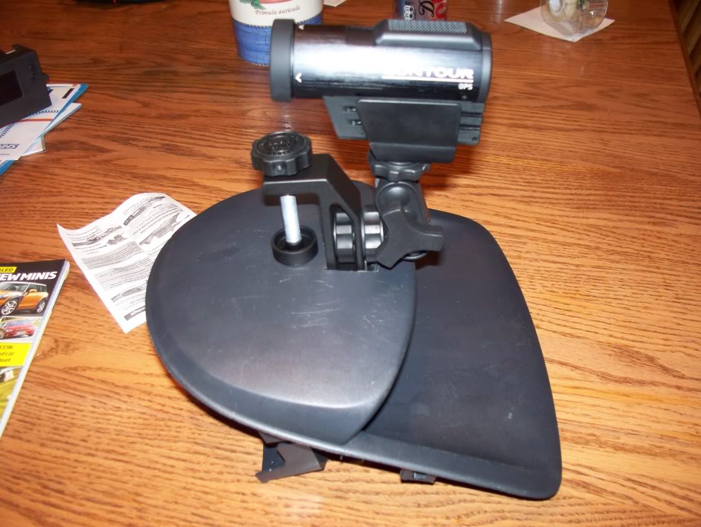

I was on holiday in July and bought myself a present, just had to work out where to mount it;
I did have it just clamped to the surround but having trialled it on a long drive, it slipped over time, due to the wedge shape. Also I had the reflection of the screen vents which was annoying. As you can see above I then modified the clock surround to give the camera a flat mounting and position it closer to the screen. This will hopefully minimise reflections (still there a bit), shouldn't get loose, and seems to be quite secure. Looking forward to trying it out on a TD @ Cadwell in September.

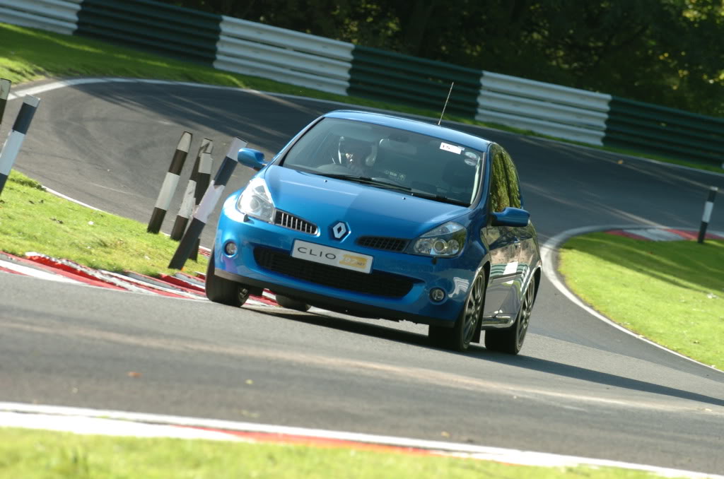

Initial impressions suggest that the car is understeering more, which had I researched getting a thicker ARB I would have realised was a common result. Unfortunatley it was all a bit of a rush to get the car into the garage to get the manifold done and the ARB was very much spur of the moment because we were dropping the subframe anyway so it made sense to do it at the same time.
There are ways to counteract the understeer, such as adjusting toe out, increasing track, etc. but I don't really want to go down that road. Current plan is to refit the standard ARB, though I may try adding a rear one first.

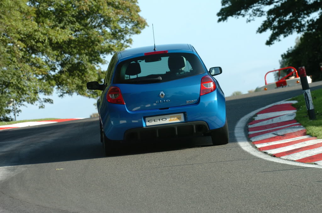

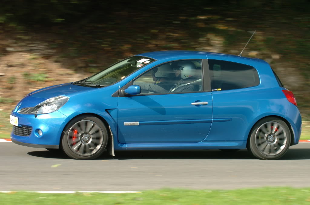

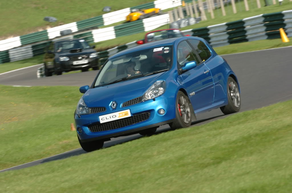

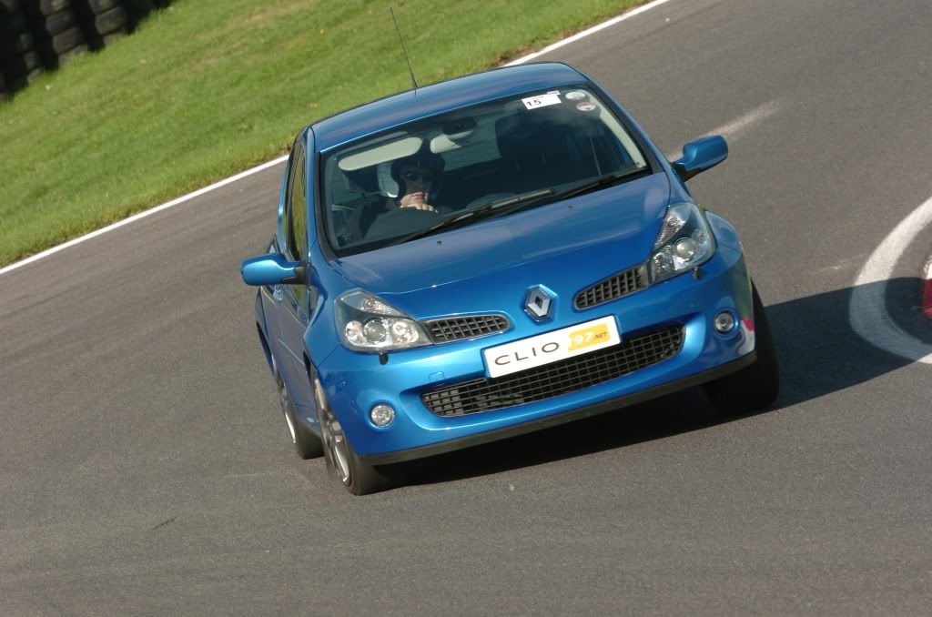

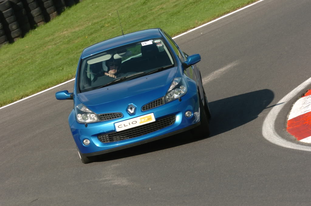

The car performed faultlessly at Cadwell on Tuesday, though I did struggle getting the power down coming out of Barn, and seemed to have more understeer through Chris Curve, overall though a pretty great day, despite early afternoon showers.
Pics;
