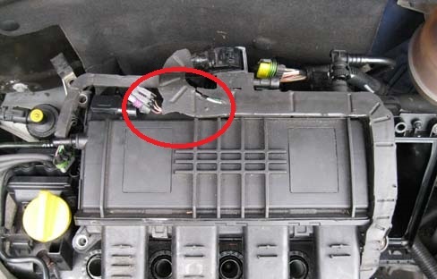

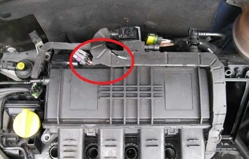

Just looked at wiring and found if i push down on the wiring that comes out of the rubber loom before the plug for the map sensor, i managed to get the light of the dash and am now able to rev the engine without it hunting and stalling have added pictures so people no what i am on about......
i am now hoping that will get rid of two of the fault codes, now just to sort the 02 sensor which im hoping the spare i have will help. I hope this will help anyone else out that has a similar problem even tho there is other threads that are more detailed.
