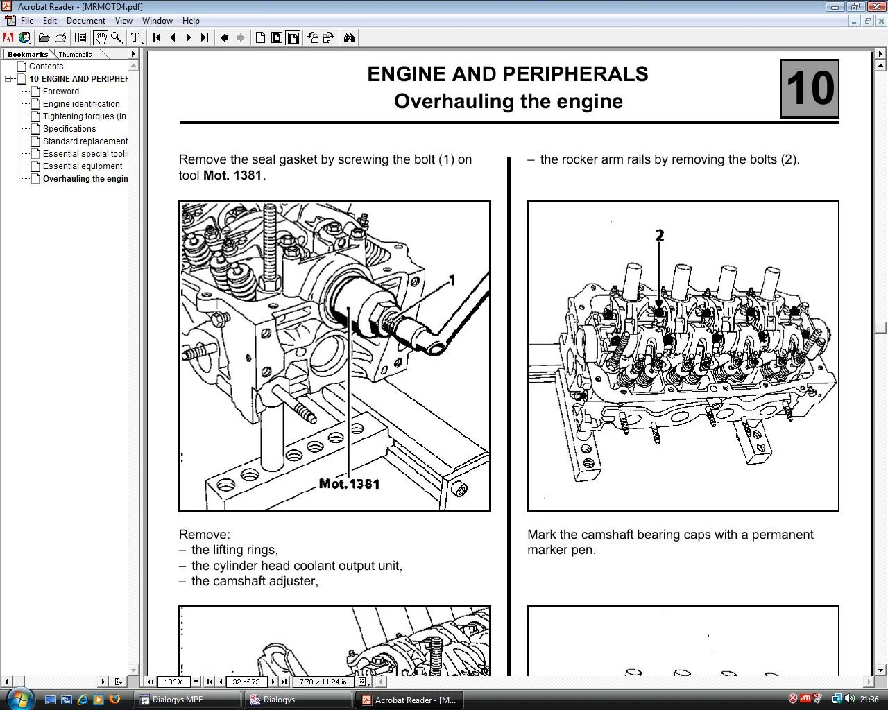

so are they DOHC or SOHC because have been told its SOHC but always thought all 16vs were DOHC anybody got pics of the timingbelt fitted?
Nope there a SOHC engine to keep costs down, they use rockers so one cam lobe operates two valves. I'll see if I can get a pic off dialogys hold on.
Not the best pic but you can see what I mean.
