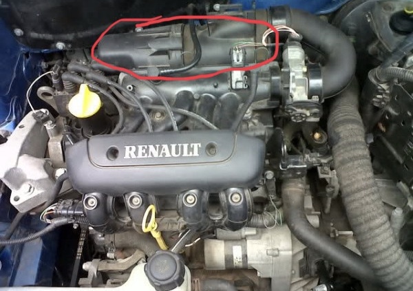

It’s genrrally on top of the gearbox, if you can take some pics of your engine bay from a few angles, then we can probably point it out for you.
If I remember rightly, if you take your hands and aim down the back of the engine/gearbox roughly where they mate, move over a few inches you'll feel the sensor. It's like a smarties tube size thing just poking out the gearbox with a plug on the end. I haven't got any pictures I'm afraid as that car is long gone
Just remembered the air box is in the way, remove this to get at it!
