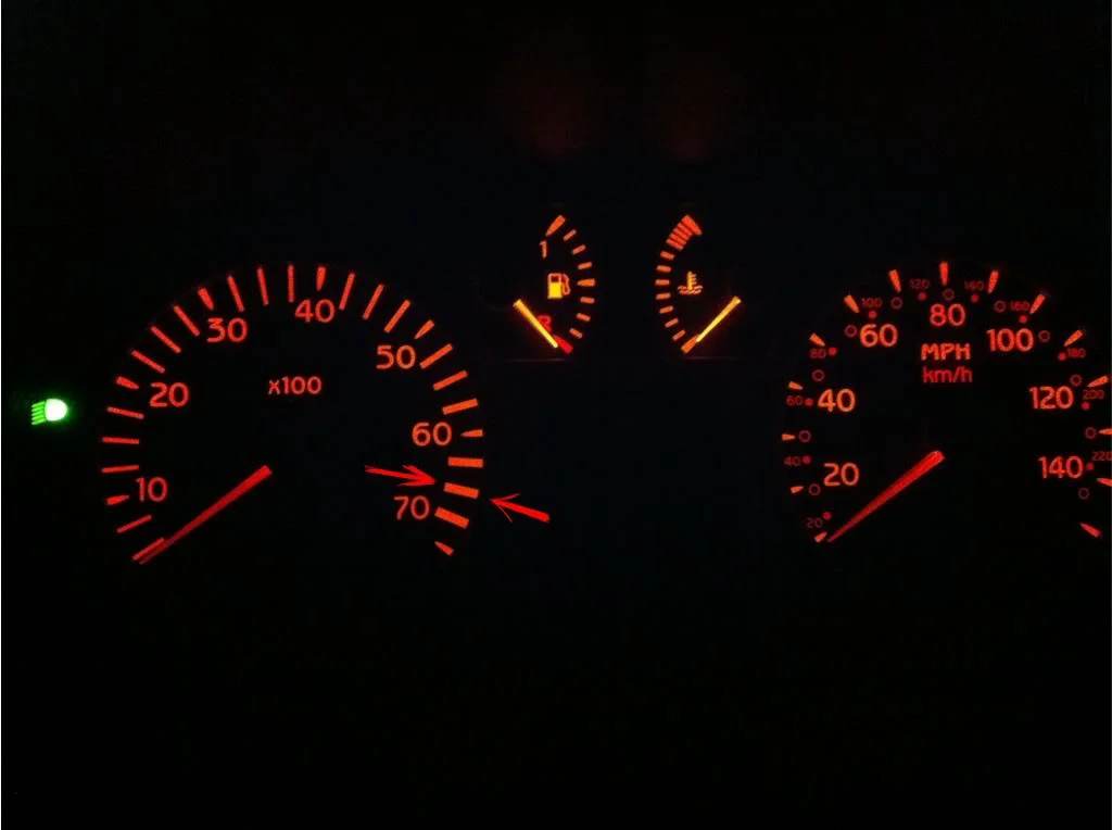

Just thought i'd share the answer to this.
On my mk2 ph3 1.4 16v, it has digital dials.
cold = 0
warming = 2 bars
normal running temp = 4 bars
at 0 and 2 bars the rev limit is at just below 6k
when at running temp the red line its at about 6.5 6.6k :)
