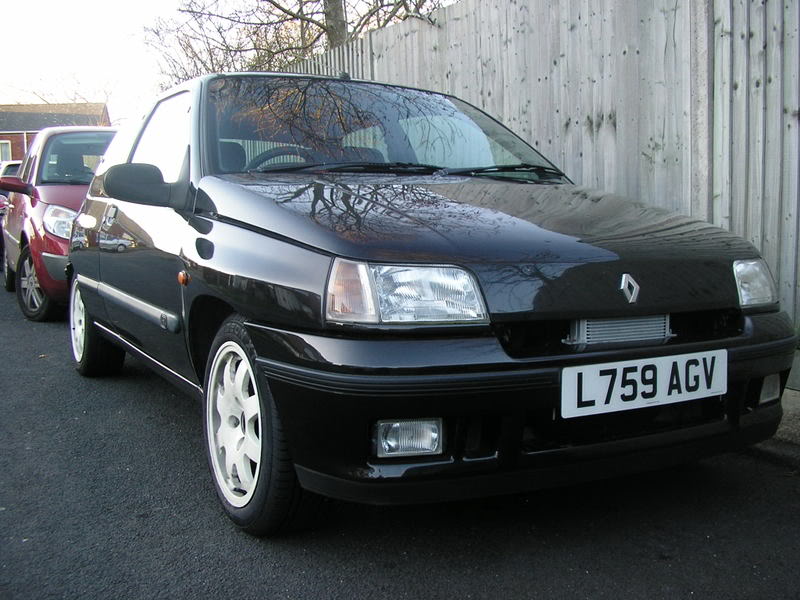

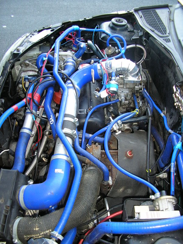

3.I had this in my mk1 clio..cheap,fast and easy to maintain...5 gtt lump and the conversion is dead easy and you can keep the 16v gearbox to keep the speedo
