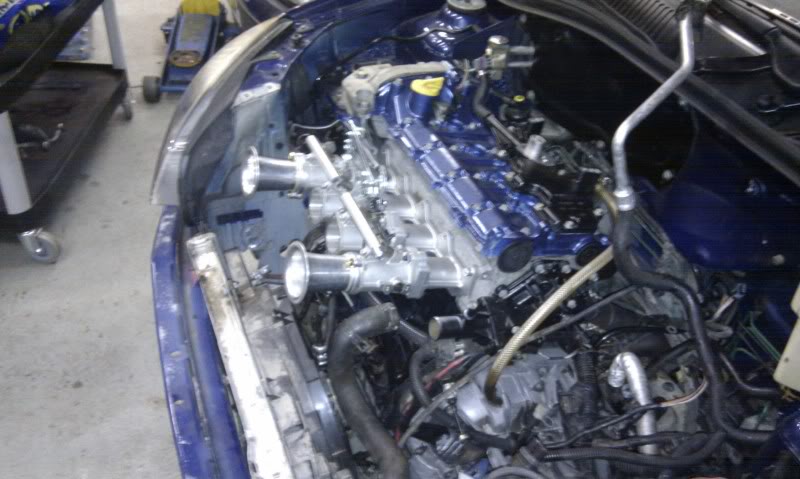

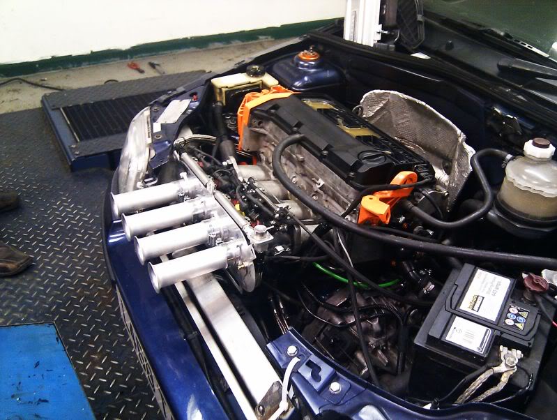

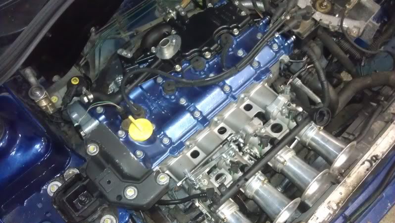

experimented with that at emerald last year. in short, as long as you can fit under the bonnet is better

Yes. Really good read that. Refreshing to see it related to back to back practical tests rather than theory!
Dan's pictures above are the ones I remember seeing before.
According to some of my online based calculations 15mm change in runner length can shift torque by 250rpm. All theory of course:)
